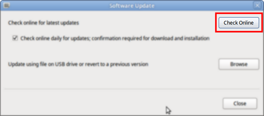

Update PathPilot

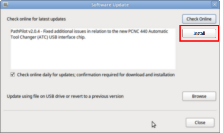

Before using the Door Lock Switch Kit, you must make sure that the PathPilot controller is updated to PathPilot v2.1.6 (or newer). This version of PathPilot has settings required to use the Door Lock Switch Kit.
To update PathPilot, do either of the following:
  2. Downloading and installing an update file requires an Internet connection. From the Status tab, confirm that the Internet button LED light is on. Then, select Update.
Figure 10: Update button on the Status tab.
Figure 11: Software Update dialog box.
  1. Select Install.
Figure 12: Install button on the Software Update dialog box.

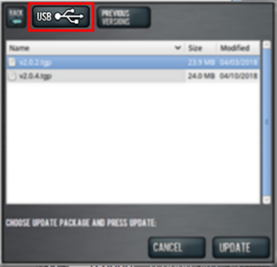

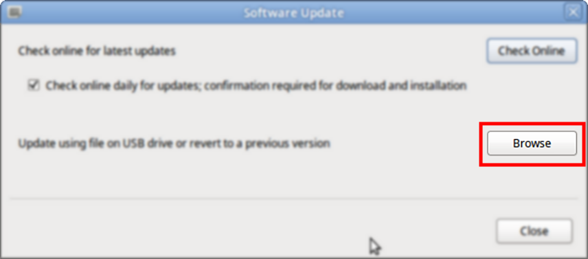

  1. From the PathPilot support center , download the most recent PathPilot update file.
Figure 13: Update button on the Status tab.
Figure 14: Software Update dialog box.
Figure 15: Browse dialog box.
