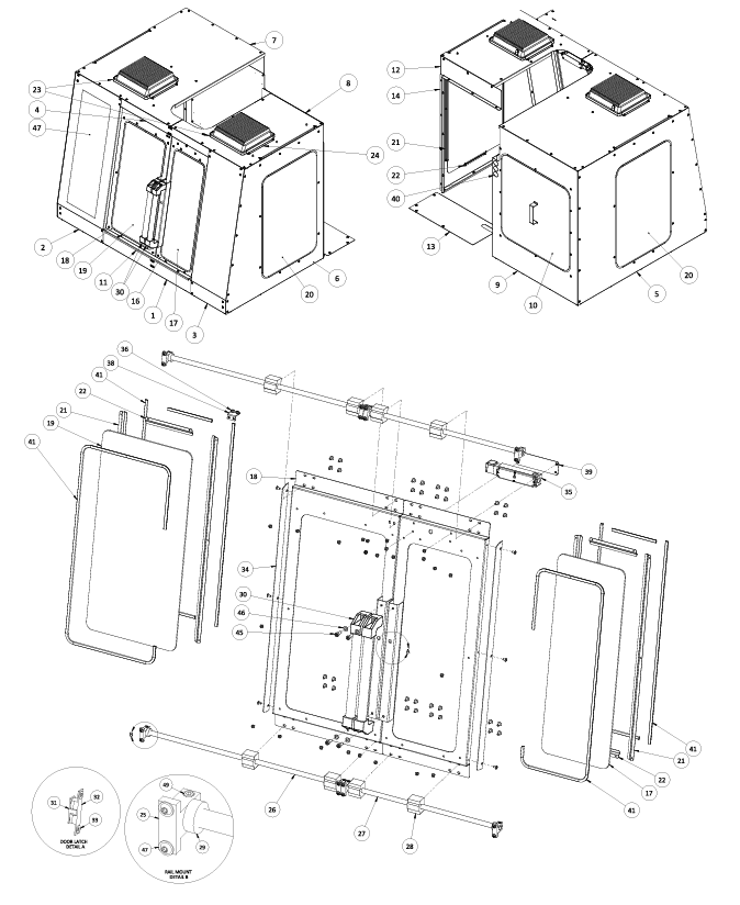

Install the Enclosure Panels
Tip! To install the enclosure panels, work from the left to the right of the machine.
To make it easier to install all components, don't install the side windows until later in the procedure.
Keep all screws one quarter-turn loose while installing the enclosure panels. This makes it easier to align the panels. Once you're done installing the enclosure, fully tighten all screws.
Install the Left Rear Panel
  1. Attach the column cover to the machine column with three M6 × 1.0 - 12 screws.
  2. Attach the left rear panel to the column cover with four M5 × 0.8 - 10 screws.
  3. Attach the left rear panel to the left chip pan with three M6 × 1.0 - 12 screws.

Install the Rear Splash Shield
  1. Attach the rear splash shield to the right chip pan below the electrical cabinet with four M6 × 1.0 - 12 screws.
Install the Linear Rails

Install the Front Doors
Assemble the Front Doors
Figure 23: Rubber trim, window, and window retainers layered to assemble the front door.
  1. Push a strip of rubber trim onto the edge of the window opening on each front door. Make sure that the trim starts at one end of the door handle mount, continues around the perimeter of the window, and ends at the opposite side of the door handle mount. When finished, use shears or a knife to cut the excess trim.
  2. Remove and discard the protective plastic film from each window.
  3. On the inside of one front door, put one window on top of the rubber trim.
  4. Attach one dark gray, vertical window retainer to both sides of the front door's window opening with two sets of three M5 × 0.8 - 10 screws.
    NOTICE! To prevent window damage from over-tightening, use your fingers to tighten the screws.
  5. Attach one dark gray, horizontal window retainer to the top and bottom of the front door's window opening with two sets of two M5 × 0.8 - 10 screws.
Figure 24: Window retainers attached to the front door.
  1. Repeat Steps 1 through 5 to assemble the remaining front door.
Install the Front Door Assemblies
Each front door is attached to the enclosure by securing it to the linear bearings: the wider door is mounted on the left side of the enclosure, and the narrower door is mounted on the right side of the enclosure.
To install the front doors:
  1. Starting with the top linear assembly, attach the narrow door to the two upper linear bearings with two sets of four M5 × 0.8 - 10 screws.
Figure 25: Narrow door attached to the top linear assembly.
  1. Move the bottom of the narrow door into alignment with the bottom linear assembly. Then, attach the narrow door to the two bottom linear bearings with two sets of four M5 × 0.8 - 10 screws.
  2. Repeat Steps 1 to 2 to attach the wide door to the top and bottom linear rail assemblies on the remaining side of the enclosure.
Figure 26: Both front doors attached to the enclosure.
  1. To the edge of the front door that's closest to the left side of the enclosure, attach one door seal with three M5 × 0.8 - 10 screws.
Figure 27: Door seal attached to the edge of the front door.
  1. Repeat Step 4 for the remaining front door.
  2. Attach the handles to both front doors with two sets of two M8 x 1.25 - 20 screws and two sets of two M8 flat washers.
Figure 28: Both front door handles attached to the enclosure.

Enclosure Exploded View
Enclosure Parts List
ID
Enclosure Panel, 770, Lower Front (PN 37600)
Enclosure Panel, 770M, Left Front (PN 37603)
Enclosure Panel, 770M, Right Front (PN 37601)
Enclosure Panel, 770, Upper Front (PN 37605)
Enclosure Panel, 770M, Left Side (PN 37604)
Enclosure Panel, 770M, Right Side (PN 37602)
Enclosure Panel, 770, Left Top (PN 37614)
Enclosure Panel, 770, Right Top (PN 37615)
Enclosure Panel, 770, Left Rear (PN 37616)
Enclosure Panel, 770, ATC (PN 37617)
11
Chip Tray Rail, 770 (PN 37662)
12
Enclosure Panel, 770, Right Rear (PN 37619)
13
Enclosure Panel, 770M, Splash Shield (PN 38479)
14
Enclosure Panel, 770, Splice Plate (PN 38480)
15
Enclosure Panel, 770, Column Splice (PN 37618)
16
Enclosure Door, 770, Right (PN 37609)
17
Window, 770M, Right Door (PN 37624)
18
Enclosure Door, 770, Left (PN 37608)
19
Window, 770M, Left Door (PN 37623)
20
Window, 770, Side (PN 37625)
21
Enclosure Window Retainer, 770, Vertical (PN 37620)
22
Enclosure Window Retainer, 770, Horizontal (PN 37621)
23
LED Floodlight, 50 W (PN 37341)
24
Flood Light Retainer (PN 38222)
25
Linear Rail Mount (PN 37622)
26
Left Door Rail, 770 (PN 37606)
27
Right Door Rail, 770 (PN 37607)
28
Linear Bearing (PN 37610)
29
Door Bumper (PN 38357)
30
Handle, 400 mm (PN 37611)
31
Enclosure Ball Latch, Male (PN 38483)
32
Enclosure Ball Latch, Female (PN 38482)
33
Washer, Flat, M5, Stainless Steel (PN 37939)
34
Door Seal (PN 37613)
35
Locking Door Switch (PN 37352)
36
Nut Bar (PN 37585)
37
Locking Switch Key (PN 37529)
38
Switch Key Bracket (PN 37586)
39
Locking Door Switch Installation/Cover Plate (PN 38272)
40
Round Plug, 32 mm (PN 37598)
41
Sealing Strip, Rubber (PN 38356)
21
42
Screw, Button Head Cap (Flanged), M6 × 1 - 12, Stainless Steel (PN 38206)
77
43
153
44
Screw, Socket Head Cap, M5 × 0.8 - 20 (PN 30357)
45
Screw, Socket Head Cap, M8 × 1.25 - 22 (PN 37190)
46
Washer, Flat, M8 (PN 30531)
47
Decal, Enclosure, 770M, Front Left Panel (PN 38745)
