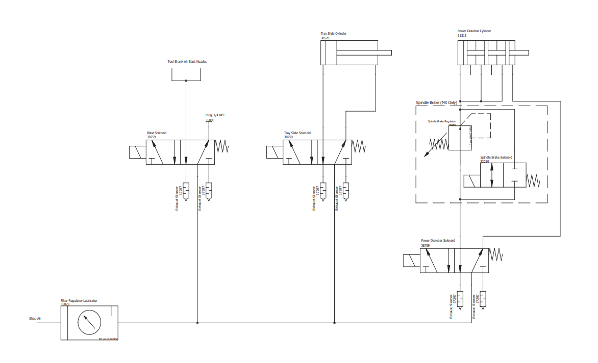

Air Requirements
  • Air Pressure Between 90 psi and 120 psi (620 kPa to 825 kPa).
  • Air Volume For successive back-to-back tool changes, at least 2 cfm at 90 psi is required.
    Use the FRL Filter-Regulator-Lubricator (PN 32457) (included with the power drawbar kit) for this purpose.

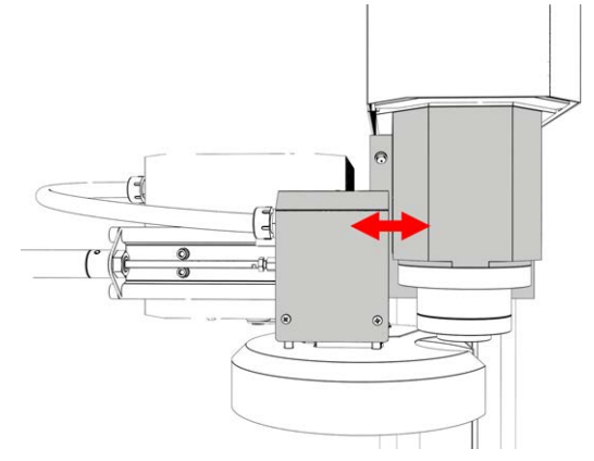

Prepare the Machine
Figure 6: Tool tray moved in toward the spindle.
Figure 7: Linear bearing flush with the ATC main assembly.

  3. Verify that the ATC is all the way forward (toward the spindle), and then slowly move the Z-axis down (-Z) to examine the clearance of the carousel door opening.
  4. Verify that the carousel door opening is approximately equal to the front back and left of the spindle mounting flange:
Figure 10: Distance between the carousel door opening and the spindle mounting flange.
Figure 11: Socket head cap screws securing the ATC main assembly to the mounting bracket.
      Repeat this step as needed.
  2. Tighten the socket head cap screws and the flange nuts (if you loosened them in Step 5).

Make Air Connections
  2. Route the loose ends of the two 1/4 in. plastic tubes connected to the ATC main assembly through the enclosure knockout, up the energy chain, and toward the Power Drawbar.
  1. Trim and connect the loose ends of the 1/4 in. plastic tubes in the following order:
Figure 12: Air in port in the ATC main assembly.
d. If you haven't already done so, connect your shop's air supply to the FRL.

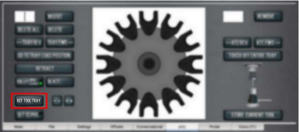

  1. Verify that there’s no tool in the spindle.
  2. From the PathPilot interface, on the ATC tab, select Ref Tool Tray.
The tool tray spins.
NOTE: You’re only required to reference the tool tray once, unlike the mill axes' referencing procedure.

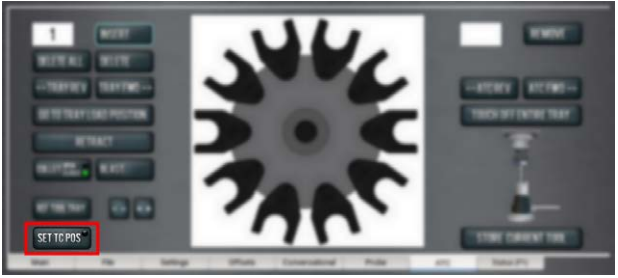

Set the Tool Change Height

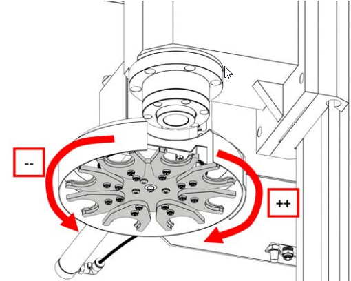

Adjust for Rotational Play
There's a small amount of rotational play built into the Automatic Tool Changer (ATC) carousel. This play allows for some misalignment during tool changes, and you must adjust for it in both directions. The taper on the tool shank also helps align the tool during a tool change.
To adjust for rotational play:
  1. From the PathPilot interface, on the ATC tab, select Tray Fwd to rotate the tray clockwise (forward) one full tool slot.
  1. Select Tray Rev to rotate the tray counterclockwise (backward) one full tool slot.
  2. Verify that the tool’s shank is aligned with the collet in the spindle.
  3. Depending on the alignment, do one of the following:
  • Aligned You have completed aligning the ATC. Remove the tool from the fork. Go to Step 5.
  • Not Aligned You must readjust the tool tray rotation. Go to "Adjust the Tool Tray Load Position".

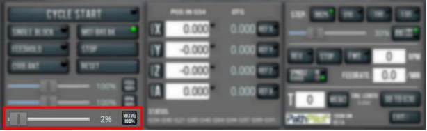

  1. From the PathPilot interface, on the Main tab, drag the Maxvel Override slider to the left. This reduces the maximum velocity by the percentage shown.
  1. Do a test tool change. Because the maximum velocity is reduced, it's easier to verify the alignment of the ATC and stop the machine if further adjustment is required.
Tip! Use the Spacebar key to pause the tool change, if needed.
Figure 8: Set TC POS button on the ATC tab.

Schematics
To view a PDF version of your manual, go to Tormach document TD10427.
