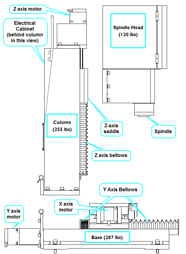

The PCNC 770 Mill can be broken down to 3 major components: the Base, the Column, and the Spindle Head. The user may elect to only partially disassemble their machine, in which case awareness of component weight and weight distribution is critical.
Figure 1

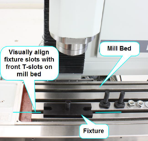

  1. Position the spindle fixture to the front T-slot on the bed; do not attach fixture bolts at this time. See Fig 3.
Figure 3

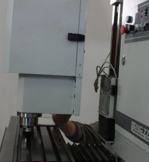

  1. Jog the Y axis position so that the fixture is under the spindle bore.
  2. Partially lower the spindle over the fixture. It might be useful to manually lift the fixture into the spindle/collet (See Fig. 4), then slowly lower the spindle and fixture down to the mill bed until the collet is about half way down on the fixture.
Figure 4

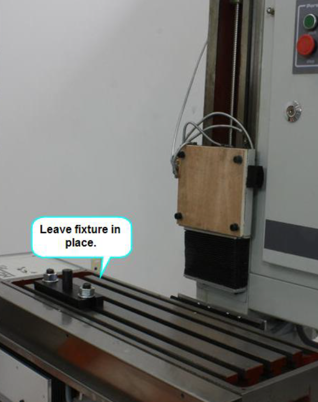

  1. Mount and tighten the T-bolts to the bed and fixture then lower spindle all the way onto fixture leaving about a ¼ inch gap between the Base of the fixture and the nose of the spindle. See Fig. 5.
Figure 5

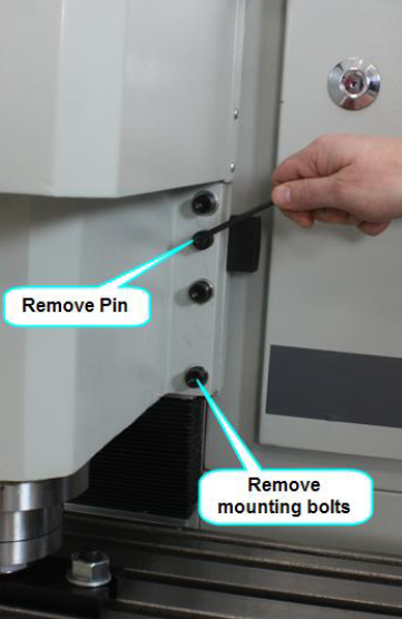

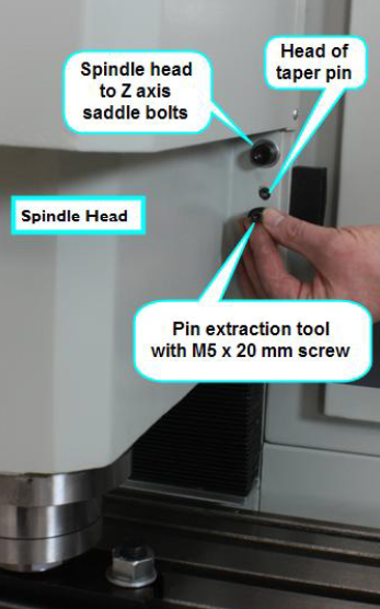

  2. Remove the taper pins at the Z axis saddle. There are 2 tapered pins located 1 on each side of the spindle head. Each pin has a threaded hole. Use the pin extraction tool by placing the open side of the cup over the pin, and thread the screw through the hole in the cup into the pin. It may be necessary to scrape away a bit of paint from the head of the pin to get the screw in properly. Tightening down the screw will extract the pin. After a few turns the pin will simply pull out. Should the screw become lodged in the pin threads, take caution not to damage the pin’s surface as you free them. Set pins aside as you will be re-using these during reassembly. See Fig. 6.
Figure 6
  1. Remove the bolts connecting the spindle head to the saddle (these will be used later to mount the protective covers). See Fig.7.
Figure 7

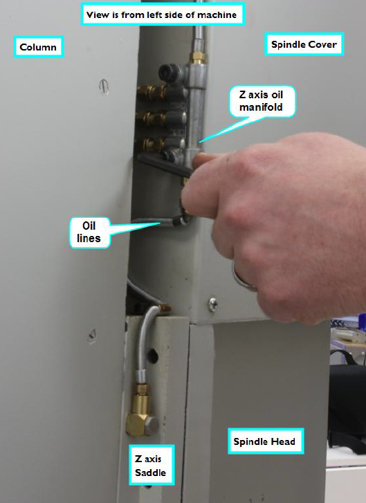

  1. Remove the Z axis oil manifold bolts. See Fig. 8.
Figure 8

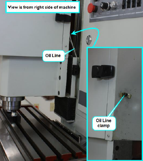

  1. Move the Y axis to separate the spindle head from the Column, about 1-2 inches.
  2. Loosen the lubrication line clamp located on the back face of the sheet metal spindle cover. See Fig. 9.
Figure 9

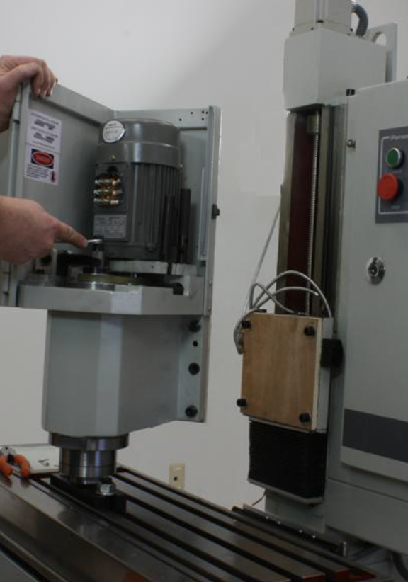

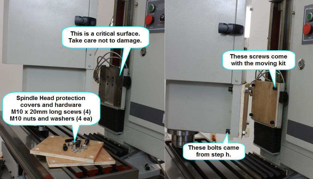

  1. Mount protective cover (match hole patterns). Note: re-use the spindle head mounting bolts to mount the cover to the Column. See Fig. 11.
Figure 11

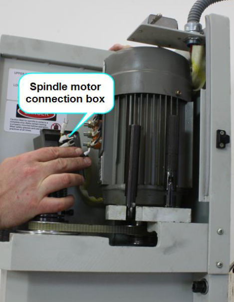

  3. Remove the connection cover box on the spindle motor and disconnect the 3 black motor power leads and the ground wire. See Figure 12.
Figure 12

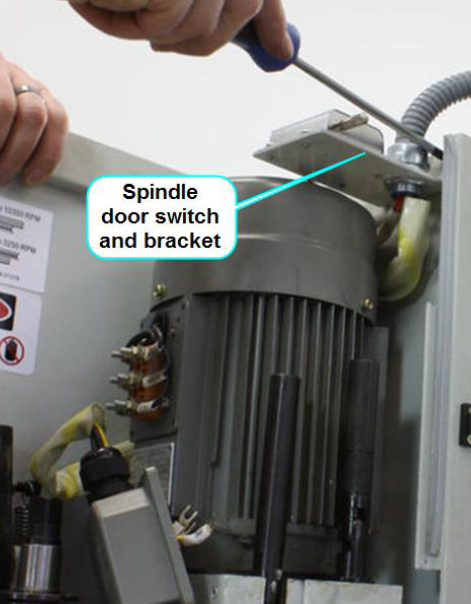

  1. Remove the 3 screws connecting the spindle door switch to the rear cover. See Figure 13.
Figure 13

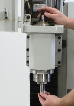

  1. The spindle head can now be lifted and removed from the machine. Note, the weight of the head can cause the collet to remain collapsed over the fixture post. If the head will not come freely off the fixture, use a means to gently pry the head vertically. Less than 1” of vertical travel is needed to free the spindle. Ideally the fixture would be left in place on the bed to make reassembly easier. See Fig. 15. If the spindle will not come free from the fixture while mounted to the table, the fixture can be unbolted and removed with the spindle. Care should be taken to not let the spindle fall while loosening the fixture mounting bolts. Care should also be taken not to damage the bed.
Figure 15
WARNING! The spindle head weighs 120 pounds. Use proper lifting equipment and observe all safety precautions before lifting. The sheet metal cover is not a good place for lifting points.

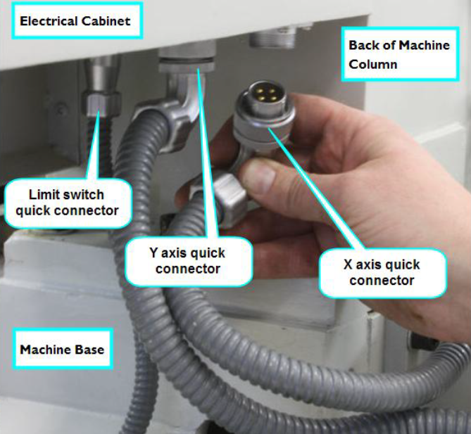

  1. Underneath the electrical cabinet are 3 plugs. The 2 larger plugs are for the X and Y axis motors, the smaller one is for the x and y limit switches. Disconnect them from the cabinet by loosening the retaining nut and pulling down. See Fig. 17.
Figure 17

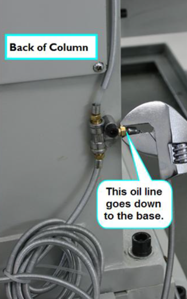

  1. The lubrication system must be separated. Located on the back of the Column is a y-fitting. Loosen and remove the oil line fitting that goes down to the Base. See fig. 18.
Figure 18

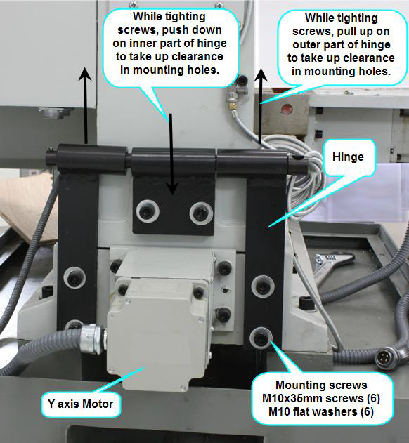

  1. Mount the moving kit Hinge using the indicated screws. See Fig. 18. Note: it may be necessary to scrape away paint from the tapped holes in the Column and Base. The hinge is designed with a pin that fits loosely in the hinge flaps. Proper mounting means pushing up on the outer flaps when tightening, and down on the inner flap when tightening. This will help limit the possibility of damage to critical surfaces during disassembly and reassembly.

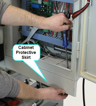

  1. Mounted to the front face at the bottom of the electrical cabinet is a protective skirt used to deflect coolant off of the electrical connections. This skirt needs to be removed in order to access some of the Column mounting bolts. There are 3 nuts and screws along the top edge of the skirt and 2 screws on the side. See Fig. 19.
Figure 19

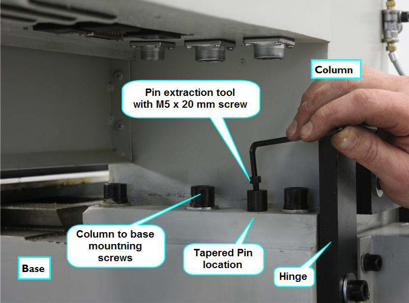

  1. There are 2 taper pins used to align the Column to the Base, one on each side of the Column. These are to be removed in a similar manner described in section 2i. See Fig. 20. To ease pin removal and avoid damage to the pins, soak the pin area with quality penetrating oil for a couple of hours or so.
Figure 20

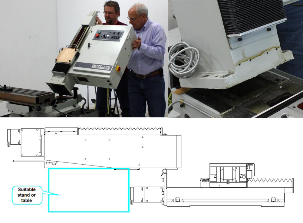

  1. Remove the 6 mounting screws connecting the Column to the Base.

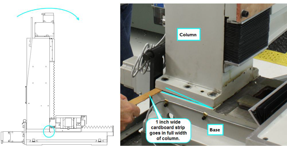

  2. Cut a one inch wide, 10 inch long strip of corrugated cardboard.
  3. Gently tilt the Column forward (the hinge pin will keep the Column from falling) and slip the cardboard strip in the gap created at the Column to Base interface. Note: it is better to use 2 people for this task. See Fig. 21.
Figure 21
  1. Position a suitable stand or table behind the mill. If this is being done at ground level, then suitably sized timbers may be used. Using 2 people, gently tilt the Column backwards until it comes to a rest horizontally. See Fig. 22.
Figure 22
WARNING! THE COLUMN WEIGHS 255 POUNDS. Caution should be taken to avoid injury.

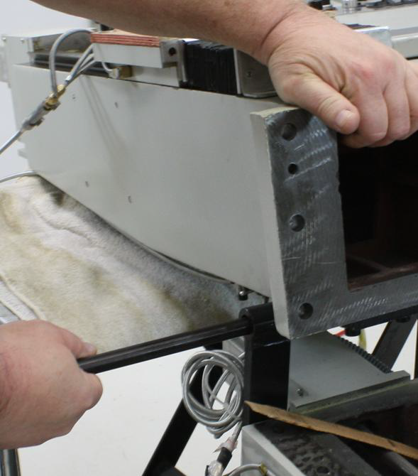

  1. Remove the hinge pin cotter pin, and then the hinge pin itself. See Figure 23
Figure 23
  1. The Column can now be separated from the Base.

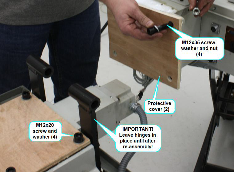

    IMPORTANT! Do not remove the hinge pieces until after reassembly.
  2. Using the fasteners indicated; mount the wooden protective covers to the critical surfaces. See Figure 24
Figure 24

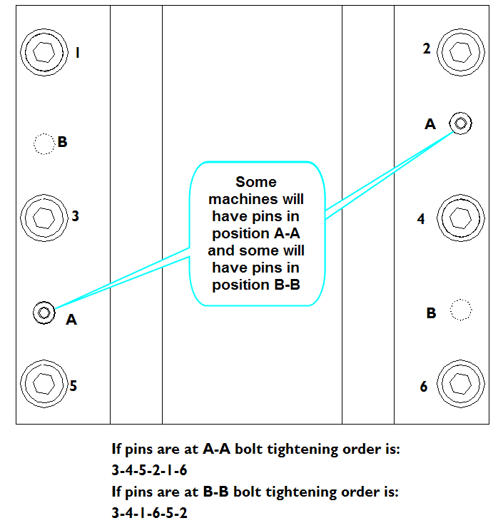

  2. Use the taper pins to establish alignment prior to installing mounting bolts. Take care to limit the amount of sliding motion between the critical surfaces during alignment.
  3. Follow Figure 25 below indicating the tightening sequence of the Column mounting screws. Torque to 74 Ft-lbs (100 Nm).

    6. Final screw tightening should follow the sequence shown in figure 25 below. Final screw torque should be 41 Ft lbs (55Nm).
Figure 25
