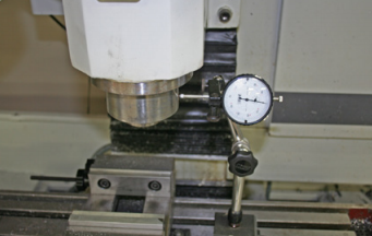

The following method describes the proper procedure to measure X-axis backlash. An analogous procedure is used to measure Y- and Z-axis backlash.
  1. Mount a dial indicator to the mill table along the X-axis to the left of the spindle, with the tip pointing at the spindle.
  2. Jog the Y- and Z-axis to position the spindle head so the indictor tip contacts the outer diameter of the spindle cartridge (see Figure 9.1).
  3. Carefully jog the X-axis in the positive direction until the indictor contacts the spindle. After initial contact, continue to jog the X-axis in the positive direction so that the dial makes at least one complete revolution; stop when dial reads 0.
  5. In MDI field, program a positive X move of .01” at a feed rate of 5 IPM: G01 X.01 F5. The spindle head moves slightly in +X direction. When finished, indictor should read .010”.
  6. Program an X move back to 0: G01 X0 F5. The spindle head moves slightly in the -X direction. The X DRO should say 0; however, the dial indicator should read a number very close to 0. This value is the measured lost motion.

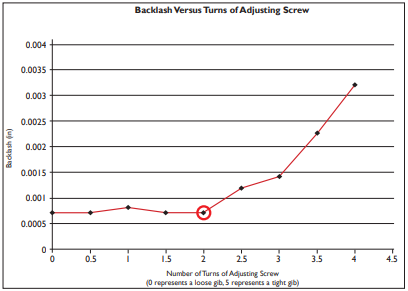

  1. Loosen the upper gib screw eight rotations and tighten the lower gib screw eight rotations. This ensures that the gib clearance is quite loose.
  2. Use a dial indicator to measure lost motion in the Z-axis (refer to Lost Motion Testing). With a very loose gib, the majority of the measured lost motion is attributable to the backlash in the angular contact bearing pair. On a new mill, this value measured should be less than 0.0015” on the Z-axis and less than .0013” on X- and Y-axis.
  3. Tighten the gib by one turn by loosening the lower screw first, then tightening the upper screw. Measure the backlash again.
  4. Repeat this procedure until the measured backlash begins to increase. At this point, the gib setting is slightly too tight.

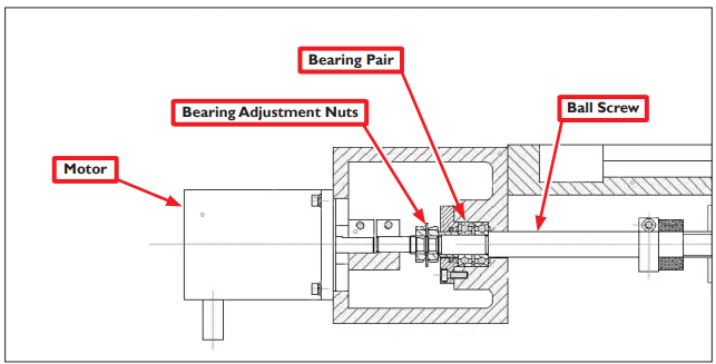

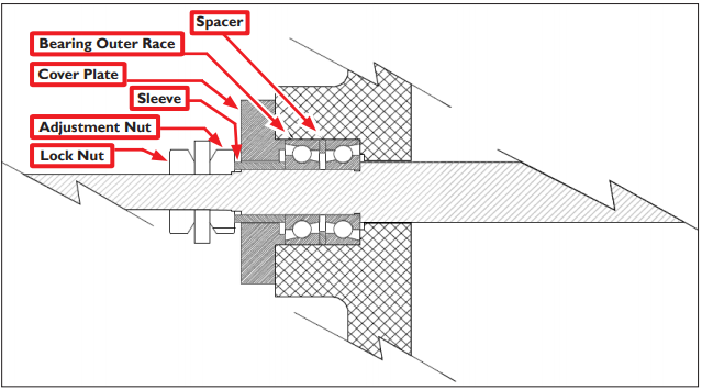

The figure below shows how the force of preload is transmitted through the bearings, from the inner race to the outer race. In a preload pair, this force is then transmitted back to the inner race by an opposed bearing. It should be apparent that the correct orientation of the angular contact bearing is critical to the operation.

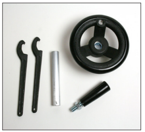

To adjust the angular contact bearing pair preload on all 770 and 1100 machines, the AC bearing service tool kit is required (part number 35355).

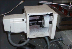

To properly estimate the torque needed to overcome angular contact bearing friction, the bearings must be isolated from the motor detent torque. The following procedure illustrates the X axes; other axes will follow suit:
  1. For adjusting the X-axis, position the table near the right hand end of its travel (i.e., X near to zero). This ensures that the bearing is near to the ball nut to minimize bending of the screw during tests.
  2. Remove X-axis motor mount cover plate.
  4. Remove four cap screws holding the axis motor to the motor mount and remove axis motor. Take care not to put any strain on the motor wires.
  5. Insert a 1/2” diameter rod (included in AC Bearing Service Tool Kit, PN 35355) or drill blank into the coupling. This will effectively extend the ball screw shaft outside of the motor mount.
  6. Clamp a handwheel or vise grip on the end of the rod; this allows sensitive feel for the torque caused by the preload on the bearings. Rotation should be smooth with a small perceptible drag; this corresponds to a medium preload of about 150 pounds. If the rotation feels tight, you have too much preload and will dramatically shorten the life of the bearings. If the rotation is free, you have little or no preload and backlash will be excessive. This test should be done with the lock nut tight.
  8. Re-mount box and motor; ensure that coupling is symmetrically fitted to the motor shaft and the screw end and is fully tightened.

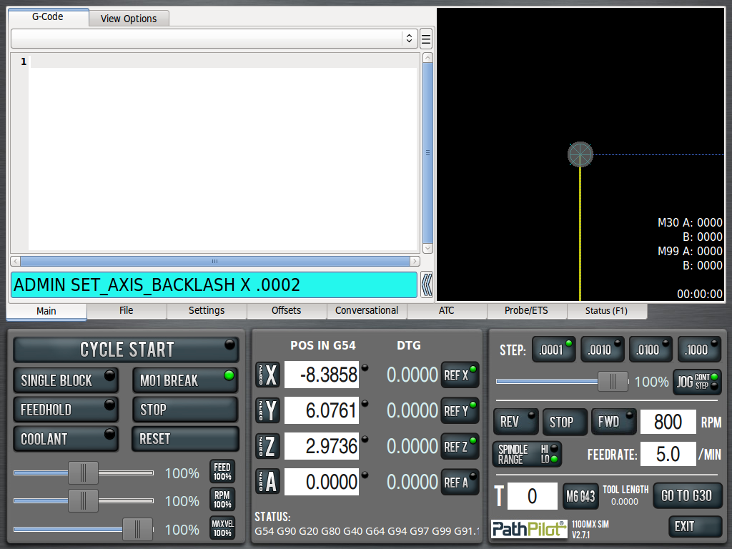

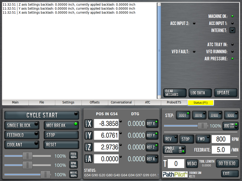

Backlash Compensation
https://tormach.atlassian.net/wiki/s/-813001308/6452/17b5d0ae2ede2362fa8d1e732dc89744e3e532f6/_/images/icons/emoticons/warning.png Note: There is no backlash compensation for the A axis.
