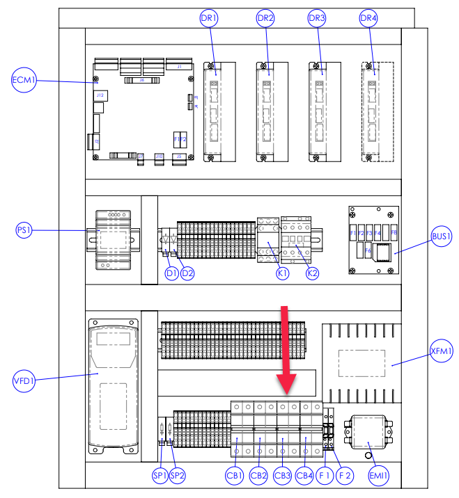

Console isn’t Receiving Power
Test the Power Button Functionality
Examine Power Input to the Console
M/MX Electrical Cabinet

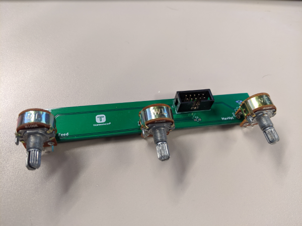

RPM, Feed Override, or Max Velocity knobs don’t Work
Examine the Connectors on the Ribbon Cable

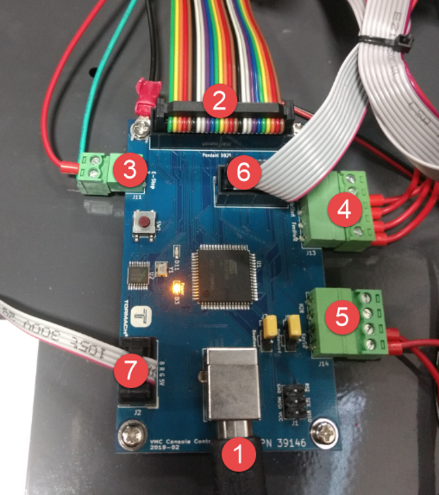

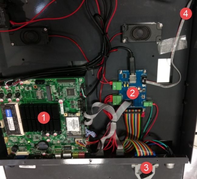

Examine the USB Connection to the Control Board
  1. Computer
  3. DB25 Connector for Pendant
Daughter Board
  3. E-Stop circuit connection
  5. Key switch input
  7. Front panel LED connector
