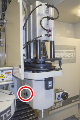

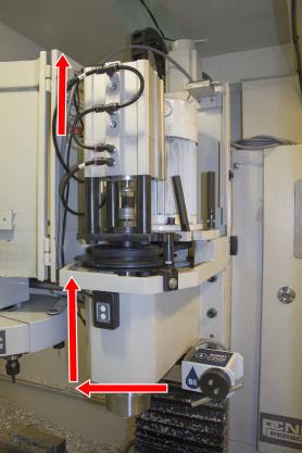

PCNC 770/PCNC 1100
  1. Open the spindle motor cabinet door.
  2. Route the control cable from the SmartCool head unit up the spindle column and through the inside of the spindle motor cabinet.
Figure 7: Routing into the spindle motor cabinet.
  1. Secure the control cable from the SmartCool head unit to the machine with two cable ties and two cable tie mounts: one inside the spindle motor cabinet, and one on the head casting.
Figure 8: Cable tie mount on the head casting.
  1. Route the control cable from the SmartCool head unit to the back of the machine based your specific mill configuration:
    1. Power Drawbar Installed Route through power drawbar’s cable carrier and out to the back of the machine.
Figure 9: Routing on a machine with a power drawbar.
  1. No Power Drawbar Installed Hold the control cable from the SmartCool head unit near the Z-axis motor mount plate. Then, slowly jog the spindle head up and down to verify clearance through the full range of motion in the Z direction. Loosen the center screw on Z-axis motor mount plate, and attach the control cable with one zip tie and one zip tie mount.
Figure 10: Routing on a machine without a power drawbar.
  1. Slowly jog the spindle head up and down to verify that the control cable is free of obstruction from the machine movement.
