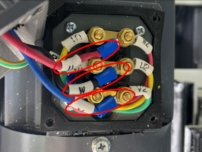

Open up the RapidTurn motor junction box
Swap the position of two of these wires: U, V, W
DO NOT MOVE U1, V1, W1, or U2, V2, W2!
