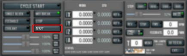

Start the Machine
  3. Press the Reset button.
Select Reset.
Figure 1: Reset button
About Reset Mode
  • Clears alarms

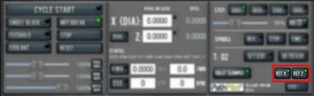

Reference the Machine
Figure 2: Reference buttons.
About Referencing
  • Before using MDI commands

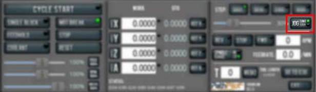

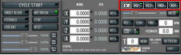

Jog the Machine

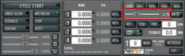

Figure 3: Jog button.
  • When the Cont green light is on, continuous velocity mode is selected.
  • When the Step green light is on, step mode is selected.
Figure 4: Jog Speed slider.
Figure 5: Step buttons (in G20 mode).
For more information on step mode, see "About Step Jogging" (page 4).

About Step Jogging
While jogging in step mode, the machine moves one step each time you either press a jog key on the keyboard, click the inner wheel of the Jog Shuttle, or rotate the Console Pendant one click. The jog step sizes range depending on the programming mode you are using:

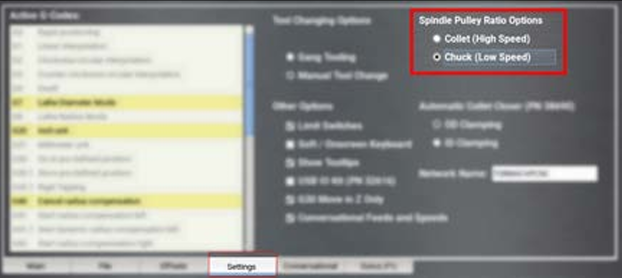

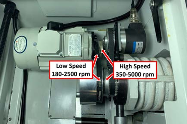

Change the Spindle Speed Range
This machine has two spindle speed ranges:
  • High 250 rpm to 7500 rpm
  • Low 70 rpm to 2000 rpm
WARNING!  Entanglement / Entrapment Hazard. The machine operates under automatic control — it can start at any time and crush, cut, entangle, or pinch body parts. Always keep clear of positions on the machine where unexpected or unintended machine motion could cause harm. Before operating this machine in any way, you must verify that all operators know the location of the machine's Emergency Stop button.
To change the spindle speed range:
    4. Follow correct lockout/tagout procedures.
  2. Open the spindle cabinet door.
  3. Loosen the 8 mm socket head cap screw on the far side of the motor mount with a 6 mm hex wrench.
  4. Lift the spindle motor up (it tilts toward you, pivoting about the remaining screw). The spindle belt slackens, which allows you to move the belt from one pulley to the other.
Figure 6: Example of the spindle belt in the low position.
  1. With the spindle belt in its new position, retighten the 8 mm socket head cap screw that you loosened in Step 3.
  2. Rotate the spindle by hand to visually confirm that the spindle belt is fully seated in the pulley.
  3. Close the spindle cabinet door.
  4. From the PathPilot interface, on the Settings tab, select the appropriate spindle pulley ratio option.
Figure 7: Spindle Pulley Ratio Option selections.

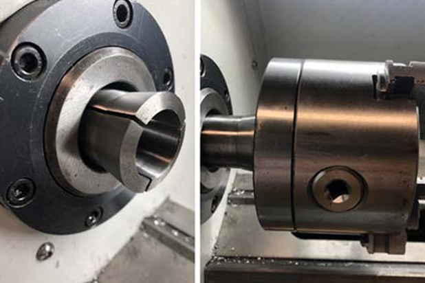

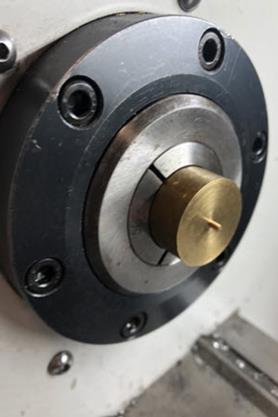

Load Material into the Spindle
  1. Open the enclosure door and the spindle door. Verify that the latch on both doors is seated to prevent the doors from unexpectedly falling.

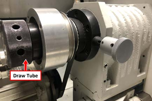

  2. Install the draw tube through the spindle.
Figure 8: Draw tube installed into the spindle.
  1. Install a 5C collet or chuck into the headstock.
Figure 9: Workholding option installed.
  1. Depending on which workholding option you're using, do one of the following:
  • 5C Collet Put a piece of stock into the collet, and adjust the length of the stock in the cutting area.
Figure 10: Material installed into the collet.
  • Chuck You'll install the stock after the drawtube and the chuck are securely tightened.

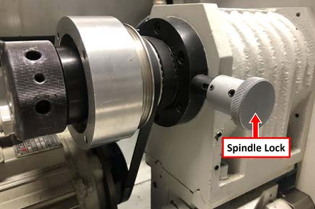

  1. Gently push on the spindle lock and rotate the spindle with your hand. Stop rotating the spindle once you feel the lock engage.
Figure 11: Spindle lock.
  1. Hold the spindle lock with one hand and, using the other hand, tighten the draw tube with the (provided) spanner wrench until the draw tube is tight.

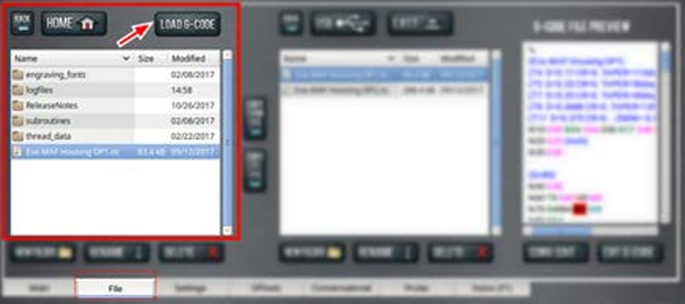

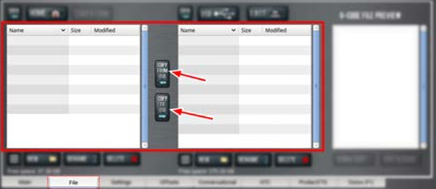

Load G-Code
To run a G-code program on a PathPilot controller, you must first verify that the file is on the controller. For more information on transferring and moving files, see "Transfer Files to and From the Controller" (page 9).
To load G-code:
  2. Select Load G-Code.
Figure 12: Controller Files window on the File tab.
To run a G-code program, you must transfer the files to the PathPilot controller.
  1. Insert a USB drive into any open USB port.
  2. From the File tab, select the file to transfer (either in the USB Files window or the Controller Files window).
  2. Select either Copy From USB or Copy to USB.
Figure 13: File tab
  1. Select Eject.

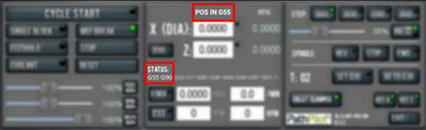

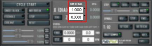

Set Work Offsets
In the the X (Dia) DRO field, all values are expressed in terms of the diameter of the workpiece, not the radius.
Example
If the active tool is 2 in. away from the spindle centerline, 4.000 displays in the X DRO field.
  • Select Zero.
Figure 14: Work Offset DRO fields.
To change work offsets:
Figure 15: Work offset indicated in the PathPilot interface.
About Work Offsets
Work offsets allow you to think in terms of X and Z coordinates with respect to the part, rather than thinking of them with respect to the machine position. This means that you can jog the machine to an arbitrary location (like the end of a workpiece) and call that location zero.

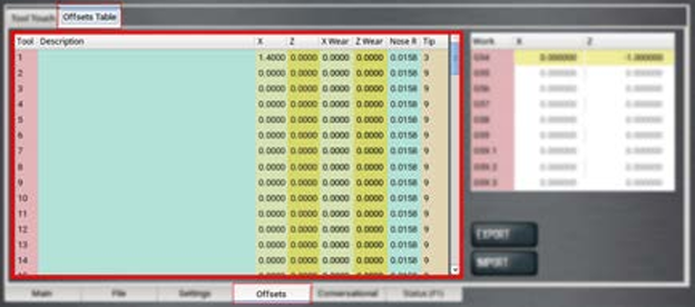

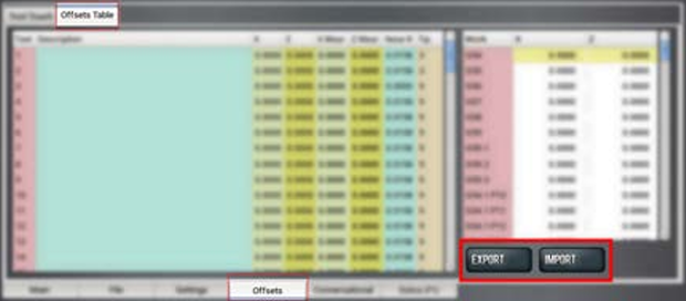

Set Tool Geometry Offsets
Before running a G-code program, PathPilot must know the geometry of the tools that are required for the program. For more information on using tool length offsets, see "About Tool Offsets".
NOTE: You can import a .csv file with tool geometry offset data. For information, see "Import and Export the Tool Table".
To set tool geometry offsets:
  1. Verify that the machine is powered on, out of reset, and the axes have been referenced.
  2. From the PathPilot controller, on the Offsets tab, select the Offsets Table tab.
  3. Find the Tool Table window.
Figure 16: Tool Table window on the Offsets tab.
  1. Touch off the tool geometry offsets. For information, see "Touch Off the Tool Geometry Offsets".
  2. (Optional) Select a field to edit. When finished, select the Enter key.

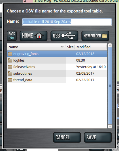

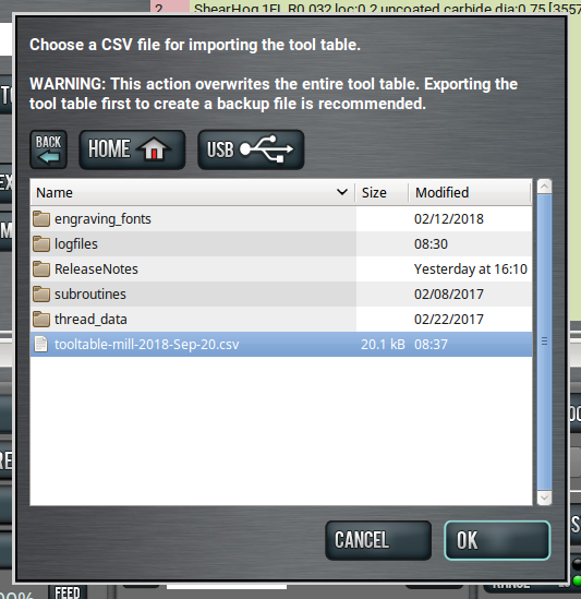

Figure 17: Export and Import buttons on the Offsets tab.
Import a .csv File
  4. From the Offsets tab, on the Offsets Table tab, select Import.
Figure 18: Import dialog box.
  1. From the Offsets tab, on the Offsets Table tab, select Export.
Figure 19: Export dialog box.
  2. Select Save.
  4. Select Eject.

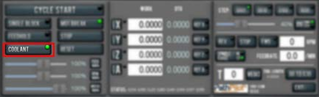

Operate the Coolant Pump
To turn coolant on or off:
  • Select Coolant.
Figure 20: Coolant button.
About Coolant
