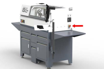

  2. Rotate the Emergency Stop button one-quarter turn clockwise to release it.
Figure 3: Emergency Stop button.

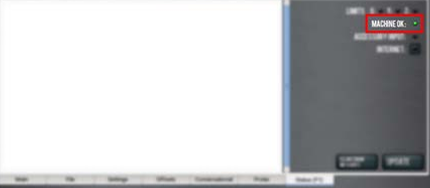

  1. Verify that the blue Reset LED comes on. From the PathPilot interface, on the Status tab, verify that the Machine OK light changes from yellow to green.
    Once both are on, the machine is powered on and ready to operate.
Figure 5: Machine OK light on the Status tab.

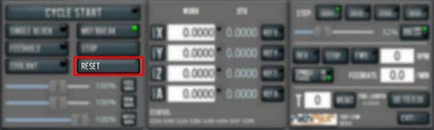

  1. Select Reset.
Figure 6: Reset button.
This initializes the connection between the machine and controller.

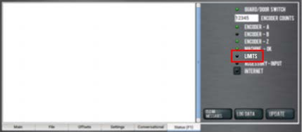

Verify Limit Switch Function
You must confirm that the limit switches correctly operate.
  1. From the PathPilot interface, on the Status tab, identify the Limits light.
Figure 9: Limits light on the Status tab.
  1. Hold a piece of steel (like a screwdriver or a wrench) up to each limit switch. The red light on each limit switch is on until the steel is within sensing range, at which point the red light dims or turns off.
    From the PathPilot interface, on the Status tab, the Limits light comes on.

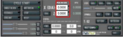

Verify Axes Function
You must confirm that the axes correctly operate.

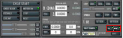

  1. Power on the machine and bring it out of Reset.
  2. Reference the axes: from the PathPilot interface, select Ref Z, Ref X.
Figure 10: Ref Z, Ref X, and Ref Y buttons.
The machine moves to the reference position.
  1. Use the keyboard to verify axes motion:
    1. Select the Up Arrow key and then the Down Arrow key.
      The carriage moves away from you (X+), then toward you (X-).
    2. Select the Right Arrow key and then the Left Arrow key.
      The carriage moves right (Z+), then left (Z-).

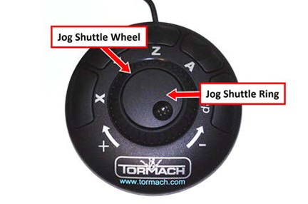

  2. If applicable, verify the optional Jog Shuttle:
    1. Press any axis button on the Jog Shuttle — X, Y, Z, or A — to select an axis.
Figure 11: Functions on the optional Jog Shuttle.
From the PathPilot interface, on the Main tab, the corresponding green Axis light comes on.
Figure 12: Axis lights.
b. Turn the Jog Shuttle Ring in any direction to move the selected axis, then turn it in the opposite direction to reverse the direction.

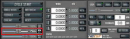

  1. From the PathPilot interface, confirm that the Spindle Override slider isn't set to 0% (when it's set to 0%, the slider is yellow). To clear the override, select RPM 100%.
Figure 13: Spindle Override slider.
NOTE: The Spindle Override slider changes the programmed spindle speed by a specific percentage. If it's set to 0%, the spindle won't move during the following steps in this procedure. For information, see "About Spindle Override".

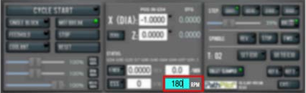

  1. From the PathPilot interface, in the RPM DRO field, type 180. Then select the Enter key.
  2. Select FWD.
Figure 14: Spindle controls.
The spindle rotates clockwise at 180 rpm.
  1. Examine the spindle direction: verify that it's rotating counterclockwise, as shown in the following image.
Figure 15: Spindle rotating counterclockwise, in the correct forward direction.

  1. Push the Emergency Stop button to lock it into the disabled position.
Figure 7: Emergency Stop button.
With the Emergency Stop button in the disabled position all motion and spindle function stops, the Reset button is disabled , and the blue Reset LED goes off. From the PathPilot interface, on the Status tab, the Machine OK light illuminates yellow.
