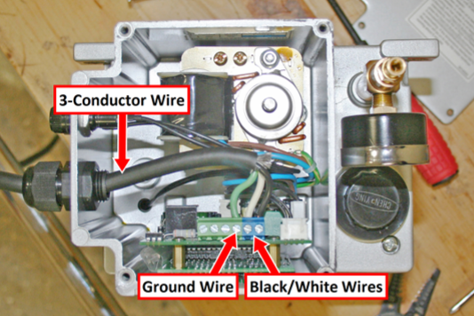

  2. Put the 3-conductor wire through the pre-installed cord grip assembly as shown in the following image.
Figure 1: 3-conductor wire connected to the automatic oiler.
  1. Use a wire stripper (or similar) to remove two inches of the 3-conductor wire insulation.
  2. Use a wire stripper to remove 1/4 inch of the wires, and then connect them.
  3. Gently pull the 3-conductor wire away from the automatic oiler to remove the slack. Stop pulling when the 3-conductor wire is snug. Then, tighten the nut.

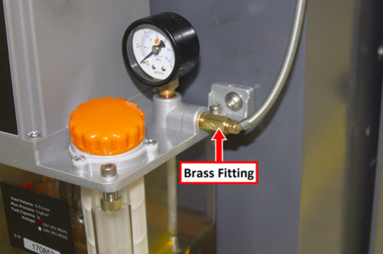

  4. Remove the brass fitting from the automatic oiler.
Figure 2: Brass fitting on the automatic oiler.

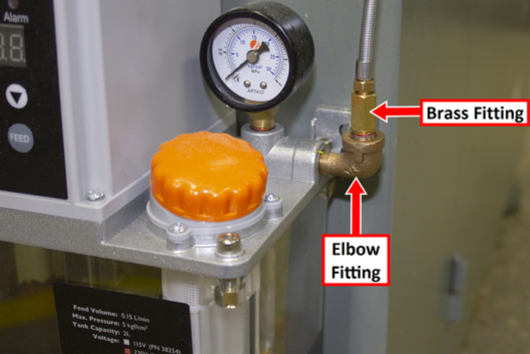

  1. Connect the brass fitting to the elbow fitting. Then, install the elbow fitting on the automatic oiler as shown in the following image.
Figure 3: Elbow fitting installed on the automatic oiler.

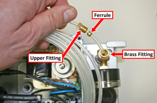

  1. Use the upper fitting and the ferrule from the automatic oiler’s brass fitting to attach the clear nylon tubing. Then, use an 8 mm wrench to tighten it.
Figure 4: Clear nylon tubing and the hardware to attach it.

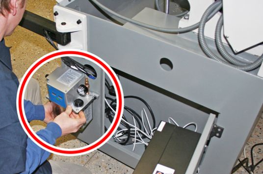

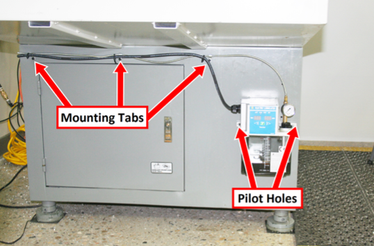

  2. On the left-hand side of the stand (under the chip pans), locate the pilot holes for mounting the automatic oiler.
  3. Use a Phillips screwdriver to attach the automatic oiler to the stand with two M6 × 16 mm screws, two M6 lock washers, and two M6 nuts.
  4. Use three M5 × 10 mm screws to attach three mounting tabs to the stand.
Figure 5: Automatic oiler installed on the stand.
  1. Put the 7 in. cable ties through the mounting tabs, and then secure the 3-conductor wire and oil tube in the mounting tabs.

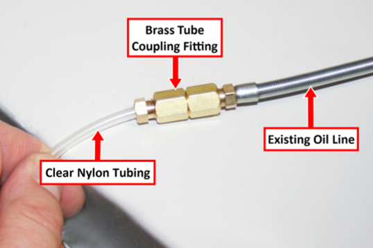

  2. To extend the existing oil line, connect it to the brass tube coupling fitting and clear nylon tubing from the automatic oiler.
Figure 6: Extending the existing oil line.

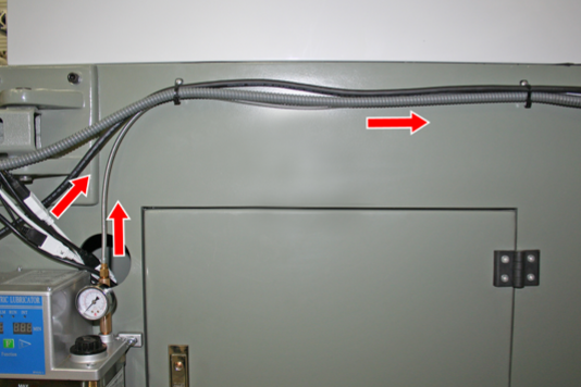

  1. Carefully route the line around the back of the mill. Make sure that it doesn’t come in contact with any moving parts.

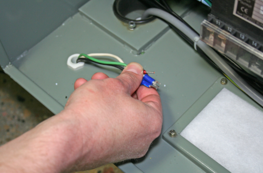

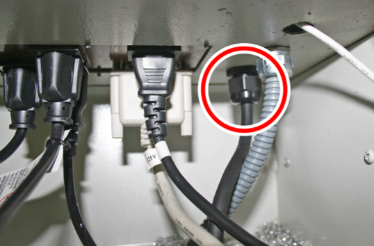

  2. Use the cord grip to put the 3-conductor wire through bottom of electrical cabinet’s knockout hole. Then, tighten it with the cord grip nut.
Figure 7: Automatic oiler's 3-conductor wire in the electrical cabinet.
NOTE: If the cord grip doesn’t fit in the knockout hole, use a 7/8 in. drill to enlarge the hole.

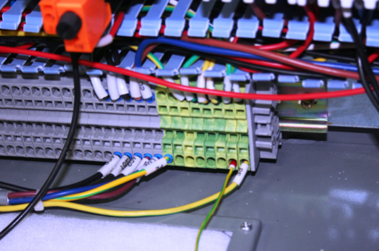

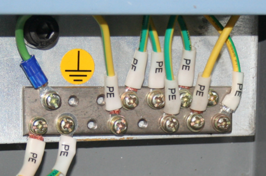

  1. Older machines are equipped with a ground bar, while newer machines have a green ground terminal block section. Identify the ground connection specific to your machine.
Figure 8: Examples of a ground bar and ground terminal block.

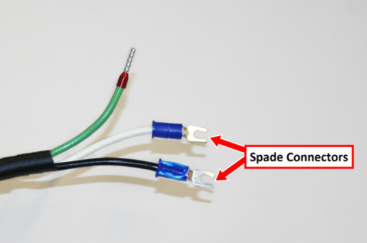

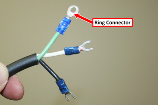

  1. Use a wire stripper to remove 1/4 in. of the insulation on the black and white power wires to expose bare metal.
  2. Crimp the spade connectors to the black and white power wires.
Figure 9: Spade connectors crimped on the power wires.
  1. Based on the ground connection that you identified in Step 9, do one of the following:
    1. Ground Terminal Block Use the pre-mounted ferrule; go to Step 13.
    2. Ground Bar Clip off the ferrule, remove 1/4 in. of the insulation on the wire, and then crimp on the ring connector, as shown in the following image.
Figure 10: Ring connector crimped on to the ground wire.

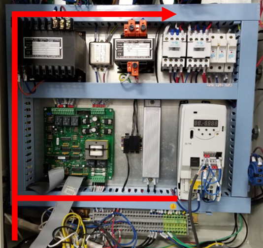

  1. Inside the mill’s electrical cabinet, remove the required wire trough covers, and set them aside.
Figure 11: Wire routing inside the electrical cabinet.
    1. Ground Bar Route the green wire through the lower wire trough, and connect it to any ground bar terminal screw.
    2. Ground Terminal Block

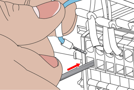

      1. Route the green wire through the lower wire trough.
      2. Slowly insert the end of a small, flat-blade screwdriver straight into any slot in the green section of the terminal block.
Figure 12: Use a flat-blade screwdriver to open the terminal clip and insert the wire.
iii. Gently pry the terminal clip open, and then insert the wire into the terminal block.
iiii. Slowly remove the screwdriver.

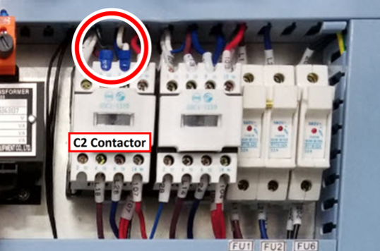

  1. Route the black and white power wires through the wire troughs to C2 contactor.
  2. Loosen the screw terminals below wires L13 and L23. Regardless of C2-wire orientation, connect the black wire to the L13 screw terminal and the white wire to the L23 screw terminal.
Figure 13: Black and white wires connected to the C2 contactor.
  1. Tighten the screws on C2 contactor.

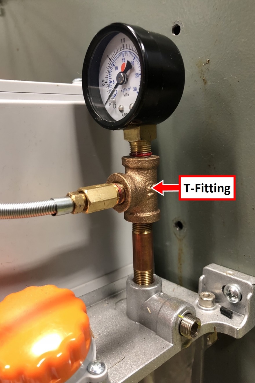

  1. Install the T-fitting on the automatic oiler as shown in the following image
Figure 3: T-fitting installed on the automatic oiler.

  1. To extend the existing oil line, connect it to the brass tube coupling fitting and clear nylon tubing from the automatic oiler.
Figure 7: Extending the existing oil line.

  2. Route the 3-conductor wire from the automatic oiler through the pre-installed cord grip in the bottom of the electrical cabinet.
Figure 8: Automatic oiler wires routed through the cord grip in the electrical cabinet.
Figure 9: Examples of a ground bar and ground terminal block.
Figure 10: Spade connectors crimped on the power wires.

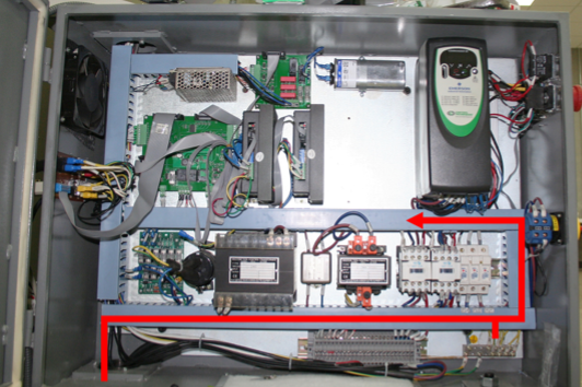

  1. Inside the electrical cabinet, remove the required wire trough cover and set aside.
Figure 12: Wire routing inside the electrical cabinet.
Figure 13: Use a flat-blade screwdriver to open the terminal clip and insert the wire.
Figure 14: Black and white wires connected to the C2 contactor.

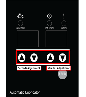

  1. Refer to About the Automatic Oiler for recommended interval and actuation times.
  2. On the oiler's control panel, push and hold either of the Minutes Adjustment buttons. It doesn't matter which button you push.
Figure 1: Automatic oiler control panel.
The oiler beeps.
  1. While looking at the Minutes display, do one of the following:
  • To increase the interval time, push the Up Arrow. We recommend that you set it to 480 minutes (eight hours).
  • To decrease the interval time, push the Down Arrow.
  2. On the oiler's control panel, push and hold either of the Seconds Adjustment buttons. It doesn't matter which button you push.
    The oiler beeps.
  3. While looking at the Seconds display, do one of the following:
  • To increase the interval time, push the Up Arrow. We recommend that you set it to 12 seconds.
