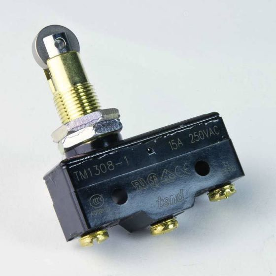

  2. Locate the physical switches on the machine and manually activate them while watching the LEDs in PathPilot.
    1. If the switches illuminate their respective status light, they are working; inspect the limit switch flags.
    2. If a switch doesn’t illuminate its status light, continue to the next step.
    3. If a switch illuminates multiple status lights, continue to the next step.
    4. If a status light stays on even when the switch isn’t depressed, continue to the next step.
  3. On the machine control board, located the J2 connecter and use a small piece or wire to jump the 414 wire to the 409 (X-axis), 410 (Y-axis), 411 (Z-axis) while watching the LEDs in PathPilot.
    (info) If you have a status light that stays on, remove the 409 (X-axis), 410 (Y-axis), 411 (Z-axis) before testing with the jumper.
    1. If one of the status lights doesn’t illuminate, replace the machine control board.
    2. If the status lights illuminate correctly, continue to the next step.
  4. Locate the malfunctioning limit switch, take a picture for future reference, and then remove the wires with a screwdriver.
  5. With the switch in its normal state (not depressed), measure the resistance across the switches NC (normally closed) and C (common) terminals with digital multimeter set to resistance.
    1. If the digital multimeter reads OL, shows a resistance in the MΩ, and/or doesn’t produce continuity tone, replace the switch.
    2. If the switch measure 0-5 Ω, continue to the next step.
  6. With the switch depressed, measure the resistance across the switches NC (normally closed) and C (common) terminals with digital multimeter set to resistance.
    1. If the switch measure 0-5 Ω, replace the switch.
    2. If the digital multimeter reads OL, shows a resistance in the MΩ, and/or doesn’t produce continuity tone, reinstall the switch.
  7. Inspect the wiring on the malfunctioning switch for loose ferrules, terminal connections, fraying, or broken line.
