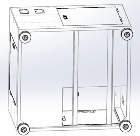

Attaching Feet

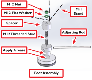

NOTE: Attach Feet to Stand after pallet is removed and while Stand is still on its side (see Figure 1).
Figure 1
  1. Apply multi-purpose grease to the locations indicated in Figure 2 and join them together.
  2. Insert M12 Threaded Stud into each foot and slide on Spacers (see Figure 2).
  3. Attach feet to Stand using assembly shown in Figure 2.
  4. Carefully return Stand so it rests on feet and position at installation location.
  5. If Stand is in its final location, level Stand using a carpenter’s level. Adjustments to Feet are made using Adjusting Rod to increase or decrease height on each corner (see Figure 2).
Figure 2

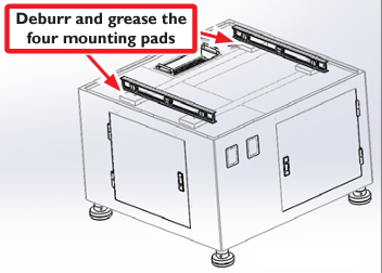

  1. Deburr and grease four mill mounting pads to prevent rust (see Figure 3).
Figure 3

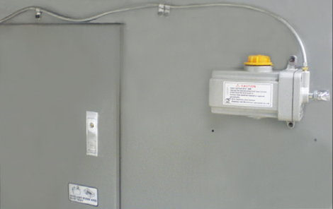

Installing Manual Oiler
  1. Route oil line (pre-installed at back of mill near Y-Axis motor) down back of stand and along left side as shown in Figure 4.
  2. Mount manual oiler and tubing clips using pre-drilled holes (see Figure 4); connect oil line.
Figure 4
  1. Fill manual oiler reservoir with ISO VG68 Machine Oil (PN 31386).
  2. Retract and release plunger until oil is pushed through system. After that pull plunger:
    1. Each time mill is powered on
    2. Every four hours of operation

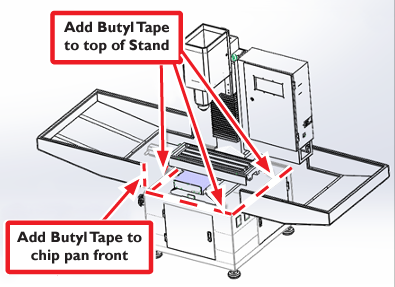

  1. Position chip pans near stand and test fit. Left Chip Pan and Right Chip Pan are different.
  2. Seal joints between stand and chip pans with Butyl Tape as indicated in Figure 5 prior to installing Left Chip Pan and Right Chip Pan. It is best to apply Butyl Tape and install one chip pan at a time.
Figure 5
  1. Use 11 M6 x 10 mm Screws to attach Right Chip Pan to stand.
  2. Use 10 M6 x 10 mm Screws to attach Left Chip Pan to stand.
  3. Add a strip of Butyl Tape where chip pans meet in front. Use two M6 x 10 mm Screws and two M6 Nuts to join together chip pans.

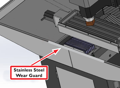

  4. After chip pans are installed, use two M6 x 10 mm Screws, two M6 Flat Washers, and two M6 Nuts to attach Stainless Steel Wear Guard across front (see Figure 6).

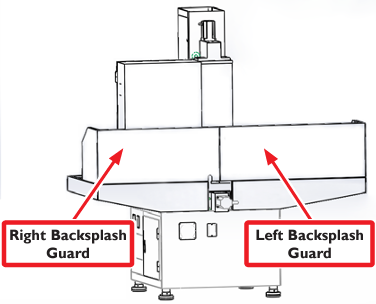

  1. Position backsplash guards near stand and test fit; Left Backsplash Guard and Right Backsplash Guard are different (see Figure 7).
Figure 7
  1. Use five M6 x 10 mm Screws to attach Right Backsplash Guard to Right Chip Tray.
  2. Repeat step 2 for Left Backsplash Guard.
  3. Use two M6 x 10 mm Screws and two M6 Nuts to connect two backsplash guards at rear joint.
NOTE: Do not use Butyl Tape for the joint between the backsplash guards or between the backsplash guards and chip pans.
NOTE: If any holes on the backsplash guards do not line up, loosen surrounding screws as needed. Once all screws are started, tighten to approximately 3 ft-lbs of torque.

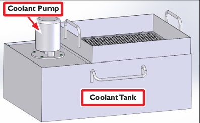

  1. Remove all parts from inside Coolant Tank (see Figure 8).
Figure 8

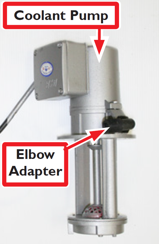

  1. Using four M5 x 12 mm Screws, mount Coolant Pump to Coolant Tank (see Figure 8).
NOTE: Coolant Pump is 115 VAC only.
NOTE: Wrap Elbow Adapter threads and Coolant Hose Adapter with thread seal tape (PTFE Tape).

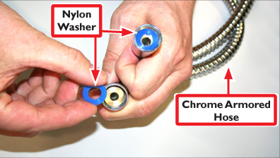

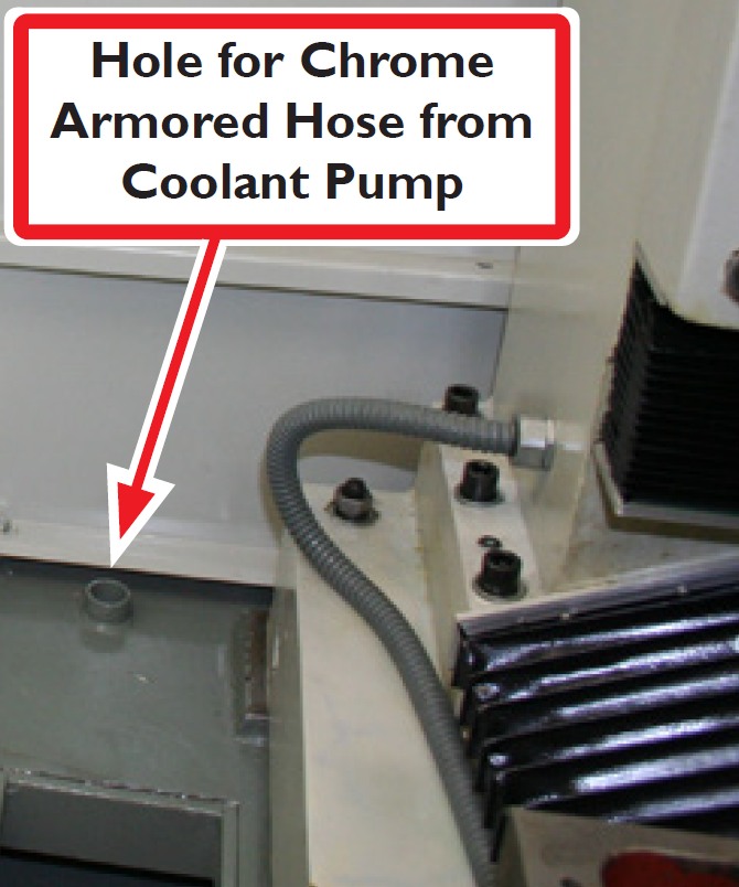

  1. Insert Nylon Washer into both ends of Chrome Armored Hose (see Figure 9).
Figure 9
  1. Insert Chrome Armored Hose through hole in Stand; connect to Elbow Adapter on Coolant Pump (see Figure 10 and Figure 11).
Figure 10
Figure 11

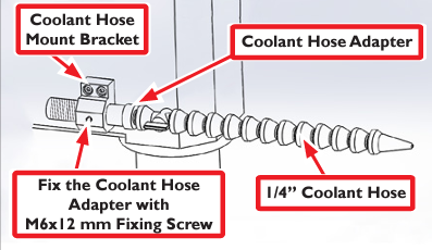

  1. Connect 1/4” Coolant Hose to Coolant Hose Adapter; insert into Coolant Hose Mount Bracket (see Figure 12).
  2. Connect Chrome Armored Hose to Coolant Hose Adapter.
  3. Using two M5 x 8 mm Pan Head Screws, attach Coolant Hose Mount Bracket to mill head.
  4. Using one M6 x 12 mm Fixing Screw, attach Coolant Hose Mount Bracket to Coolant Hose Adapter (see Figure 12).
Figure 12

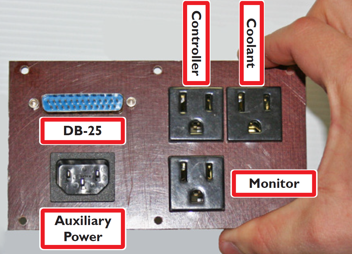

  1. Connect Coolant Pump’s 3-prong plug into outlet shown in Figure 13.
Figure 13
NOTE: Power Connection Panel is located on bottom of electrical cabinet.

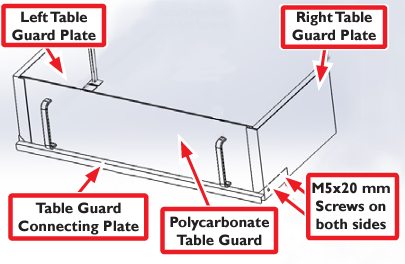

Installing Table Guard Kit

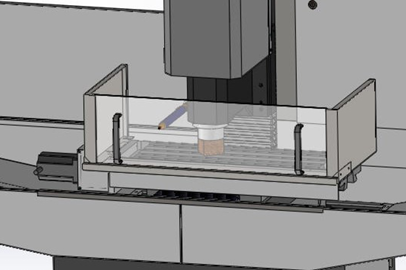

  1. Remove four set screws from the four corners of top of mill table and set aside.
  2. Insert Left Table Guard Plate and Right Table Guard Plate inside Table Guard Connecting Plate; fasten with four M5 x 20 mm Screws as shown in Figure 14.
  3. Slide Polycarbonate Table Guard into slots on guard plates (see Figure 14).
Figure 14
  1. Using four socket head cap screws, attach Table Guard Kit assembly onto mill table (see Figure 15) and fasten at locations indicated in step 1.
Figure 15
