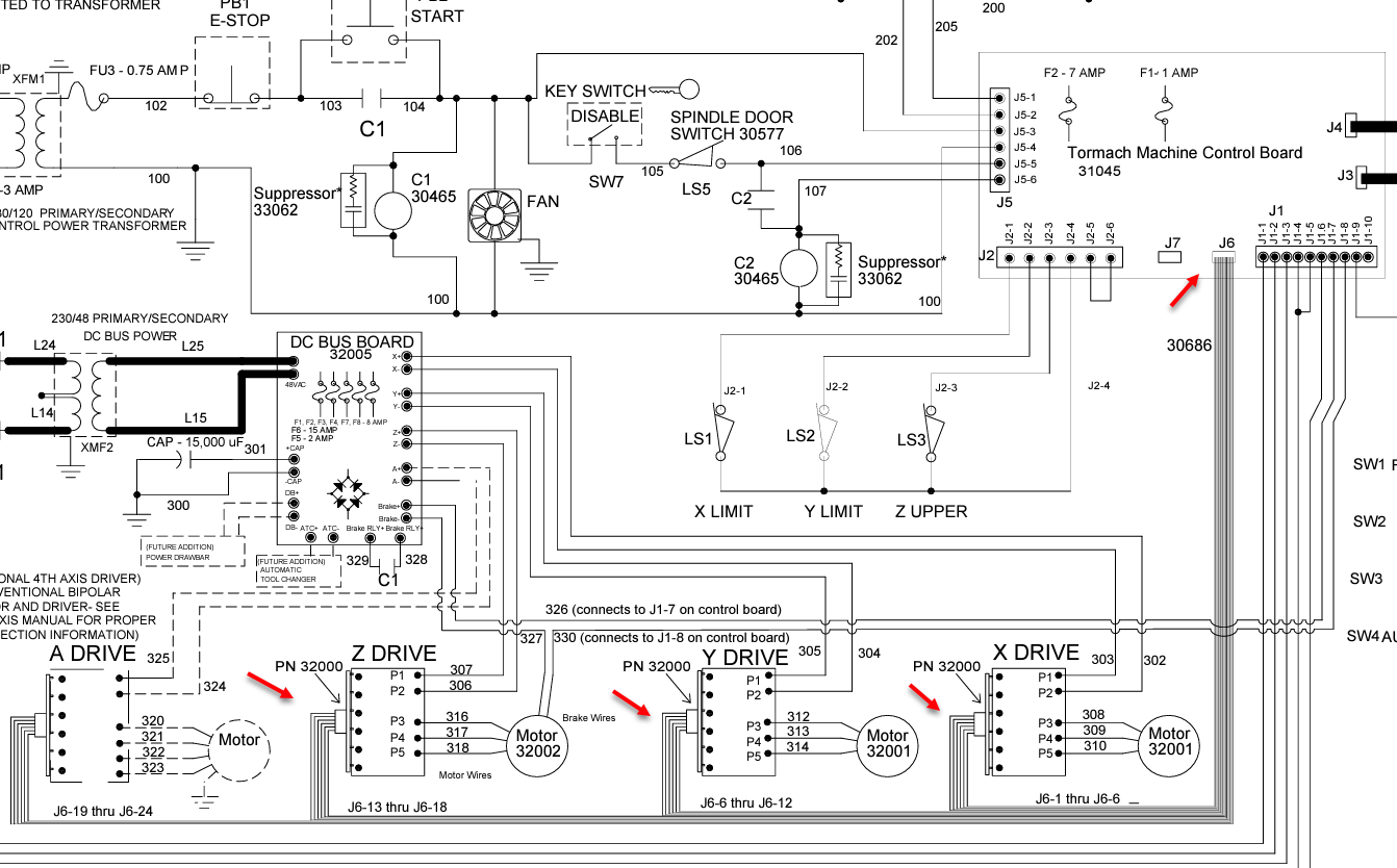

Reseat the Connectors on the Machine Control Board
Reason: Control signals aren’t reaching the electronic driver modules.
  1. Power off the machine.
      1. J6-1 - J6-6 (X-axis)
      2. J6-7 - J6-12(Y-axis)
      3. J6-13 - J6-18 (Z-axis)
PCNC 1100 J6 Ribbon Cable

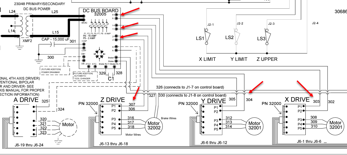

      1. 302/303 (X-axis)
      2. 304/305 (Y-axis)
      3. 306/307 (Z-axis)
PCNC 1100 Stepper Driver Power Wires
Inspect the Motor’s Drivers
Reason: There’s a defective or malfunctioning axis Driver/cable.
Full Stepper Driver Controller Swap (Full Driver Swap) image-20241113-202026.png NOTE: 4th AXIS DRIVERS CANNOT BE SWAPPED WITH SERIES 3 OR 'M' SERIES MACHINE DRIVERS. image-20241113-202026.png

Inspect the DC-Bus board
    1. If the green LED is not illuminated: Go to All Axes Won't Move When Commanded - PCNC 1100
