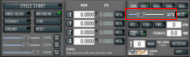

Jog the Machine
Figure 3: Jog button.
Figure 4: Jog Speed slider.
Figure 5: Step buttons (in G20 mode)
About Jogging
Jog the machine using the keyboard or the optional Jog Shuttle. Whether you're jogging with the keyboard or with the Jog Shuttle, you can either:
For more information, see "Jog Controls Reference".

Jogging in PathPilot
Jogging with the Keyboard
Jogging with the (Optional) Jog Shuttle
The optional Jog Shuttle has the following functions:
  • An inner wheel and outer ring that jog the currently selected axis.
    Rotating either clockwise jogs the axis in the positive direction.
    Rotating either counterclockwise jogs the axis in the negative direction.
  • Four axis selection buttons, which toggle the currently selected axis.
NOTE: The currently selected axis displays in PathPilot: in the Position Status group, there's a green light to the left of the Axis DRO field. When it's on, it indicates the active axis.
  • A step button, which toggles the selected jog step size.

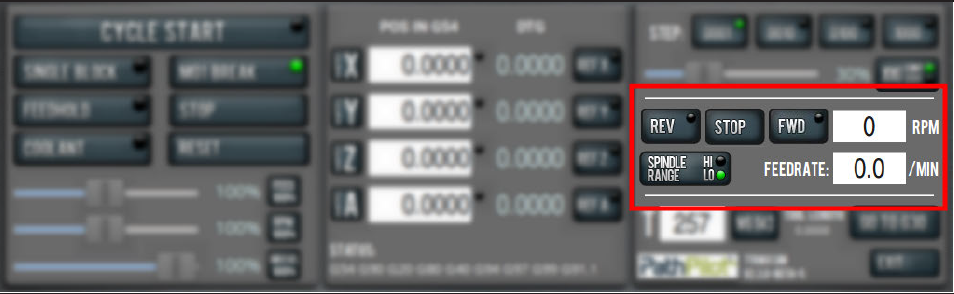

Manually Control the Spindle
  2. From the PathPilot interface, in the Manual Control area, locate the Spindle group.
Figure 6: Spindle group.
  1. Open the spindle motor door.
  2. Make sure that the spindle belt position agrees with your desired speed range. If it doesn't, do one of the following:
  1. Close the spindle motor door.
  2. In the RPM DRO field, type the desired RPM speed. Then select the Enter key.
  3. Select FWD to start the spindle in the forward direction.
  4. Select Stop to stop the spindle.
Change the Spindle Speed Range
To change the spindle speed range, you must move the spindle belt inside of the spindle cabinet:
  2. Unclamp the motor mounting plate: Use a hex wrench, and pull the motor forward.
  3. Move the spindle belt from one set of pulleys to the other.
  • Low 300 rpm to 4500 rpm
  • High 650 rpm to 10,000 rpm
  1. Secure the motor mounting plate: Push the motor back, and tighten with a hex wrench.
  2. Firmly push the spindle belt between the pulleys. If it is properly tensioned, the spindle belt should move between 3 mm and 6 mm. If it's not properly tensioned, repeat the steps in this section.
  3. Close the spindle motor door.
  4. From the PathPilot interface, examine the light on the Spindle Range button to make sure that it agrees with the spindle belt's position.
Figure 7: Spindle Range button.

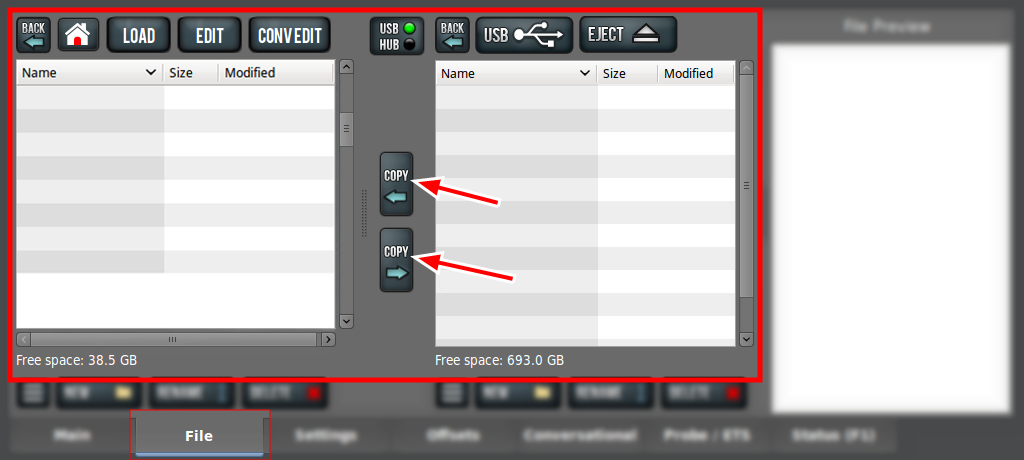

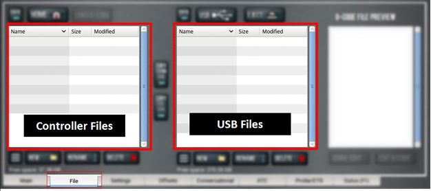

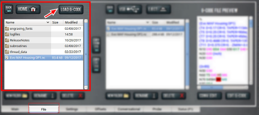

Load G-Code
To load G-code:
  2. Select Load G-Code.
Figure 8: Controller Files window on the File tab.
Figure 9: File tab.
  2. Select either Copy ← or Copy →.
Figure 10: File tab.
  1. If you're using a USB drive, select v.

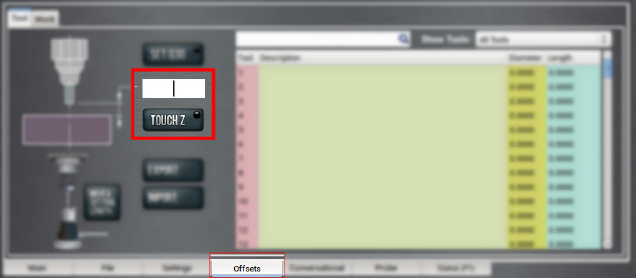

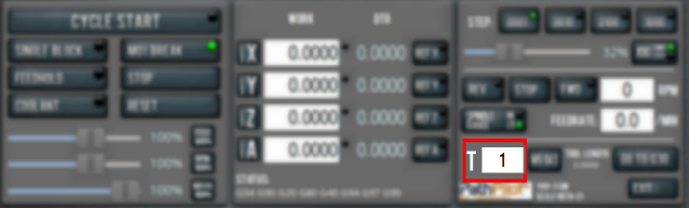

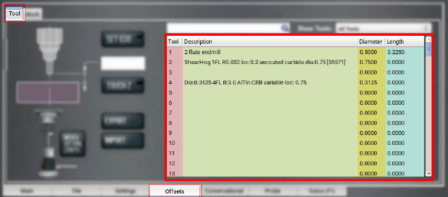

Set Tool Length Offsets
Before running a G-code program, PathPilot must know the length of the tools that are required for the program. For more information on using tool length offsets, see "About Tool Offsets" (page 10).
NOTE: You can import a .csv file with tool length offset data. For information, see Import and Export the Tool Table.
To set tool length offsets:
    For information, see "Set Up Tooling".
Figure 11: Tool Table window on the Offsets tab.
About Tool Offsets
The tool length offset is the distance from the cutting edge of the tool to the shoulder of the tool holder. To make sure tool length offsets are consistent among your tools, we recommend you use Tormach Tooling System (TTS) tool holders. Set the tool length offset after placing a tool in the Tormach Tooling System (TTS) tool holder — each tool and its tool holder only need to be measured once.

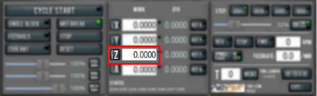

Set a Known Reference Height
  1. If there's already a tool in the spindle, remove it.
  2. From the PathPilot interface, in the Tool DRO field, type 0. Then select the Enter key.
  3. Slowly jog the Z-axis down (-Z) until it's 0.04 in. (1 mm) from the reference surface.
  4. Measure the thickness of a piece of paper, and put the paper on the reference surface. Note the thickness of the paper for later.
  5. While moving the paper back-and-forth across the reference surface, slowly step the Z-axis down (-Z) until you feel a light pull on the piece of paper. This indicates that the paper is contacting the spindle.
NOTE: It's easier to use step jogging for this task. For information on step jogging, see "About Step Jogging”.
Figure 12: Z-axis work offset DRO field.
Figure 13: Tool DRO field.
Figure 14: Touch Z DRO field and button.
  1. Select Touch Z.
    he length of the tool is stored in the Tool Table window.
  4. Jog the Z-axis up (+Z).

  4. From the PathPilot interface, on the Offsets tab, select the Tool tab.
  5. In the Tool Table window, type a description for the tool.
  6. Move the height gauge on the Tormach Tool Assistant Set to the end of the tool's cutting edge.
  7. Write down the measured tool length, and then type that value into the Length column on the Tool Table window. Then select the Enter key.

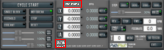

Set Work Offsets
  • Select Zero [Axis].
Figure 19: Work Offset DRO fields.
To change work offsets:
Figure 20: Work offset indicated in the PathPilot interface.
For more information on using work offsets, see "About Work Offsets”.
About Work Offsets
Work Offset Naming
Offsets 1-9 (Use either name)
Offset
Extended Name
Name
G54.1 P1
G54
G54.1 P2
G55
G54.1 P3
G56
G54.1 P4
G57
G54.1 P5
G58
G54.1 P6
G59
G54.1 P7
G59.1
G54.1 P8
G59.2
G54.1 P9
G59.3
Offset
Extended Name
Name
G54.1 P10
Not used
11
G54.1 P11
Not used
499
G54.1 P499
Not used
500
G54.1 P500
Not used

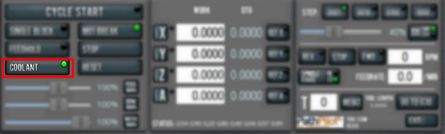

Operate the Coolant Pump
To turn coolant on or off:
  • Select Coolant.
Figure 21: Coolant button.
About Coolant
