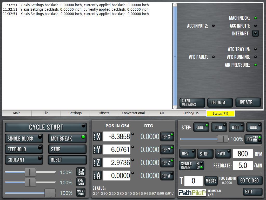

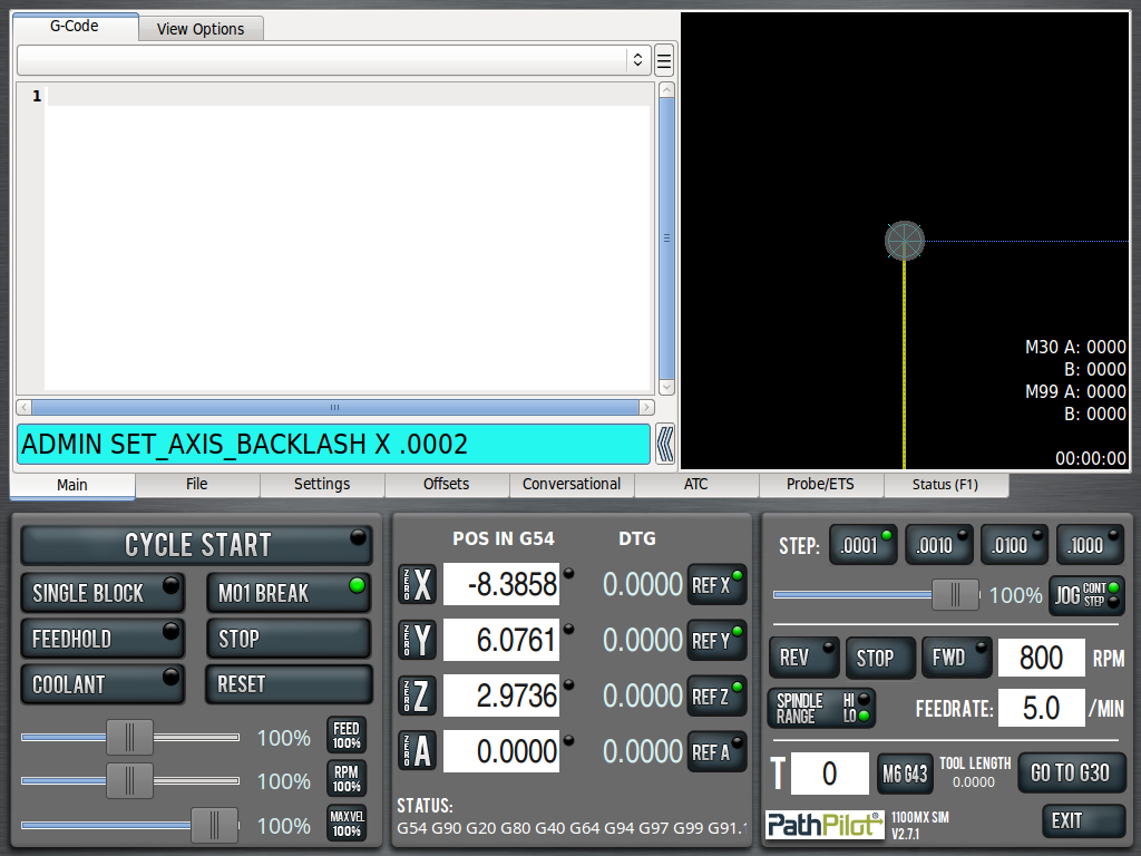

Backlash Compensation
Note: There is no backlash compensation for the A axis.
