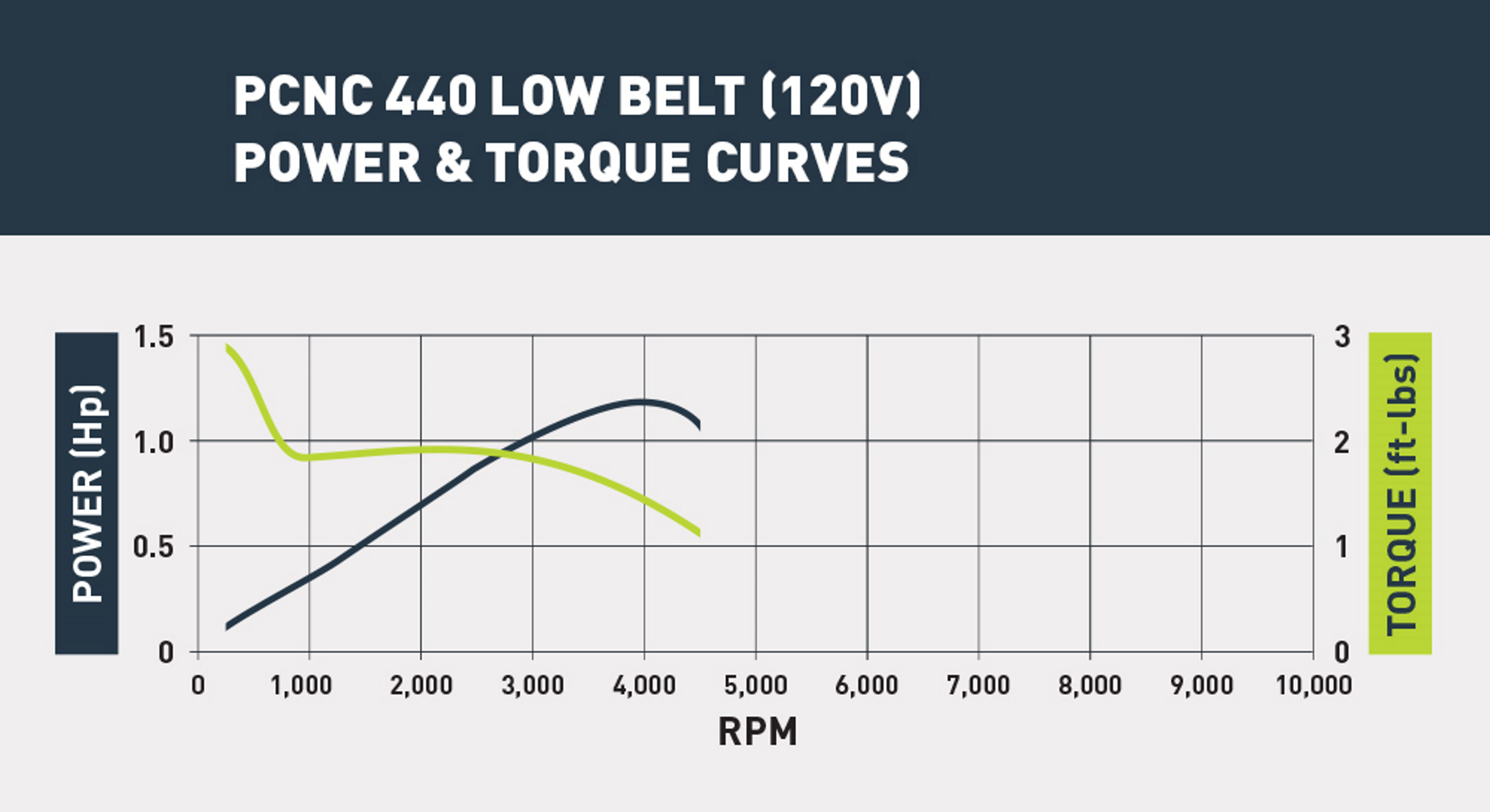

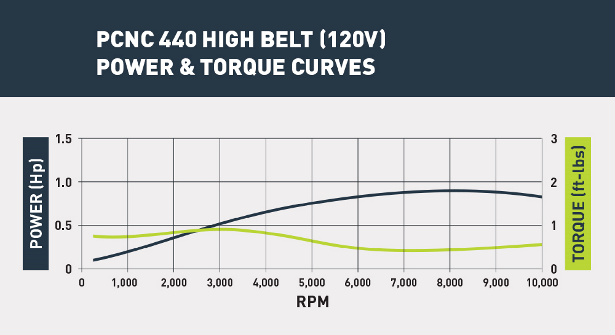

PCNC 440 Torque Curves
Shown below are the results of motor testing done on the PCNC 440 spindle.
Low Belt Position
High Belt Position
