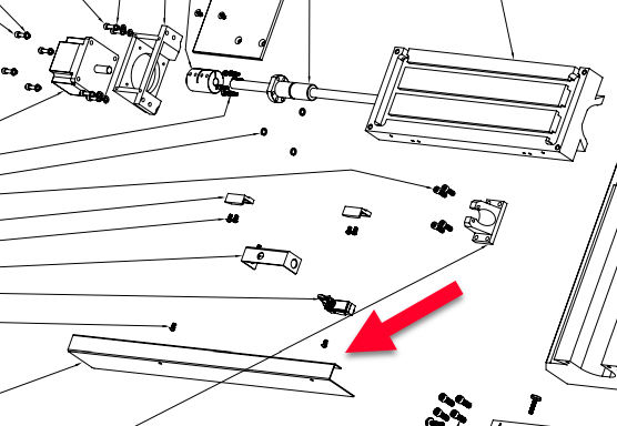

  1. Remove the stainless steel X-axis limit switch guard.

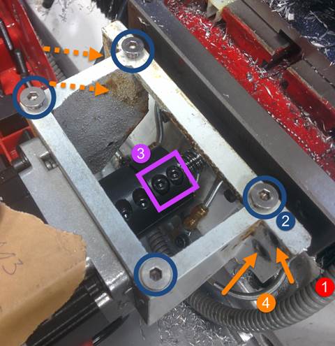

  1. Remove the X-axis motor cover by removing the 4 flat-head cap screws.
  2. Detach the ball screw side of the motor coupling by loosening the two socket head cap screws.
  3. Remove the X-axis motor mount assembly by removing the four socket head cap screws securing the mount casting to the table.

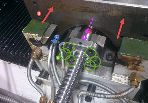

  1. Carefully slide the table to the right to expose the ball nut mount.
  2. Detach the ball nut from the ball nut carrier casting by removing the six socket head cap screws.
  3. Carefully remove the x-axis ball nut oil distribution line from the ball nut.
  4. Remove the x-axis ball screw assembly from the machine.
