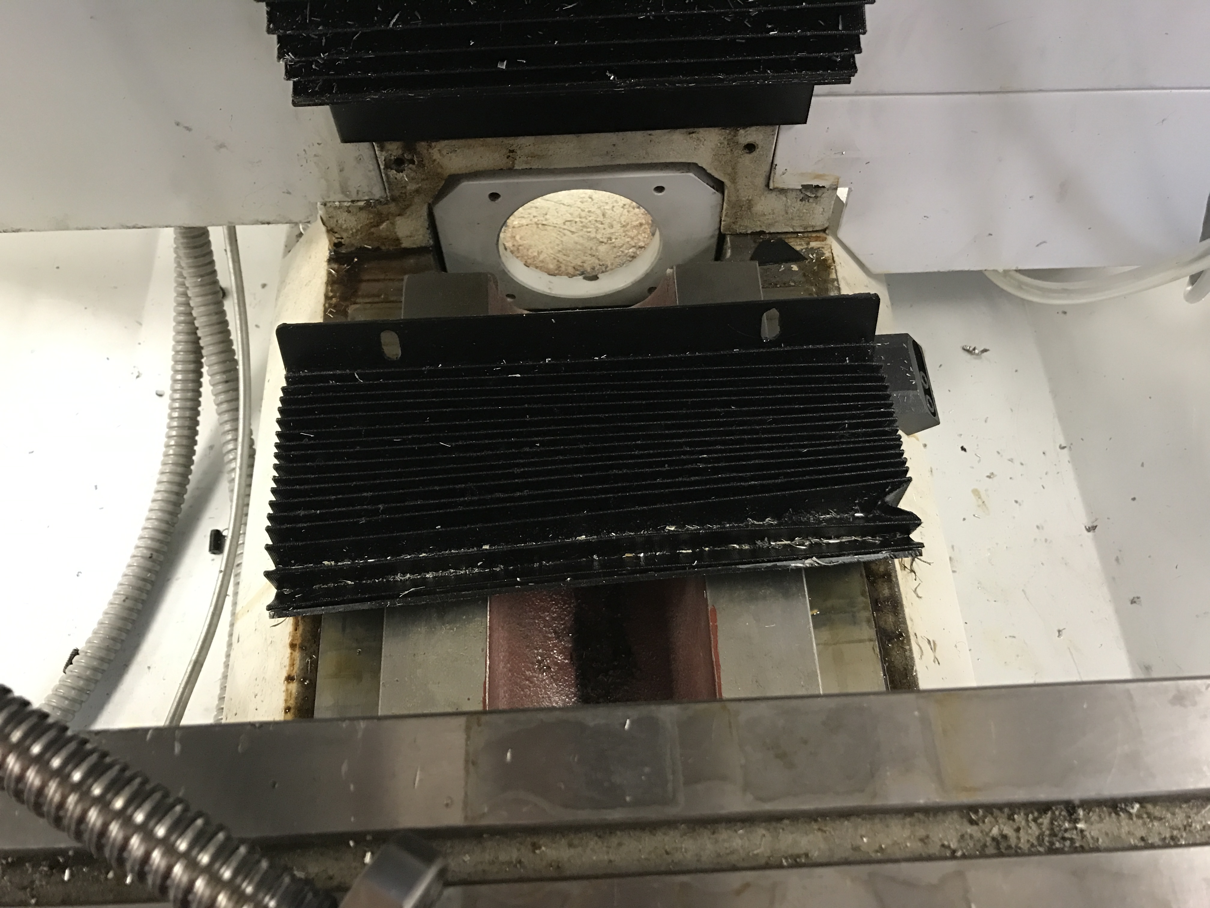

  1. Unscrew rear bellows from rear of Y axis  to expose the motor coupler next to the column, and the ball nut mounting screws next to the table.

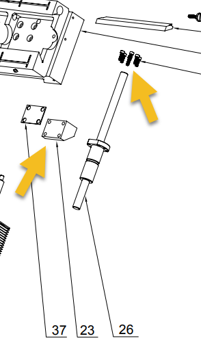

  1. Dismount the ball nut from the ball nut saddle by backing out the 6 SHCS from the rear of the table.

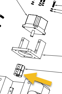

  1. Decouple the lead screw from the motor by backing out the 2 SHCS from the ball nut side of the coupler.

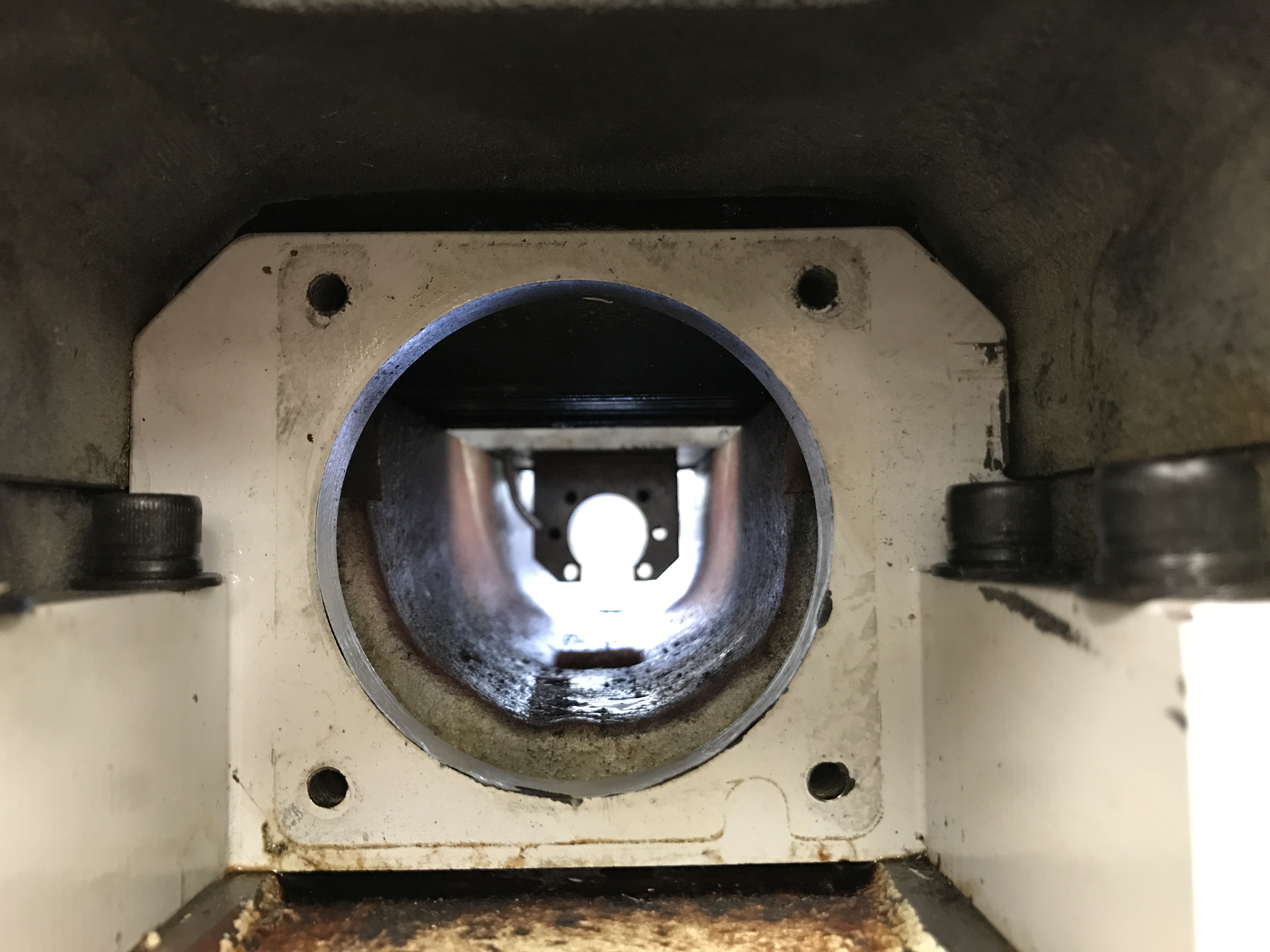

  1. Dismount the Y axis motor by backing out the four SHCS holding the motor to the casting, and pull it out of the way - be careful not to stress the motor wire leads.  It should slide off the ball screw.
  2. The Ball Screw and Ball Nut are now  free to be removed. Make sure the Ball Nut oil line is not obstructing the Ball Nut itself. Slide the ball screw assembly out the back of the machine.
