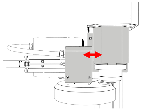

  2. Pull the bracket toward the front of the machine. You'll make adjustments to the location of the bracket later in this procedure, but we recommend starting with it moved forward.

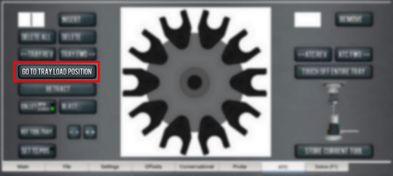

Prepare the Machine
Figure 9: Tool tray moved in toward the spindle.
Figure 10: Linear bearing flush with the ATC main assembly.

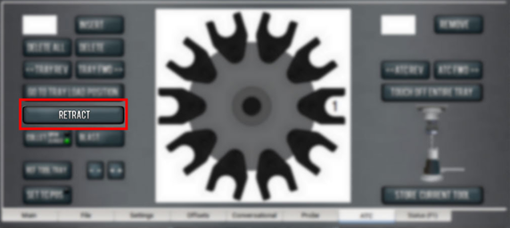

    3. Press the Reset button.

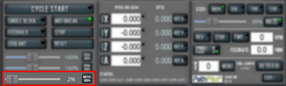

  2. Verify that the ATC is all the way forward (toward the spindle), and then slowly move the Z-axis down (-Z) to examine the clearance of the carousel door opening.
  3. Verify that the carousel door opening is approximately equal to the front back and left of the spindle mounting flange:
Figure 14: Distance between the carousel door opening and the spindle mounting flange.
Figure 15: Socket head cap screws securing the ATC main assembly to the mounting bracket.
Repeat this step as needed.
  1. Tighten the socket head cap screws and the flange nuts (if you loosened them in Step 5).
  2. Move the tool tray to its retracted position.

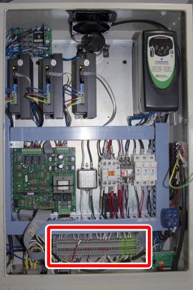

  2. Open the electrical cabinet door.

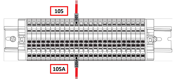

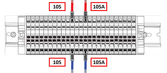

  3. Locate blue wires 105 and 105A on the terminal block in the electrical cabinet.
Figure 17: Current wire configuration on the terminal block.
  1. Remove blue wires 105 and 105A.
  2. Locate red wire 105A on the terminal block. Then, remove it.
NOTE: During the original procedure to install the Power Drawbar, wire 105 was given a new label, making it wire 105A.
  1. Connect red wire 105A to the slot opposite red wire 105 on the terminal block.
Figure 18: New wire configuration on the terminal block.

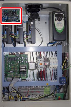

  1. Remove the wire trough covers in the electrical cabinet.
  2. Identify wires T1 and B5 on the ATC Legacy Adapter Cable. Then, route them through the wire troughs toward the variable frequency drive (VFD).

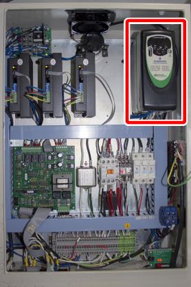

Figure 21: VFD in the electrical cabinet.

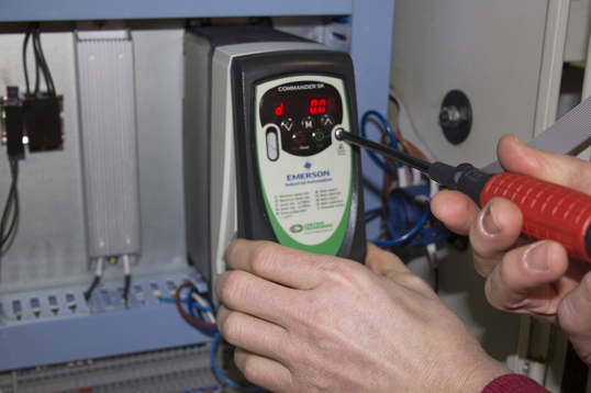

  1. Use a Phillips screwdriver to remove the cross-head screw on the VFD, and then remove the VFD faceplate.
Figure 22: Removing the faceplate from the VFD.

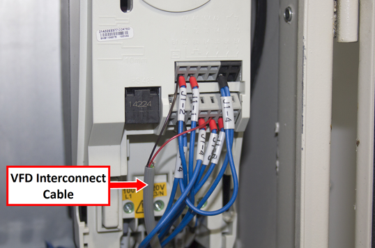

  1. If you previously installed the Power Drawbar board, you must remove the VFD interconnect cable. Identify it on the VFD and remove it. Then, pull the loose cable out of the machine, and discard it.
Figure 23: VFD interconnect cable connected to the VFD.

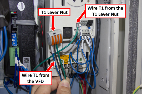

  1. Remove wire T1 from the VFD, and then insert it in to the open slot in the T1 lever nut on the ATC Legacy Adapter Cable.
NOTE: If you have an (optional) load meter, your VFD has an extra wire in slot T1. Remove it from the VFD, and then insert it into the remaining open slot in the T1 lever nut on the ATC Legacy Adapter Cable.
  1. Completely push the lever down on the T1 lever nut to latch the wire. Verify that the lever is latched.
  2. Connect the loose wire from the T1 lever nut in to slot T1 on the VFD.
Figure 25: T1 lever nut connected to slot T1 on the VFD.

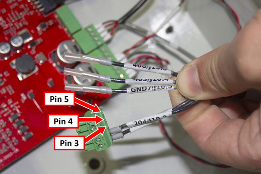

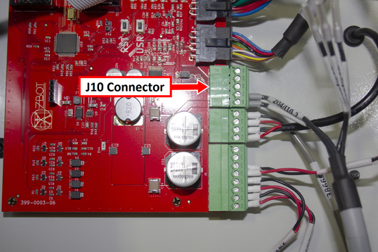

Rewire the ATC Board
  1. Unlock and open the lid on the ATC main assembly with a large, flat-blade screwdriver.
  2. Identify the J10 connector on the ATC board, and then unplug it from the board.
Figure 28: J10 connector on the ATC board.
  1. Identify the loose ends of wires 403, 408, and GND.
Figure 29: Loose wires on the J10 connector from the ATC board.
  1. Remove the plastic wire protectors from the ferrule ends.
  2. Use a small, flat-blade screwdriver to connect the following wires to the J10 connector:
    1. Wire 408 to pin 3
    2. Wire 403 to pin 4
    3. Wire GND to pin 5 (depending on the age of your ATC, the GND wire may already be grounded to the ATC box. If so, there is no need to connect it to the ATC board.)
  3. Plug the J10 connector back in the ATC board.
  4. Close the lid on the ATC main assembly and lock it.

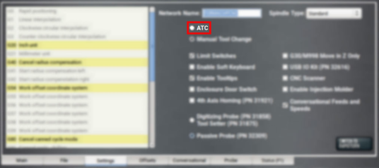

  1. If you have not yet done so, you must make sure that the PathPilot controller is updated to the latest version of PathPilot: From the Status tab, select Update. Then, follow the on-screen instructions.
  2. From the PathPilot interface, on the Settings tab, select the ATC radio button.
Figure 30: ATC radio button on the Settings tab.

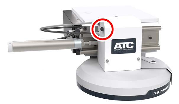

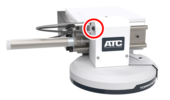

    1. Push and hold the open button on the side of the ATC.
Figure 31: Collet open button on the side of the ATC.
The collet opens.
c. Release the button.
The collet closes.

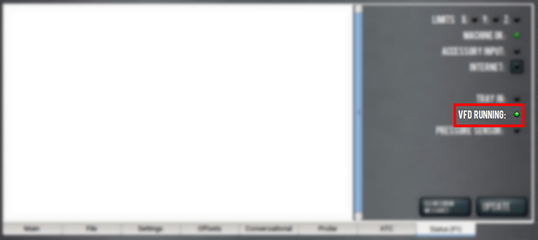

  1. From the Status tab, make sure that the VFD Running green light comes on.
Figure 32: VFD Running light on the Status tab.
NOTE: If the VFD Running light did not come on in the previous step, we can help. Create a support ticket with Tormach Technical Support at tormach.com/how-to-submit-a-support-ticket for guidance on how to proceed.

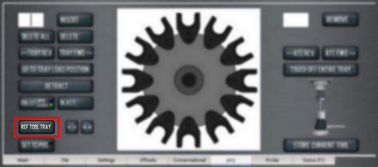

  2. From the PathPilot interface, on the ATC tab, select Ref Tool Tray.
Figure 37: Ref Tool Tray button on the ATC tab.
The tool tray spins.
NOTE: You're only required to reference the tool tray once, unlike the mill axes’ referencing procedure.
  1. Select Go to Tray Load Position.
Figure 38: Go to Tray Load Position button on the ATC tab.
  1. When prompted, select OK.
    The tool tray moves forward.

  1. From the PathPilot interface, select Go to Tray Load Position.

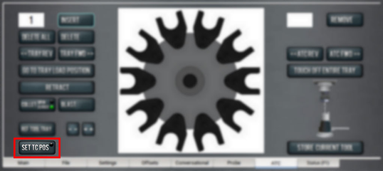

Set the Tool Change Height
Figure 41: Set TC POS button on the ATC tab.

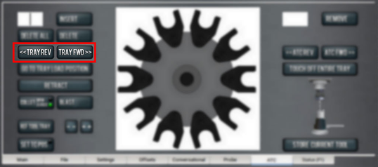

There's a small amount of rotational play built into the Automatic Tool Changer (ATC) carousel. This play allows for some misalignment during tool changes, and you must adjust for it in both directions. The taper on the tool shank also helps align the tool during a tool change.
To adjust for rotational play:
  1. From the PathPilot interface, on the ATC tab, select Tray Fwd to rotate the tray clockwise (forward) one full tool slot.
Figure 42: Tray FWD and Tray REV buttons on the ATC tab.
  1. Select Tray Rev to rotate the tray counterclockwise (backward) one full tool slot.

  1. From the PathPilot interface, on the Main tab, drag the Maxvel Override slider to the left. This reduces the maximum velocity by the percentage shown.
Figure 43: Maxvel Override slider on the Main tab.
  1. Do a test tool change. Because the maximum velocity is reduced, it's easier to verify the alignment of the ATC and stop the machine if further adjustment is required.
Tip! Use the Spacebar key to pause the tool change, if needed.

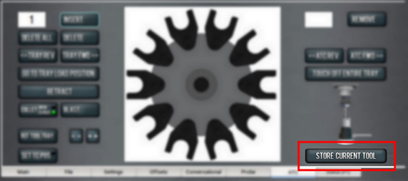

Assign Tool Numbers

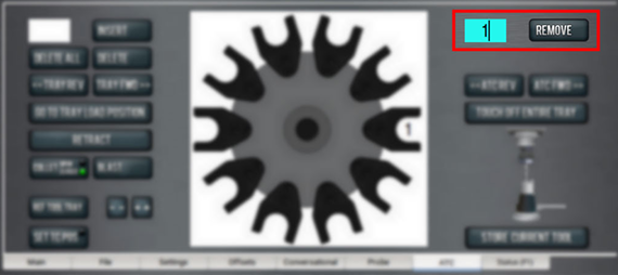

  3. Select Store Current Tool.
  1. Click Retract.
  1. Select Remove.
  1. Select Retract.
Figure 5: Collet open button on the side of the ATC.
The collet opens.
  2. Release the button.
    The collet closes.
NOTE: If installed, the Power Drawbar button's functionality is replaced by the button on the ATC.

  1. From the PathPilot interface, on the ATC tab, select Go To Tray Load Position.
Figure 6: Go to Tray Load Position button on the ATC tab.
  1. Load a tool into an open fork on the tray.

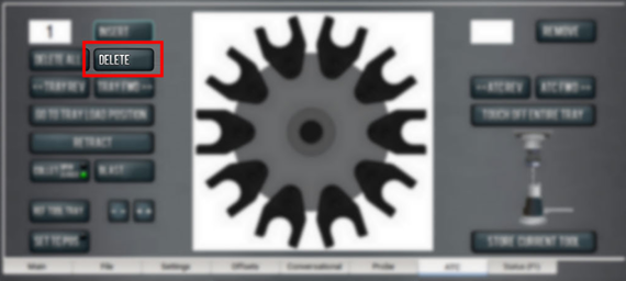

  3. Select Delete.
Figure 7: Delete button on the ATC tab.
  1. Select Retract.

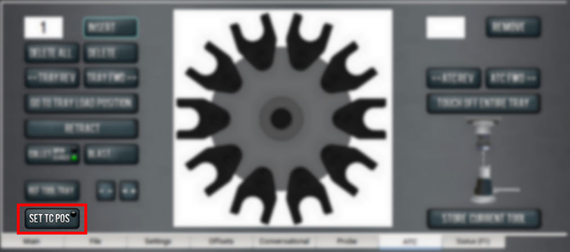

Figure 8: Set TC POS button on the ATC tab.

From the PathPilot interface, on the Settings tab, select the Manual Tool Change radio button.
