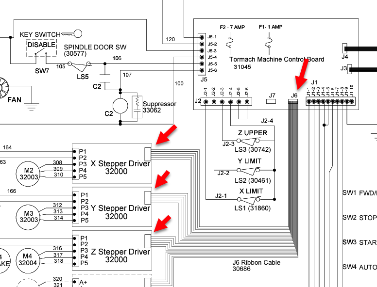

Reseat the Connectors on the Machine Control Board
Reason: Control signals aren’t reaching the electronic driver modules.
  1. Power off the machine.
      1. J6-1 - J6-6 (X-axis)
      2. J6-7 - J6-12(Y-axis)
      3. J6-13 - J6-18 (Z-axis)

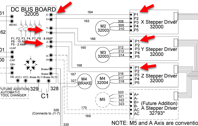

      1. 163/164 (X-axis)
      2. 165/166 (Y-axis)
      3. 167/168 (Z-axis)
PCNC 770 Stepper Driver Power Wires
Inspect the Motor’s Drivers
Reason: There’s a defective or malfunctioning axis Driver/cable.
Full Stepper Driver Controller Swap (Full Driver Swap) image-20241113-202026.png NOTE: 4th AXIS DRIVERS CANNOT BE SWAPPED WITH SERIES 3 OR 'M' SERIES MACHINE DRIVERS. image-20241113-202026.png

Inspect the Motor
  2. Remove the motor leads from the axis stepper driver controller, and examine the motor for signs of coolant or contamination.
  3. Based off of the chart, measure the resistance of windings at the green connector on the axis driver.

X
308
308
309
309
310
310
0.5-2.0 Ω
Each wire
>1 M Ω or OL
Y
312
312
313
313
314
314
0.5-2.0 Ω
Each wire
>1 M Ω or OL
Z
316
316
317
317
318
318
0.5-2.0 Ω
Each wire
>1 M Ω or OL
Resistance across leads on all phases for X, Y and Z should be about the same. Deviation may indicate a problem. This does not apply to the A-axis.
