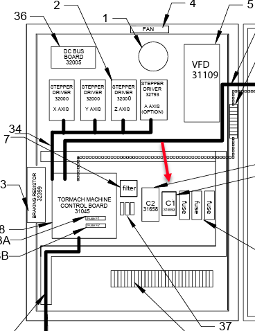

Your machine axes require power and control signals to work. If either of those are disrupted you can lose any or all of your axes motion. If only one motor is not working go to, One Axis Won't Move (or Only Moves in One Direction), and Other Axes Move - PCNC 770.

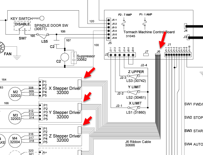

  1. Inspect the stepper driver controller lights.
    1. Some controller lights are on: One Axis Won't Move (or Only Moves in One Direction), and Other Axes Move - PCNC 770.
    2. All the controller lights are off: Continue to the next step.
  2. Power off the machine.
  3. Examine the data cable at the machine control board and the axes drivers.
      1. J6-1 - J6-6 (X-axis)
      2. J6-7 - J6-12 (Y-axis)
      3. J6-13 - J6-18 (Z-axis)
PCNC 770 J6 Ribbon Cable
PCNC 770 Main Control Board and Driver Locations

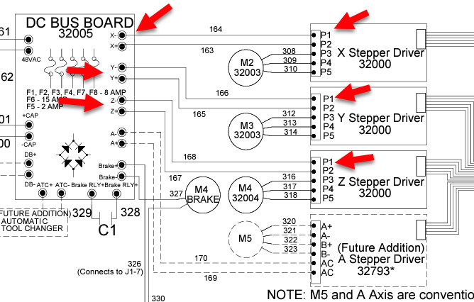

      1. 163/164 (X-axis)
      2. 165/166 (Y-axis)
      3. 167/168 (Z-axis)
PCNC 770 Stepper Driver Power Wires

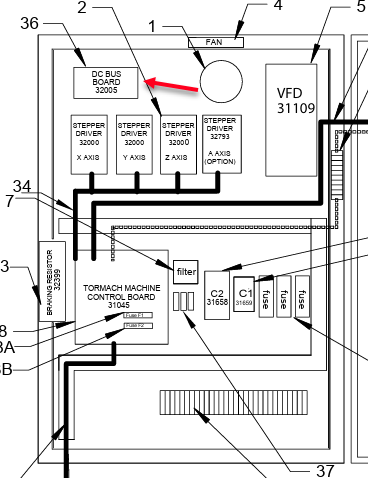

PCNC 770 DC-BUS Location

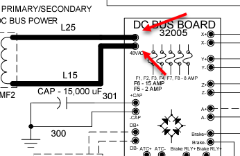

Inspect the DC-BUS board
Reason: The DC-BUS is malfunctioning.
    1. If it does: The stepper driver controllers will be illuminated, if the DC Bus Axis Fuses are not blown. To learn how to check individual fuses, see: One Axis Won't Move (or Only Moves in One Direction), and Other Axes Move - PCNC 770 | Inspect-the-DC-Power-Supply
    1. L25
    2. L15
PCNC 1100 DC-BUS

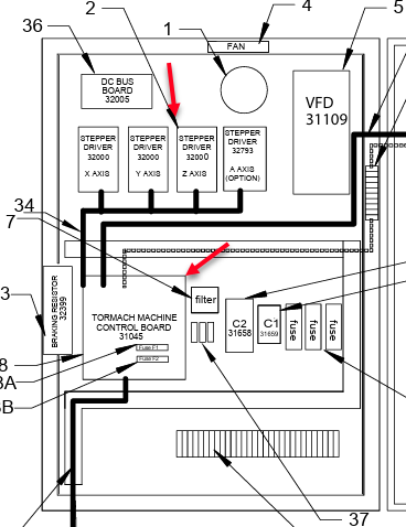

Inspect the Transformer
Reason: The transformer is shorted
  1. Power off the machine.
  2. Remove 161 and 162 from the transformer.
PCNC 770 Transformer Location

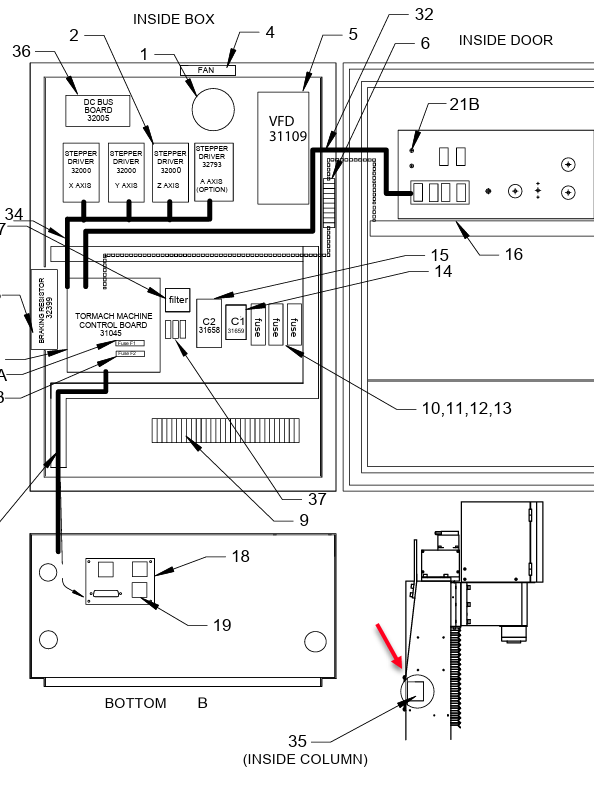

Check the C1 Contactor
Reason: The C1 is defective.
  2. Inspect the C1 to see if the center bar has been pulled in.
    1. If bar is in: The C1 is latched. Using a digital multimeter set to Vac, measure for 120 Vac between:
      1. 160
      2. 100
PCNC 770 C1 Location
  1. Press and hold the Reset button on the operator box and observe the C1. Then release the Reset button and observe the C1.
    1. If the bar only stays in when the button is pressed: There is a loose coil wire, short, or the C1 has malfunctioned.
    2. If the bar never gets pulled in: See Machine Won't Power On - PCNC 770
