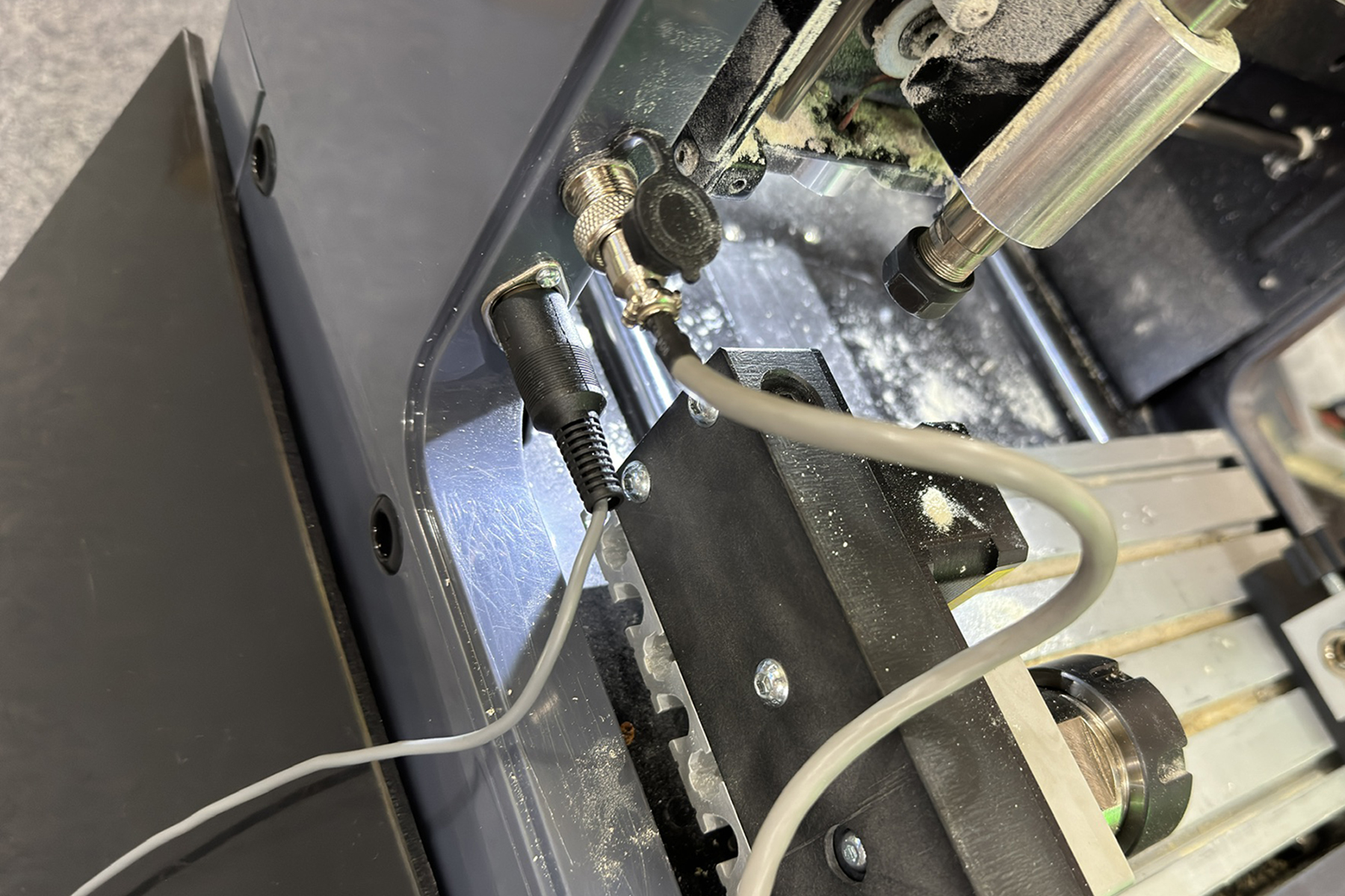

  3. Connect the loose ends of both cables from the rotary axis to the 4- and 5-pin DIN connectors on the front of the xsTECH. Note: The 5-pin homing sensor should be unplugged after referencing the A-Axis.
Figure 1: Cables plugged in to the DIN connectors.

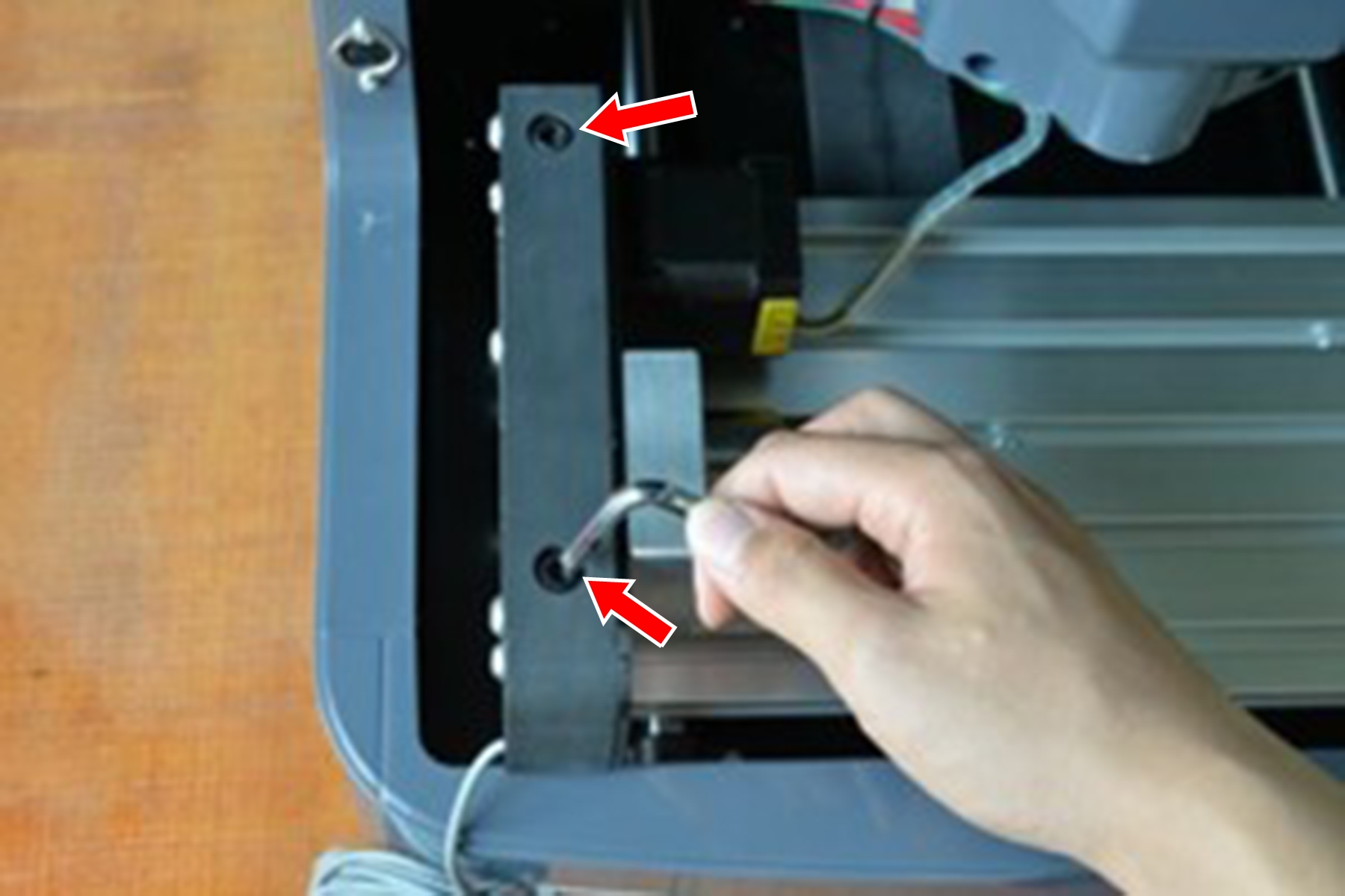

  1. Slide the T-nuts on the bottom of the rotary axis into the T-slots on the left end of the machine table.
Figure 2: Sliding the rotary axis into the machine table's T-slots.

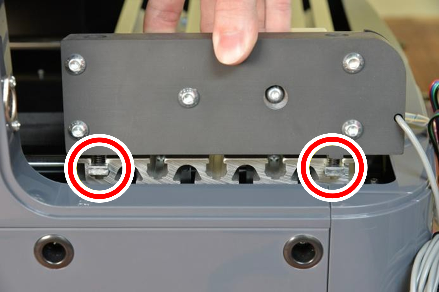

  1. Tighten the two screws on the top of the rotary axis with the included 5 mm hex wrench.
Figure 3: Screws securing the rotary axis to the machine table.

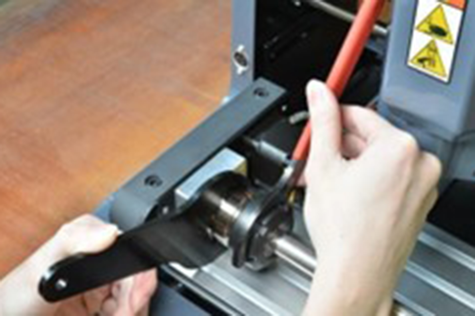

  1. Install the 16 mm collet and the ER32 collet nut into the rotary axis spindle:
      Figure 4: A collet inserted into the collet nut.
    2. Tilt up the collet to snap it into place.
      Figure 5: The collet tilted into place.
    3. Loosely thread the nut on the spindle.

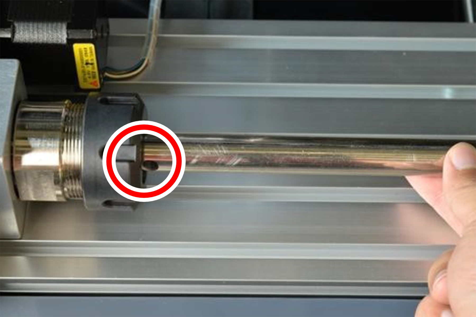

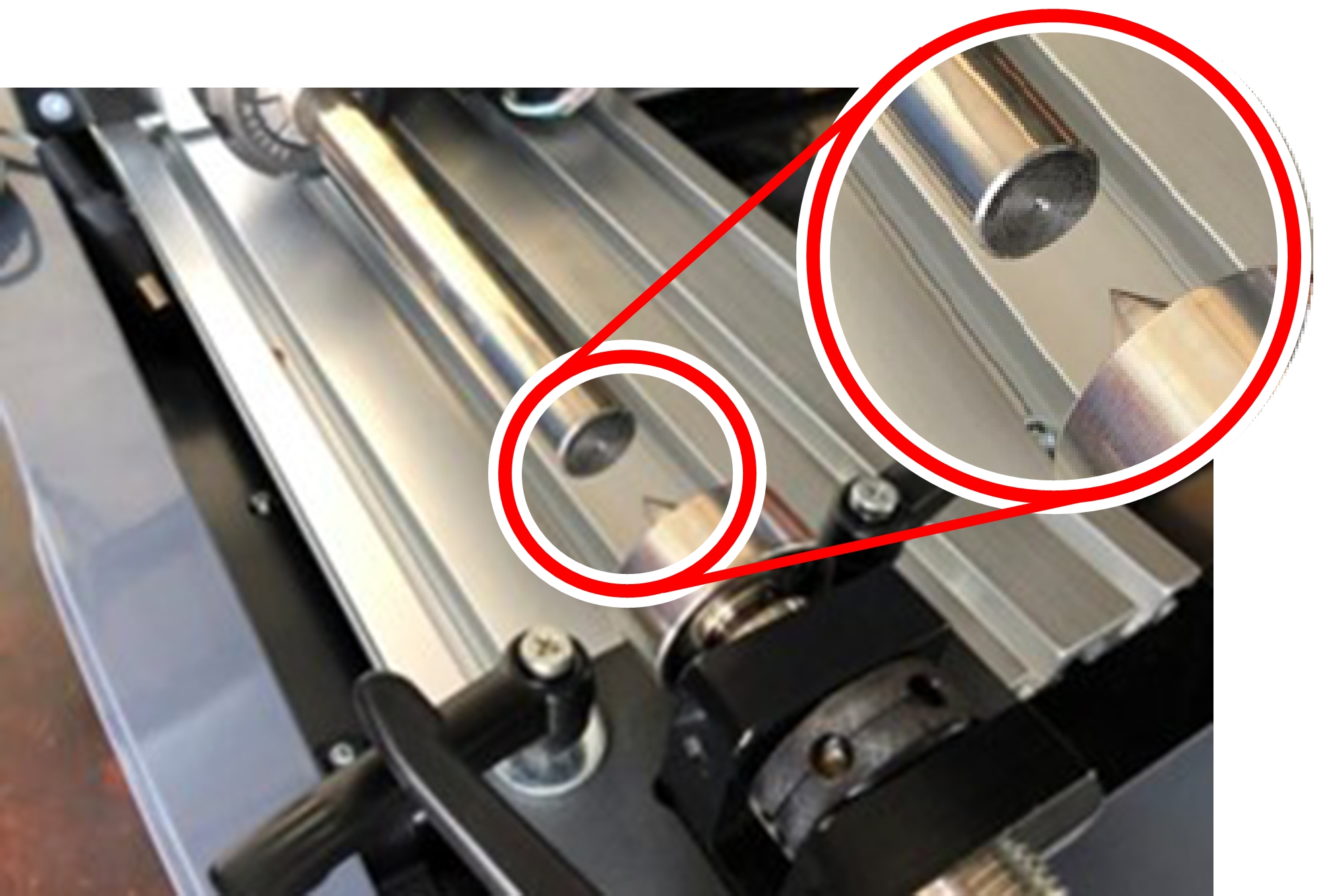

  2. Identify the setup bar that's included with this kit. On one end, there's a small hole, which is used to align the tailstock with the spindle. Insert the setup bar into the spindle so that the hole is toward the right side of the machine table, and so that about 1/2 in. of the bar is inside the collet.
Figure 6: Setup bar in the spindle.
  1. Use the two included wrenches to lock the setup bar in the spindle. If needed, manually rotate the chuck to align the flats with the wrench.
Figure 7: Locking the setup bar in the spindle.

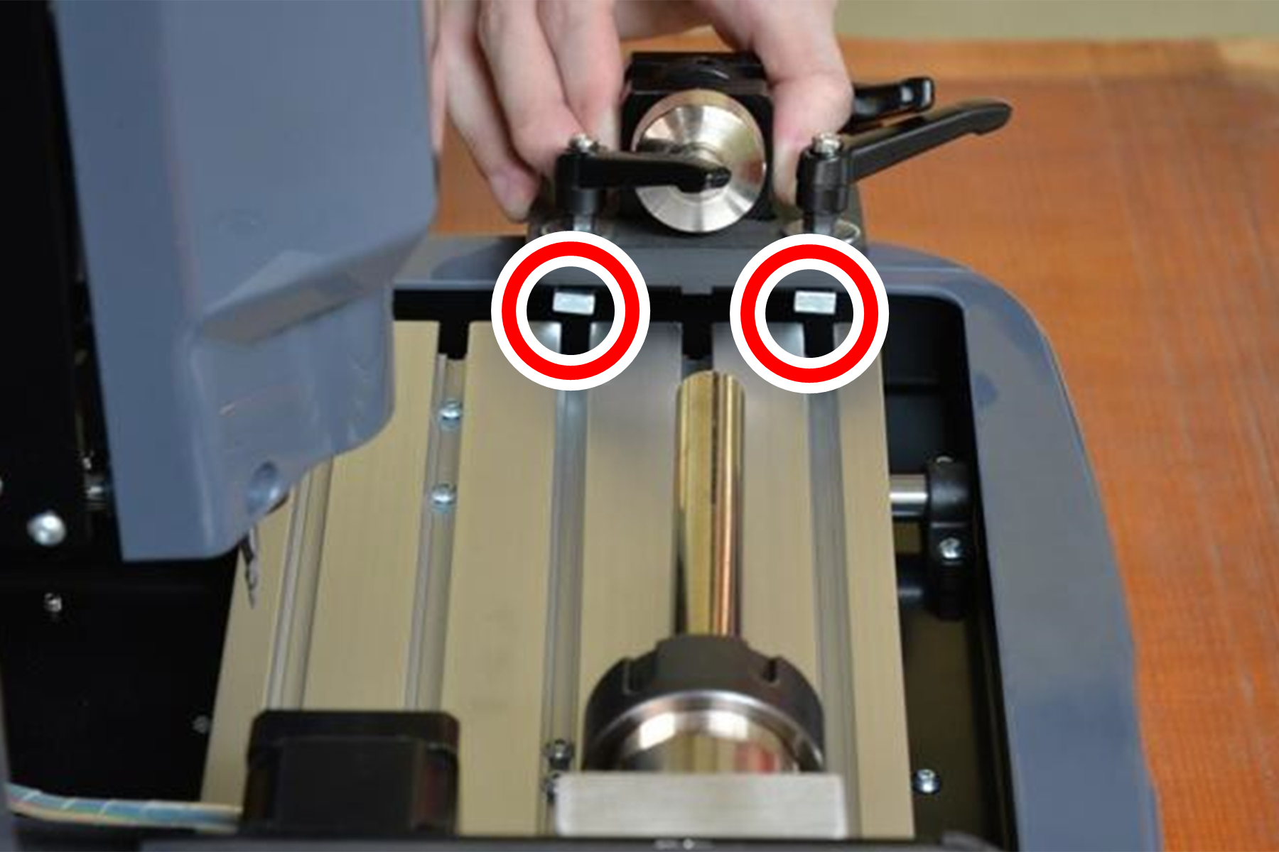

  1. Slide the T-nuts on the bottom of the tailstock into T-slots on the right end of the machine table.
Figure 8: Sliding the tailstock into the machine table's T-slots.
NOTE: If it's difficult to align the T-nuts with the T-slots, you can temporarily remove them from tailstock and slide them into the T-slots. Then, place the tailstock on the machine table over the T-nuts, and reinstall the T-nuts onto the tailstock.

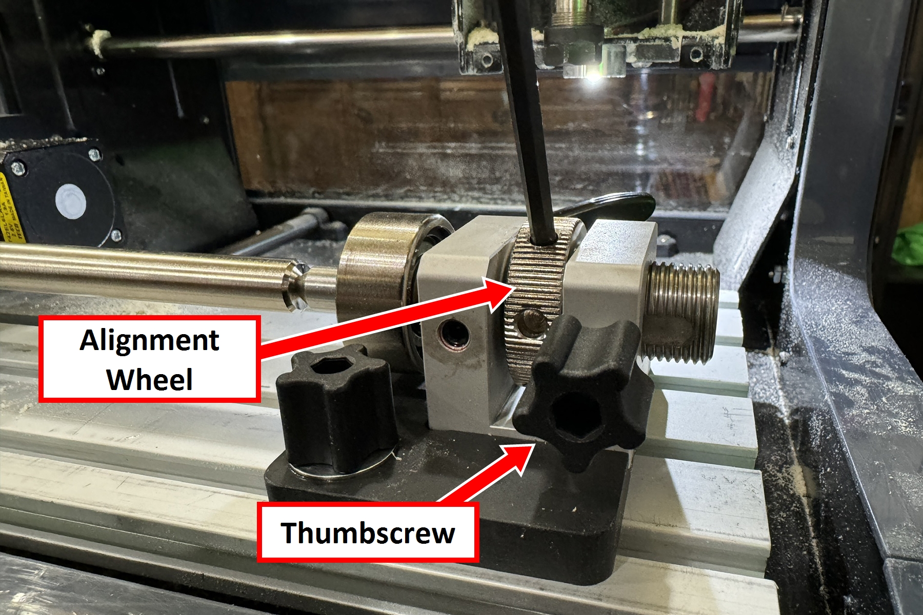

  1. Align the hole on the setup bar with the tailstock.
Figure 9: Aligning the setup bar with the tailstock.
  1. Using the setup bar tool, rotate the adjustment wheel to extend the tailstock center about 1/2 in. Then, move the tailstock itself toward the setup bar until there's no movement in the setup bar, and tighten the thumb screw.
Figure 10: Alignment wheel.

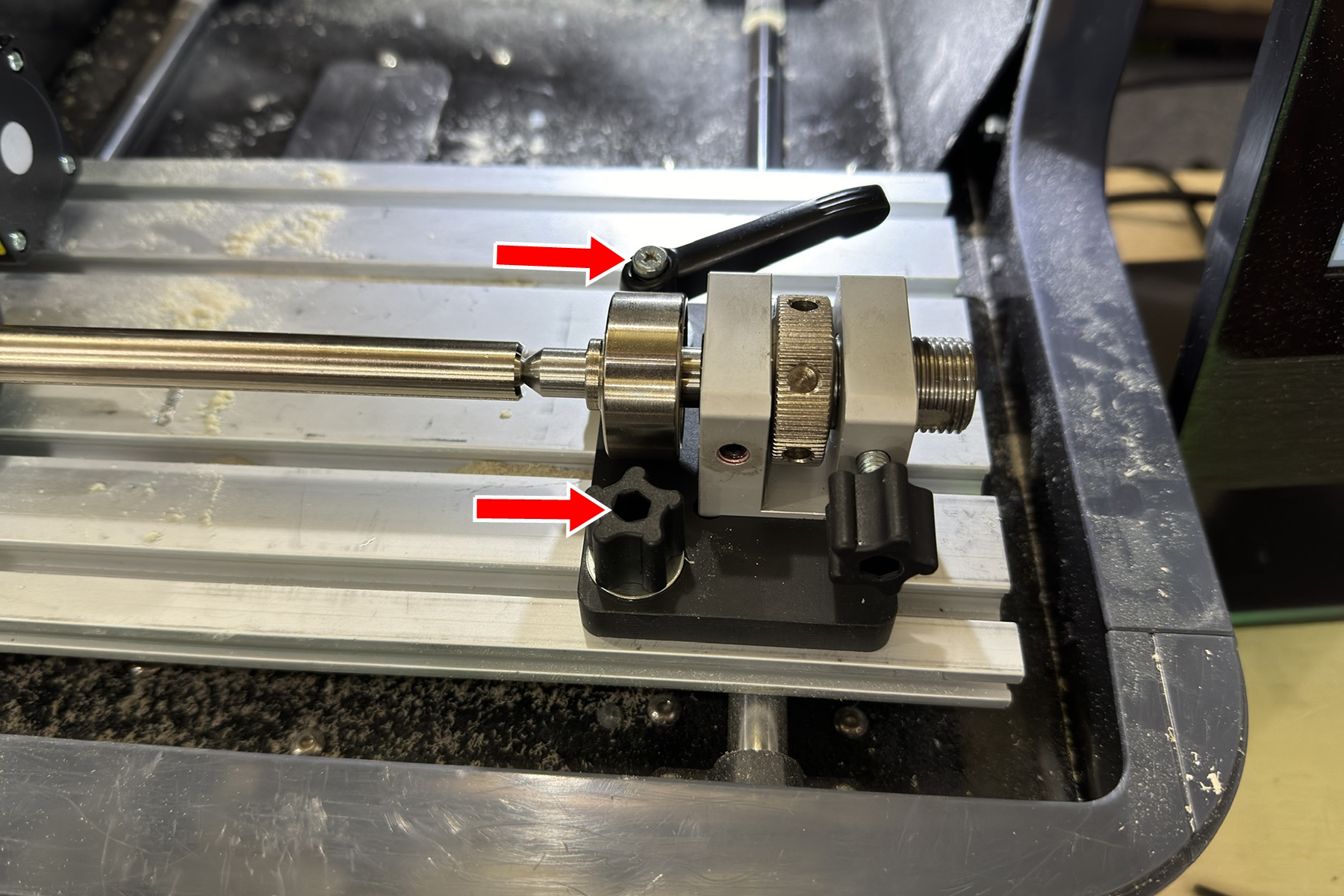

  1. Tighten the two handle screws on the tailstock with a Phillips screwdriver.
Figure 11: Two screws used to secure the tailstock to the machine table.
  1. Loosen the chuck, and rotate the tailstock's alignment wheel to move the tailstock center back about 1/2 in. Then, remove the setup bar from the spindle.

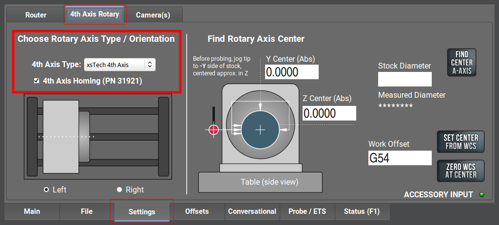

    3. Press the Reset button.
  2. From the Settings tab, select the 4th Axis Rotary tab.
  3. From the 4th Axis Type drop-down menu, select xsTech 4th Axis. Select the 4th Axis Homing (PN 31921) checkbox.
    Figure 12: 4th axis tab.

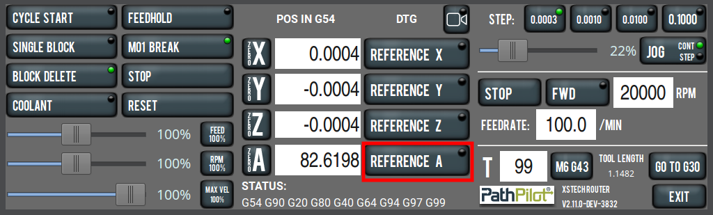

  4. Select Reference A to reference the A-axis.
    Figure 13: Reference A button.
    The spindle rotates to find the homing switch.
    NOTE: If the spindle doesn't rotate to find the homing switch, go to Step 3 to verify that homing is enabled.
