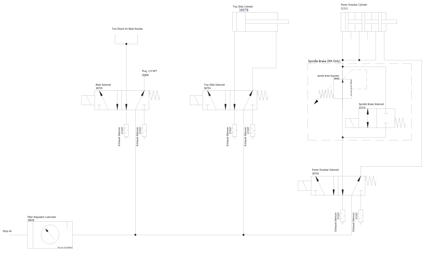

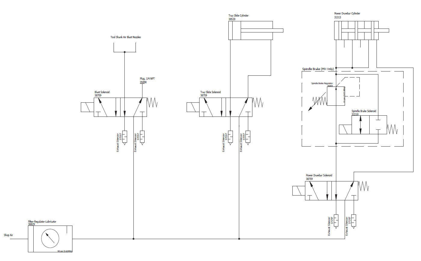

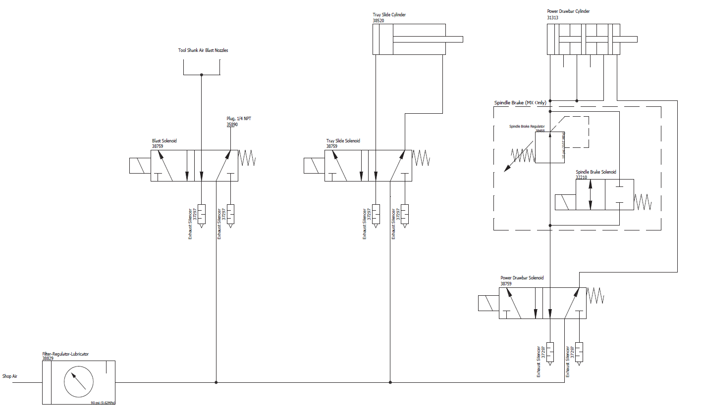

Blast/Tray/Drawbar Solenoid (PN 38759)
Plug, 1/4 NPT (PN 35890)
Exhaust Silencer (PN 37297)
Filter-Regulator-Lubricator (PN 38829)
Tray Slide Cylinder (PN 38578)
Power Drawbar Cylinder (PN 31313)
