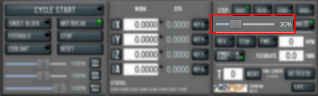

Jog the Machine
Figure 3: Jog button.
Figure 4: Jog Speed slider.
Figure 5: Step buttons (in G20 mode).
About Jogging
Jog the machine using the keyboard, the optional Jog Shuttle or Operator Console Pendant. Whichever device you're jogging with, you can either:
  • A keyboard key is pressed
  • The Operator Console Pendent wheel is turned in the desired direction.
About Step Jogging
While jogging in step mode, the machine moves one step each time you either press a jog key on the keyboard, click the inner wheel of the Jog Shuttle, or rotate the Console Pendant one click. The jog step sizes range depending on the programming mode you are using:

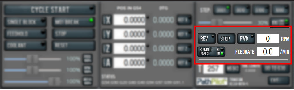

Manually Control the Spindle
  2. From the PathPilot interface, in the Manual Control area, locate the Spindle group.
Figure 6: Spindle group.
  1. Open the spindle motor door.
  2. Make sure that the spindle belt position agrees with your desired speed range. If it doesn't, do one of the following:
  1. Close the spindle motor door.
  2. In the RPM DRO field, type the desired RPM speed. Then select the Enter key.
  3. Select FWD to start the spindle in the forward direction, or REV to start the spindle in the reverse direction.
  4. Select Stop to stop the spindle.

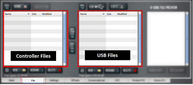

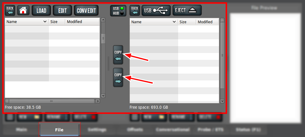

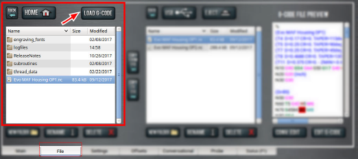

Load G-Code
To load G-code:
  2. Select Load G-Code.
Figure 8: Controller Files window on the File tab.
Figure 9: File tab.
Figure 10: File tab.
  1. If you're using a USB drive, select Eject.

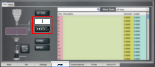

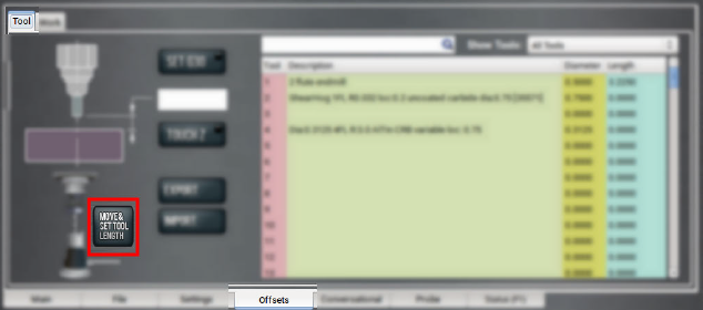

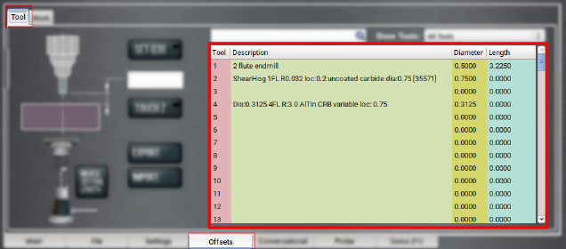

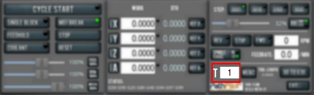

Set Tool Length Offsets
NOTE: You can import a .csv file with tool length offset data. For information, see Import and Export the Tool Table.
To set tool length offsets:
    For information, see "Set Up Tooling".
Figure 11: Tool Table window on the Offsets tab.
About Tool Offsets

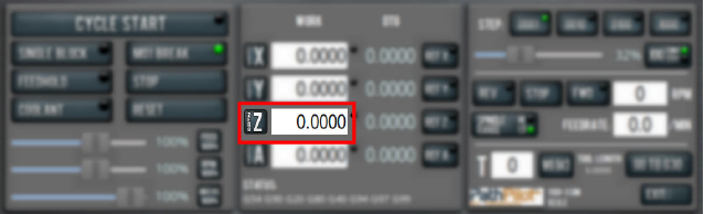

Set a Known Reference Height
  7. While moving the paper back-and-forth across the reference surface, slowly step the Z-axis down (-Z) until you feel a light pull on the piece of paper. This indicates that the paper is contacting the spindle.
Figure 12: Z-axis work offset DRO field.
Figure 13: Tool DRO field.
Figure 14: Touch Z DRO field and button.
  1. Select Touch Z.
  4. Jog the Z-axis up (+Z).
Figure 15: Tool DRO field.
Figure 16: Tool tab on the Offsets tab.

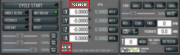

Set Work Offsets
  • Select Zero [Axis].
Figure 19: Work Offset DRO fields.
To change work offsets:
Figure 20: Work offset indicated in the PathPilot interface.
About Work Offsets

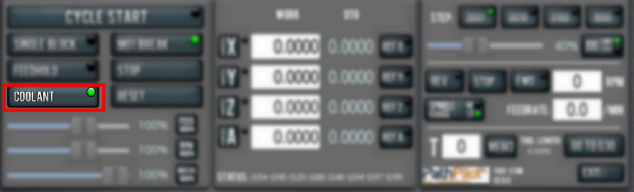

Operate the Coolant Pump
To turn coolant on or off:
  • Select Coolant.
Figure 21: Coolant button.
About Coolant
