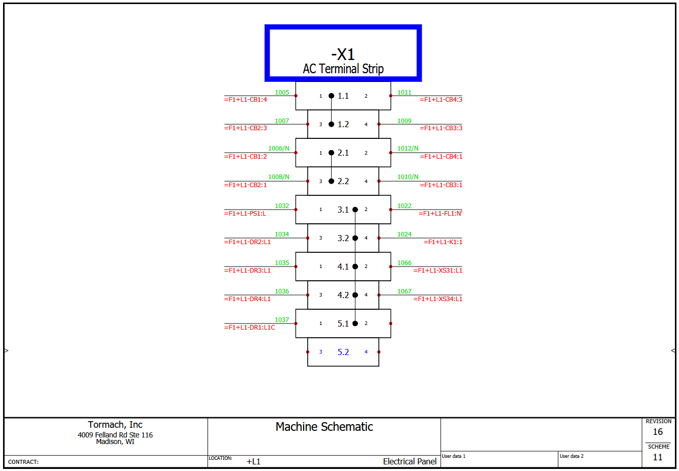

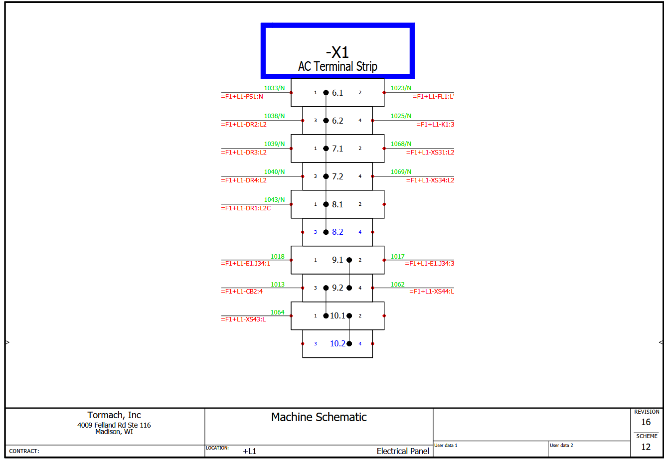

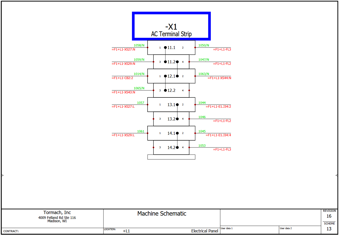

230 Vac Power - 1500MX

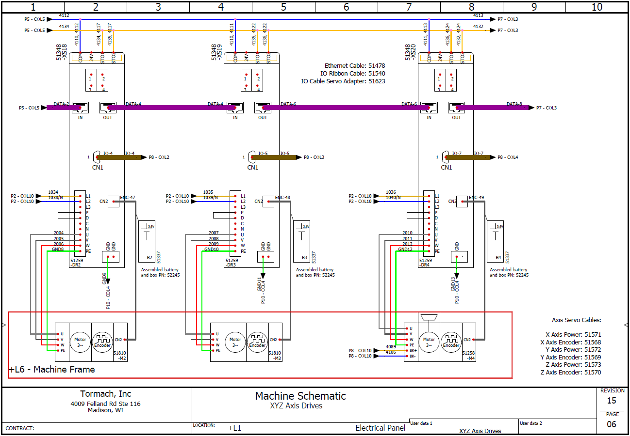

A- and B-Axis Drives - 1500MX

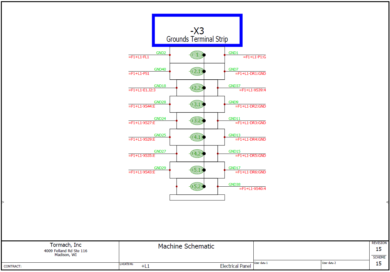

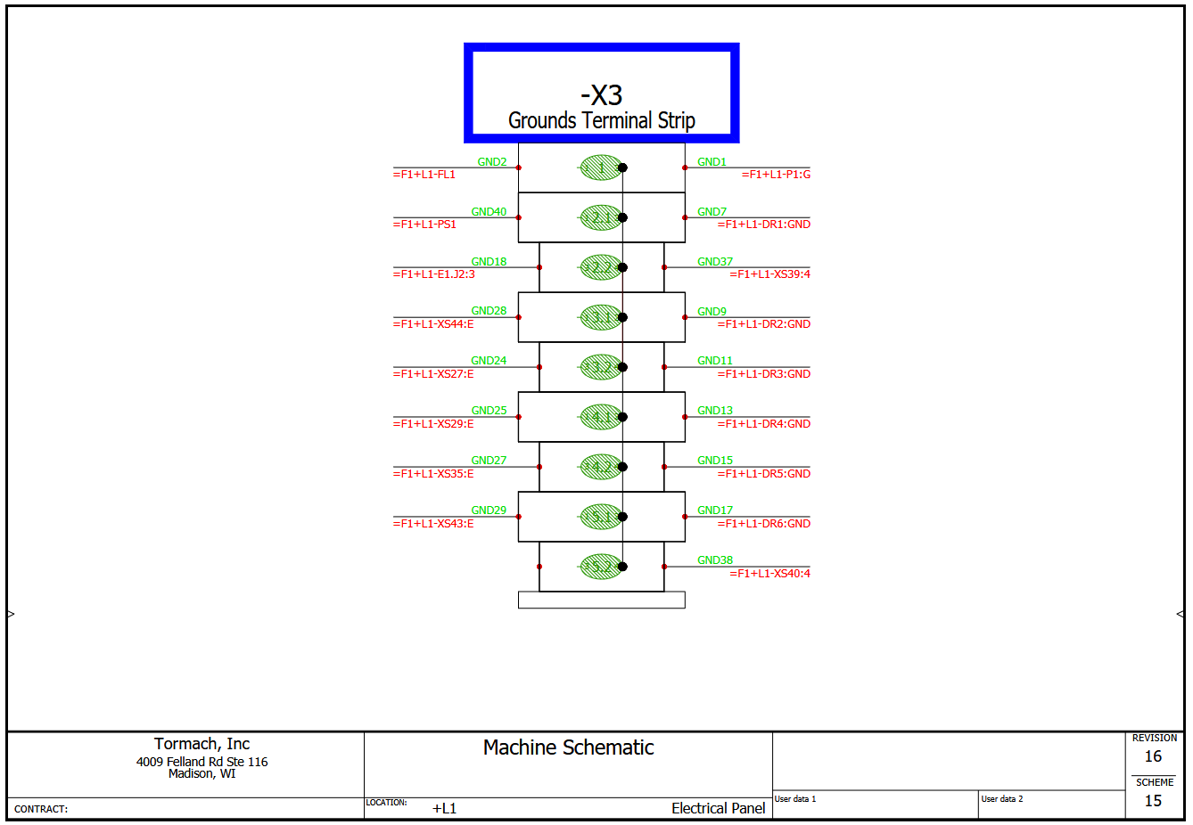

Grounds - 1500MX

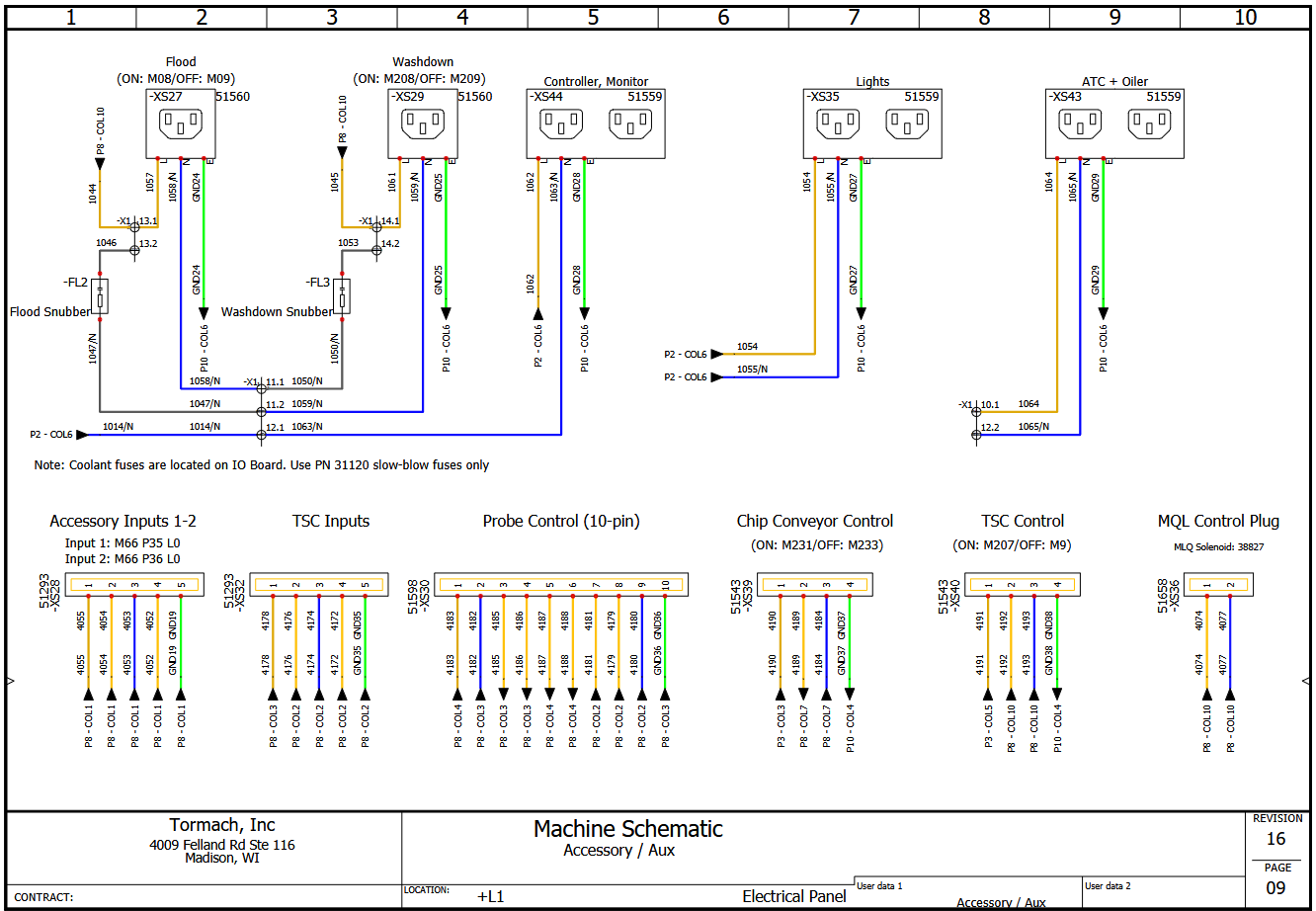

Accessory Schematics
