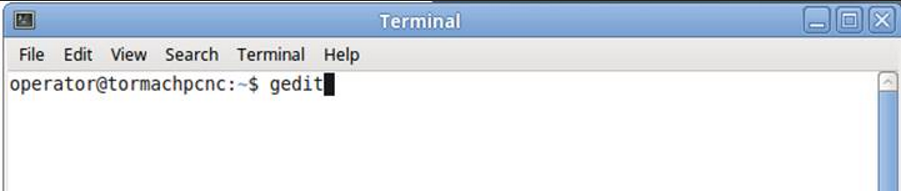

  1. On your Tormach controller, open a terminal window by holding CTRL + ALT + X on the keyboard.
  2. Type gedit and click Enter.

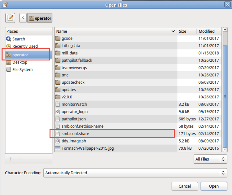

  1. Use the Open button at the top of the screen.
  1. Browse to a file called “smb.conf.share”.

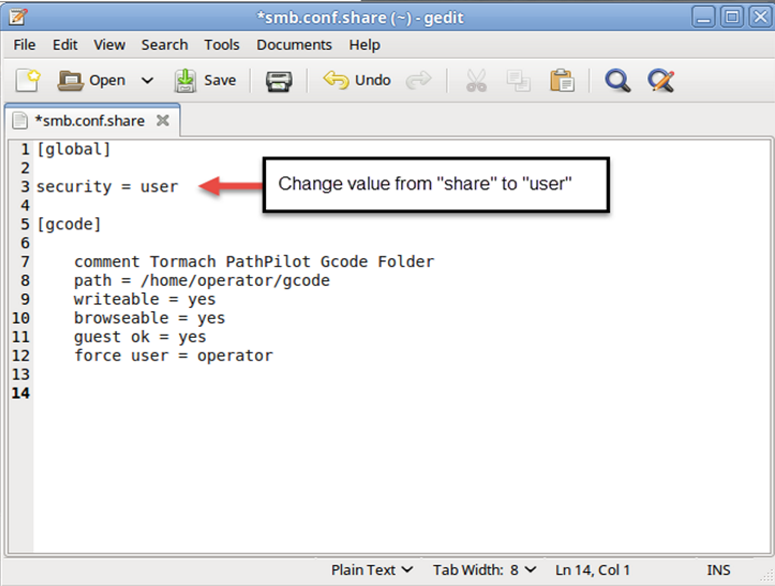

  1. Double click the file name to open it, and then proceed to change “security = share” to “security = user”. Then Save and reboot the PathPilot controller.
    If you don’t have “[global]” and/or “security = user” at all, add them both as pictured below.
  1. Test your connection to your “gcode” share. If no change is seen, continue on to step #7.

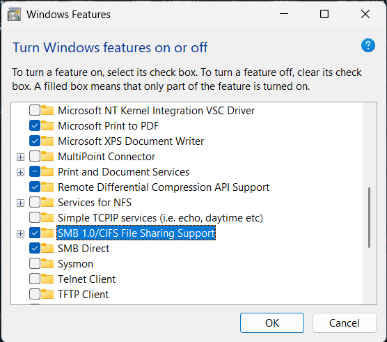

  2. On Windows machines, search for “Windows Features”. From this window, search for SMB 1.0. Make sure this option is checked.
  1. Reboot your windows machine, router and modem.
  2. Test the mapped drive again. If it still does not work, move on to the next topic.

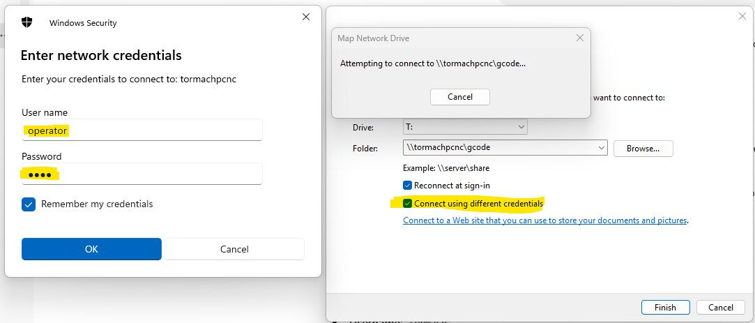

Connect Using Different Credentials to Map the Network Drive
  1. From the Windows machine side, check this option when attempting to map your “gcode” drive.
  1. Enter the User name “operator” and the Passwor “pcnc”.
  2. If this still does not allow you to map your drive, reach out to Tormach Technical Support, although, it may be needed to contact your networks admin, or a local computer specialist to assist with your personal network setup.
