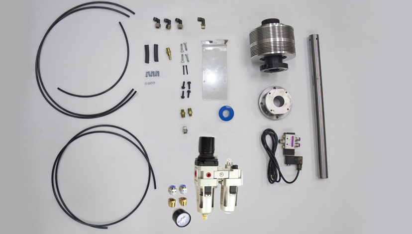

Product: Automatic Collet Closer Kit for 15L Slant-PRO (PN 38690)
The kit includes the items as shown in the following image.
Adapter Spacer (PN 38253)
Anti-Rotation Bracket (PN 38278)
Bolt, Hex Flange, M6 × 1 - 20 (PN 31779)
Draw Tube (PN 38362)
Edge Trim (PN 34618)
Fitting, Elbow, 1/4 in. Tube - 1/4 in. NPT (Female) (PN 31990)
FRL Filter-Regulator-Lubricator (PN 38829)
NPT Reducer (PN 38689)
Nut, Hex, M5 × 0.8 (PN 31201)
Pneumatic Cylinder
Screw, Button Head Cap, M4 × 0.7 - 30 (PN 38359)
Screw, Button Head Cap, M5 × 0.8 - 16 (PN 38360)
Screw, Hex, M6 × 1 - 25 (PN 32371)
Solenoid Assembly
Thread Seal Tape (PN 37508)
Tube, 1/4 in. OD, Nylon (PN 31457)

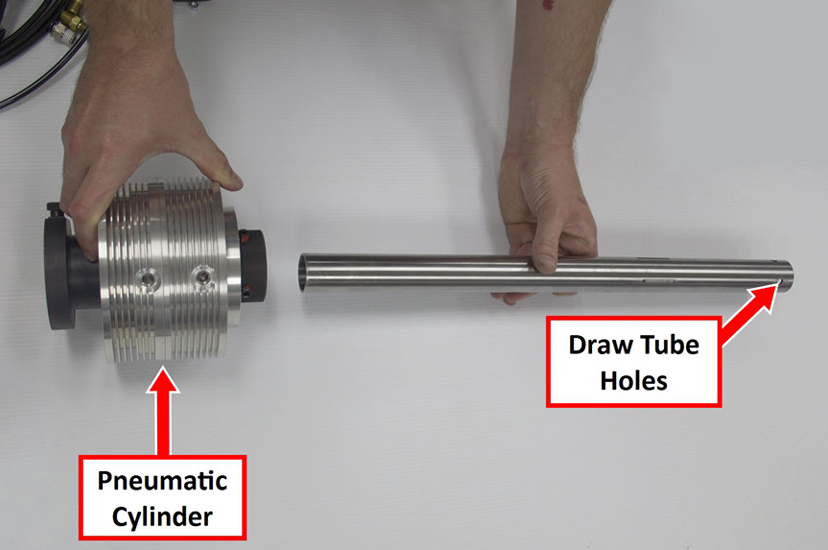

Assemble the Pneumatic Cylinder

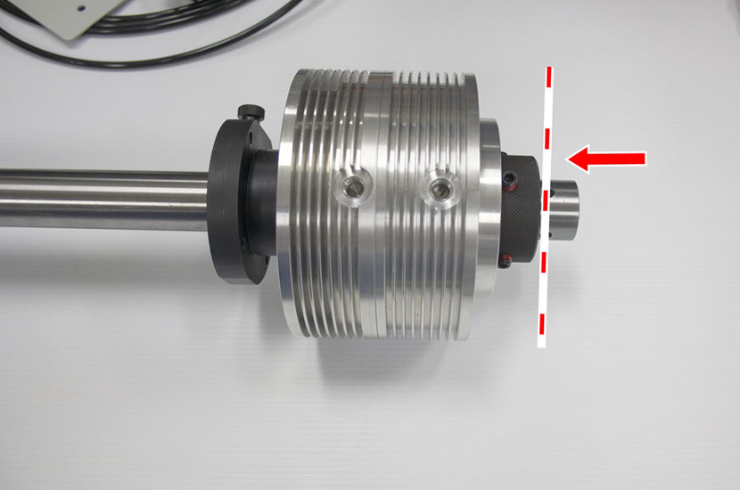

  1. Find the draw tube provided. One end of the draw tube has four holes, which are used to secure the draw tube to the pneumatic cylinder.
  2. Assemble the draw tube with the pneumatic cylinder so that the draw tube’s holes are furthest away from the pneumatic cylinder, as shown in the following image.
Figure 1: Draw tube aligned with a pneumatic cylinder.
  1. Put the draw tube through the pneumatic cylinder until the end of the draw tube is flush with the end of the pneumatic cylinder.
Figure 2: Draw tube in the pneumatic cylinder.
  1. Use a 3/16-in. hex wrench to tighten the four set screws on the pneumatic cylinder that are aligned with the four holes on the draw tube.
    The draw tube is now secured in place.

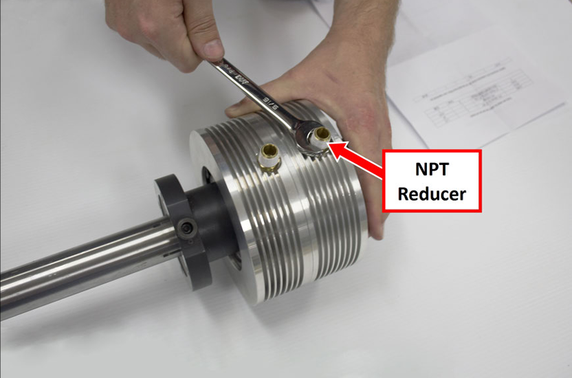

  2. Find the two NPT reducers provided. Wrap the threads on both ends of the NPT reducers with thread seal tape.
  3. Install two NPT reducers on the pneumatic cylinder with a 9/16-in. hex wrench.
Figure 3: NPT reducers installed on the pneumatic cylinder.

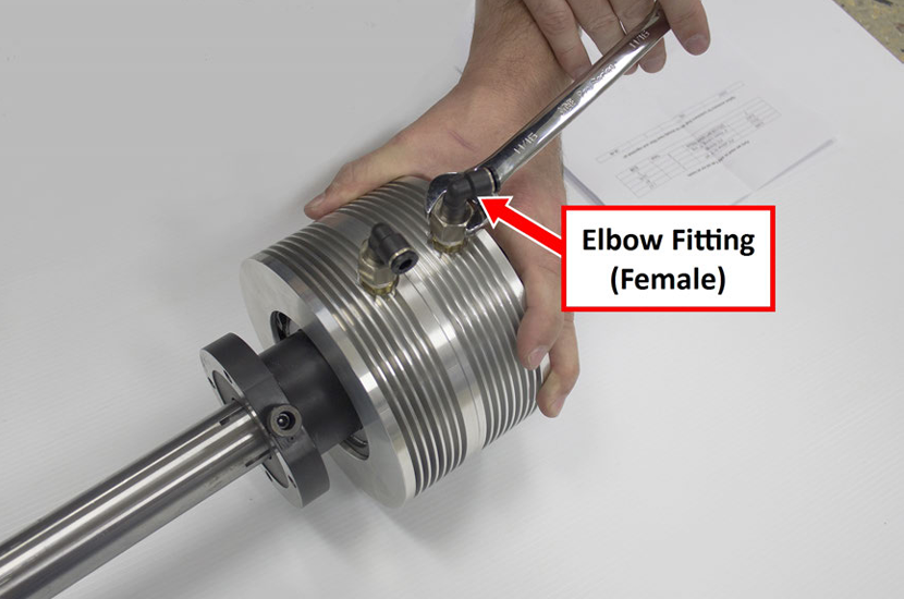

  1. Install two elbow fittings (female) to the NPT reducers with an 11/16-inch wrench.
Figure 4: Elbow fittings (female) installed on the NPT reducers.

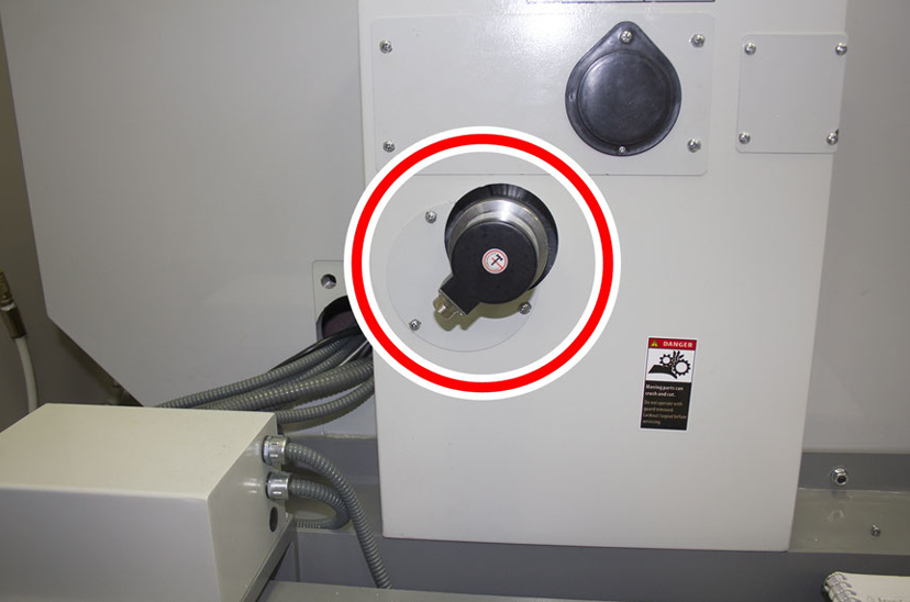

  2. Identify the rotary encoder on the belt guard cover.
Figure 5: Rotary encoder on the belt guard cover.
  1. Disconnect the power connector from the rotary encoder.
  2. Identify the encoder cover below the rotary encoder.
  3. Remove the encoder cover's three screws with a Phillips screwdriver, and set aside the encoder cover and its screws

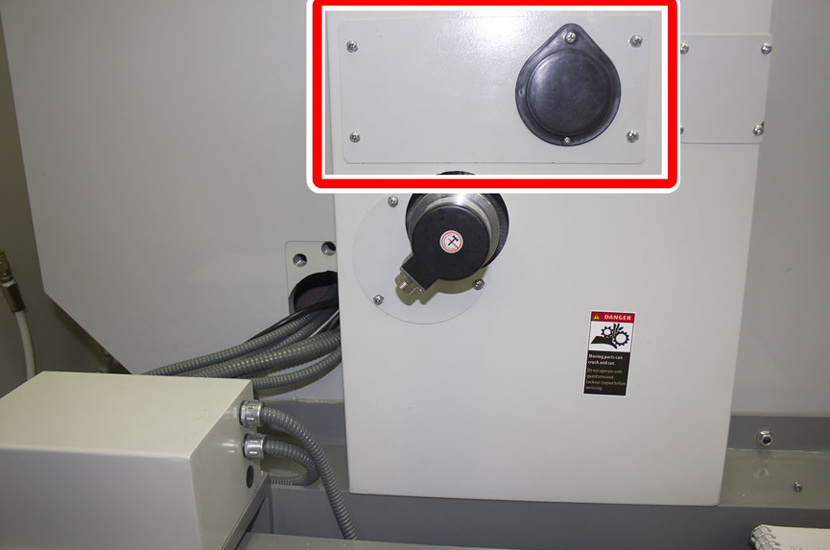

  4. Identify the spindle bore cover above the rotary encoder.
Figure 6: Spindle bore cover on the belt guard cover
  1. Remove the spindle bore cover's screws with a Phillips screwdriver, and discard the spindle bore cover and its screws.

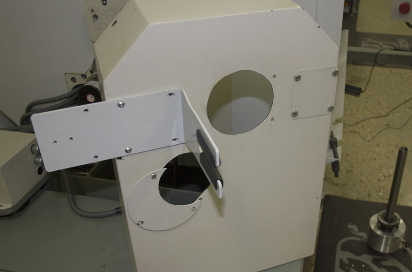

This procedure gives instructions to drill two holes in the belt guard cover to use for the anti-rotation bracket provided. To do so, you must first identify the hole locations by temporarily installing the anti-rotation bracket.

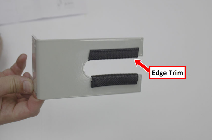

  1. Slide two pieces of edge trim (provided) on the anti-rotation bracket, as shown in the following image.
Figure 7: Edge trim pieces installed on an anti-rotation bracket.
  1. Use two M5 × 0.8 - 16 button head cap screws to temporarily attach the anti-rotation bracket to the belt guard cover, as shown in the following image. Verify that the screws are centered within the slots on the anti-rotation bracket.
Figure 8: Anti-rotation bracket installed on a belt guard cover.
  1. Use a marker to indicate hole locations on the belt guard cover: Put one mark in the center of each open slot on the anti-rotation bracket.
  2. Remove the two M5 × 0.8 - 16 button head cap screws and the anti-rotation bracket.
  3. Set aside the anti-rotation bracket and its screws.
  4. Drill holes in the two marked locations on the belt guard cover with a #1 drill bit.
  5. Install the anti-rotation bracket on the belt guard cover: Use four M5 × 0.8 - 16 button head cap screws and four M5 × 0.8 hex nuts.

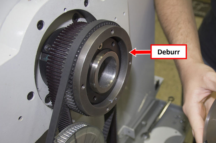

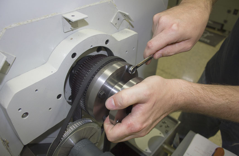

  1. Remove any burrs on the face of the spindle pulley with a machinist's stone. Burrs could cause runout.
Figure 9: Face of the spindle pulley on the left side of the machine.

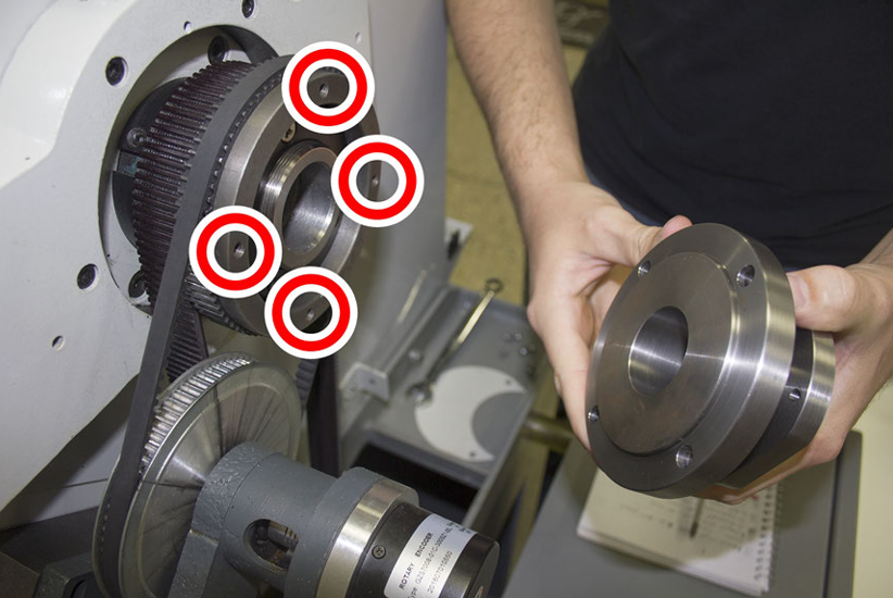

  1. Identify the four pilot holes on the spindle pulley as shown in the following image.
Figure 10: Pilot holes on the spindle pulley.
  1. Align the four pilot holes on the spindle pulley with the four holes on the adapter spacer.
  2. Use a 10 mm wrench and four M6 × 1 - 20 flanged hex bolts to attach the adapter spacer to the spindle pulley.
Figure 11: Adapter spacer installed on the spindle pulley.

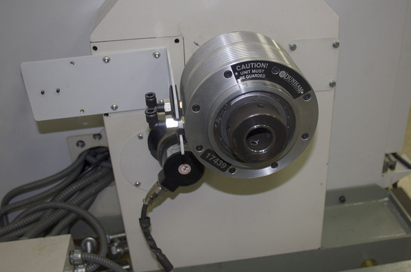

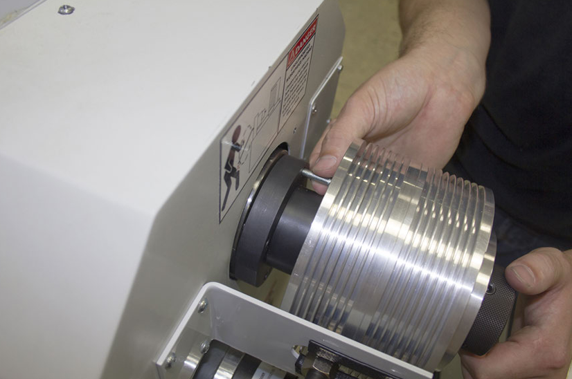

  2. Slowly slide the assembly into the spindle while verifying that its fittings slide into the anti-rotation bracket.
Figure 12: Pneumatic cylinder assembly put into the spindle.

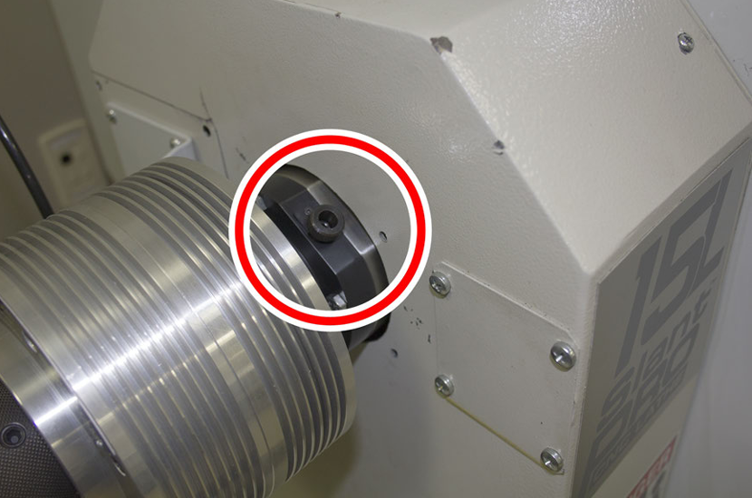

  1. Identify the thumb screw on the pneumatic cylinder assembly.
  2. Verify that the thumb screw is aligned with the flat edge on the adapter spacer, as shown in the following image.
Figure 13: Thumb screw aligned on a pneumatic cylinder assembly.
  1. Use four M6 × 1 - 25 hex head screws to tighten by hand the pneumatic cylinder assembly to the adapter spacer. Verify that the screws are tight, but not tightened completely.
Figure 14: Pneumatic cylinder assembly installed on the adapter spacer.

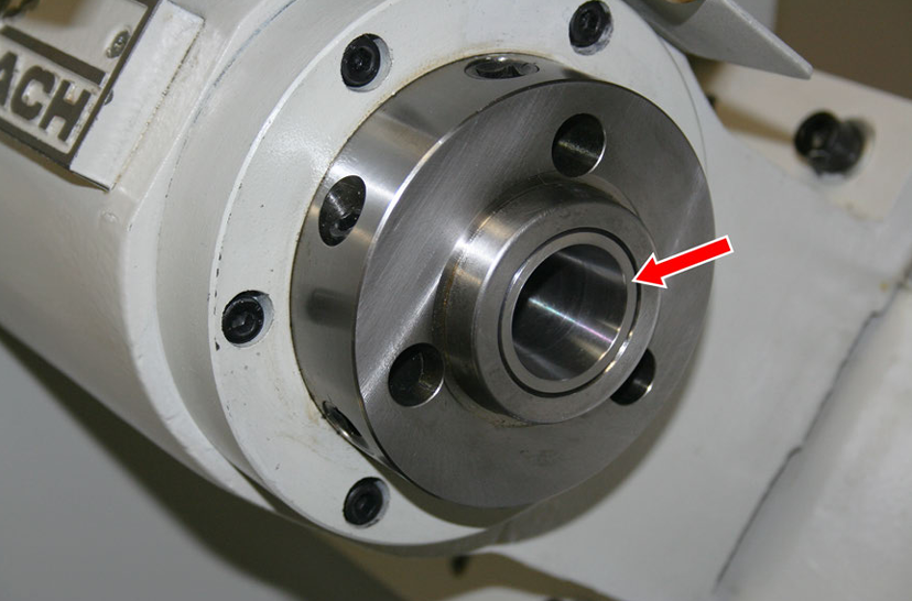

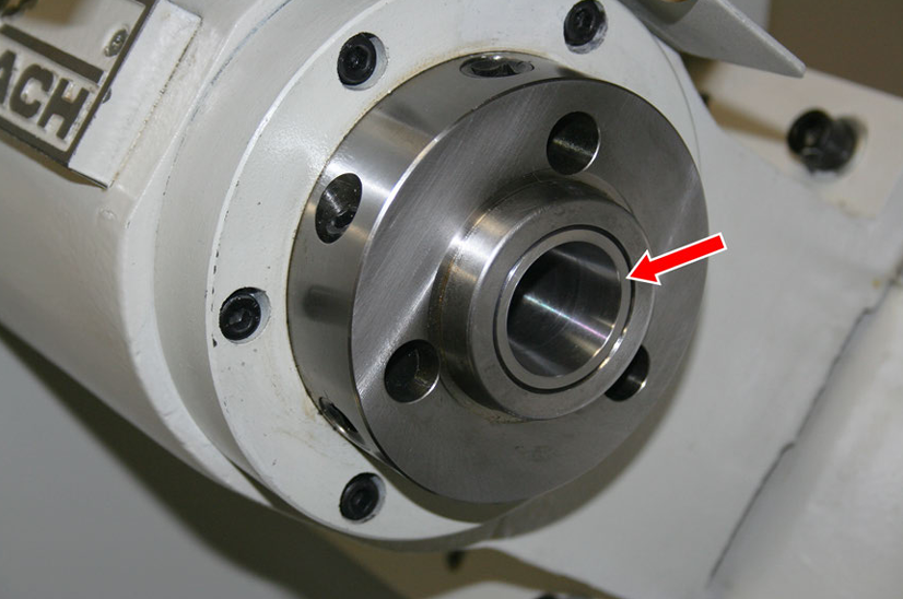

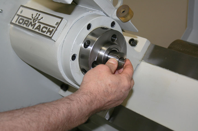

  1. Loosen the thumb screw on the pneumatic cylinder assembly. Loosening the thumb screw allows the draw tube to rotate separately from the spindle so that you can thread a collet into the draw tube.
  2. Verify that a 5C insert is installed in the spindle, as shown in the following image.
Figure 15: 5C insert installed in the spindle.
  1. Install a collet into the 5C insert. You must rotate the collet until its groove aligns in the 5C insert.
Figure 16: Collet installed into the 5C insert.

  4. Tighten the thumb screw on the pneumatic cylinder assembly.
  5. To prevent the draw tube from turning during operation, you must make sure that the thumb screw is engaged in the draw tube: Turn the draw tube handle counterclockwise until the thumb screw clicks into one of four slots on the draw tube.
    The draw tube is now locked into place.

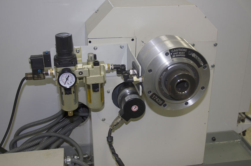

Make Air Connections

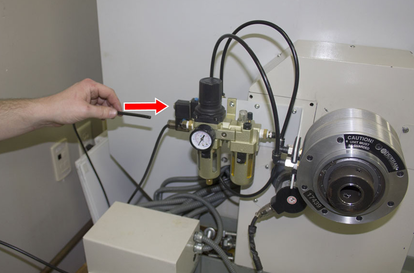

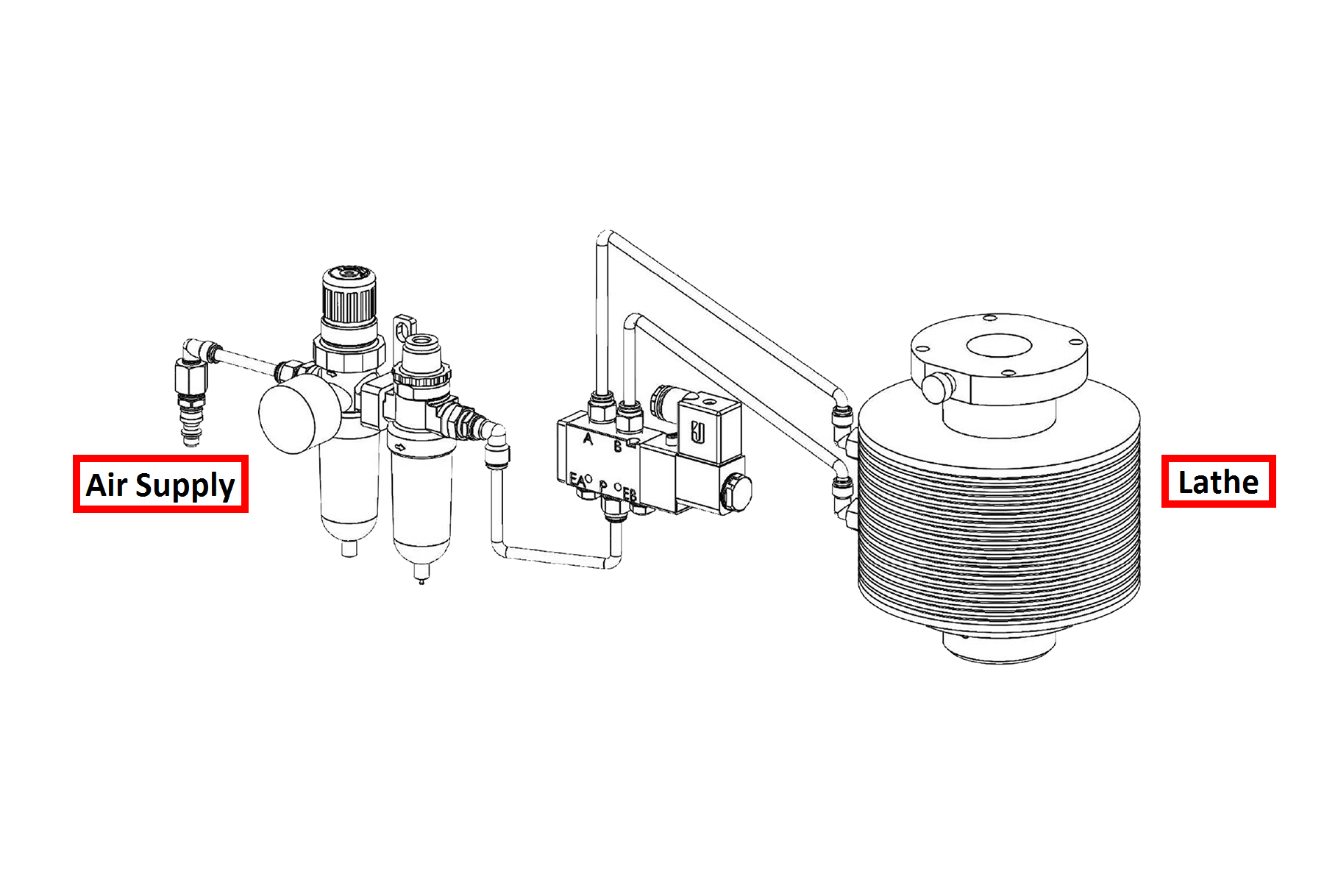

To verify that the air to the solenoid is dry, filtered, and regulated, use the (provided) FRL Filter-Regulator-Lubricator (PN 38829).
NOTE: For an air routing diagram for reference, go to "Pneumatic Schematic".

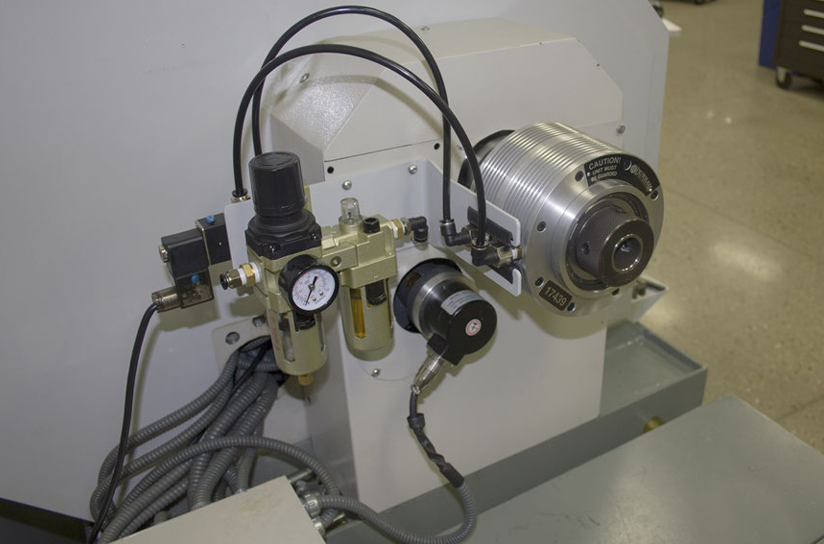

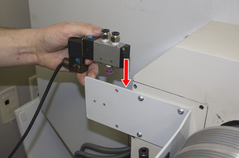

  1. Use two M4 × 0.7 - 30 button head cap screws to attach the solenoid behind the anti-rotation plate, as shown in the following image. Verify that the side with two ports is pointing up.
Figure 17: Solenoid behind the anti-rotation plate.
  1. Connect the power cord on the solenoid to the outlet marked Closer on the power connection panel.
  2. Attach the FRL Filter-Regulator-Lubricator in front of the anti-rotation bracket with one M5 × 0.8 - 16 button head cap screw, as shown in the following image.
Figure 18: FRL Filter-Regulator-Lubricator installed in front of the anti-rotation plate.
NOTE: For setup and operating instructions, see the documentation for the FRL Filter-Regulator-Lubricator (PN 38829).
  1. Use the medium-length air tubes provided to make air connections in the following order:
    1. Connect one end of each medium-length air tube to each elbow fitting on the pneumatic cylinder.
    2. Put the medium-length air tube from the elbow fitting closest to the belt guard cover into port A on the solenoid.
    3. Put the medium-length air tube from the elbow fitting furthest from the belt guard cover into port B on the solenoid.
Figure 19: Air connections from the pneumatic cylinder to the solenoid.

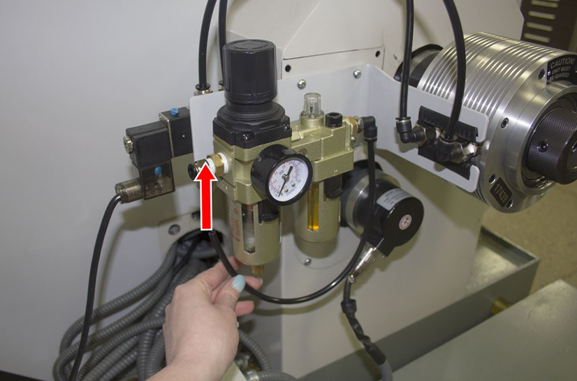

  1. Connect one end of the shortest air tube provided into port P on the solenoid.
  2. Connect the loose end of the shortest air tube to the output port on the FRL Filter-Regulator-Lubricator.
Figure 20: Example of an air connection at the output port on the FRL Filter-Regulator-Lubricator.

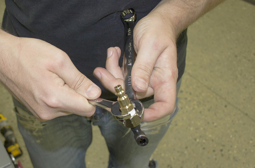

  1. Wrap the threads of the quick-connect fitting provided with thread seal tape.
  2. Use one 9/16-in. wrench and one 11/16-in. wrench to install the quick-connect fitting into an elbow fitting.
Figure 21: Quick-connect fitting installed in the elbow fitting.
  1. Connect one end of the longest air tube provided to the elbow fitting.
  2. Connect the loose end of the longest air tube to the input port on the FRL Filter-Regulator-Lubricator.
Figure 22: Example of an air connection at the input port on the FRL Filter-Regulator-Lubricator.
  1. Connect the quick-connect fitting to the air compressor.

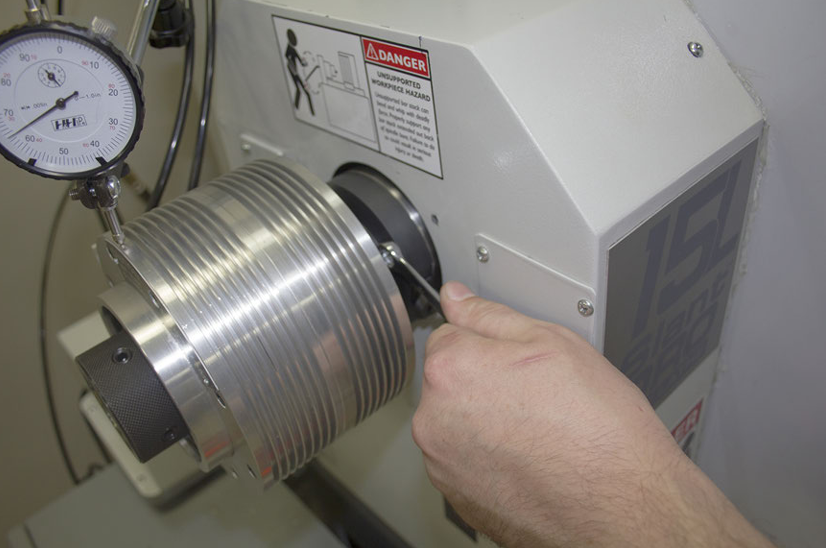

Align the Automatic Collet Closer Kit with the Spindle

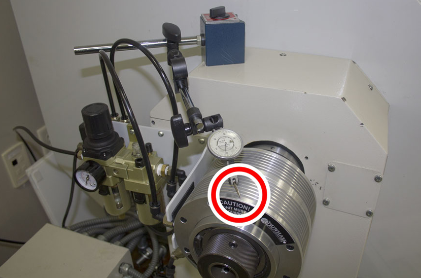

  1. Put the base of a magnetic dial indicator on the top of the belt guard cover. Verify that the magnetic dial indicator touches the aluminum of the pneumatic cylinder furthest away from the belt guard cover, as shown in the following image.
Figure 23: Magnetic dial indicator put on a pneumatic cylinder.
  1. Rotate the spindle clockwise. On the magnetic dial indicator, the needle rises and falls. Continue to rotate the spindle until the needle reaches the highest point on the magnetic dial indicator.

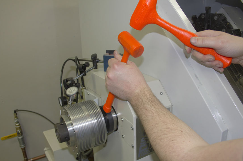

  2. Gently tap the mounting flange with two dead-blow hammers, as shown in the following image.
Figure 24: Using two dead-blow hammers to align an Automatic Collet Closer Kit.
  1. Rotate the spindle clockwise until the needle again reaches the highest point on the magnetic dial indicator.
  2. Repeat Steps 2 through 4 until the spindle runout is less than 0.002 in.
NOTE: If the reading on the magnetic dial indicator remains the same after you tap the mounting flange with the dead-blow hammer, loosen the four M6 × 1 - 25 hex head screws, and repeat Steps 3 through 4.
  1. Tighten the four M6 × 1 - 25 hex head screws on the mounting flange with a 10 mm wrench.
Figure 25: Tighten the mounting flange on the pneumatic cylinder.

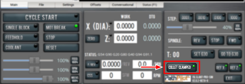

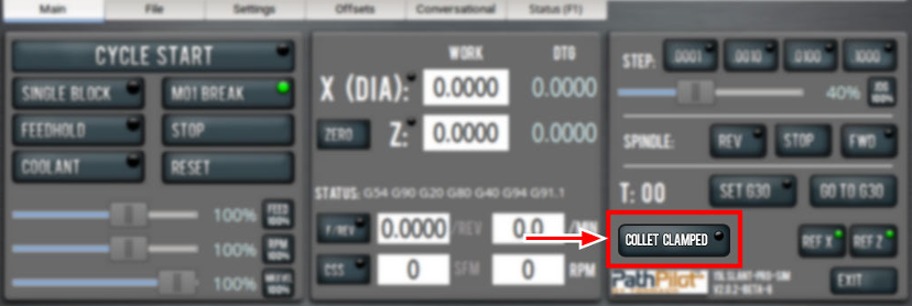

  • From the PathPilot interface, select Collet Clamped to toggle the button's green light on and off.
    • When the Collet Clamped button's green light is on, the collet is in the closed (clamped) position.
    • When the Collet Clamped button's green light is off, the collet is in the open (unclamped) position.
Figure 26: Collet Clamped button with the light on.

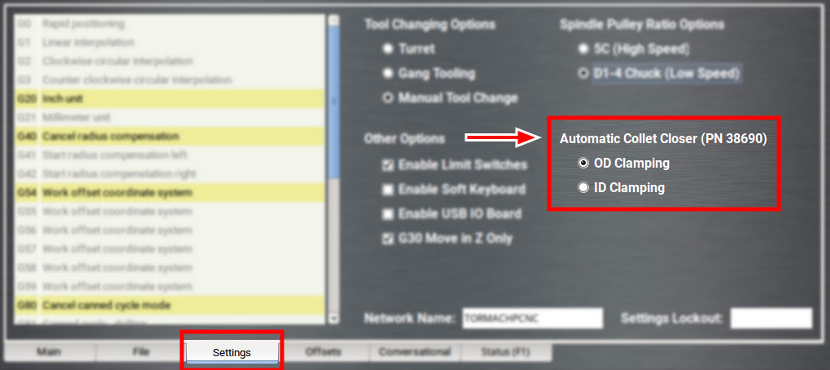

Switch Between ID and OD Clamping
To switch between clamping the inside diameter and the outside diameter of a workpiece:
  • From the PathPilot interface, on the Settings tab, select either the ID Clamping or the OD Clamping option.
Figure 27: Automatic Collet Closer Kit clamping options.
Figure 4: 5C insert installed in the spindle.
Figure 5: Collet installed into the 5C insert.

Pneumatic Schematic
