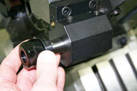

Boring Bar Holder (pre-installed) (PN 37136)

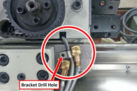

Coolant Fitting (may be pre-installed)

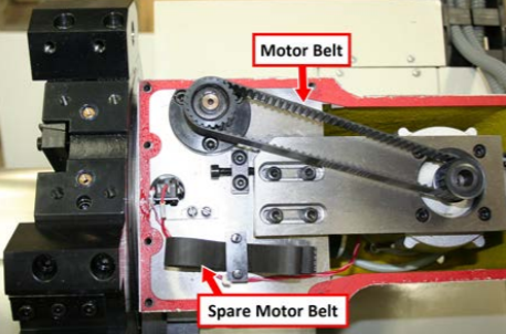

Spare Motor Belt (under motor cover) (PN 36047)

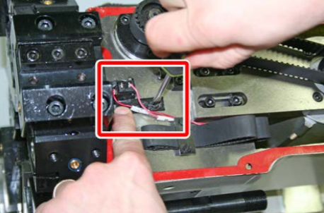

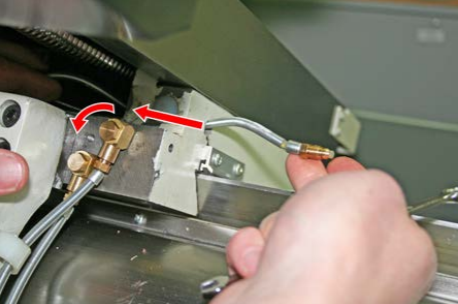

Oil Line Relocation
Machines with serial numbers 10192 and below must first relocate the oil line. Depending on your machine's serial number, do one of the following:

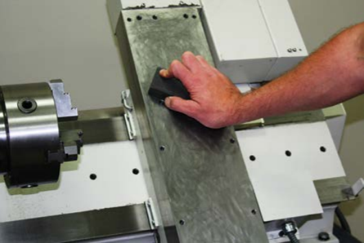

Clean the Mounting Surfaces
You must make sure the surface is free of burrs or debris:
  1. Use a machinist stone (or similar) to clean the lathe’s slant bed.
Figure 1: Deburring the bed.
  1. Use a machinist stone (or similar) to clean the bottom of the turret.

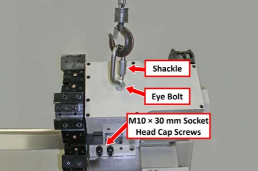

  1. Screw the eye bolt tightly into the turret and attach the shackle.
Figure 2: Securing the turret to the lifting hardware.
  1. Use a lift system to raise the turret above the lathe.
IMPORTANT! Keep the turret attached to the lift system until instructed to remove.

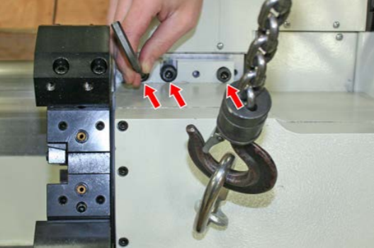

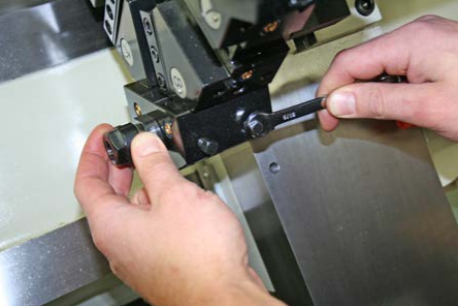

  1. Use an 8 mm hex wrench to screw two M10 x 30 mm socket head cap screws two-thirds of the way into the two slots. Do not install the M10 flat washers.
  2. Use a lift system to lower the turret onto the two screws installed in the slots.
  3. Install the remaining four M10 x 30 mm socket head cap screws and M10 flat washer into open positions on the front and back of the turret.
Figure 3: Securing the turret to the lathe.
  1. One at a time, remove the two M10 x 30 mm socket head cap screws from the slots.
  2. Add one M10 flat washer to each screw.
  3. Reinstall the M10 x 30 mm socket head cap screws and M10 flat washers to the slots.
  4. Snug down all six screws tightly.
  5. When the turret is completely secure, disconnect the lift system from the turret’s eye bolt.
  6. Remove the eye bolt.

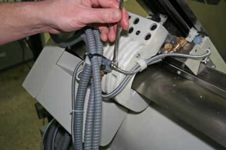

Route Wires to the Electrical Cabinet

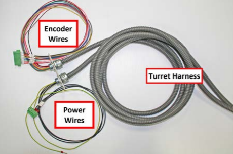

For further details on turret electrical wiring, refer to the following image and/or the electrical schematic in the lathe's operator manual.
  2. Route the turret harness over the back of the lathe.
Figure 4: Turret harness identification.

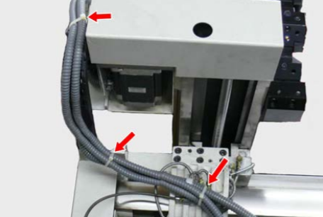

  1. Use cable ties (included) to secure the turret harness in the locations shown in the following image.
Figure 5: Harness secured behind the lathe.

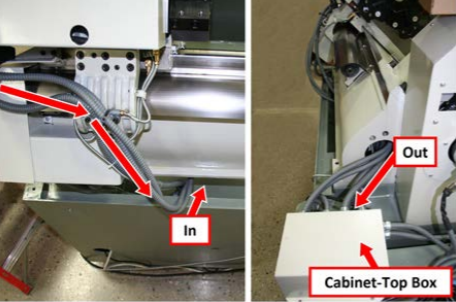

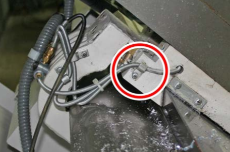

  1. Route the turret harness into the lathe casting and out through casting hole on the opposite side of the lathe.
Figure 6: Harness routing.
IMPORTANT! Verify that the turret harness is free from entanglement throughout its full motion.
  1. Pull the turret harness through the casting far enough so that the new cover plate can reach beyond the cabinet-top box.

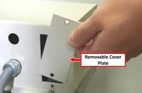

  2. Open the electrical cabinet door on the side of the lathe.
  3. To begin routing the power and encoder ends of the turret harness into the electrical cabinet, you must first unscrew the removable cover plate from the cabinet-top box; set screws aside.

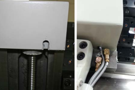

Figure 7: Cabinet-top box cover plate.
NOTE: If your lathe doesn't have a removable cover plate, we can help. Create a support ticket with Tormach Technical Support at tormach.com/how-to-submit-a-support-ticket for guidance on how to proceed.

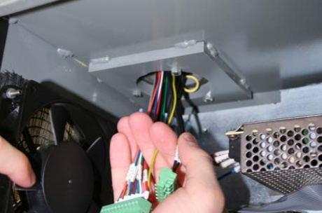

  1. Carefully feed the power and encoder wires down into the cabinet-top box. Pull the wires into the electrical cabinet far enough so that they can reach all connections.
Figure 8: Power and encoder wires pulled into the electrical cabinet.

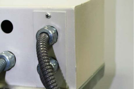

  1. Use the two screws set aside earlier to install the new cover plate and turret harness assembly to the cabinet-top box.
Figure 9: New cover plate installed onto the cabinet-top box.

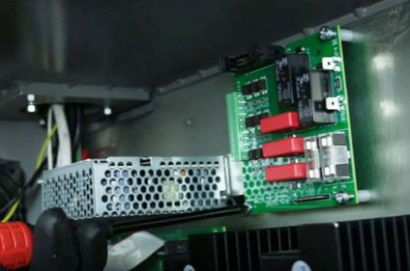

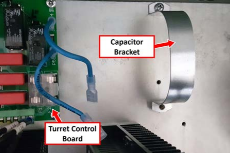

  1. Thread four M4 standoffs (PN 50765) into the four pre-drilled and pre-tapped holes on the electrical cabinet back panel.
  2. Use four M4 screws (PN 50838) to mount the turret control board to the standoffs that you installed in the previous step.
Figure 10: Turret control board mounted into the electrical cabinet.

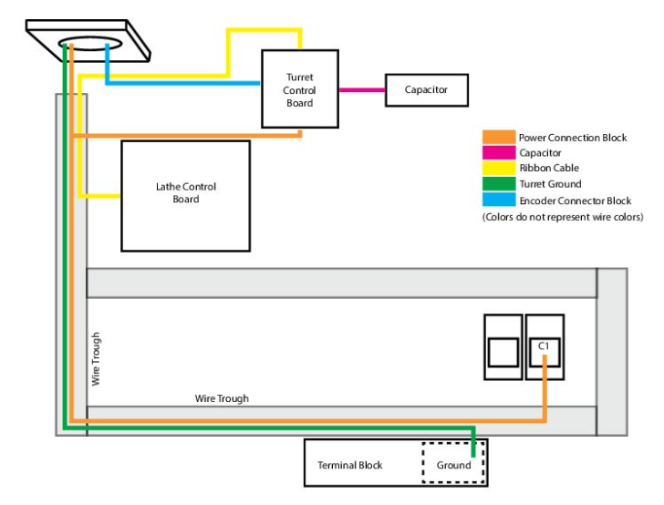

Make Electrical Connections

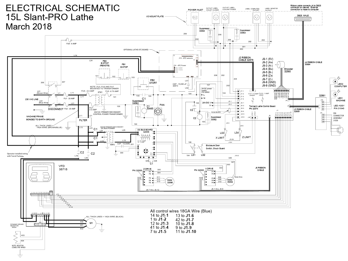

An illustration of turret wire routing inside the electrical cabinet is shown in the following image. The steps to follow detail the connections shown below.
  1. Use two M4 x 10 mm pan head screws to mount the capacitor and capacitor bracket on the back panel of the electrical cabinet.
Figure 11: Mounting the capacitor bracket into the electrical cabinet.
NOTE: If the back panel of your electrical cabinet doesn’t have two holes to mount the capacitor bracket, use the bracket as a template to drill and tap the holes.

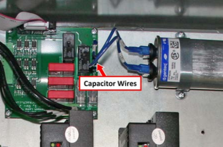

  1. Locate two loose blue capacitor wires marked L51 and L52.
  2. Connect wires L51 and L52 between capacitor terminals and terminals P4/P5 on the turret control board.
Figure 12: Capacitor connections.
NOTE: The capacitor is non-polar. There is no wrong way to connect.

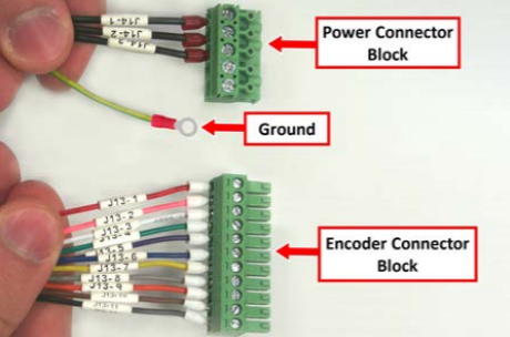

  1. Locate and identify three end wire configurations on the turret harness. Make sure that the cncoder connector block wires are in sequential order.
Figure 13: Turret harness end wire connections.

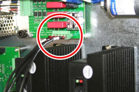

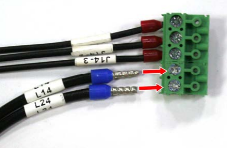

  1. Locate two loose turret power wires marked L14 and L24. Loosen the lock screws on the power connector block, and connect wires L14 and L24. Re-tighten screws snugly.
Figure 14: Power wires connected to the power connector block.
  1. Remove the necessary wire trough covers from the electrical cabinet, and toute the power and ground wires through them.
  2. Route the power connector block to the turret control board, and then plug it in.
Figure 15: Power connector block connected to the turret control board.
IMPORTANT! To avoid damage to the turret control board pins, carefully align the power connector block.

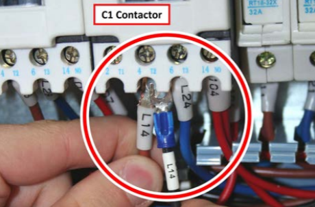

  1. Route the loose ends of the power connection block (wires L14 and L24) through the wire troughs and to the C1 contactor.
  2. Loosen the terminal lock screw above wire L14 on the C1 contactor, and then piggyback the L14 spade terminal onto the existing L14 connection. Re-tighten the terminal lock screw above wire L14 to secure both terminal wires.
Figure 16: Connecting wire L14 to the C1 contactor.

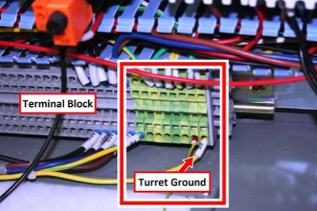

  1. Loosen the terminal lock screw above wire L24 on the C1 contactor, and then piggyback the L24 spade terminal onto the existing L24 connection. Re-tighten the terminal lock screw above wire L24 to secure both terminal wires.
  2. Route the loose end of the turret ground wire through the wire troughs and to the green-colored section of terminal block.
Figure 17: Terminal block.
  1. Cut the eyelet off of the turret ground wire, and then twist the wire ends together.
  2. You can connect the turret ground wire into any available slot in the green-colored section of the terminal block. To make the connection:
    1. Slowly insert the end of a small, flat-head screwdriver straight into the slot above or below the wire.
    2. Pry the terminal clip open carefully.
    3. Insert the wire into the terminal block, and then slowly remove the screwdriver.
NOTE: If the turret ground wire does not reach the terminal block, attach the provided turret ground extension.

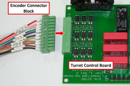

  1. Route the encoder connector block to the turret control board, and then plug it in.
Figure 18: Encoder connector block and the turret control board.

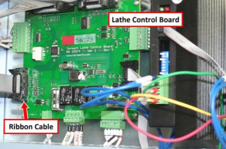

  1. Connect one end of the ribbon cable to the turret control board.
  2. Route the opposite end of the ribbon cable through the wire trough and connect it to the lathe control board.
Figure 19: Ribbon cable connected to the lathe control board.
  1. Use two mounting tabs, M4 × 10 mm pan head screws, and cable ties to secure excess encoder connector block and ribbon cable connections to the back of the electrical cabinet.
NOTE: Holes are pre-drilled and tapped.
  1. Reinstall the wire trough covers.

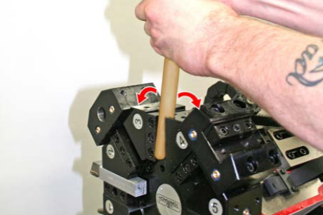

Adjust X-Axis Alignment
    3. Press the Start button.

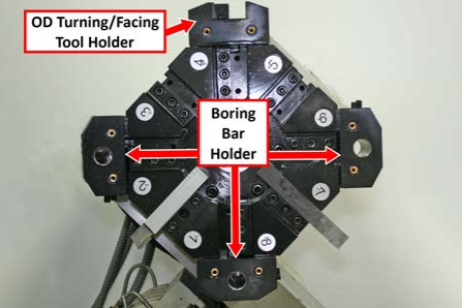

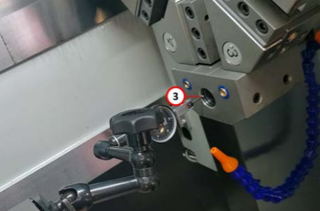

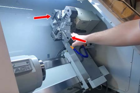

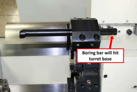

  2. Rotate the turret so that pocket number 3 or pocket number 7 is presented to the spindle.
NOTE: You can use either pocket — both have boring bar holders and are opposing one another, which makes them ideal for alignment.
Figure 20: Boring bar holders in pocket number 3 and pocket number 7.

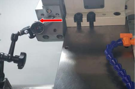

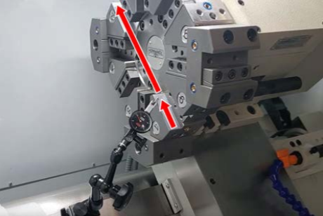

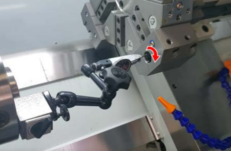

  1. Mount the dial indicator's magnetic base on the spindle. Position the indicator so that, when you rotate the spindle by hand, the indicator sweeps a bore approximately the size of the boring bar holder.
  2. Jog the turret close to the indicator and turn the spindle by hand. Adjust the position of the indicator until it's sweeping the inside diameter of the boring bar holder.
Figure 21: Indicator positioned within the boring bar holder.
  1. Set the indicator reading to zero at the initial contact point.
  2. Sweep the bore with the indicator:
  • Ensure the reading is the same on both sides of the bore along the machine's X-axis.
  • Jog the machine in X in step mode (0.001 in. increments) until equal readings are achieved.
NOTE: At this step, the reading itself on the dial isn't important — just that the reading is the same in both positions.
Figure 22: Positions to read the indicator.
  1. If needed, fine-adjust the indicator diameter to maintain an accurate sweep.
  2. Once the readings match, note any discrepancy in the third position. This value determines the difference in alignment of the Y-axis, which you can resolve by shimming the turret.

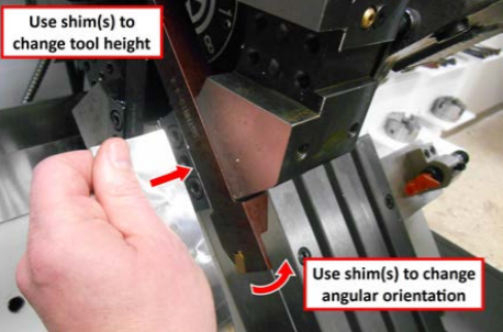

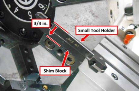

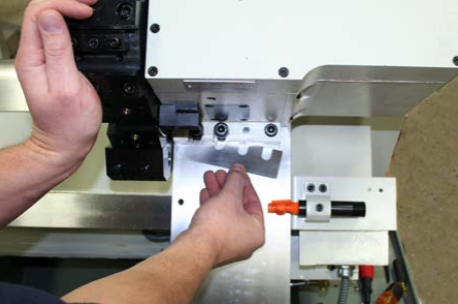

  1. Determine the shim thickness needed:
  • Because you're using a bore for alignment, the difference in the indicator readings is twice the required turret adjustment.
  • Use a shim that is half of the indicator reading discrepancy from Step 7 (for example, for a reading of 0.003 in., use a 0.0015 in. shim).

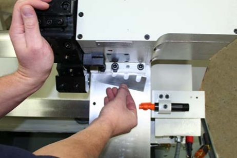

Adjust Y-Axis Alignment (Shim Installation)
  1. Before installing the shims, make sure that you can easily return to the current position of the turret:
  • From the PathPilot interface, in the X (Dia) DRO field, type 0. Then select the Enter key.
  • While you're installing the shims, be careful to not disturb the indicator.
  • We recommend backing the Z-axis away from the indicator before installing the shims.

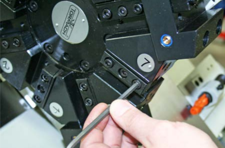

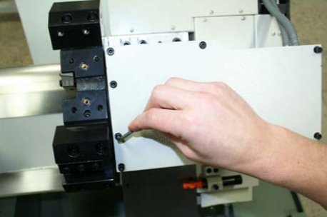

  1. Loosen the turret bolts (three on top, three on bottom) with an 8 mm hex wrench, but do not remove them.
  2. Verify that the shim is clean and free of debris, and then insert the shim under the front of the turret. Make sure that the shim doesn't bend while you're installing it.
Figure 24: Installing a shim under the front of the turret.
  1. Carefully tighten the outside and inside bolts on the front and rear of the turret. You can keep the middle bolt loose while you recheck the alignment.
  2. Recheck the X and Y readings. If readings are still off, adjust the shim thickness and repeat the process.
  3. Change to pocket number 7 and repeat X and Y alignment checks.
  4. Ensure both pockets show consistent readings.
  5. If necessary, adjust to balance the difference between both holders.

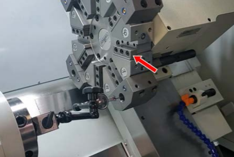

Verify Radial Alignment

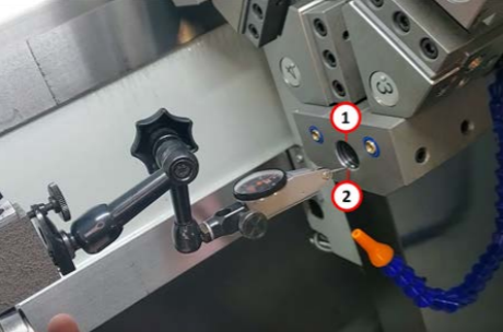

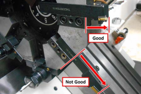

  1. Change to tool number 6.

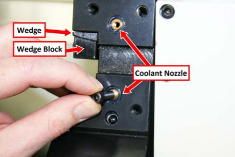

  2. Remove the wedge block from tool number 6, and clean off the face of the turret if necessary.
Figure 25: Wedge block on tool number 6.
  1. Mount the indicator on the Z-axis rail, and position the needle so that it's as parallel to the Z-axis as possible.
  2. Sweep the face from tool number 6 to tool number 2 with the indicator as shown in the following image.
Figure 26: Sweeping the dial indicator from tool 6 to tool 2.
  1. Note any discrepancy between the faces. This value determines the shim thickness needed. Minor deviations within 0.0005 in. are acceptable.
  2. Loosen the turret bolts, insert the shim at the rear of the turret, and re-tighten the bolts.
Figure 27: Installing a shim under the rear of the turret.
  1. Recheck alignment and make final minor adjustments as needed.
  2. Re-install the wedge block in tool number 6.
  2. Sweep the face of the turret with the indicator as shown in the following image. Make sure that you don't sweep over any features that are proud of the surface (like the coolant ports).
Figure 28: Sweeping the dial indicator across the Z-axis of the turret face.
  1. Note any movement in the dial indicator. Minor deviations within 0.0005 in. are acceptable.
  2. If adjustment is needed:
    1. Loosen turret bolts slightly.
    2. Use a rubber mallet to tap the turret into alignment.
    3. Re-tighten bolts and recheck alignment.
  3. Verify that all of the turret bolts are re-tightened.

Boring Bar Holder Use
IMPORTANT! Mark the factory-installed location of each boring bar holder on the turret with a paint pen for future re-install (if removed).
Two types of tool holders are pre-installed on the turret. If removal or relocation is necessary, unscrew four bolts on each.
Figure 30: Turret tool holder types.

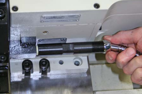

To insert a tool in any boring bar holder:
  1. Identify the tool pocket to be used and insert a 3/4” tool.
Figure 31: Installing a tool into the boring bar.
  1. Make sure that the tool is flat as shown in the following image. Tighten snugly. To remove a tool, reverse this process.
Figure 32: Example of a correctly installed tool.
NOTE: If using a smaller-sized tool, use appropriate-sized bushing.
Wedge Block/Tool Extraction
  1. Loosen two outside screws in the wedge block; remove the extraction bolt in the center hole and keep for later use.
Figure 33: Wedge block.
  1. When the tool is inserted, push the wedge back to seat in the rear of the pocket.
  2. Tighten the wedge block snugly.
  3. To extract the tool, loosen two wedge block screws, insert the extraction bolt into the center hole and — while holding the tool with one hand — screw in the extraction bolt until the tool comes free.
Coolant Nozzle
Use M5 × 8 mm socket head cap screw (or hex wrench) to aim the coolant nozzle as needed. Make sure that the nozzle allows coolant to flow to the cutting edge of the tool.
Figure 34: Coolant nozzle.

Shimming
Shimming of tools to set tool height and orientation is common in any lathe set up. Shims come in a wide variety of shapes, sizes, materials, and thicknesses. Shims typically range in size from 0.0005 in. to 0.01 in. or larger. Stacking of shims to get the right thickness is not ideal, but not uncommon either.
Nominal Tooling Size
We advise using 3/4 in. tooling for the turret, but it is possible to use smaller tool holders. Keep in mind that these must be shimmed so tool tip is in line with the spindle axis.
Figure 35: Example of using smaller tool holders.
Tooling Length
To reduce vibration and deflection, mount tools with the cutting tip as close to the turret clamp or block as possible.
Figure 36: Example of recommended tooling lengths.
Tool Turret Position Repeatability
While turret operation is fairly accurate and repeatable, it’s impossible to be perfect. During turret installation, height and alignment were adjusted for one pocket. This resulted in all other pockets being close to but not exactly the same pocket height and alignment at the first one. Since most lathe tools aren’t sensitive to this alignment, being off by, for example, 0.003 in. may not have any measurable impact on a part. Some tools, such as parting tools for example, need to be as close to perfect as possible. We recommend mounting tools sensitive to alignment in the first pocket (used for aligning the turret), or shimming (up/down, side to side) appropriately.
Figure 37: Example of using shims to adjust alignment.
There is sometimes a trial and error process that occurs to learn where this may or may not be relevant.
IMPORTANT! Be aware that it is possible for a tool to be mounted out far enough that it could crash into the lathe bed.
IMPORTANT! Some 3/4 in. boring bars can protrude out too far towards the turret base, resulting in a crash during a tool change. To eliminate this issue, cut the boring bar shorter.

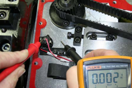

Lock Switch Adjustment
The turret has a tool lock switch that may require adjustment to achieve a complete locking of the turret face after a tool change. To adjust:
  1. Push the Emergency Stop button.
  2. Remove eight socket head cap screws to remove the motor cover from turret.
Figure 39: Removing the motor cover.
  1. Pull on the motor belt in a clockwise direction to rotate turret motor until turret is in a fully-locked position.
Figure 40: Motor belt.
NOTE: A spare motor belt is located under the motor cover.
  1. Check to make sure that the turret is locked by inserting a 3/4 in. broom handle (or similar wooden dowel) into the pocket and then rotating the turret back and forth. The turret is mechanically locked when no further rotation is possible.
Figure 41: Verifying that the turret is locked.
IMPORTANT! Only use a wooden material for this test. Other materials may damage the turret.
  1. On the operator panel, twist out the Emergency Stop button, and then push the Start button.
  2. Use a flat-head screwdriver to loosen two screws on the lock switch bracket.
Figure 42: Lock switch bracket.

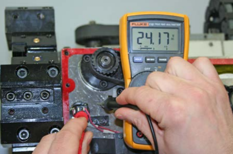

  1. Move the bracket left and, using a multimeter, touch contact and a ground; adjust switch location until the multimeter reads 0 volts.
Figure 43: Multimeter set up.
NOTE: Ensure that your multimeter lead is placed on the pink wire as shown. The position of the wire on the switch may differ from the pictured position.
  1. Move the bracket right until multimeter reads 24 volts.
Figure 44: Multimeter set up.
  1. Re-tighten the bracket and re-install the motor cover.

  1. At back of the lathe, disconnect the oil line from the oil manifold.
Figure 45: Disconnecting the oil line.
  1. Use a Phillips screwdriver to remove the oil line bracket and set it aside.
Figure 46: Oil line bracket.
  1. Put the disconnected oil line back through the carriage.
  1. Reconnect the oil line to the manifold.

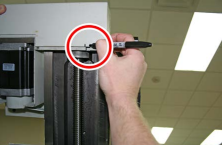

  2. Locate the notch below the X-axis motor cover, and mark the cutout location.
Figure 47: Marking the cutout location.
  1. Use a Phillips screwdriver to remove four screws on the X-axis motor cover, and then remove the motor cover. Set all aside.
  2. Slowly move the X-axis down, making sure to not pinch the oil line.
  3. Attach the oil line bracket (set aside earlier) to the oil line and position as shown in the following image. Make sure that the tension in the oil line is correct. Then, mark a drill hole for the bracket.
Figure 48: Oil line bracket attached.

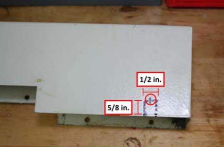

  1. Use a #19 drill, M5 × 0.8 tap, and a tapping handle to drill and tap the marked location.
  2. Mark a cutout slot — 5/8 in. × 1/2 in. — on the X-axis motor cover as shown in the following image. Use a 1/2 in. drill bit to drill a hole
Figure 49: Cutout slot marked on the X-axis motor cover.
  1. Use a hacksaw to cutout the remainder of the slot.
  2. Reinstall the X-axis motor cover. Make sure that the oil line has clearance around the slot.
Figure 50: Oil line clearance checks.
