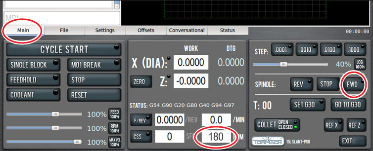

  1. On the Main screen in the PathPilot interface, set chuck speed by entering 180 in the RPM field (see Figure 1). Then, press the Enter key on the keyboard.
  2. Click Spindle FWD to start spindle rotation (see Figure 1).

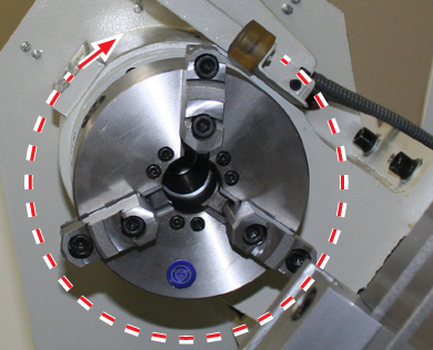

  3. Observe spindle direction to confirm forward is correct (see Figure 2).
Figure 2: Correct Forward Spindle Direction

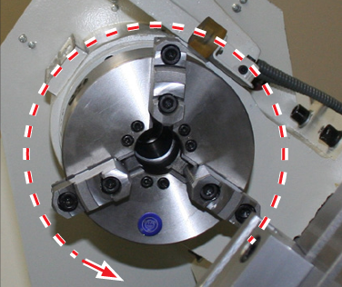

  1. Repeat to confirm reverse is correct by clicking Spindle REV and observing spindle direction (see Figure 3). If not rotating as shown, refer to Spindle Direction is Reverse.
Figure 3: Correct Reverse Spindle Direction

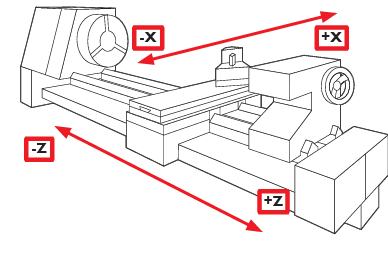

The lathe has two axes of motion, denoted as the X-axis and the Z-axis. The Z-axis is parallel to rotational axis of the spindle. The X-axis is perpendicular to the Z-axis and nominally parallel to the long dimension of the carriage (see Figure 4). The –X direction is toward the front and +X direction is toward the rear. The –Z direction is toward the headstock and the +Z direction is opposite the headstock.

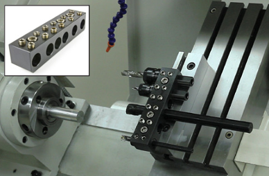

Gang Tooling
A gang tooling plate with three T-slots and a riser block can be mounted to the carriage to facilitate mounting tool holders in industry-standard, gang-tool holding blocks (see Figure 7). Risers are available for both 1/2” and 3/4” centerline heights.
Figure 7
This option offers higher precision and faster tool change times than a manual tool post or turret, but requires vigilance to ensure appropriate clearance between tool, workpiece, and chuck/spindle nose. Gang setups are ideal for small diameter, short parts. Additionally, gang blocks can be swapped out as a single unit, dramatically reducing part setup time.

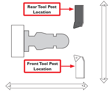

Front Tool Post and Rear Tool Post Locations
Tools are mounted on the carriage in either a front tool post or rear tool post position. Front tool post tools address the workpiece by moving in +X direction (see Figure 8).
Figure 8: Right-handed Tool

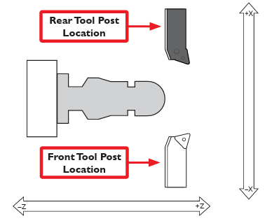

Rear tool post tools address the workpiece by moving in –X direction (Figure 9).
Figure 9: Left-handed Tool
