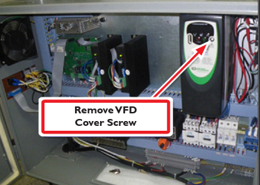

2. Locate the VFD in the electrical cabinet (see Figure 1). Using a Phillips screwdriver, remove the VFD cover.

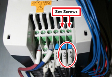

3. Identify motor wires #401 and #402, located at the bottom of the VFD (see Figure 2). Loosen the set screws above wires #401 and #402 and swap the wire connections (see Figure 2). When complete, retighten the set screws.

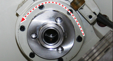

6. On the Main screen in the PathPilot interface, click Spindle FWD to start spindle rotation.
7. Confirm the spindle is rotating in the correct forward direction (see Figure 3.
