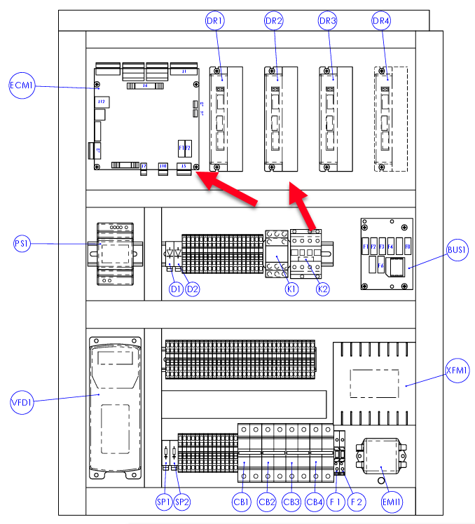

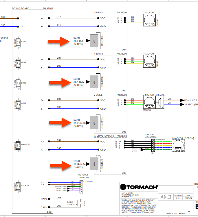

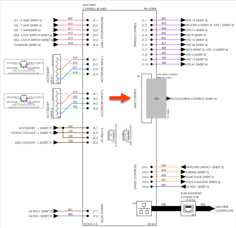

  3. Examine the data cable at the machine control board and the axes drivers.
      1. 423.1 (X-axis)
      2. 423.2 (Y-axis)
      3. 423.3 (Z-axis)
M Axis Drivers
M ECM Board
770M ECM and Driver Locations

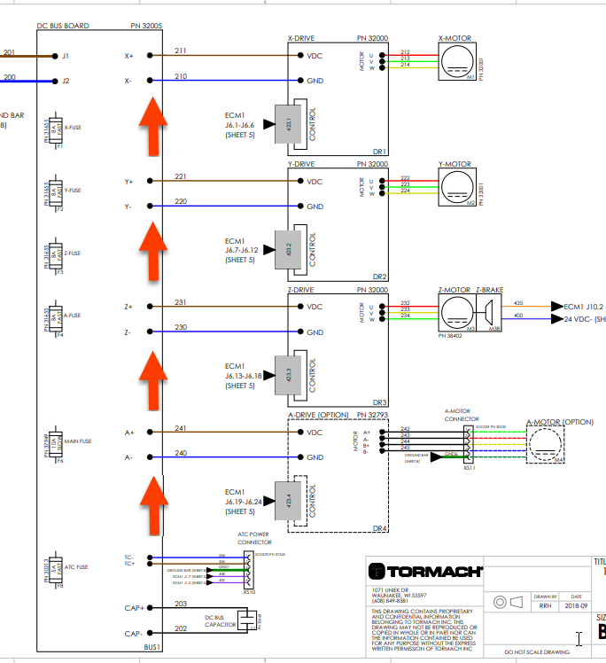

    DC-Bus/Stepper driver controllers: Spade connectors/Degson style
    1. 210/211 (X-axis)
    2. 220/221 (Y-axis)
    3. 230/231 (Z-axis)

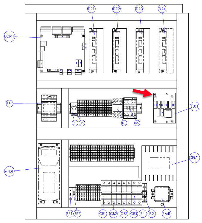

M DC Bus Board
770M DC-BUS Location
Inspect the DC-BUS Board
Reason: The DC-BUS or DC power supply is malfunctioning.
    1. If it does: The stepper driver controllers will be illuminated, if the axis fuses are not blown. To check individual axis fuses, see: One Axis Won't Move (or Only Moves in One Direction), and Other Axes Move - 770M | Inspect the DC Power Supply

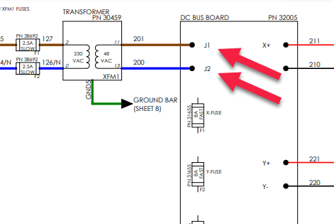

  2. Power off the machine.
    1. 200 (J2)
    2. 201 (J1)
  5. Continue to the next troubleshooting topic.

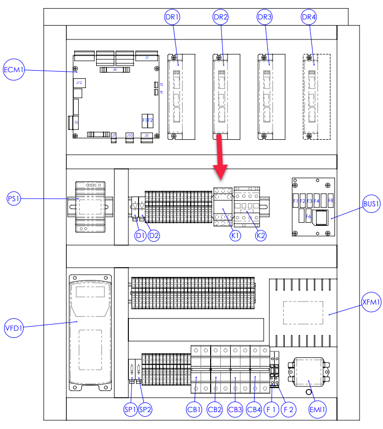

Check the K1 Contactor
Reason: The K1 is defective.
  2. Inspect the K1 for an illuminated red LED that indicates it has power.
    1. If the light is on: The K1 is latched. Using a digital multimeter set to Vac, measure for 220 Vac between:
