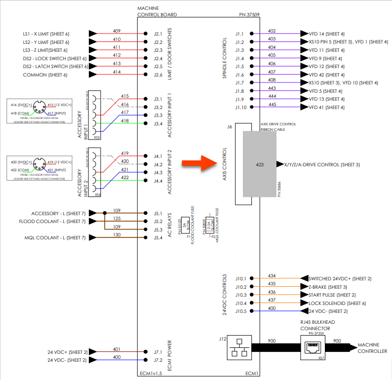

      1. 423.1 (X-axis)
      2. 423.2 (Y-axis)
      3. 423.3 (Z-axis)

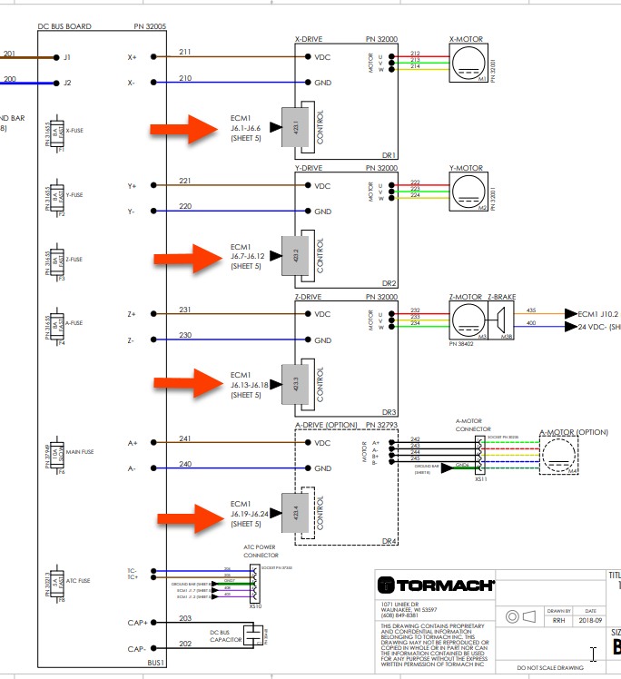

M Axis Drivers
M ECM Board

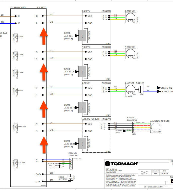

    1. DC-BUS: Spade connectors
      1. 210/211 (X-axis)
      2. 220/221 (Y-axis)
      3. 230/231 (Z-axis)
    2. Stepper driver controllers: Degson style
      1. 211-214 (X-axis)
      2. 221-224 (Y-axis)
      3. 231-234 (Z-axis)

Inspect the DC Power Supply
Reason: There's a blown fuse on the DC-BUS board.
    1. If the green LED is not illuminated: Go to All Axes Won't Move When Commanded - 770M
