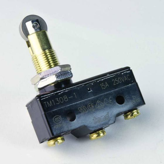

  4. Locate the malfunctioning limit switch, take a picture for future reference, and then remove the wires with a screwdriver.
  5. With the switch in its normal state (not depressed), measure the resistance across the switches NC (normally closed) and C (common) terminals with digital multimeter set to resistance.
    1. If the digital multimeter reads OL, shows a resistance in the MΩ, and/or doesn’t produce continuity tone, replace the switch.
    2. If the switch measure 0-5 Ω, continue to the next step.
  6. With the switch depressed, measure the resistance across the switches NC (normally closed) and C (common) terminals with digital multimeter set to resistance.
    1. If the switch measure 0-5 Ω, replace the switch.
    2. If the digital multimeter reads OL, shows a resistance in the MΩ, and/or doesn’t produce continuity tone, reinstall the switch.
