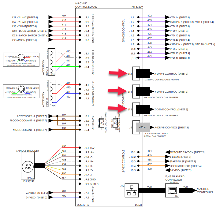

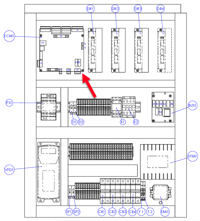

  3. Examine the data cables at the machine control board and the servos removing then re-connecting them to ensure they are seated.
    1. Machine control board: Degson style
      1. 424 (J13) (X-axis)
      2. 425 (J14) (Y-axis)
      3. 426 (J15) (Z-axis)
    2. Servos: Molex style
770MX ECM Board
770MX ECM Board Location

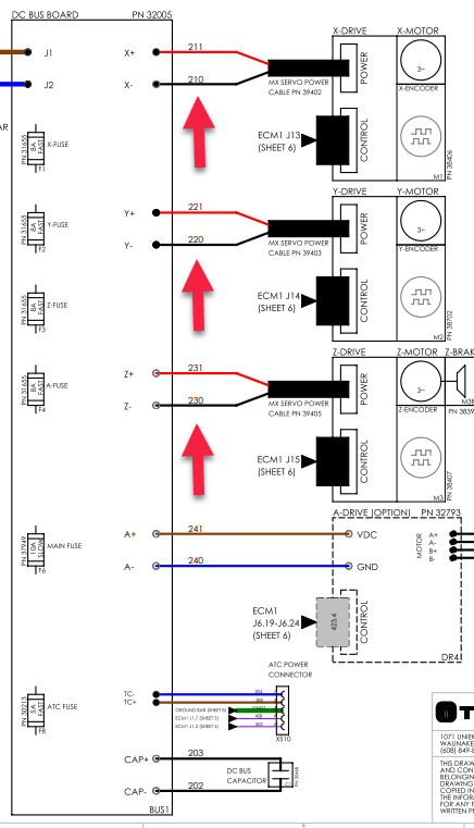

  1. Examine the power cables at the DC-BUS and the servos removing then re-connecting them to ensure they are seated.
    1. DC-Bus: Spade connector
      1. 210/211 (X-axis)
      2. 220/221 (Y-axis)
      3. 230/231 (Z-axis)
770MX DC Bus Board
770MX DC-BUS Location

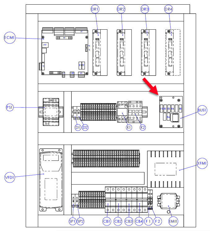

Inspect the DC-BUS Board
Reason: The DC-BUS is malfunctioning.

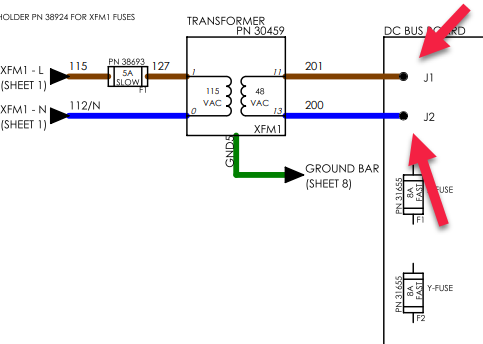

  2. Power off the machine.
    1. 200 (J2)
    2. 201 (J1)
Inspect the XMF1 Transformer
Reason: The fuse(s) have blown.

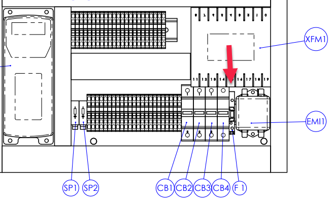

  1. Power off the machine.
  2. Remove and measure the resistance across the F1 then F2 fuses with digital multimeter set to resistance.
    1. Replace the fuses if the digital multimeter reads OL, shows a resistance in the MΩ, and/or doesn’t produce continuity tone.
    2. If the fuses measures 0-5 Ω reinstall them.
770MX Electrical Cabinet XFM1 Fuse location

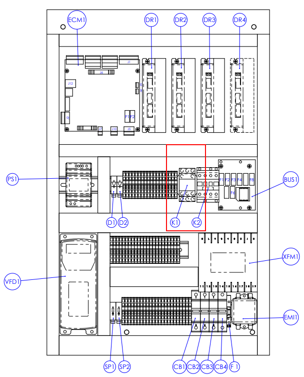

Check the K1/C1 Contactor
Reason: The K1/C1 is defective.
  2. Inspect the K1 for an illuminated red let that indicates it has power.
    1. If the light is on: The K1 is latched. Using a digital multimeter set to Vac, measure for 120 Vac between:
      1. 112N
      2. 115
770MX Electrical Cabinet K1 Location
  1. Press and hold the Reset button on the operator box and observe the K1 LED. Then release the Reset button and observe the K1 LED.
    1. If the light only stays on when the button is pressed: There is a loose coil wire, short, or the K1 has malfunctioned.
