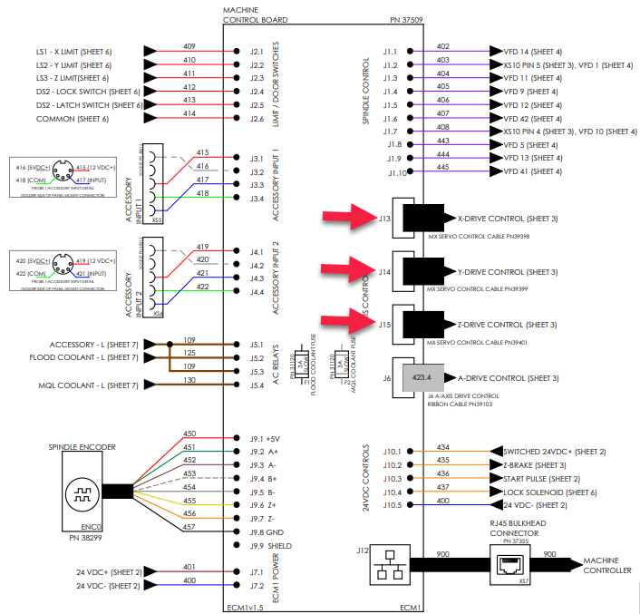

  2. Examine the data cables at the machine control board and the servos removing then re-connecting them to ensure they are seated.
    1. Machine control board: Degson style
      1. 424 (J13) (X-axis)
      2. 425 (J14) (Y-axis)
      3. 426 (J15) (Z-axis)
    2. Servos: Molex style
770MX ECM Board

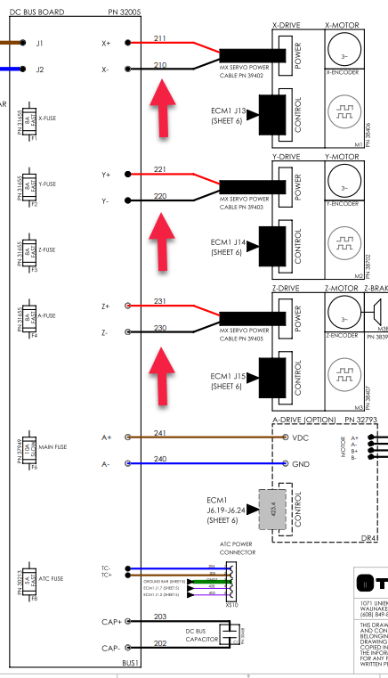

  1. Examine the power cables at the DC-BUS and the servos removing then re-connecting them to ensure they are seated.
    1. DC-Bus: Spade connector
      1. 210/211 (X-axis)
      2. 220/221 (Y-axis)
      3. 230/231 (Z-axis)
770MX DC Bus Board
