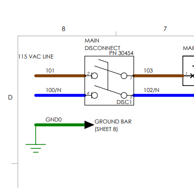

  • The main disconnect switch
  • Digital multimeter
  2. Press the Reset button.
  1. Examine the building’s breaker. If it's not already on, turn it on.
Machine
Wires
Measure for…
770M/MX
101 and 100/N
115 Vac nominal
770M/MX Disconnect Switch

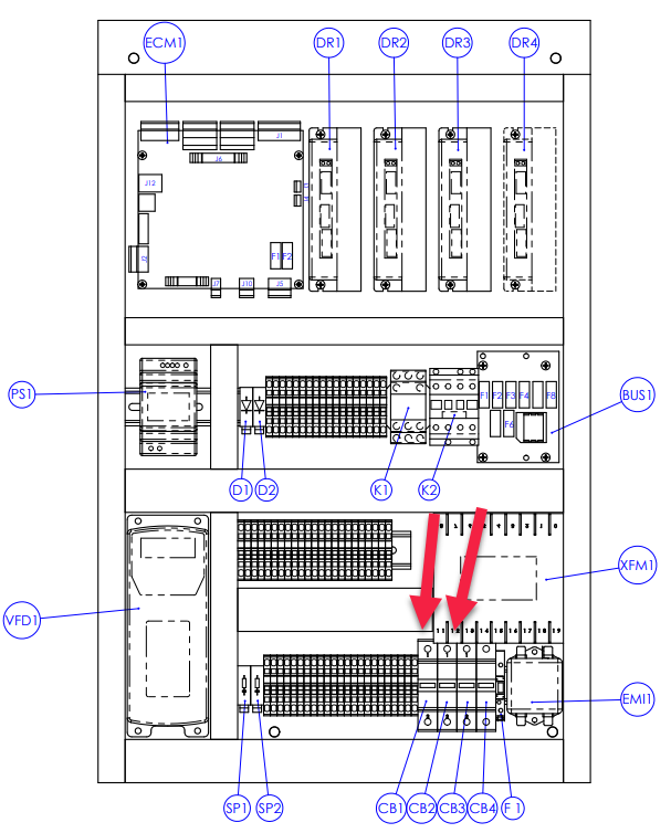

Reset the CB1 and/or CB2 Circuit Breaker
Reason: The CB1 and/or CB2 circuit breaker tripped.
  1. Measure the wires as indicated below.
  2. If required, power off the machine and reset the tripped breaker.
Machine
Wires (CB1 and CB2)
Measure for…
770M/MX
105 and 100/N
and
107 and 100/N
115 Vac nominal
770M/MX Electrical Cabinet CB1 and CB2 Location

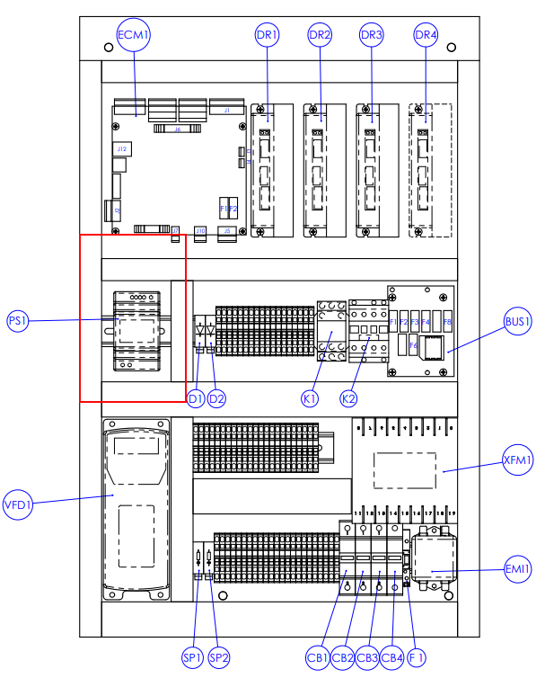

Inspect the DC Power Supply (PS1)
Reason: The DC power supply PS1 is defective.
  1. With a multimeter measure the Vdc between 400 and 401.
  2. If the digital multimeter reads below 22 Vdc, with a multimeter measure between 112/N and 113 for the input Vac.
    If the input Vac is correct, replace the DC power supply.
Machine
Wires
Measure for…
770M/MX
400 and 401
24 Vdc nominal
Machine
Wires
Measure for…
770M/MX
112/N and 113
115 Vac nominal
770M/MX Electrical Cabinet PS1 Location

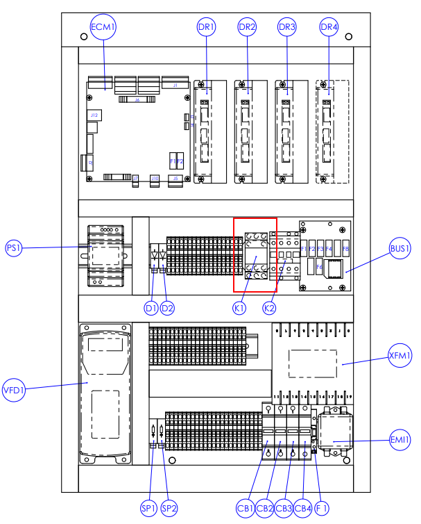

Inspect the K1 Contactor
Reason: The contactor K1 is defective.
  1. Examine the K1 contactor’s red LED light. Depending on the state, do one of the following:
    1. Red LED is On. This indicates that the contactor is latched. Use a digital multimeter to examine the power at K1-1 and wire 115.
    2. Red LED is Off. Press and hold the Reset button and observe the LED on K1:
      1. If it's on, K1 has a latching circuit issue.
      2. If it's not on, K1 may have a coil issue.
770M/MX Electrical Cabinet K1 Location
Contactor K1 energizes the DC-BUS board, which provides 65 Vdc to the machine. K1 can fail by not energizing the coil, or the contacts could fail.
