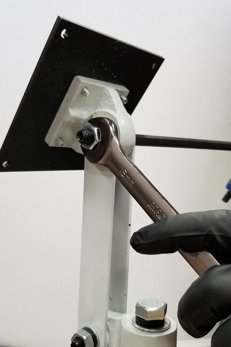

Figure 3: Incorrect and correct orientations of the monitor bracket on the Controller Arm.
Figure 4: Tightening the monitor bracket in place.

  1. Adjust the position of the monitor and the keyboard tray with an 8 mm hex wrench and a 16 mm wrench. Once complete, securely tighten the pivot screws.
