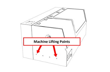

  1. Find the four M10 lifting eyelets provided in the tool box. You'll use them as lifting points to move the machine off of the pallet.
  2. Install the two M10 lifting eyelets into each end of the machine by hand in the locations shown in the following image. Verify that the lifting eyelets are installed hand tight.
Figure 1: Lifting points on the left side of the machine.

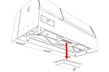

  1. Remove the drip tray from the bottom of the machine.
Figure 2: Removing the drip tray from the bottom of the machine.

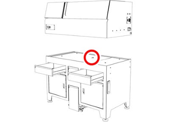

  1. Carefully lower the machine onto the machine stand while routing the coolant tube through the hole in the middle of the stand.
Figure 4: Route the coolant tube though the hole in the stand.

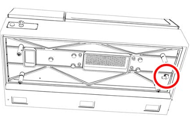

Figure 5: Coolant tube fitting on the bottom of the machine.
