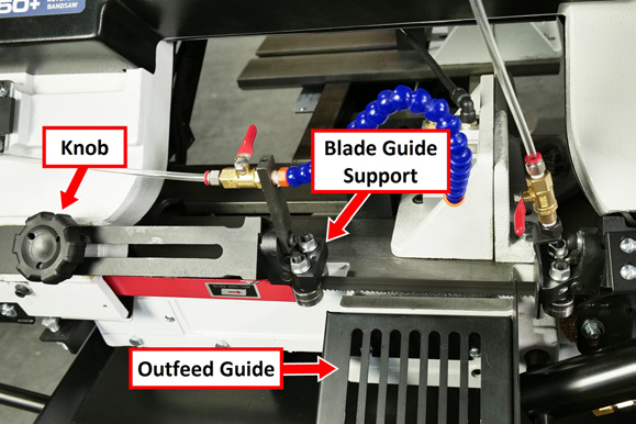

  1. Identify the knob on the blade support guide. Then, loosen it.
Figure 1: Blade support guide and its knob.
  1. Move the blade support guide toward the material. Stop when it's 1/4 in. from the material.
  2. Tighten the knob on the blade support guide.

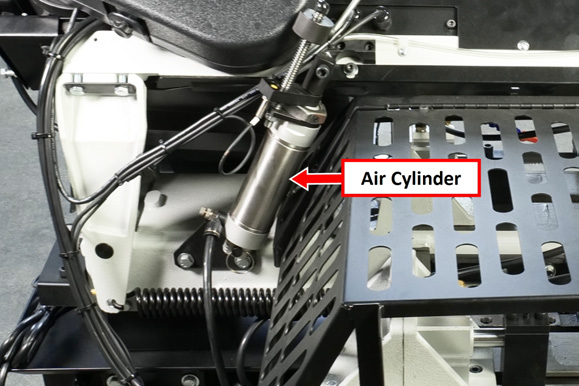

  3. On the back of the machine, identify the air cylinder, as shown in the following image.
Figure 2: Air cylinder on the back of the machine.

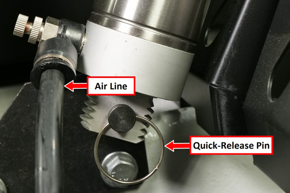

  1. Remove the cotter clip (on the end of the quick-release pin).
Figure 3: Quick-release pin on the air cylinder.
  1. Pull the quick-release pin out of the air cylinder, and set it aside.

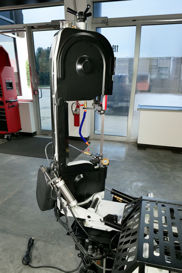

    The air cylinder hangs from the saw head.

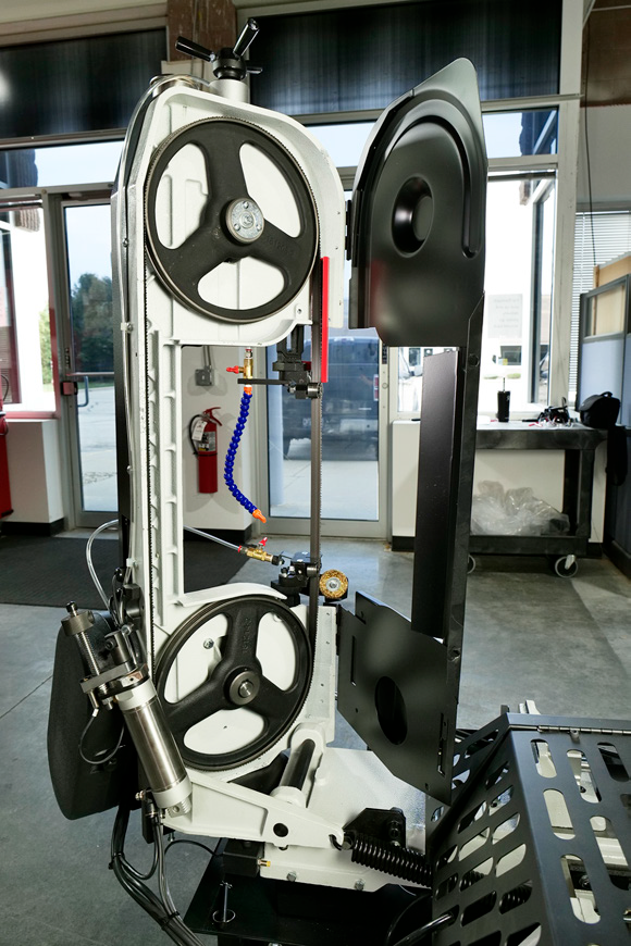

  2. Lift the saw head to the upright position, as shown in the following image.
Figure 4: Bandsaw head lifted upright.

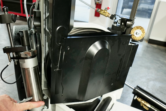

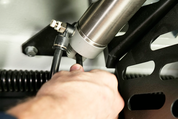

  1. Loosen the bolt securing the air cylinder to the bandsaw with an 8 mm hex wrench until the door can open. Make sure the bolt is still secure enough to hold the air cylinder in place — letting the air cylinder hang adds extra strain to the wires.
Figure 5: Bolt on the air cylinder.
  1. Slide up the bottom of the blade cover, and then slide the blade cover up until it clears the base casting.
Figure 6: Blade cover.
  1. Remove the two screws from the side of the blade cover with a 5 mm hex wrench, and then set aside the screws.
Figure 7: Removing the screws securing the blade cover to the bandsaw.

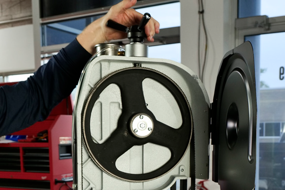

  1. Open the blade cover, as shown in the following image.
Figure 8: Blade cover opened.
  1. Identify the tensioner on the top of the saw head.
Figure 9: Tensioner on top of the saw head.
  1. Verify that the blade tension is set correctly.

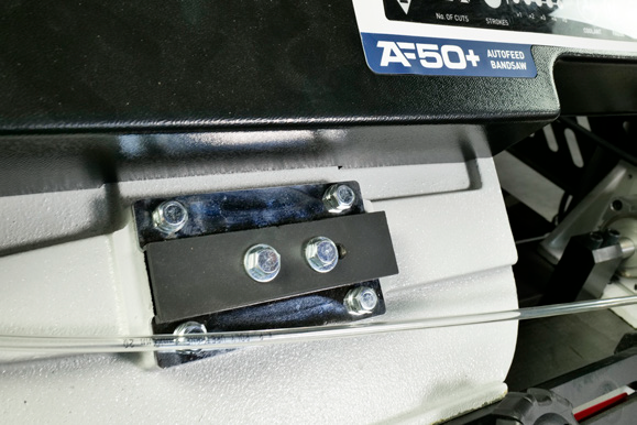

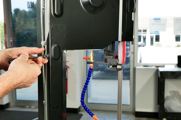

  1. Identify the two socket head cap screws with washers on the front of the bandsaw. Then, loosen them with a 6 mm hex key wrench.
Figure 10: Socket head cap screws used to adjust the blade tracking.
  1. Identify the socket head cap screw without a washer.
  2. Use the socket head cap screw without a washer to adjust the blade tracking. While observing the blade as it moves, do one of the following:
  • Track Closer to Wheel Shoulder Turn the socket head cap screw without a washer clockwise.
  • Track Away from Wheel Shoulder Turn the socket head cap screw without a washer counterclockwise.
  1. Put a piece of paper between the blade and the wheel to test the blade tracking.
  2. With the paper held in place, slowly turn the socket head cap screw without a washer to track the wheel closer to the shoulder. Continue turning until the paper is cut into two pieces.
  3. Slowly back off the socket head cap screw without a washer to move it slightly away from the wheel shoulder.
  4. Tighten the two socket head cap screws with washers on the front of the bandsaw.

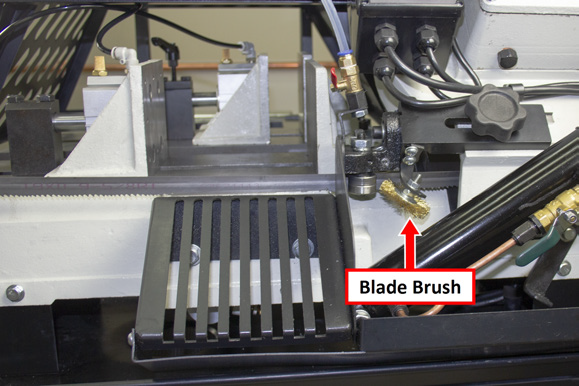

  1. Identify the blade brush.
Figure 11: Blade brush.
  1. Adjust the blade brush until its bristles overlap the blade.
    If the Blade Brush (PN 38033) is worn or damaged, you must replace it.

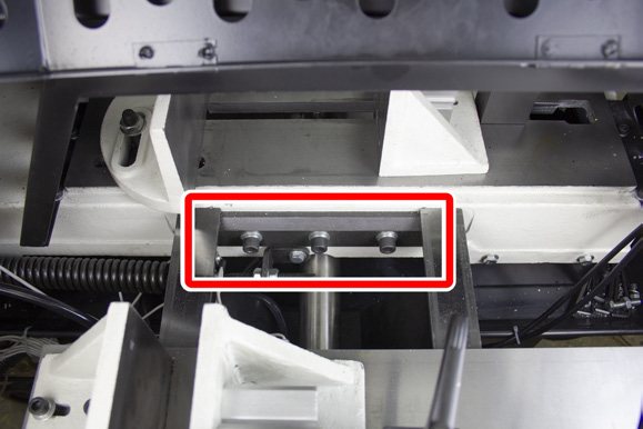

Adjust the Height of the Infeed Table

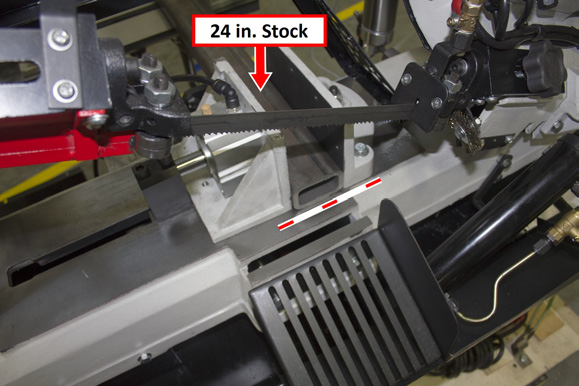

  1. Find a piece of 24 in. stock. We recommend using one of the following:
  • Cold-rolled steel (that's at least 1 in. square)
  • Extruded aluminum (that's at least 1-1/2 in. square)
  • Structural tubing (that's at least 1-1/2 in. square)
  1. Move the infeed table so that it's approximately in the center of travel.
  2. Loosen three M10 socket head cap screws on the base casting. This allows you to adjust the height of the infeed table.
Figure 12: M10 socket head cap screws on the base casting.
  1. Open the clamps on both vises with the handwheel and the clamp handle. Then, load the stock between the vises as shown in the following image.
Figure 13: Stock loaded between the vises.
  1. Close the vise with the handwheel until the material is secure. Verify that the stock is flat against the entire length of the base casting.
  2. Lift and secure the guide rail and the infeed table to the stock with clamps, as shown in the following image.
Figure 14: Clamp secured to the 24-in. stock.

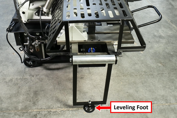

  2. If required, adjust the leveling foot.
Figure 15: Leveling foot.

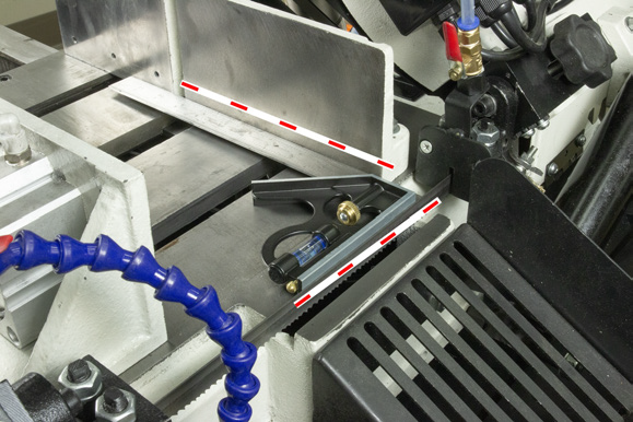

Adjust the Jaws
Align the Fixed Jaw
  1. Open the jaws so that there's enough space to put a square in between them.
  2. Put a square on the base casting between the jaws.
  3. Push the square until it's flush with the side of the blade.
NOTE: The square must be flush with the side of the blade, not the blade's teeth.
  1. Loosen the two screws securing the fixed jaw to the base casting with a box end wrench.
  2. Tap the fixed jaw until it's flush with the side of the square. Verify that the square is still flush with the side of the blade.
Figure 16: Fixed jaw aligned with the blade.
  1. Tighten the two screws securing the fixed jaw to the base casting. Confirm that it remains flush with the square.

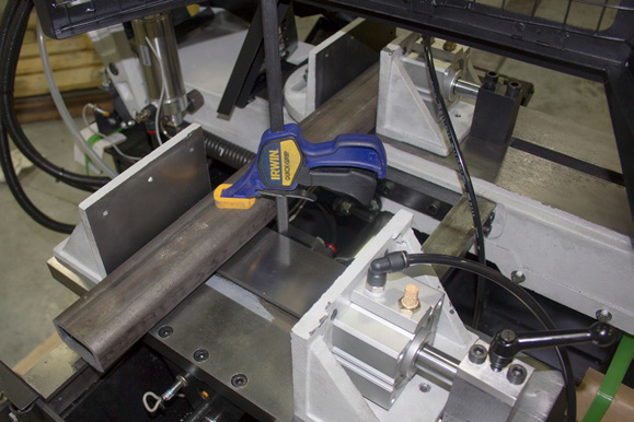

Figure 17: Stock loaded between the vises.
  2. Loosen the four M8 socket head cap screws securing the fixed clamp jaw to the infeed table.
Figure 18: M8 socket head cap screws on the fixed clamp jaw.
  1. Secure the stock to the fixed jaw with a clamp.
  2. Tap the fixed clamp jaw until it is flush with the side of the stock.
  3. Tighten the four M8 socket head cap screws that you loosened in Step 4. Verify that the fixed clamp jaw remains flush with the stock.
  4. Remove the clamp from the machine.
  5. Remove the stock from the machine.
