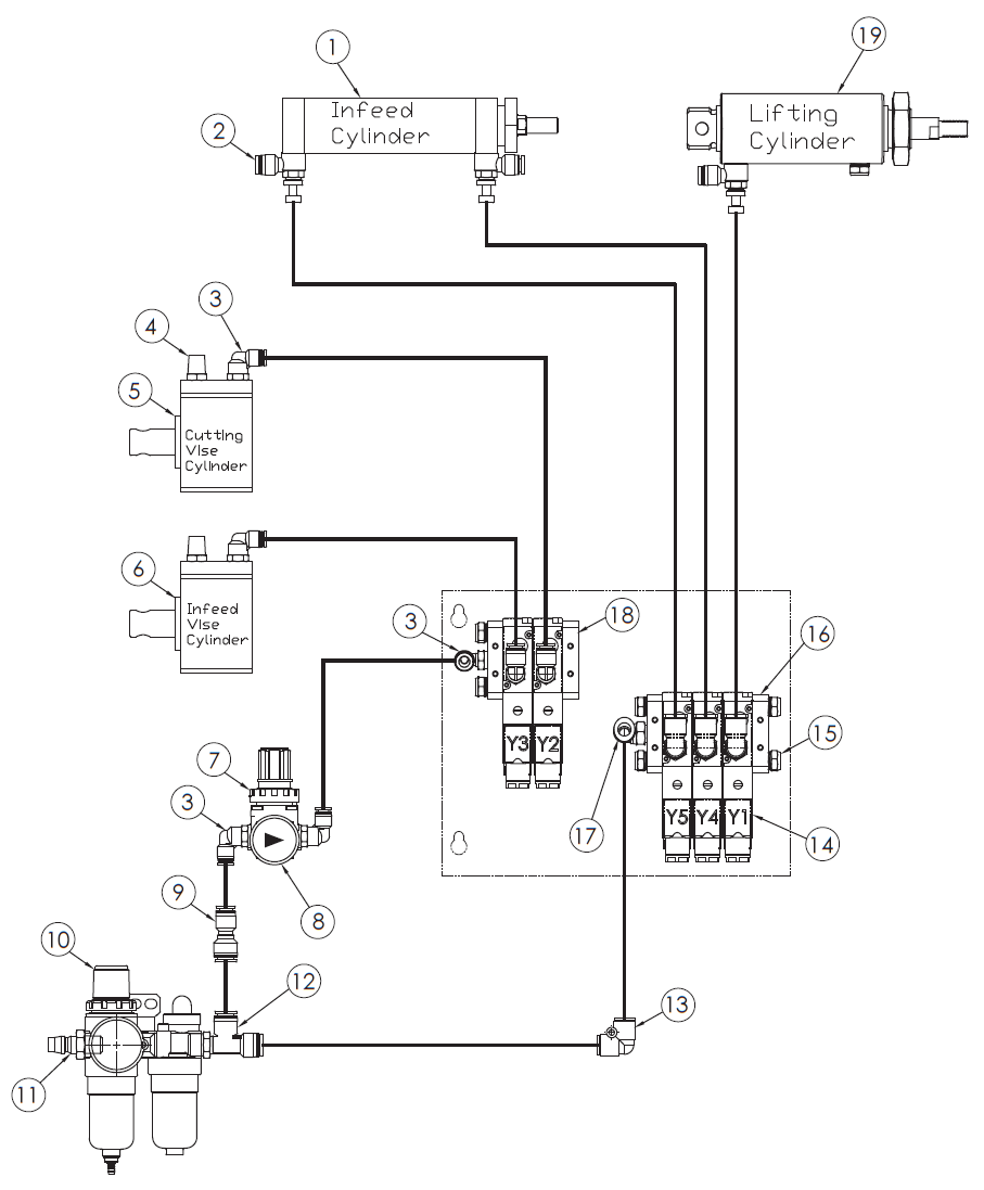

Pneumatic System - AF50+
Infeed Cylinder
Speed Controller
Male Elbow
Silencer
Compact Cylinder
Compact Cylinder
Pressure Regulator
Pressure Gauge
Fitting
Regulator
11
Fitting
12
Fitting
13
Fitting
14
Solenoid Valve
15
Silencer
16
Manifold
17
Fitting
18
Manifold
19
Lifting Cylinder
