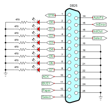

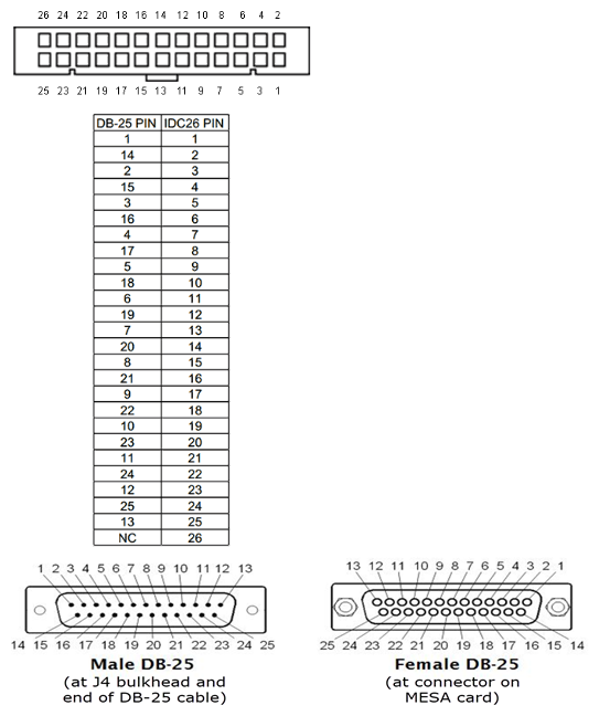

The DB25 is the serial communication line that connects the controller to mill. Once connected to the electrical cabinet the signal travels down a ribbon cable to an IDC26 connector. This connects to the machine control board or MX3660.
The images below are general pin alignment and the following charts show detail the DB25 pin responsibilities.
