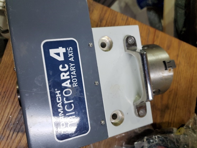

  1. Power off the machine and disconnect the MicroArc cable from the machine bulkhead connector. Remove the retaining ring from the back of the motor, the button head screws from motor cover, and loosen the cable gland from the cover. Set all screws in a magnetic dish.
  1. Feed the motor cable through the cable gland until you have approx. 2 feet (50cm) of cable left. Set the cover to the side. Remove the 4 screws securing the motor to the housing. Remove the 6 Torx screws holding the drive adapter to the motor flange.
  1. Cut the motor cable, remove the cable end and motor. Remove the cable gland and gland nut from the original cable. Discard both the cut cable end and original motor. Feed the replacement cable through the cover as show, from the inside out. Feed the cable gland, gland nut, and replacement connector shell onto the replacement motor cable as shown.
  1. Connect the motor pins to the replacement connector according to the below image. The pin number is stamped next to its cavity. The image is shown looking at the back of the connector (pins will be inserted in the side that threads into the connector shell pictured above).
  1. Ensure the wires are seated fully with a light tug. The wires should snap into position. If a wire is placed in an incorrect cavity, use the pin removal tool to remove the wire and reseat it in the correct cavity.
  2. Thread the shell onto the connector and secure the shell with the two Phillips screws. Secure the drive adapter to the replacement motor, attach the motor to the housing, and feed the motor cable through the cover until there is only 3-4 inches (75-100mm) of slack in the cover. Secure the cable gland nut and reattach the cover.
  3. Reconnect the motor cable to the machine bulkhead, power on the machine, and test the MicroArc functionality.
