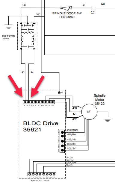

Verify that the BLDC is Getting Power
Reason: The BLDC is defective.
  1. Using a multimeter, confirm you have power getting to the BLDC between L1 and L2.
PCNC 440 BLDC
a. If there is power but nothing on the display, contact Tormach Technical Support.

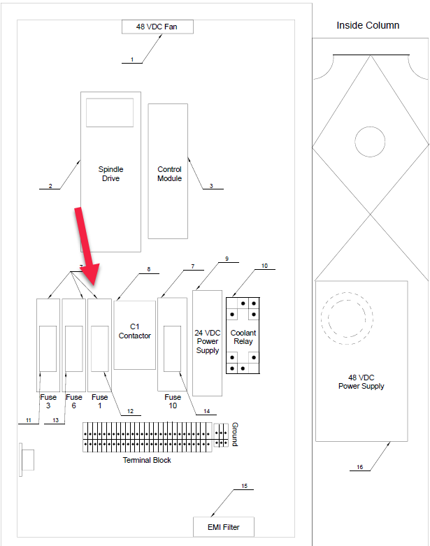

b. If there is no power, review the previous solutions to try and re-establish power. Also, check the F1 - 6 amp fuse.
PCNC 440 F1 location

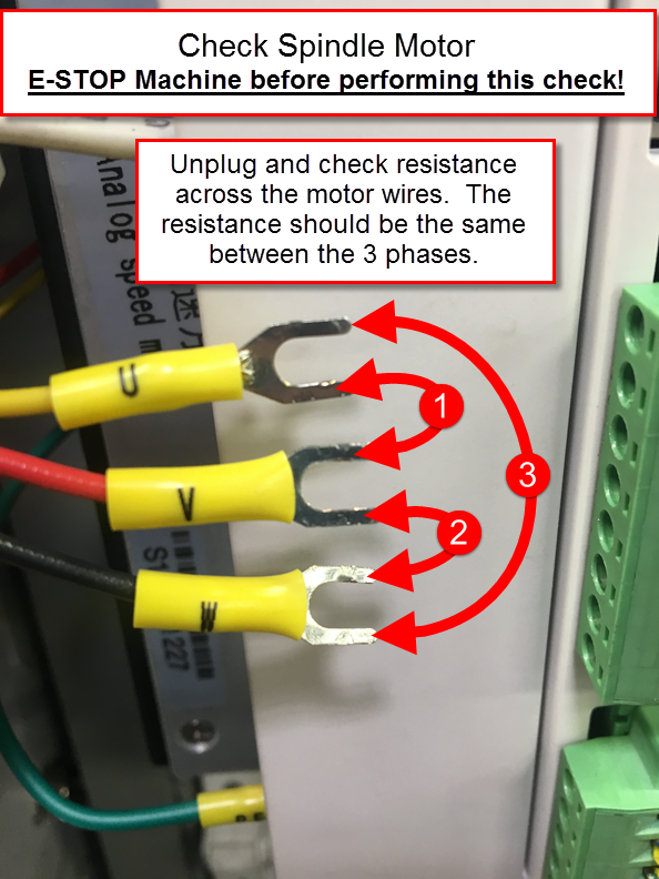

Measure the Motor Resistance (Ω)
  1. Power off the machine.
    1. Wires U and V
    2. Wires U and W
    3. Wires V and W
  5. Numbers outside of the specified range indicate that the motor or its wiring is bad and needs to be replaced.
