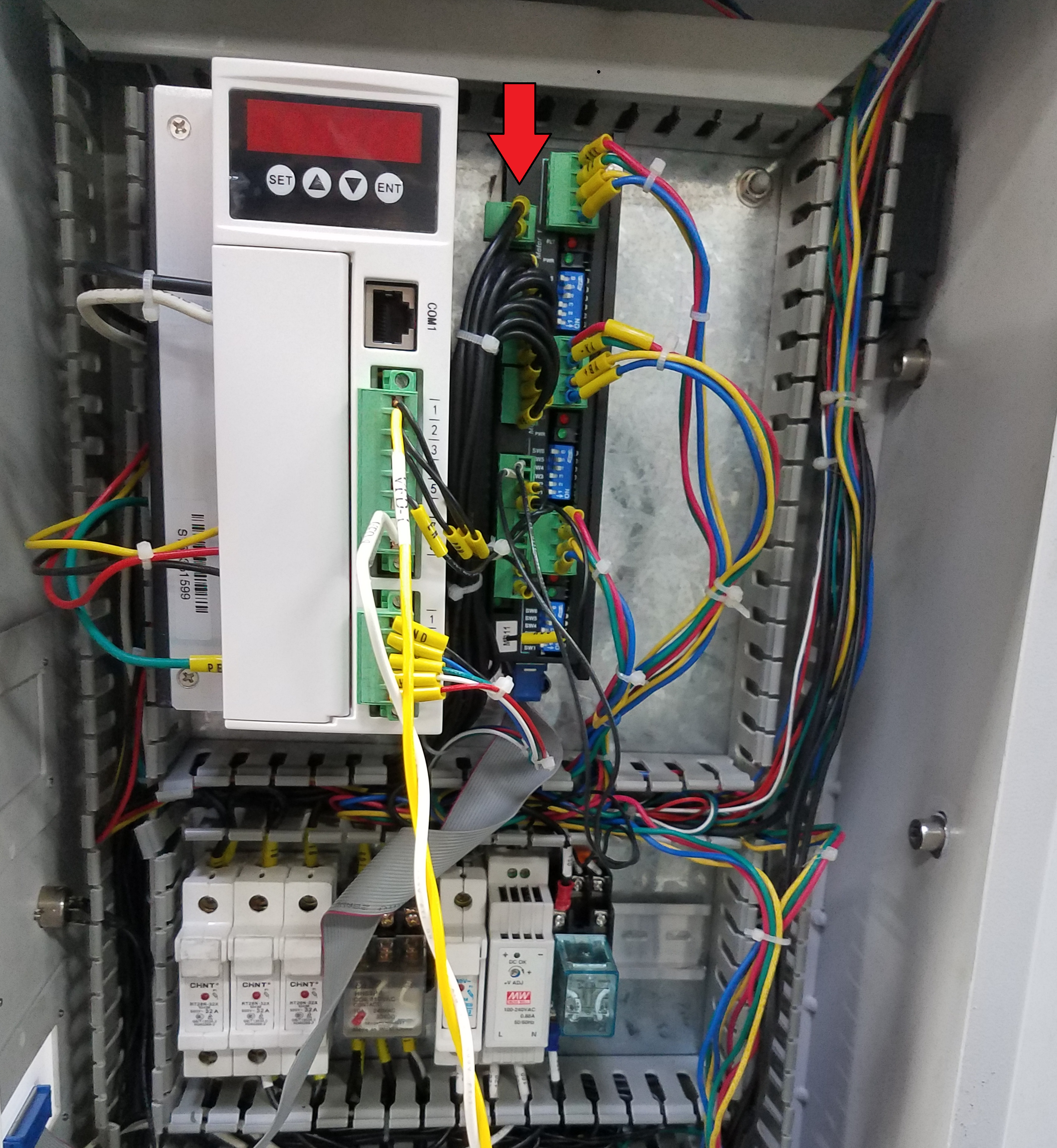

Check LEDs on MX3660 Driver
Reason: Power failure to driver
If the stepper driver controller has an illuminated green light: It is ready and operating normally and you should continue to the next topic.
If the stepper driver controller has an illuminated red LED: The machine should be power cycled to try and reset the stepper driver controller or the stepper driver controller needs to be replaced.
If the are no lights on the stepper driver controller: Continue to Inspect your 48V supply.

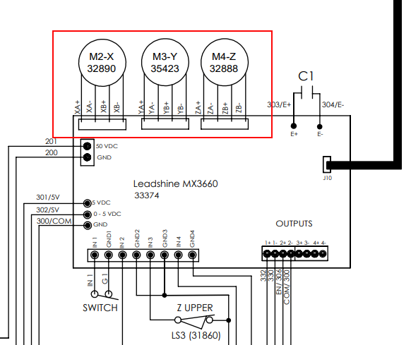

Reseat the Connectors on the MX3660 and Motors
Reason: Control signals aren't reaching the electronic driver module
Stepper Connections on MX3660
PCNC 440 MX3660 Fan Test
Reason: The MX3660 is malfunctioning
If the fan is not running, there may be a short in the driver
Power off the machine.
Remove the back panel from the machine.
Remove wires 200-201. Check for the fan function.
Power on the machine.
If the fan comes on, replace the driver. If not, continue on.

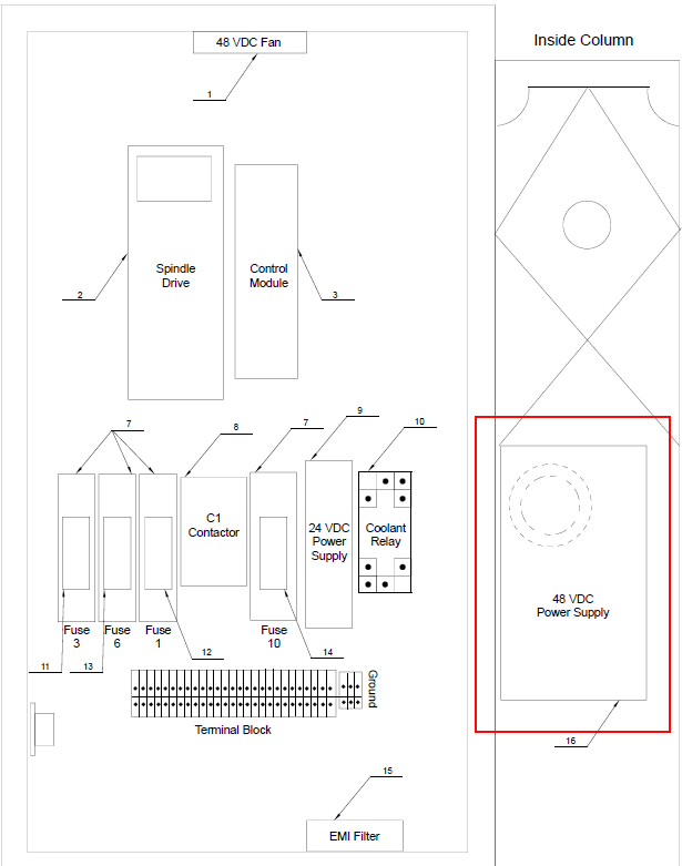

Inspect the 48v DC Power Supply
Reason: The DC power supply is malfunctioning.
Check for voltage between wires 200 and 201 from the power supply for 48v. If no voltage is present inspect the primary AC side of the supply. (Wires 120-100) If no voltage is present, continue on through the troubleshoot.
Location of 48v DC Power Supply

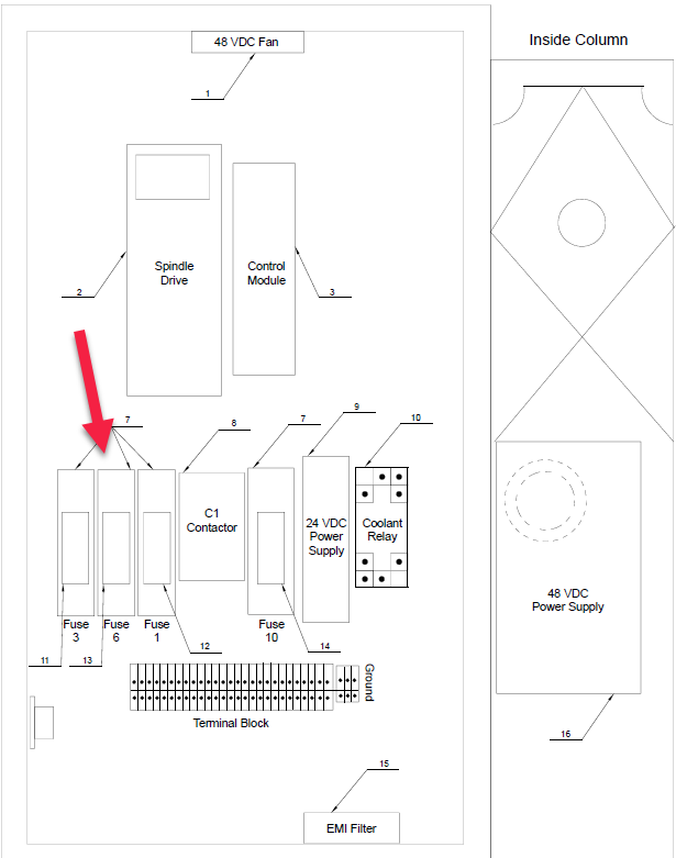

Inspect the F6 Fuse
Reason: The fuse have blown.
To learn how to check a fuse, see: Checking a Fuse on a Tormach Machine
If there is no power found coming to or from the fuse, inspect your wall power.
PCNC 440 Electrical Cabinet - F6 Location
