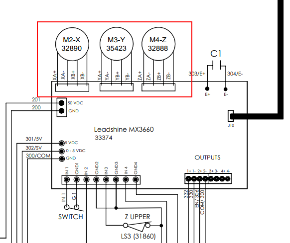

Reseat and Inspect the Connectors on the MX3660 and Motors
Reason: Control signals aren't reaching the electronic driver module
Stepper Connections on MX3660
Inspect the Motor’s Drivers
Reason: There's a defective or malfunctioning axis driver/cable.
  2. Examine the LEDs of the motor drivers on the MX3660 driver.
    1. If the stepper driver controller has an illuminated green light: It is ready and operating normally and you should continue to the next topic.
    3. If the are no lights on the stepper driver controller: Continue to Inspect you power source.

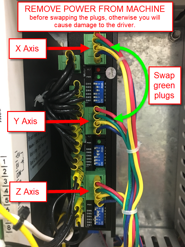

PCNC 440 Driver Swap
  1. Power off the machine.
  3. Swap the green plugs between two different axes.
    MX3660
  4. Power on the machine. (warning) The controls on the machine change, depending on the ribbon cables you swapped.
    1. If the malfunctioning motor now functions properly: It is likely that the malfunctioning axis driver is defective. A replacement MX3660 Driver will be needed
