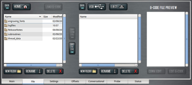

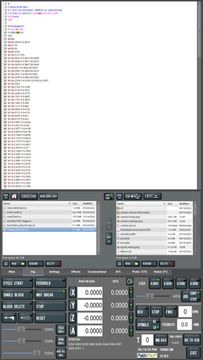

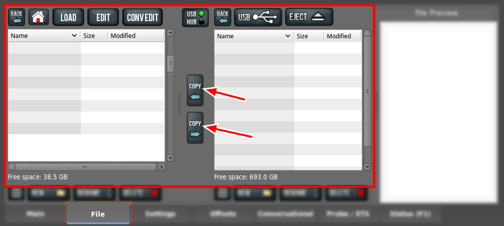

Create and Load G-Code Files

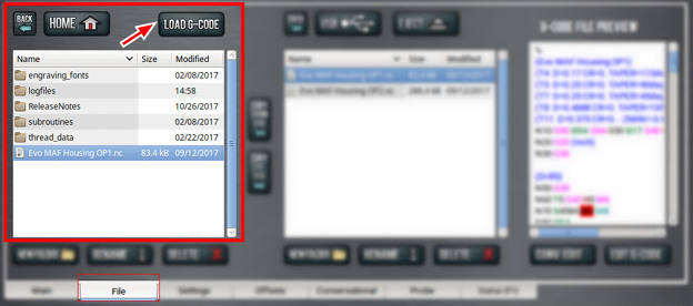

Load G-Code
To load G-code:
  2. Select Load G-Code.

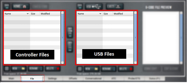

Figure 1: Controller Files window on the File tab.
  2. From the File tab, select the file to transfer (either in the USB Files window or the Controller Files window).
Figure 2: File tab.
Figure 3: File tab.
  1. If you’re using a USB drive, Select Eject.

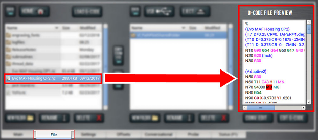

Preview G-Code Files
To preview G-code files:
Figure 4: File tab.

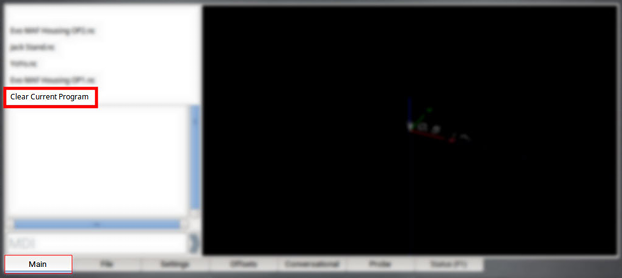

Access Recent G-Code Files
Figure 5: Recent Files Menu
    The G-code program loads.
Close the Current Program
Figure 6: Recent Files menu on the Main tab.

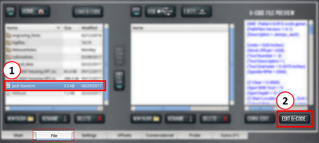

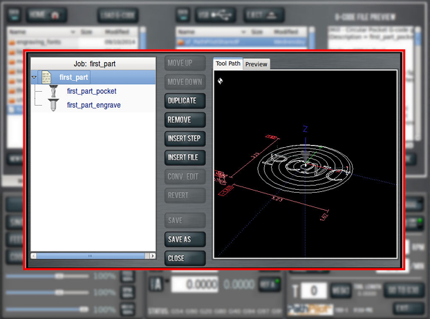

Edit G-Code
Figure 7: Edit G-code button on the File tab.
  2. Close the text editor.
  2. Select Conv. Edit.
Figure 8: Job assignment editor.
  1. Select Save.
Change the Step Order
Create a New Job Assignment
  1. Select Insert Step.
  3. Select Insert.
Load an Existing G-Code File
  3. Select Open.
Edit a Job Assignment
Select the job assignment, and then select Conv. Edit.
  1. Edit the job assignment.
  2. Select Finish Editing.
Tips
NOTE:  Revert is only available for individual job assignments created in conversational programming.

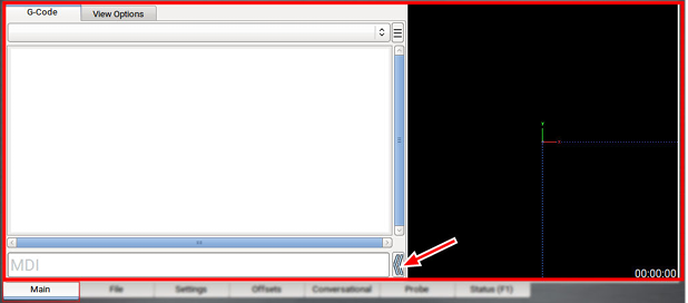

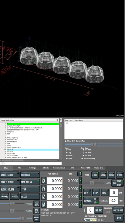

Read G-Code
Expand the G-Code Tab
To expand the G-Code tab:
  • Select the Window Expander.
Figure 9: Window Expander on the Main tab.

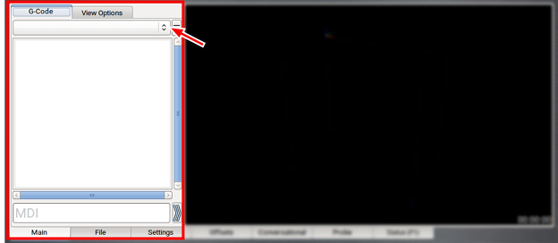

About the G-Code Tab

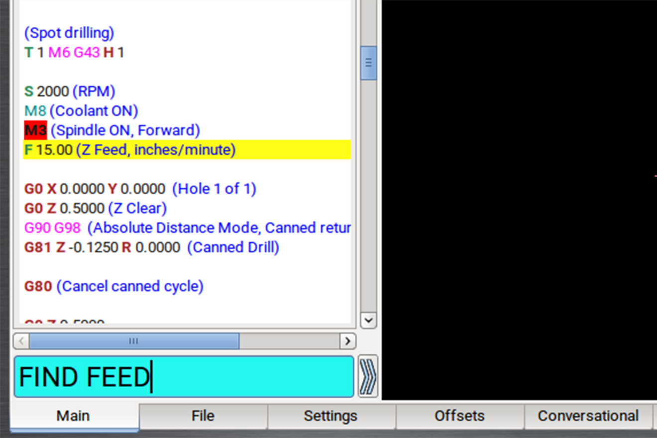

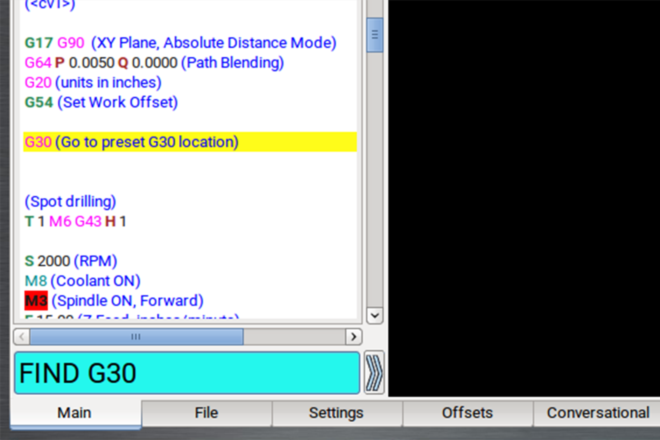

Search in the Code
To search in the code:
Figure 10: Search for a text command.
Figure 11: Search for a feed command.
  1. Select the Enter key.
  2. (Optional) Select Enter.
Set a New Start Line
To set a new start line:
  • Right-click any line in the program.
Figure 12: Accessing the Options menu by right-clicking.
  • Tap the line. Then, select the Options menu.

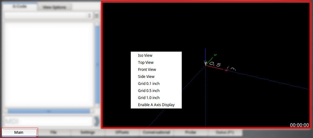

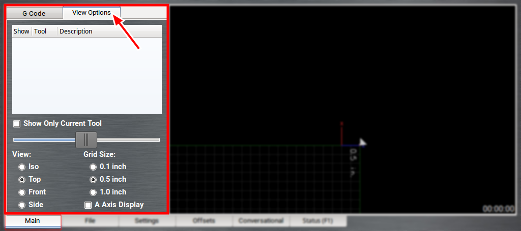

Figure 13: Tool Path display on the Main tab.
Figure 14: View Options tab on the Main tab.
  1. Select a new view.
About the Tool Path Display
  • Front
  • Iso
  • Side
  • Top
  • G20 Mode 1/2 in. intervals
  • G21 Mode 5 mm intervals
  • Select Reset.

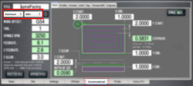

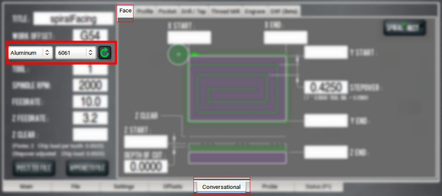

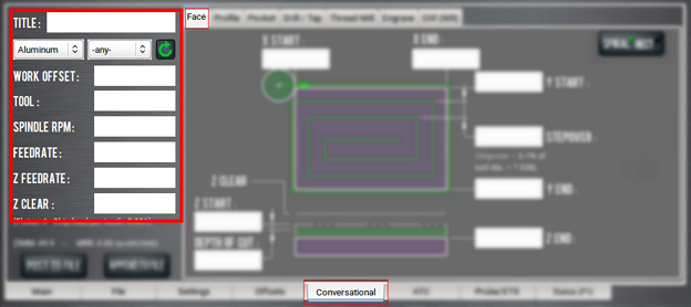

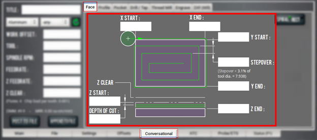

Create a Face on a Part
Using conversational programming, you can program PathPilot to take multiple cuts — each following the last — on an X/Y plane over a Z range. For information, see "About Facing" (page 12).
  • The area from the rear, left corner of the workpiece to the rear, right corner of the workpiece must be clear of any obstructions from the Z Start position to the Z End position.
  • The top of the workpiece must be free of any workholding devices.
  • The value used in the Z End DRO field must be such that it is above the workholding device.
  • The value used in the Z Clear DRO field must be such that it is above any obstruction in the tool path between the end of one pass and the beginning of the next.
To create a face on a part:
Figure 15: Conversational DROs on the Face tab.
    1. In the X Start DRO field and the X End DRO field, type the location of the workpiece edges. We recommend using the rear left corner of the part for the X Start value.
    2. In the Y Start DRO field and the Y End DRO field, type the location of the workpiece edges. We recommend using the front right corner of the part for the Y End value.
    3. In the Stepover DRO field, type the required distance between tool paths. To prevent uncut areas in the spiral corners, we recommend limiting this value to 80% of the tool diameter. For information, see "Facing Reference".
    4. In the Z Start DRO field and the Z End DRO field, type the location of the first and last Z passes. For a single Z pass at the location typed in the Z End DRO field, type a value of 0 or a full Z range value into the Depth of Cut DRO field.
    5. In the Depth of Cut DRO field, type the desired amount of material to remove.
NOTE: The depth of cut is later adjusted within the Z range so that each pass in the Z range has the same depth (rather than the last Z pass having a short depth of cut).
Figure 16: Program-specific DROs on the Face tab.
About Facing
Face milling is the process of cutting a surface that's perpendicular to the axis of the cutting tool. A facing program is usually used to cut an accurate, finished top surface on a rough piece of stock material. After a facing program is complete, tool marks remain — creating a fairly flat surface, with microscopic height differences.
Facing in PathPilot
When using a facing routine, each tool pass along the X-/Y-axis begins off to the side of the workpiece to avoid plunging into the workpiece. To compensate for this procedure, PathPilot sets lead-in tool paths outside of the workpiece using the part's work offsets, the tool's diameter, and the predetermined stepover value. PathPilot also adjusts the depth of cut to make sure each tool pass has the same depth, rather than cutting a short depth on the last pass of the program.
  1. Moves the machine to the predefined G30 position, or the tool change position.
  2. If required, performs or requests a tool change.
  3. Makes a rapid move in the X and Y direction to the beginning of the workpiece.
  4. Makes a rapid move in the Z direction to the predefined Z Clear position.
  5. Begins the cut in the X/Y plane at an adjusted Z depth of cut.
NOTE: The value entered into the Depth of Cut DRO field is adjusted within the Z range (the value entered into the Z End DRO field minus the value entered into the Z Start DRO field).
  1. Makes cuts in a rectangular spiral from the workpiece perimeter to the workpiece center.
For information on using conversational programming in PathPilot to face a part, see "Create a Face on a Part".
Facing Reference
PathPilot uses the following terms when creating a face on a part in conversational programming:
  • Stepover Indicates how much space PathPilot creates between each spiral tool path.
  • Z Clear Indicates the Z location that the tool moves (retracts) to when starting or ending a tool pass.

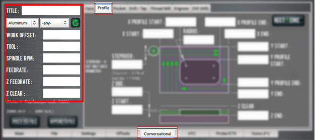

Create a Profile on a Part
Using conversational programming, you can program PathPilot to take multiple cuts — each following the last — on an X/Y plane over a Z range to form a boss. For information, see "About Profiling".
  • The value used in the Radius DRO field must be between 0 and either:
    • One half of the boss' narrow width, or
    • The full radii on the long ends of the boss
  • The value used in the Z Clear DRO field must be set to clear any obstructions between path changes.
To create a profile on a part:
  2. From the Conversational DROs group, set the parameters for the profiling operation.
Figure 17: Conversational DROs on the Profile tab.
    3. In the X Profile Start DRO field, the X Profile End DRO field, the Y Profile Start DRO field, and the Y Profile End DRO field, type the location of the profile's outer edges.
    4. In the Stepover DRO field, type the required distance between tool paths. If you want a single cut in the workpiece (to create a slot), type 0.
    5. In the Radius DRO field, type the required radius for the corners of the profile. For no corner radius, type 0.
    6. In the Z Start DRO field and the Z End DRO field, type the location for the first and last Z passes. For a single Z pass at Z End, type 0 — or a full Z range value — in the Z DOC DRO field.
    7. In the Z DOC DRO field, type the desired amount of material to remove.
Figure 18: Program-specific DROs on the Profile tab.

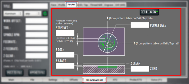

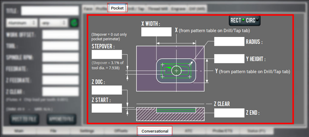

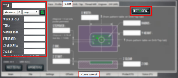

Create a Pocket on a Part
Using conversational programming, you can program PathPilot to take multiple cuts — each following the last — on an X/Y plane over a Z range to form a circular or rectangular pocket. For information, see "About Pockets".
    • One half of the pocket's narrow width, or
    • The full radii on the long ends of the pocket
To create a circular pocket on a part:
  1. From the Conversational tab, select the Pocket tab.
  2. From the Conversational DROs group, set the parameters for the pocket operation.
Figure 19: Pocket tab.
    1. In the X Center DRO field and the Y Center DRO field, type the location of the pocket's center.
    2. In the Pocket Dia. DRO field, type the required diameter for the pocket.
NOTE: The radius of the tool is used to set the tool path diameter.
c. In the Stepover DRO field, type the required distance between each rotation of the spiral cut. For a single cut around the inside perimeter of the pocket (to create a slot), type 0.
d. In the Z Start DRO field and the Z End DRO field, type the location of the first and last Z passes. For a single Z pass at the location typed in the Z End DRO field, type a value of 0 or a full Z range value into the Depth of Cut DRO field.
e. In the Z DOC DRO field, type the desired amount of material to remove.
Figure 20: Pocket tab.
To create a rectangular pocket on a part:
Figure 21: Pocket tab.
    1. In the X Start DRO field, the X End DRO field, the Y Start DRO field, and the Y End DRO field, type the location of the pocket edges.
    2. In the Radius DRO field, type the required radius for the corners of the pocket. For no corner radius, type 0.
    3. In the Stepover DRO field, type the required distance between adjacent tool paths. For a single cut around the inside perimeter of the pocket (to create a slot), type 0.
    5. In the Z DOC DRO field, type the desired amount of material to remove.
Figure 22: Pocket tab.
About Pockets
A pocket program is usually used to remove a large amount of material from a part.
Creating Pockets in PathPilot
For more information about creating a pocket on a part using conversational programming, see of the following sections, depending on the shape of the pocket:
For information on using conversational programming in PathPilot to make a pocket on a part, see "Create a Pocket on a Part".

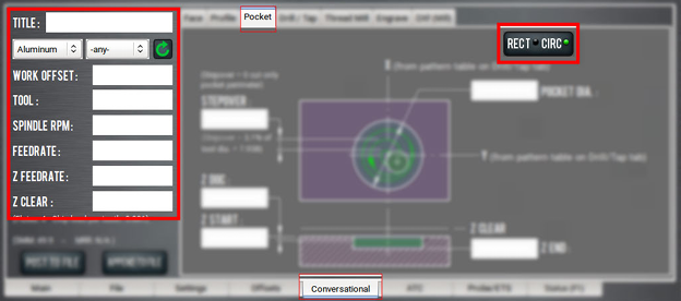

About Circular Pockets
PathPilot does one of the following, depending on the diameter of the tool:
  • Tool Diameter Larger Than Pocket Diameter PathPilot displays an error and does not create any G-code. You must select a different tool or edit the diameter of the pocket.
  • Tool Diameter Just Small Enough to Fit Within Pocket Diameter PathPilot does the following in the order listed:
  1. Uses a straight Z plunge into the pocket center. You must use a center-cutting end mill.
  2. Makes a single pass around the perimeter of the pocket at the adjusted Z depth of cut.
  3. Continues to make single passes around the perimeter of the pocket.
  • Pocket Diameter More Than Two Times Tool Diameter PathPilot does the following in the order listed:
  1. Uses a helical entry into the pocket center.
  2. Makes a hole that is two times the diameter of the tool diameter in the pocket center.
  3. Makes a spiral cut out from the pocket center to the pocket diameter.
  4. Makes a cut around the perimeter of the pocket.
About Rectangular Pockets
  • Tool Diameter Larger Than Pocket Width PathPilot displays an error and does not create any G-code. You must select a different tool or edit the width of the pocket.
  • Tool Diameter Just Small Enough to Fit Within Pocket Parameters PathPilot does the following in the order listed:
  • Length of Pocket More Than Two Times Diameter of Tool PathPilot uses a linear ramp entry.

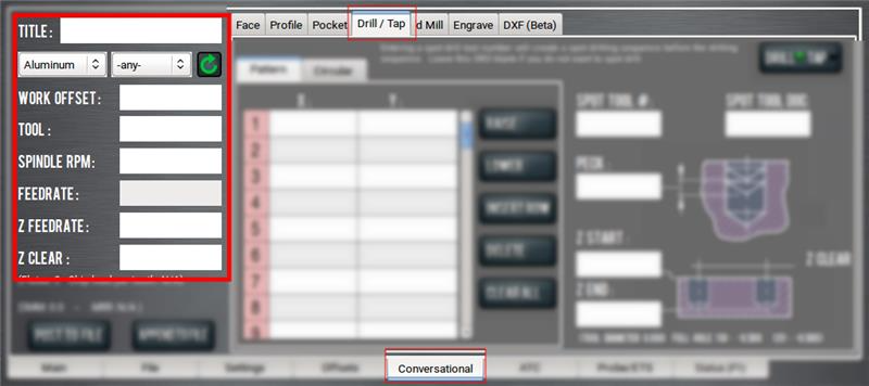

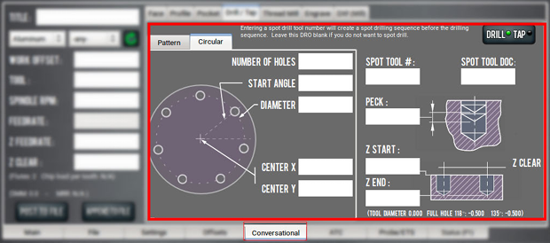

Create Hole Locations on a Part (Drill)
Using conversational programming, you can program PathPilot to make multiple holes on a part. For information, see "About Drilling".
  • In the Conversational DROs group, the value in the Z Clear DRO field must be set to clear any obstructions between hole changes.
To make a specific hole pattern of evenly spaced holes around a circumference (also know as a bolt pattern):
  1. From the Conversational tab, select the Drill tab.
Figure 23: Drill/Tap tab on the Conversational tab.
  1. From the Drill tab, select the Circular tab.
  2. In the Number of Holes DRO field, type the number of holes (greater than 0) required for the pattern.
  3. In the Start Angle DRO field, type the value of the angle from angle 0 (from -90 to 90).
  4. In the Diameter DRO field, type the size of the circular pattern (as defined by a line through the center point of each hole).
  5. In the Center X DRO field and the Center Y DRO field, type the location for the center of the hole.
  6. Go to "Create a Drilling Sequence".
Use the Location table to make a list of X and Y locations for each hole using the same tool, the same Z location, and the same values in the Conversational DROs group.
NOTE: You can create holes using different tools or different parameters. You must first post the first group of hole locations, enter the second group of hole locations, and then append the second group to the existing posted file.
To make a hole pattern based on X and Y locations on a part:
Figure 24: Drill/Tap on the Conversational tab.
  1. From the Drill tab, select the Pattern tab.
  2. In the Location table, select the row, then select the cell to edit.
    Holes indicated in the Location table are completed from top to bottom.
  3. Go to "Create a Drilling Sequence".
Tips
  • To rearrange the row order, select a row, and then select Raise or Lower.
  • To clear all values in the table, select Clear All.
  • To make sure that the value is a valid number, leave the cell. If the value isn't a valid number, it's erased, and an error displays on the Status tab.
  • Before posting the file, make sure that there are none of the following:
    • X values without a Y value
    • Y values without an X value
    • An empty row before the last row with values
About Drilling
A drilling program is used to create a series of holes in defined locations on a part.
Drilling in PathPilot
PathPilot has the following options to define the locations:
  • Pattern Use X and Y locations to make a list of hole locations.
  • Circular Use a circumference to make a specific pattern of evenly spaced holes.
For information on using conversational programming in PathPilot to drill holes, see "Create Hole Locations on a Part (Drill)".
During a drilling routine, PathPilot uses one of the following canned G-code cycles, depending on the entries in each DRO field:
  • G81 Drill
  • G82 Drill with dwell
  • G83 Drill with peck
NOTE: The features can't be combined, because peck cancels dwell.
The Drill tab uses one of the following canned G8x cycles to drill a hole at each identified location:
  • G81 Drill
Hole depth is usually defined as the full diameter portion of the hole, so you may need to consider the Z length from the drill point to the corner.
  1. In the Spot Tool # DRO field, type the number of the spot drill.
If a valid tool number is used in the Spot Tool # DRO field, PathPilot makes a spot drilling sequence before the drilling sequence. In the spot drilling sequence, PathPilot uses the values indicated in the Feedrate DRO field, the Spindle RPM DRO field, and the Z Clear DRO field.
NOTE: To skip a spot drilling sequence, leave the Spot Tool # DRO field blank.
  1. In the Spot Tool DOC DRO field, type the depth of cut for the spot drilling sequence.
NOTE: To skip a spot drilling sequence, leave the Spot Tool DOC DRO field blank.
  1. In the Peck DRO field, type the distance for each peck.
NOTE: Any entry greater than 0 typed in the Peck DRO field replaces G81 with G83 in the G-code. For information, see "Drilling Reference".
  1. Set the parameters for the hole in the Z range:
    1. In the Z Start DRO field, type the location for the first Z pass.
    2. In the Z End DRO field, type the location for the last Z pass.
Drilling Reference
PathPilot uses the following terms when drilling on a part in conversational programming:
  • Start Angle Specifies the angle from angle 0. Angle 0 is a base (horizontal) line from the center point going right (east) to the circumference. The angle from the base line can be:
    • Positive or negative
    • Up to 90 degrees (or -90 degrees)
      A negative angle produces a clockwise rotation; a positive angle produces a counterclockwise rotation.
    • Rotates the pattern either clockwise or counterclockwise
      For example, to create a hex pattern with flats on the top and bottom, use a value of 0 in the Start Angle DRO field. To create a hex pattern with flats on the left and right sides, use a value of 30 (or -30) in the Start Angle DRO field.
  • Peck The value isn't adjusted: the G83 routine feeds at the Z Feedrate, starting from Z Clear down to the Peck distance, then rapid retracts to Z Clear, and rapid returns to start the next Peck.
NOTE: The first and last peck will likely be shorter than the value typed into the Peck DRO field.

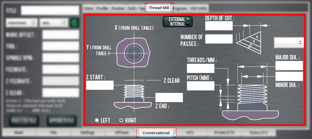

Create Threads on a Part
Using conversational programming, you can program PathPilot to take helical tool paths around a boss or inside a hole to create external or internal threads. For information, see "About Thread Milling" (page 26).
  • The auto-filled DRO field values assume a full-form threaded tool. If you're using a fine-point threaded tool to cut coarse threads, you must modify the root diameter to account for the tool's smaller nose radius.
  • The value used in the Z Clear DRO field must be such that it can clear any blockages in the path between the end of one Z pass and the beginning of the next.
To create threads on a part:

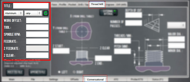

  1. From the Conversational tab, select the Thread Mill tab.
  2. From the Conversational DROs group, set the parameters for the thread milling operation.
Figure 25: Conversational DROs on the Thread Mill tab.
  1. Depending on the type of threads, do one of the following:
  • For external threading (creating threads on a boss, for example), select External.
  • For internal threading (creating threads inside a hole, for example), select Internal.
    1. From the Quick Reference drop-down, select the thread size.
      The Threads/In DRO field, Pitch (In) DRO field, Major Dia. DRO field, and Minor Dia. DRO field auto-fill.
NOTE: The threads listed follow the current unit setting: either inches (G20) or millimeters (G21).
b. In the Z Start DRO field, type the location of the first Z pass (where you want the thread to start).
c. In the Z End DRO field, type the location of the last Z pass (where you want the thread to end).
NOTE: The tool actually goes beyond the value entered in the Z End DRO field, due to the cutting tip width and the Z component of the compound feed angle and thread depth.
d. In the Depth of Cut DRO field or the Number of Passes DRO field, type a value to represent the amount of material to remove in each helical pass. For information, see "Thread Milling Reference".
NOTE: The Depth of Cut DRO field and the Number of Passes DRO field are linked — after you type a value in one and press Enter on the keyboard, the other is auto-filled.
Thread milling is used to make helical tool paths on a part — either externally, like on a boss, or internally, like in a hole. The right-handed threads are based on pitch, diameter, and length.
Thread Milling in PathPilot
For information on using conversational programming in PathPilot to do thread milling, see "Create Threads on a Part".
PathPilot uses the following terms when creating a thread mill on a part using conversational programming:
  • Major Dia. and Minor Dia. Set the start and end diameter of the thread peak and valley.
  • Depth of Cut Sets the amount of material cut in each helical pass — the value is the distance (the change in radius) the tool is fed on the first pass. This first pass cuts a triangular area which is related to the chip load. Subsequent cut depths are set to cut the same amount of area, so the linear feed gets smaller for each pass. The tool is also fed in on a compound angle of 30 degrees, keeping the cuts to one face of the tool.
  • Z Clear The location the tool moves or retracts to when starting or ending a Z pass.

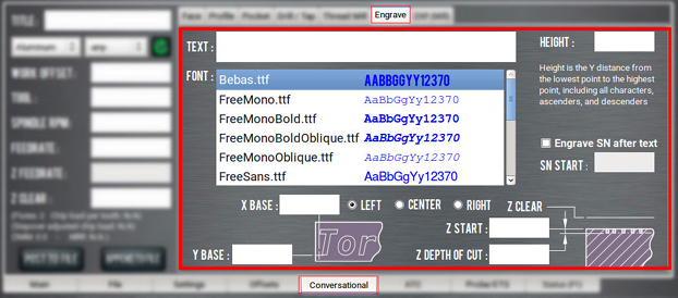

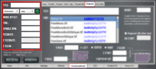

Create Text to Engrave on a Part
Using conversational programming, you can program PathPilot to engrave a single line of text on a part. For example, you could use this feature to engrave True Type stick or outline fonts into things like simple plaques, control panels, or data plates. For information, see "About Engraving".
To create an engraving sequence on a part:
  1. From the Conversational tab, select the Engrave tab.
  2. From the Conversational DROs group, set the parameters for the engraving operation.
Figure 27: Conversational DROs on the Engrave tab.
    1. In the Text DRO field, type the desired text to engrave.
      The text appears in the Preview window.
b. From the Font list, select the desired font for the engraved text.
NOTE: To search the Font list, select a font and begin typing the font's name. PathPilot scrolls to the result.
The Preview window updates to display the font selected.
NOTE: You can add True Type font files to the PathPilot controller. For information, see "Transfer Files to and From the Controller".
c. Use the Alignment radio buttons to select the desired alignment of the text: either Left, Center, or Right.
d. In the Height DRO field, type the distance in the Y direction from the top of the text to the bottom of the text.|
PathPilot uses the height value, along with font data, to calculate scale for character paths in the G-code program.
NOTE: The value typed in the Height DRO field includes ascenders and descenders, but no the tool cutting diameter. For a more accurate value, subtract the diameter from the overall height.
e. In the X Base DRO field and the Y Base DRO field, type the location of the left side of the first character’s baseline.
NOTE:   If any characters in the text have descenders, like y or g, they extend below the baseline.
f. In the Z Start DRO field, type the location of the surface on which to engrave.
g. In the Z Depth of Cut DRO field, type the desired depth the that the cutting tool is fed into the workpiece.
h. In the Z Clear DRO field, type the value for the tool to move or retract to — in the Z direction — at the start and end of the engraving sequence and between characters.
Figure 28: Program DROs on the Engrave tab.
About Engraving
Engraving is used to engrave a single line of text cut in a single horizontal pass along the X-axis of a part.

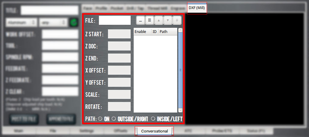

Import a DXF File
Figure 29: DXF tab on the Conversational tab.
  1. Select the File DRO field.
Example
Adjust the Tree View Window
  • Use the Fold and Unfold buttons to collapse and expand the layer and shape tree in the tree view window.
Working in the Preview Window
  • Cyan Selected paths
  • Gray Disabled paths
  • White Drawing path
  • Magenta Cut path
    • Red X-axis
    • Green Y-axis
    • Blue Z-axis

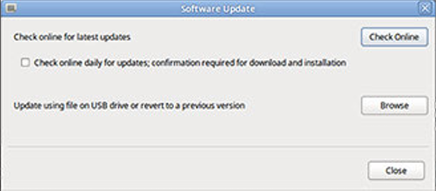

Enable Automatic Updates
To enable automatic updates:
Figure 32: Software Update dialog box.
  2. Select Close.

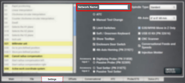

Change the Network Name
To change the network name:
Figure 33: Network Name field on the Settings tab.

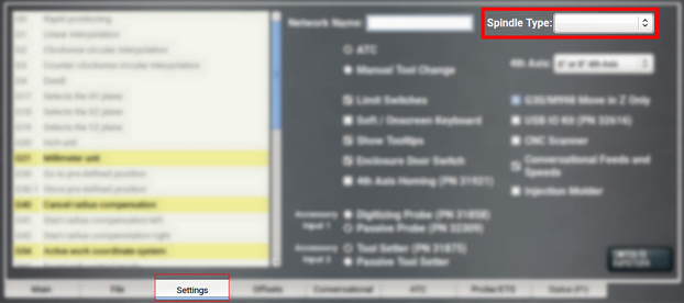

Select the Spindle Type
If you have an additional spindle (separate from the standard spindle), you must first select it in PathPilot.
To select the spindle type:
  • From the Settings tab, from the Spindle Type drop-down, select the appropriate spindle option.
Figure 34: Spindle Type field on the Settings tab.

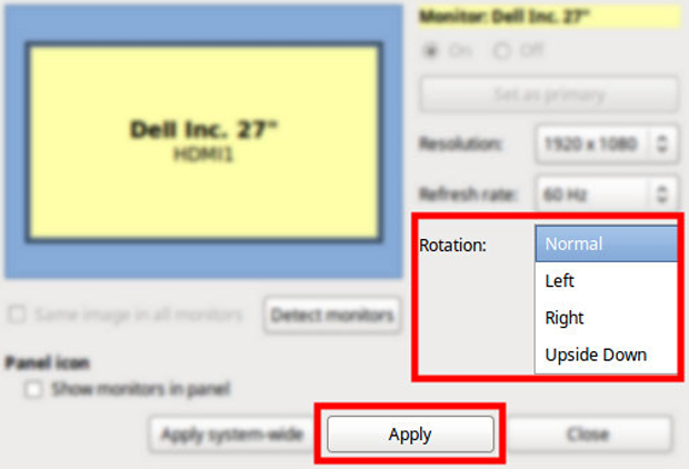

Change the Screen Orientation

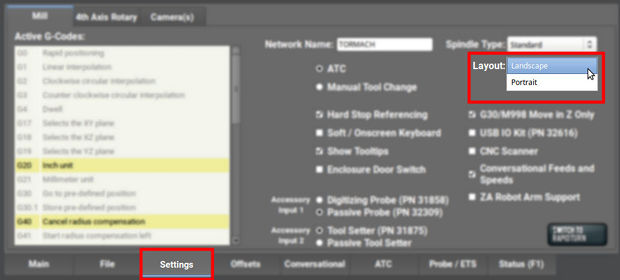

Figure 35: Layout drop-down menu on the Settings tab.
Figure 36: Monitor configuration dialog box.
About Portrait Screen Layout
Figure 37: Tool Path window in portrait screen layout.
Figure 38: File tab G-code preview in portrait screen layout.

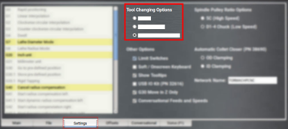

Figure 39: Tool change method options on the Settings tab.

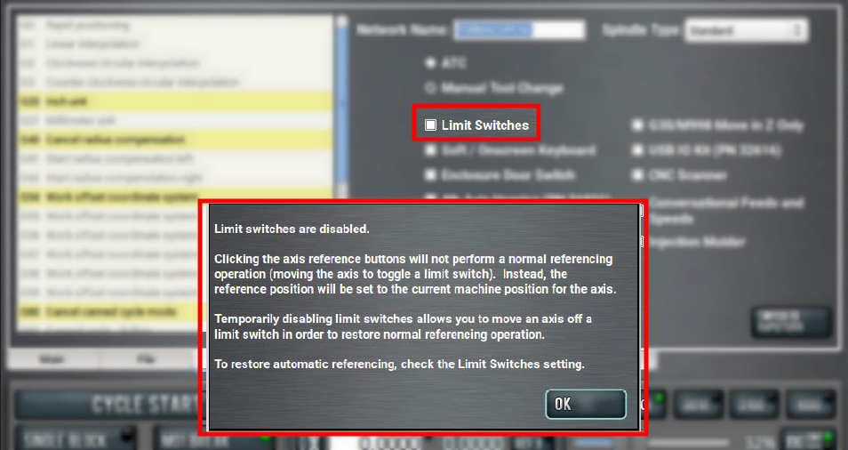

Disable Limit Switches
To provide a temporary workaround for a malfunctioning limit switch circuit, you can disable the limit switches. For information, see “About Limit Switches”.
NOTE: By default, the Limit Switches checkbox is selected.
To disable limit switches:
  1. From the Settings tab, clear the Limit Switches checkbox.
Figure 40: Limit Switches checkbox on the Status tab.
  1. Select OK.
In the PathPilot interface, on the Settings tab, the Limit Switches checkbox is selected by default. If the checkbox is cleared, the machine completes a unique referencing procedure after selecting Ref X, Ref Y, Ref Z, and Ref A: rather than moving each axis to the end of its travel, the reference position is set as the machine's current position. This is useful for troubleshooting: if the limit switches are disabled, you're able to move the axis off of its limit switch.

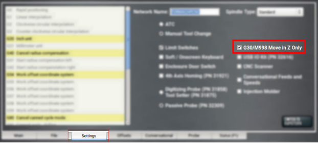

Limit G30 Moves
To limit G30 moves:
Figure 41: Settings tab.
About G30

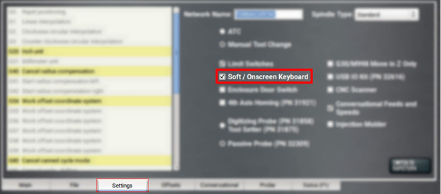

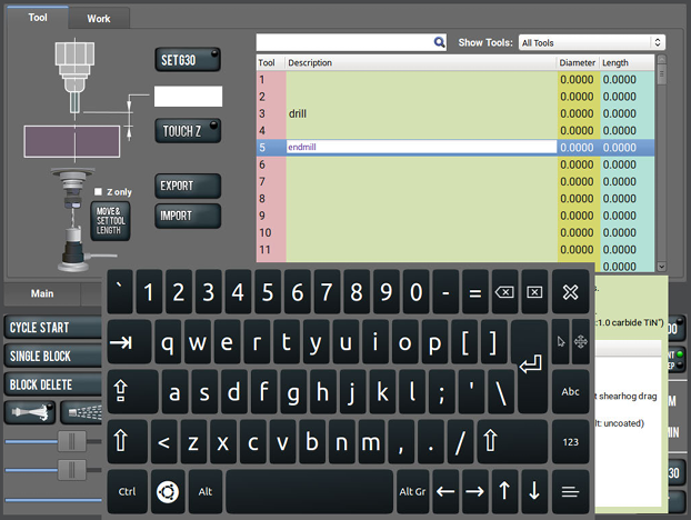

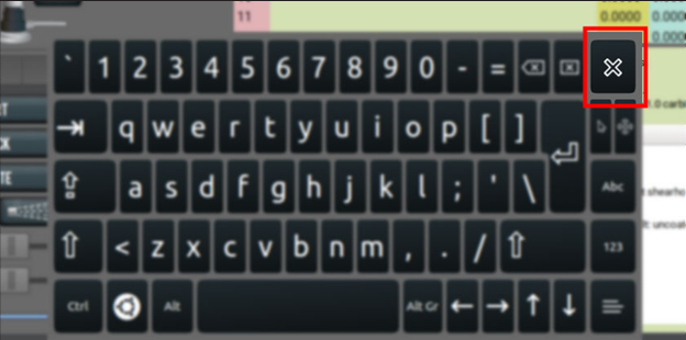

Enable the On-Screen Keyboard
Figure 42: Settings tab.
Figure 43: Soft Keyboard.
Figure 44: Soft Keyboard.
About Soft Keyboards
Figure 45: Soft Keyboard.
Figure 46: Settings tab.

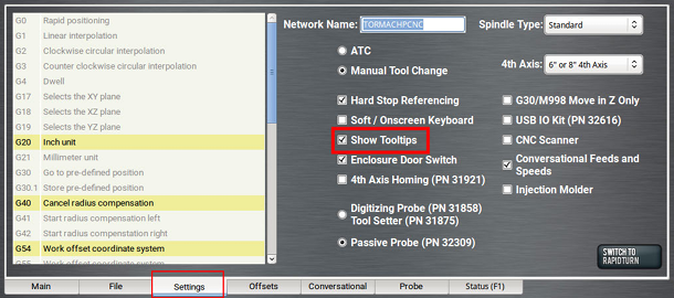

Enable Tooltips
Figure 47: Show Tooltips checkbox.
Figure 48: Settings tab.

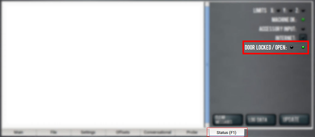

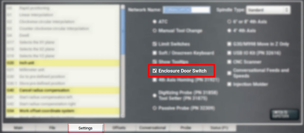

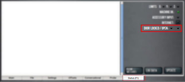

Figure 49: Status tab.
  2. Open the enclosure doors.
Figure 50: Door Open LED on the Status tab.
    The doors unlock.
Figure 51: Settings tab.

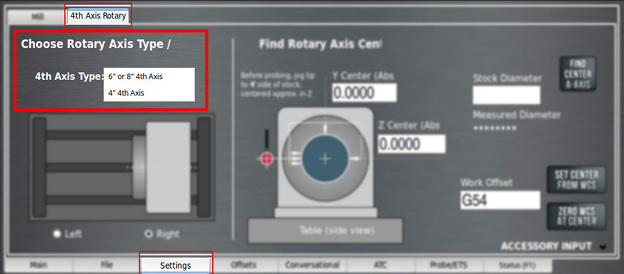

Specify the 4th Axis Rotary Type
To select the 4th axis that you're using:
Figure 52: 4th Axis Rotary tab.

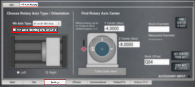

Enable the 4th Axis Homing Kit
If you have a 4th Axis Homing Kit (PN 31921), you must first enable it in the PathPilot interface.
To enable the 4th Axis Homing Kit:
  • From the Settings tab, select the 4th Axis Rotary tab. Then, select 4th Axis Homing (PN 31921).
Figure 53: USB 4th Axis Rotary tab.

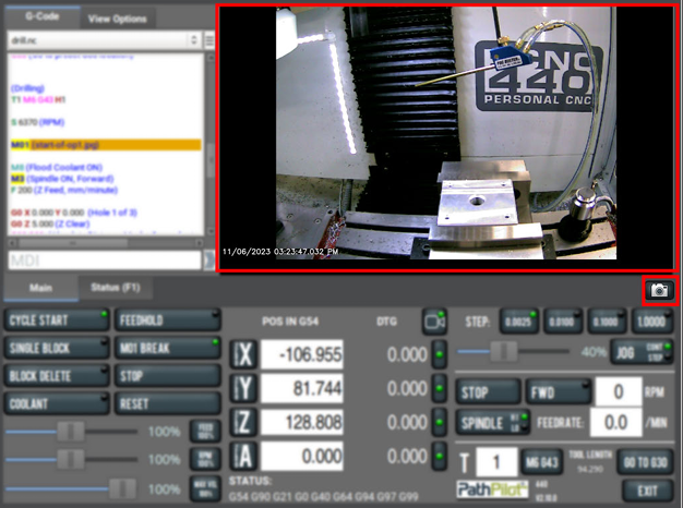

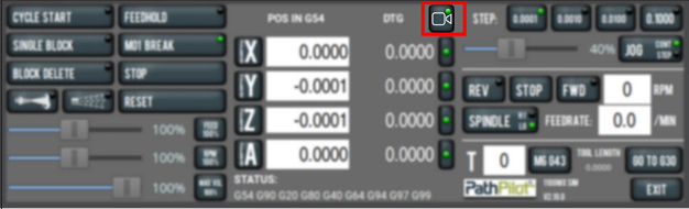

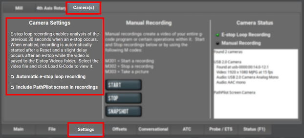

Use a USB Camera
Figure 54: USB Camera status.
About USB Cameras
Manual Recording
Figure 55: Manual recording controls.
Figure 56: Video Camera Recording button.
Figure 57: Camera Settings.
    The Main tab displays.
Figure 58: Example of taking a photo.
To view E-stop videos:

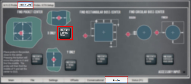

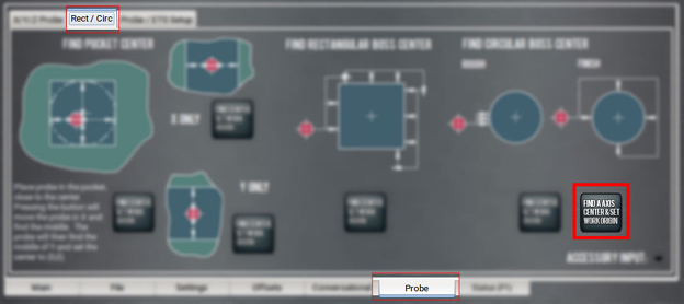

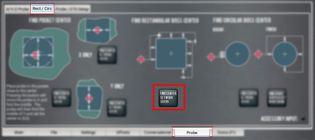

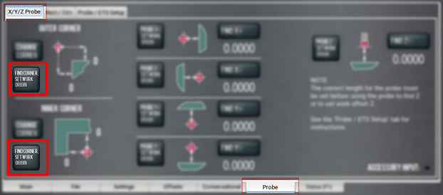

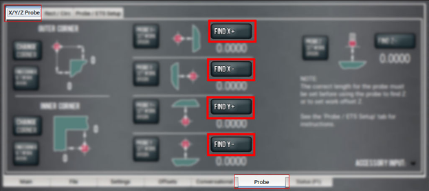

Use a Probe with PathPilot

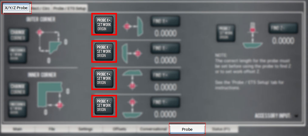

Use the Probe tab in the PathPilot interface to automate functions with a probe.
Set Up the Probe
Before using the functions on the Probe tab, you must first do the following:
  1. Verify that tool number 99 (the probe tool) is in the spindle.
  2. Disable the spindle to prevent any accidental spindle starts with the probe in the spindle.
  3. Verify that the feed rate is appropriate for probing moves.
NOTE: All probing moves occur at a feed rate specified by the DRO fields on the Probe Setup tab.
  1. Press the probe tip and make sure that, from the PathPilot interface, on the Probe tab, the Accessory Input light comes on.

Use a Probe to Find a Feature's Location
To find the location of a workpiece or vise in the current work offset coordinates:
  1. From the PathPilot interface, on the Probe tab, select the X/Y/Z Probe tab.
  2. Position the probe near the workpiece or vise.
  3. One at a time, select Find X+, Find X-, Find Y+, Find Y-, or Find Z-.
Figure 59: Probe tab.
The axis is probed, and the location of the probed surface is displayed.

Set the X and Y Work Offset Zero on the Corner of a Feature
  2. Position the probe so that it is below the surface of the feature and 1 in. away from the vice jaw corner in the X and Y directions.
  3. Select Find Corner, Set Work Origin.
Figure 60: Probe tab.
The axes are probed, and the location of the probed surface is set as the current work offset's X/Y origin.
NOTE: Select Change Corner to change the corner on which to probe.
Set the Work Offset Zeroes on a Feature
  3. One at a time, select Probe X+, Set Work Origin, Probe X-, Set Work Origin, Probe Y+, Set Work Origin, Probe Y-, Set Work Origin, or Probe Z-, Set Work Origin.
Figure 61: Probe tab.
The axis is probed, and the location of the probed surface is set as the current work offset's origin.
Use a Probe to Find the Center of a Feature
You can find the center of a pocket, slot, or boss on a part using a probe.
Find the Center of a Pocket
  1. From the PathPilot interface, on the Probe tab, select the Rect/Circ tab.
  2. Position the probe near the center of the pocket.
  3. Select Find Center, Set Work Origin as shown in the following image.
Figure 62: Probe tab.

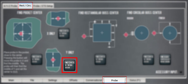

Find the Center of a Slot
  2. Position the probe near the center of the slot.
  3. Depending on the slot, do one of the following:
    1. To probe the slot in the X direction only, select Find Center, Set Work Origin as shown in the following image.
Figure 63: Probe tab.
b. To probe the slot in the direction only, select Find Center, Set Work Origin as shown in the following image.
Figure 64: Probe tab.
Find the Center of a Rectangular Boss
  2. Position the probe below the top surface of the boss and on the left-hand side.
Figure 65: Probe tab.
The probe moves around the edge of the workpiece to find the center.
Find the Center of a Circular Boss
Figure 66: Probe tab.
The probe moves around the workpiece three times to determine the approximate center of the curve, and then makes four additional move to confirm the center of the circle.
Find the Center Rotation of an A-Axis
  2. Position the probe directly above the A-axis center of rotation.
  3. Select Find A Axis Center & Set Work Origin.
Figure 67: Probe tab.
The probe moves around the round workpiece mounted in the A-axis to find the center rotation of the A-axis.

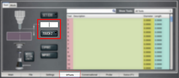

Set Tool Length Offsets
NOTE: You can import a .csv file with tool length offset data. For information, see "Import and Export the Tool Table".
To set tool length offsets:
    For information, see “Set Up Tooling”.
Figure 68: Tool Table window on the Offsets tab.
About Tool Offsets
Set a Known Reference Height

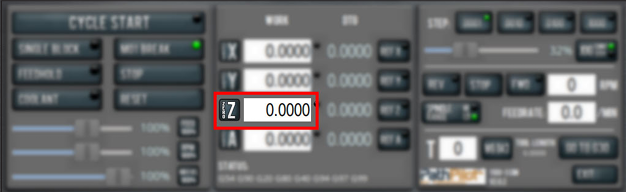

  8. While moving the paper back-and-forth across the reference surface, slowly step the Z-axis down (-Z) until you feel a light pull on the piece of paper. This indicates that the paper is contacting the spindle.
Figure 69: Z-axis work offset DRO field.
Figure 70: Tool DRO field.
Figure 71: Touch Z DRO field and button.
  1. Select Touch Z.
  4. Jog the Z-axis up (+Z).
Figure 72: Z-axis work offset DRO field.
Figure 73: Tool Height Setter
  1. From the PathPilot interface, on the Offsets tab, find an unused tool number in the Tool Table window. Then, type a description for the tool you're measuring.
  2. Put the tool holder into the spindle.
  3. From the PathPilot interface, in the Tool DRO field, type the number of the tool. Then select the Enter key.
Figure 74: Tool DRO field.
  1. Slowly jog the Z-axis down (-Z) to contact the Tool Height Setter. Stop jogging when the Tool Height Setter reads zero, which indicates that it's compressed to the height of the ground surface. Verify that the indicator rotated around the dial the same number of times as when you calibrated the Tool Height Setter.
  2. From the PathPilot interface, on the Offsets tab, in the Tool Table, select the tool for which you previously wrote a description.
  3. In the Touch Z DRO field, type the height of the Tool Height Setter. Then select the Enter key.
Figure 75: Touch Z DRO field and button
  1. Select Touch Z.

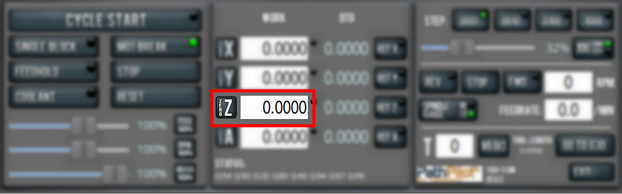

  • Select Zero [Axis].
Figure 76: Work Offset DRO fields.

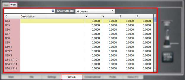

View Work Offsets
Figure 78: Work Offsets Table window.

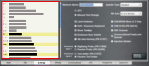

View Available G-Code Modes
Figure 79: G-code Description window on the Settings tab.

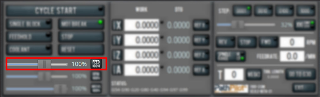

Figure 96: Feed Rate Override slider.
  • Select Feed 100%.
About Feed Rate Override

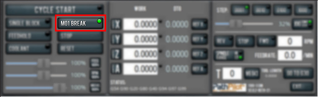

Use M01 Break Mode
  • Select M01 Break.
Figure 97: M01 Break button.
About M01 Break
  • In the same folder as the G-code program
  • In an images folder within the G-code program's folder
  • In an images folder within the home directory
  1. Program an M00 or M01 break, and, using parentheses, type the full file name of the image (including its extension).
Example
M01 (Op1_Setup.jpg) displays the image file on the Tool Path display.
Display Information with Text
  1. Program an M00 or M01 break, and, using parentheses, type a message that you’d like to display on the screen.
Example
Capture Images with a USB Camera
To us M01 to take pictures:
  2. Run the G-code program.
  3. When PathPilot executes the M01 it looks to see if the comment contains a file.
    1. If there isn’t a file name: The comment is shown as instructional text across the tool path.

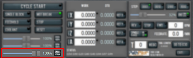

Figure 98: Maxvel Override slider.
  • Select Maxvel 100%.
About Maxvel Override

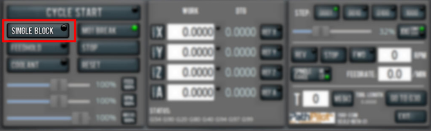

Use Single Block Mode
  • Select Single Block.
Figure 99: Single Block button.
About Single Block

Use a G30 Position
To set a G30 position:
Figure 104: Set G30 button.
To go to a set G30 position:
  • Do one of the following:
    • Select Go To G30.
      Figure 105: Go to G30 button.
About G30

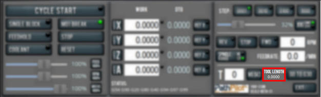

View the Tool Length
  • Identify the Tool Length read-only DRO field.
Figure 106: Tool Length DRO field.
If the tool offset matches the number of the tool in the Tool DRO field, the text is light blue on a gray background.
If the tool offset doesn't match the number of the tool in the Tool DRO field, the text is orange on a red background.

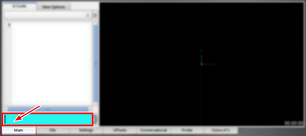

Manually Enter Commands
To manually enter commands:
Figure 107: MDI Line DRO field
The DRO field highlights.
  1. Type the command.
About the MDI Line DRO Field

Admin Network
Configure a Wi-Fi network.

Figure 109: Feeds and Speeds suggestions on the Conversational tab.
  • Spindle RPM
  • Feedrate
  • Z Feedrate
  • Depth of Cut
  • Stepover
  • Peck (if drilling)
Refresh DRO Field Values
Figure 110: Refresh button on the Conversational tab.
Use Additional Provided Information
The following tips are displayed based on the calculations that PathPilot is performing:
  • Chip Load Information Chip load — the amount of material removed per tooth — is based on the number of flutes, RPM, and feed rate.
    As the stepover value decreases, the actual chip load decreases. If the stepover is too small, the cutter may not have enough contact with the material to cut — effectively resulting in premature tool wear.
  • Cutting Speed Information Cutting speed is the speed that a given tooth (flute) on the cutter will be moving when it cuts through the material. All materials have a documented cutting speed.
    In imperial units, cutting speed is measured as surface feet per minute (SFM).
    In metric units, cutting speed is measured as surface meters per minute (SMM).
  • Material Removal Information The material removal rate (MRR) indicates how much material is removed by the tool per minute while cutting.

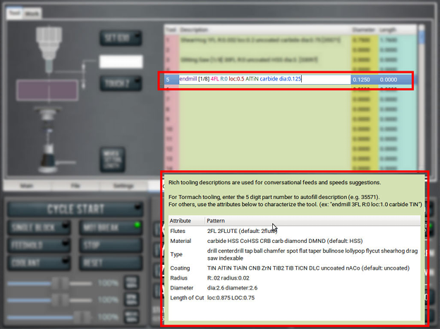

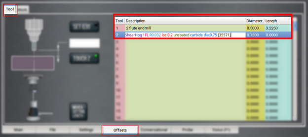

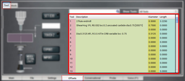

Create Tool Descriptions
  1. From the PathPilot interface, on the Offsets tab, identify the Tool Table window.
  2. Select a blank line.
Figure 111: A manually-entered tool description.
Examples
Example
Dia:.3125 4FL R:03 AlTiN CRB variable loc:.75
  • 0.3125 tool diameter
  • Four flutes
  • 0.03 radius, or "bullnose"
  • Carbide
  • Variable helix
  • 0.75 length of cut (loc)
Example
Gold colored end mill from middle drawer
This description provides very little information, and PathPilot defaults to basic cutter features:
  • Two flutes
NOTE: If you don't know the part number, you can search for the tool at http://tormach.com.
  2. Type the part number for the tool, like 35571.
Figure 112: An automatically-generated tool description for a Tormach tool.
Tool Keywords Reference
Item
Pattern
Example
Notes
type
Drill, Ball, Flycut, Drag
flutes
4FL, 12FL, 2flute
length of cut (or flute length)
loc:0.875
tool coating
TiN, ZrN, TiB2
No coating is specified same as “uncoated.”
tool diameter
Diameter:.0341, dia:.750
tool material
HSS, CoHSS, crb
No tool material is specified the same as HSS (high-speed steel).
tool radius
R:.02, radius:0.02

Use the File tab to manage system files on the PathPilot controller. For information, see "Transfer Files to and From Controller".
To manage system files:
    • Select a file, and go to the Options
      menu. Then, select Copy, Cut, or Paste.
  • Select Back or Home.
Create Backup Files
Figure 113: Admin Settings Backup Dialog box.
  2. Select Save.
Figure 114: Controller Files window on the file tab.
  • logfiles
  • media
  • ReleaseNotes
  • subroutines
  • USB
  1. Select Copy to USB.

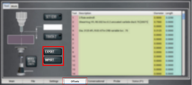

Figure 117: Export and Import buttons on the Offsets tab.
Import a .csv File
Figure 118: Import dialog box.
Figure 119: Export dialog box.
  2. Select Save.
