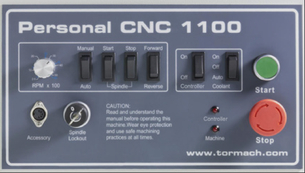

Operator Panel
The Operator Panel is located on the door of the electrical cabinet (see Figure 1). It contains physical buttons that control the following functions:
  • Start
  • E-stop
  • Controller On/Off
  • Coolant On/Off/Auto
  • Spindle Manual/Auto
  • Spindle Start/Stop
  • Spindle Forward/Reverse
It also contains the Accessory inlet, the Spindle Speed Dial (RPM x 100), and Spindle Lockout.
Figure 1
NOTE: The Operator Panel is not compatible with the PCNC 1100 or PCNC 770 full enclosure kit and is therefore removed and discarded during installation of either. In this scenario, these controls are accessed (on mills without an operator panel) via the PathPilot interface.

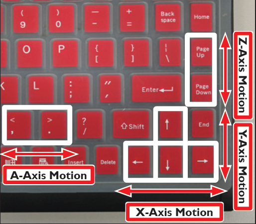

Jogging Controls
Tormach mills can be jogged with either the Jog Shuttle (PN 30616) shown in Figure 3 or by using the keyboard’s arrow keys (see Figure 4):
  • The right arrow jogs X-axis in the positive X direction (table moves left of operator).
  • The left arrow jogs X-axis in the negative X direction (table moves right of operator).
  • The up arrow jogs Y-axis in the positive Y direction (moves table towards operator).
  • The down arrow jogs Y-axis in the negative Y direction (moves table away from operator).
  • The Page Up key jogs the Z-axis in the positive Z direction (moves spindle up).
  • The Page Down key moves the Z-axis in the negative Z direction (moves spindle down).
NOTE: Jogging is not permitted during G-code program execution or MDI moves.

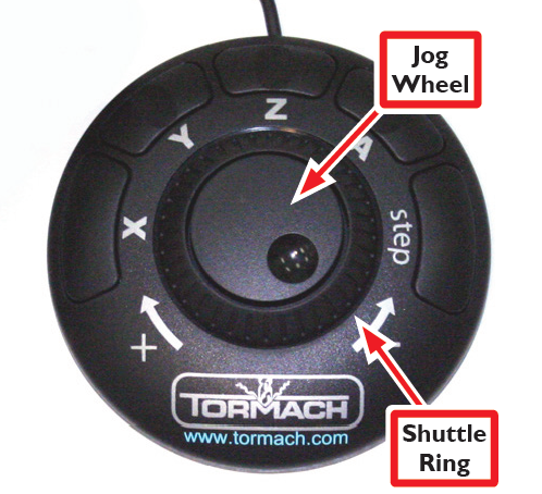

Jog Shuttle
The Jog Shuttle (PN 30616), shown in Figure 4, is an optional accessory that many operators find increases productivity, especially on short-run jobs requiring extensive setting up of the workpiece and tooling.
The X, Y, Z, and A buttons are used to jog the X-, Y-, Z-, and A-axis respectively. An illuminated LED light beside an axis DRO on the PathPilot interface indicates which axis is selected for jogging. The the Step button on the Jog Shuttle cycles through the available jog step sizes. The active size is indicated by an illuminated LED light on the Step Size buttons on the PathPilot interface.
For more information on jogging methods, see “PathPilot Interface.

Manual Spindle Control Via Operator Panel
The operator panel-based spindle controls are outlined below:
  • To control the spindle via the Operator Panel switch the spindle to Manual (see Figure 1).
  • Use the Spindle Speed Dial to select the desired spindle RPM. The numbers correspond to spindle speeds when the belt is in the high position.
  • Use the spindle direction switches to select Forward for clockwise and Reverse for counterclockwise.
  • Press Start to activate the spindle. Press Stop to stop the spindle.

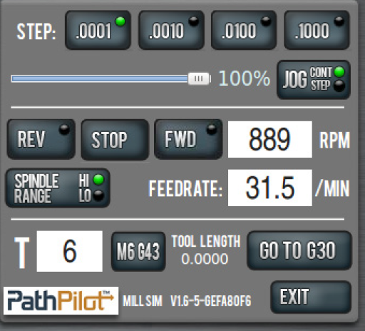

Automated Spindle Control Via PathPilot Interface
To control the spindle via the PathPilot interface, switch the spindle to Auto on the Operator Panel
(see Figure 1).

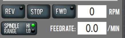

Figure 5
Ensure the Spindle Range button’s LED light (see Figure 5) correctly corresponds to the spindle belt position, either Hi or Lo; click to toggle between the two positions. For more information on the procedure to change belt position, refer to “Changing Spindle Speed Range section later in this chapter.
NOTE: A mismatch between the Spindle Range button and actual spindle belt position will result in the commanded speed being different from the indicated RPMs. See table below for available speed ranges for each spindle option.
To specify spindle RPMs, click the DRO. Using the keyboard, type the desired RPM and press Enter.
  • Click FWD to run the spindle clockwise
  • Click REV to run the spindle counterclockwise
  • Click Stop to stop the spindle

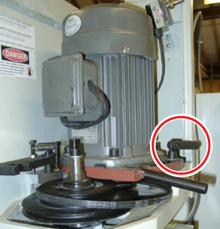

The range change is performed by moving the spindle belt from the top pair of pulleys (high speed range) to the lower pair of pulleys (low speed range).
To change belt position:
WARNING! Electrical Shock Hazard: Be sure to power off machine before making any electrical modifications. Failure to do so may result in serious injury or death.
  1. Power off mill according to power off/on procedure detailed in chapter 3, Installation.
  2. Open spindle door.
  3. Unlock motor mounting plate:
    1. On a PCNC 1100: Use the rear handle (see Figure 6)
Figure 6
  1. Pull spindle motor forward. The spindle belt slackens.
  2. Move the spindle belt from one pulley to another. (see Figure 6)
  3. Re-tighten the spindle belt so that there is approximately 1/8”-1/4” of belt deflection midway between the pulleys with a firm finger press.
  4. Lock the motor mounting plate and stow handles (if equipped) in the vertical position.
