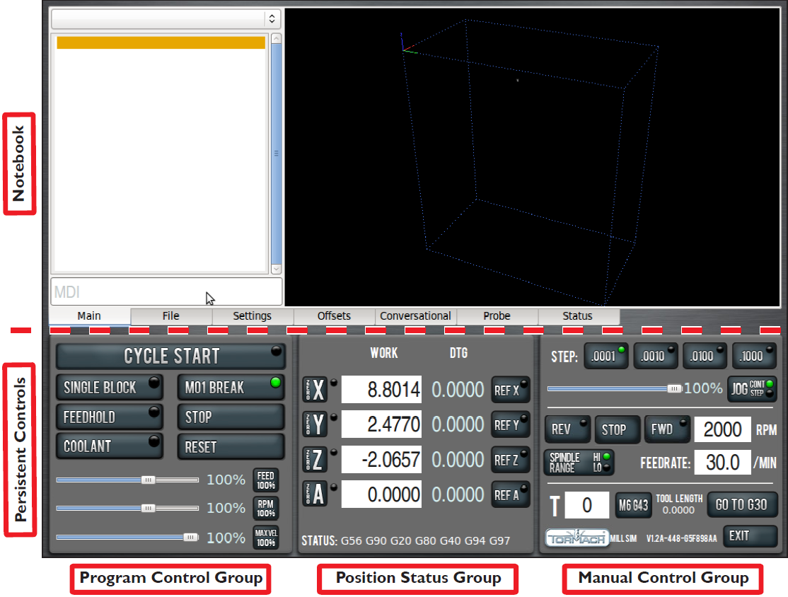

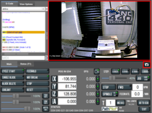

Overall Layout
The PathPilot® interface is divided into two sections, the Notebook and the Persistent Controls (see Figure 1). The Persistent Controls make up the bottom half of the screen and include three control groups: the Program Control Group, the Position Status Group, and the Manual Control Group. The top half of the screen is the Notebook, which includes seven tabs including Main, File, Settings, Offsets, Conversational, Probe, and Status. Depending on the mill accessories, there may also be optional tabs including ATC (automatic tool changer), Injection Molder, and Scanner. These tabs are used to select different Notebook pages, each of which displays various buttons, digital readouts (DROs), and information pertinent to the functioning of the PathPilot interface.
Figure 1
For example, the File page of the Notebook is used for tasks like transferring a G-code file from a USB drive to the controller, loading a G-code file into memory, or editing a G-code file.
While the Notebook half of the screen allows you to perform a variety of tasks based on which tab is active (loading G-code file, writing G-code with the Conversational tab, touching off tools), the Persistent Controls half of the PathPilot interface contains the controls used to set up a job and execute G-code. Operators already familiar with Tormach milling machines (or most other CNC machines) will be familiar with many of the Persistent Controls buttons.
For definitions and more information on the terminology used in reference with PathPilot, refer to “Programming”.
Persistent Controls
The Persistent Controls on the lower half of the screen are always present – they don’t move or disappear as you page through the Notebook that makes up the top half of the interface (see Figure 1). These are divided into three logical families: Program Control Group, Position Status Group, and Manual Control Group.

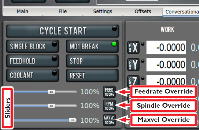

Spindle Override – The Spindle Override Slider and RPM 100% button (see Figure 2) allow you to override the commanded spindle speed by percentages ranging from 1 percent to 150 percent. The RPM 100% button returns the override to 100 percent of the commanded value or no override. The spindle must be running for these controls to have a noticeable effect. If overriden when the spindle is stopped, the speed is overridden the next time spindle starts. The override doesn’t drive the spindle past its maximum speed. The Spindle Override setting is ignored during spindle-synchronized (e.g., G84 tapping cycle) moves or any time M48 (disable feed and speed overrides) is in effect.
Feedrate Override – The Feedrate Override Slider and Feed 100% button (see Figure 2) work similarly to the spindle override controls. They affect the commanded feedrate by a percentage ranging from 1 percent to 150 percent. The feedrate override works for MDI, jogging, and G-code program G01/G02/G03 moves. The override has no effect on G00 (rapid) moves. The Feedrate Override setting is ignored during spindle-synchronized (e.g. G84 tapping cycle) moves or any time M48 (disable feed and speed overrides) is in effect.
Maxvel Override – The Maxvel Override and Maxvel 100% button (see Figure 2) work similarly to the Feedrate Override controls, except that these controls affect both G00 and G01 moves. They clamp the mill velocity to a percentage of the maximum velocity. The Maxvel slider can be very useful when running a G-code program for the first time. You can use it to stop the mill by sliding it down to 0 percent and verifying the Distance to Go and X/Y/Z/A DROs look appropriate before continuing. The Maxvel Override is a safety feature, and as such is not inhibited during spindle- synchronized moves or with M48. Make sure that Maxvel is at a value that allows the mill to achieve the programmed feed rate during spindle synchronized moves (e.g. G84 tapping) or the move may fail to produce the intended results.

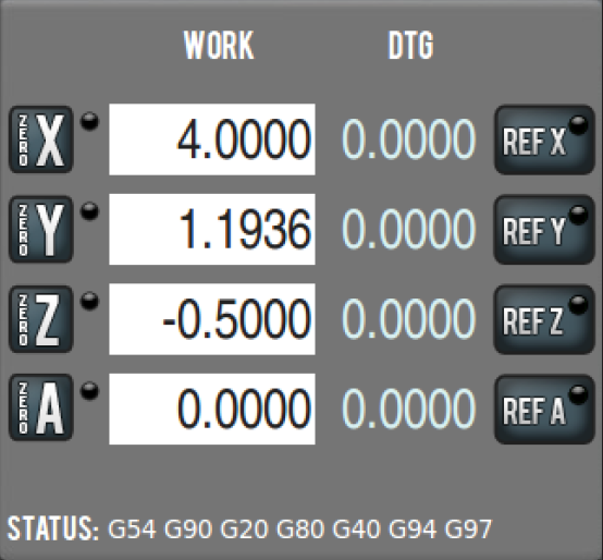

The buttons, labels, and DROs of the Position Status Group pertain to mill position, active G-code modalities, and feed/speed settings (see Figure 3). These controls may be used at any time before or after running a G-code program or MDI move. They are unavailable for operator input while mill is moving.
Figure 3

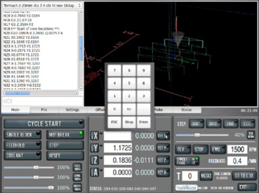

Axes Work Offset DROs – The X, Y, Z, and A work offset DROs display the current mill position expressed in the currently active work offset coordinate system (G54, G55, etc.).
When the mill is at rest, these readouts are also operator entry fields. Change the current work offset position by clicking in the DRO field, which illuminates. Type a number, for example 4.0, and click Enter on keyboard. Press the Esc key to return to the original value.
This technique is used for setting any DRO. Remember to click Enter after any DRO change. If you forget and just click on another DRO, any value you have just entered is discarded. This is designed to avoid accidental changes.
For convenience, the Zero button to the left of the axis DROs can be used to set the current work offset position for that axis to 0.000.
DTG (Distance to Go) – Just to the right of the axis DROs are the DTG (see Figure 2) or Distance to Go labels (light blue) that are read-only and display the distance remaining in any single move.
If you feedhold the mill in the middle of a move, or turn the Maxvel or Feedrate overrides to 0 percent, these labels display the distance left in the commanded move. These labels are useful when proving out a part.
Ref Axes Buttons Ref X, Ref Y, Ref Z, and Ref A buttons reference the axes to their home switch locations. This must be done after power on and before running a part program or using MDI commands. The axes may be referenced simultaneously, though it is common practice to reference the Z-axis first to clear the spindle or tool from the area of the workpiece or vise. When referenced, the LED is illuminated.
Status – The Status line displays the currently active G-code modalities and the active tool. A more detailed description of these active G-codes is provided on the Settings tab.
Jog Active LEDs – Between the (Zero) Axis and DROs are LEDs. If the mill is equipped with an optional Jog Shuttle (PN 30616), the active jog axis is indicated by an illuminated LED (see Figure 3).

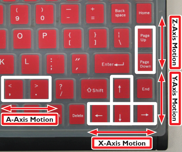

Tormach mills can be jogged with either the Jog Shuttle shown in Figure 5 or with the keyboard’s arrow keys (see Figure 6):
  • The right arrow jogs X-axis in the positive X direction (moves table left of operator)
  • The left arrow jogs X-axis in the negative X direction (moves table right of operator)
  • The up arrow jogs Y-axis in the positive Y direction (moves table toward operator)
  • The down arrow jogs Y-axis in the negative Y direction (moves table away from operator)
  • The Page Up key jogs the Z-axis in the positive Z direction (moves spindle up)
  • The Page Down key moves the Z-axis in the negative Z direction (moves spindle down)

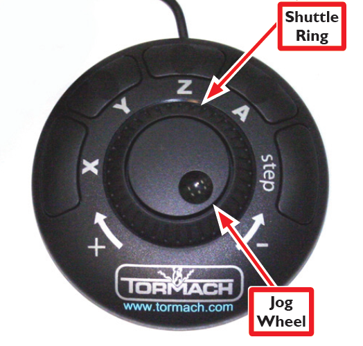

Figure 5: Jog Shuttle
Figure 6: Jogging with Keyboard Keys
NOTE: Jogging is not permitted during G-code program execution or during MDI moves.
The Jog Shuttle is an optional accessory (see Figure 5) that may increase productivity, especially on short-run jobs requiring extensive setting up of the workpiece and tooling.
The X, Y, Z and A buttons are used to jog axes X, Y, Z and A respectively (the LED light beside an axis DRO in the PathPilot interface indicates which axis is selected for jogging). The Step button cycles through the available jog step sizes (the LED on a Step Size Button in the PathPilot interface indicates which size is active). Continuous jogging is done with the Shuttle Ring by turning it counterclockwise (minus) and clockwise (plus). There are seven speeds to position any axis with speed and precision. Step jogging is done with the Jog Wheel (with finger dimple) by turning it counterclockwise in the minus direction and clockwise in the plus direction. The move will be made at the current feed rate.

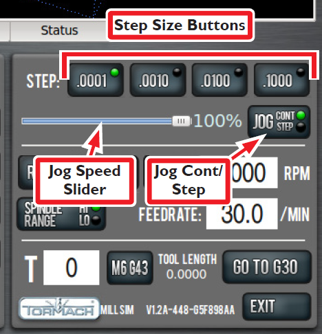

Whether using the jog shuttle or the keyboard arrow keys, there are two modes of jogging, continuous and step. When using the keyboard to jog, switch between modes using the Jog Cont/ Step button (see Figure 7).
Figure 7

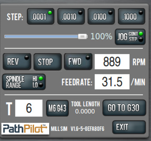

Step Mode – In Step mode the mill jogs in steps, where the step size is controlled by the four buttons to the right of the Step label (see Figure 7).
Notice that in imperial units (type G20 in the MDI Line) the step sizes range from 0.0001” to 0.1” (see Figure 7), whereas in metric mode (type G21 in the MDI Line) the step sizes range from .01 mm to 10 mm. The illuminated LED in the upper right corner of each Step button indicates active step size.
Continuous Mode – In Continuous mode the mill jogs at a continuous velocity when you press and hold any one keyboard arrow key; stop the mill by releasing the key. Axis motion is key specific as shown in Figure 6. The velocity is set using the Jog Speed Slider (see Figure 7). To set jogging velocity to the maximum speed, click and drag the Jog Speed Slider to the far right position.
Feed Rate DRO – Feed rate is the velocity at which the workpiece can be fed against the machine tool. The DRO, or digital read out, is the field that displays this velocity.

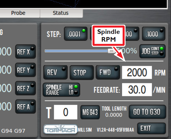

Spindle Controls – The REV, Stop, and FWD buttons can be used to manually control the spindle (see Figure 8). Rev is the equivalent of typing M04 in the MDI Line – it starts the spindle counter clockwise at the RPM specified in the Spindle RPM DRO (see Figure 8).
Figure 8
The Stop button stops the spindle, similar to the M5 command. The FWD button starts the spindle clockwise at the set RPM. These buttons are unavailable when running a G-code program or in the middle of an MDI move. Pressing REV or FWD triggers an alarm if the commanded spindle speed is outside of the valid spindle speed range for the mill's current belt position.
The Spindle RPM DRO is used to display the current spindle speed command (see Figure 8). You may change the current spindle speed command by typing a value into this DRO and pressing Enter. Values above the maximum RPM or below the minimum RPM for the current belt position triggers an alarm.
The Spindle Range button toggles between the two belt/pulley settings with an LED indicating which position is active (see Figure 8). For more information on spindle belt/pulley settings see, “Operation”.

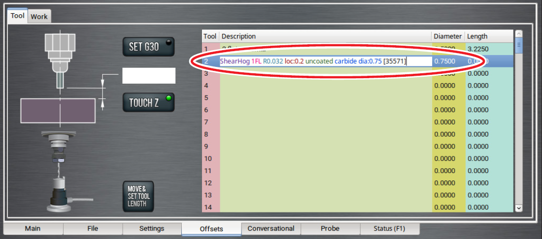

Tool DRO (T) – Displays the tool currently in the spindle. To change the spindle tool and apply its tool length offset, type a number (valid range is 0–256) in the Tool DRO and press Enter key or click the M6 G43 button.
M6 G43 Button – Causes the system to change the number of the tool that is currently in the spindle to the number typed in the DRO, as well as apply the length offset for that tool. M6 is the G-code command that requests a tool change and G43 is the command that applies a tool length offset (for more information on these commands, Programming).
Tool Length Label – Displays the current tool length offset. This display is normal (light blue text on grey background) when the tool offset number matches the tool number. But an alarm appears (orange text on red background) if the offset number does not match the current tool number.
Go to G30 Button – Causes the mill to move to a pre-defined G30 position, and is equivalent to typing G30 in the MDI Line. This G30 position can be set using the Set G30 button on the Offsets tab. Operators familiar with M998 will notice that the behavior of G30 is identical to M998. By default, the move to the G30 position is in Z only. This can be changed on the Settings tab.
To set the G30 position, jog the mill to the desired position and click the Set G30 Position button on the Offsets tab. Subsequent uses of the G30 command in G-code or the Go To G30 button will cause the mill to move to this position.

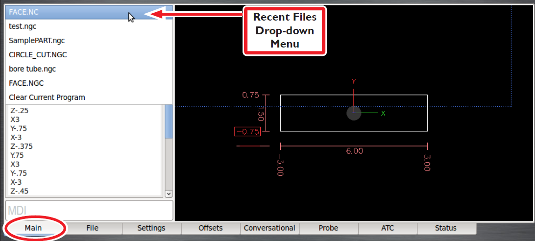

Selecting a Recent G-code Program File
The recent files drop-down menu displays the currently loaded G-code program file (see Figure 9). Click the drop-down menu to display the last five program files loaded into PathPilot; select the name of the program from the menu to load the G-code.
Select Clear Current Program in the recent files drop-down menu to close the currently loaded G-code program file.

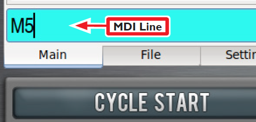

Manually Entering Commands
When running a G-code program, commands to the mill are read from a file. You can also send G-code commands to the mill directly with the MDI line (see Figure 10).
Figure 10

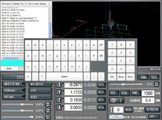

Click the MDI field to use the MDI line; the line is highlighted. Type the command, using the Backspace, Delete, Left and Right arrow keys to correct typing errors. Press Enter to execute the command; press Esc to abandon it.
Click the MDI field and use the Up or Down arrow keys to copy a recent MDI command into the MDI line. Up to 100 MDI commands are stored for reuse; these commands are saved between sessions. Command history is available after a power cycle.
NOTE: When the MDI line is open, all keystrokes are registered as a typed command. Jogging is not possible when you are clicked inside the MDI field.

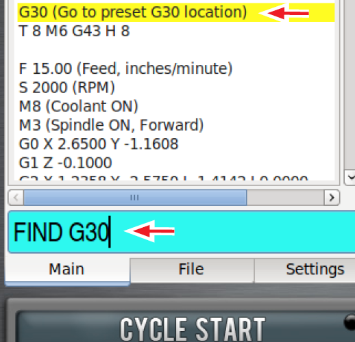

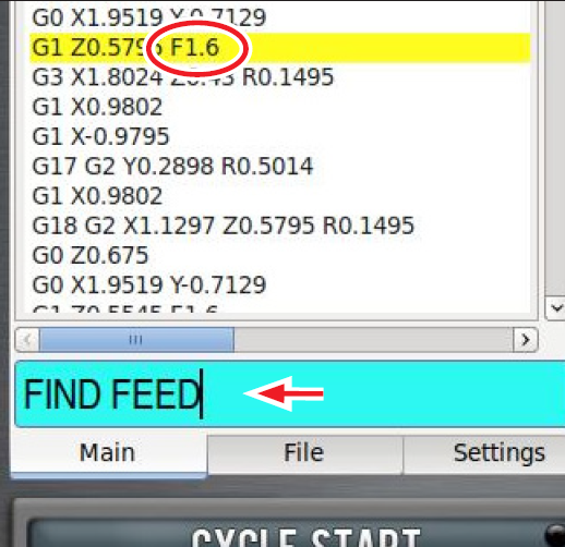

Searching in the Code
MDI has the ability to search the text of a G-code program file for specific numbers, codes, or items of interest like tools, feeds, and speeds.
Type FIND followed by the text to be searched in the MDI line (see Figure 11). Pressing Enter finds the next instance of the searched text; pressing Enter while holding down the Shift key finds the previous instance.
If found, PathPilot scrolls to the line containing the searched text and highlights it in yellow (see Figure 11). When the search reaches the end of the G-code file, it wraps and starts again from the beginning.
Figure 11
Change the starting point of the search by clicking on any line in the G-code window.
When used in conjunction with the FIND command, certain search terms (listed below) initiate a search through the G-code file to find more than just the actual search term:
  • FIND TOOL: Searches for instances of the actual word Tool in the G-code and any T G-code command which calls up a tool (e.g., T12)
  • FIND SPEED: Searches for instances of the actual word Speed in the G-code and any S G-code command
  • FIND FEED: Searches for instances of the actual word Feed in the G-code and any F G-code command (see Figure 12)
Figure 12
NOTE: Search text ignores case, so the command FIND TOOL will match TOOL, Tool, tool, etc.
The FIND command simplifies searching of a G-code file to verify speed and feed values and tool calls before cutting a part, or to find a specific set start line point in a large G-code file. For more information on using set start line, refer to “Setting a New Start Line section earlier in this chapter.

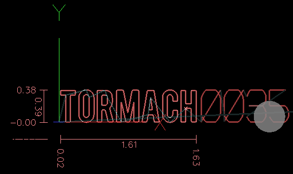

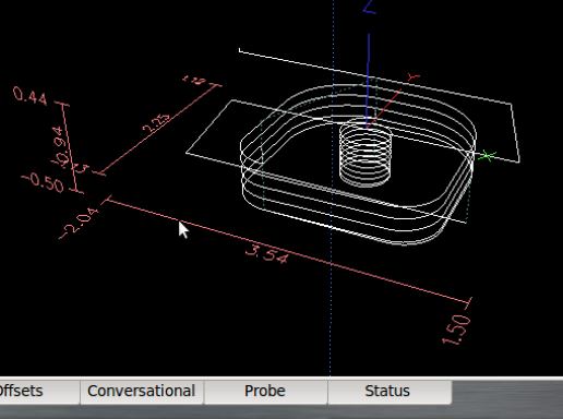

Working in the Tool Path Window
The tool path window displays a graphic representation of the tool path that is executed for the currently loaded G-code file (see Figure 13), each with a different color:
  • White lines: indicates the preview lines
  • Red lines: indicates the tool path as it is cut
  • Yellow lines: indicates jogging moves
  • Dotted blue lines: indicates the boundary box, which represents the ends of travel of the axes
Figure 13
Double-click the tool path window, or click Reset, to erase the jogging or tool path lines.
Changing the View of the Tool Path Window
Four views are available: top, front, right, and ortho. By default, the view is top. Right-click anywhere in the tool path display and select a different view to change the view of the window.
Grid lines are visible behind the tool path when the view is top, front, or right. Grid lines are not available in ortho. By default, grid lines are drawn at 0.5” intervals when in G20 mode (5 mm intervals when in G21 mode). Right-click anywhere in the tool path display and select a different grid spacing to change the resolution of the grid lines. When a program is loaded, the program extents (furthest points to which the tool will travel while executing the G-code) are displayed to the left and bottom of the tool path (see Figure 13).

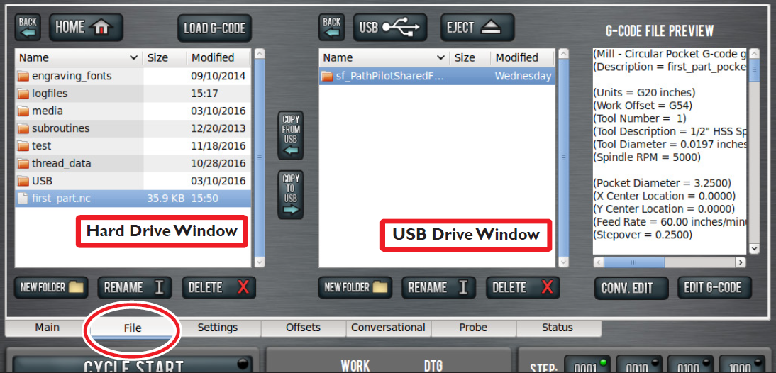

File Tab
The File tab is used to transfer files to and from a USB drive, copy, delete, and rename files and folders (see Figure 14). The left window shows files and folders on the controller hard drive; the middle window shows files and folders on a removable USB drive.
Figure 14
Managing Files
Use the New Folder, Rename, and Delete buttons below the respective USB Drive Window and Hard Drive Window for file management (see Figure 14). To move files into a folder, right-click on the file and select cut or copy from the pop-up menu.
Transferring Files or Folders from a USB Drive
  1. Insert a USB drive into any open USB port.
  2. Navigate to the file to transfer in the USB Drive Window.
NOTE: Use Back to navigate backwards; use USB to jump to the highest (home) level (see Figure 14).
  1. In the hard drive window, navigate to the desired location in the PathPilot interface to copy the transferred file from the USB drive.
  2. Highlight the file or folder to copy in the USB drive window; click Copy From USB (see Figure 14).
  3. If the file to be transferred has the same name as an existing file on the controller, you can either overwrite the file, give it a different name, or cancel the file transfer.
  4. When copied to the new location, the file displays in the USB drive window.
  5. Click Eject to disconnect the USB drive from the controller (see Figure 14).
NOTE: Ejecting the USB drive this way helps to avoid corrupting data on the USB drive.

Editing G-code with a Text Editor
  1. Highlight the file and click Edit G-code (see Figure 14).
  2. A text editor opens the file in a new window for editing the contents of the file. Make the appropriate changes to the file and click Save.
  3. Click the X in the upper right-hand corner of the screen to close the text editor.
  4. Click OK when asked to re-load the file.

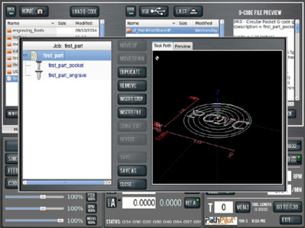

Editing G-code with Conversational Programming
  1. From the File tab, select the file and click Conv. Edit (see Figure 14).
    A job assignment editor opens the file in a new window. The left window displays job assignments of a program. The right window displays a preview of the program (see Figure 15).
Figure 15
  1. Edit the file contents as needed:
  • To change the order in which the steps of the program occur: Click Move Up, Move Down, Duplicate, or Remove.
  • To create a new job assignment using conversational programming:
    • Click Insert Step. PathPilot creates the job assignment and opens the Conversational tab.
    • Click Insert.
    • If necessary, edit the job assignment order in the program.
  • To load an existing G-code file into the program:
    • Click Insert File. G-code files that are hand-written, or generated from CAM software or conversational programming in PathPilot, can be inserted.
    • Navigate to and select the .nc file that you want to insert.
    • Click Open.
  • To edit a job assignment that was created in conversational programming:
    • Select the job assignment and click Conv. Edit. In the Conversational tab, PathPilot opens the relevant tab.
    • Make the desired changes to the job assignment.
    • Click Finish Editing.
  1. Click Save.
Tips:
  • To restore an edited job assignment to its original parameters: Click Revert.
NOTE: Revert is only available for individual job assignments created in conversational programming.
  • To undo all changes made to an entire G-code program: Click Close. When prompted, Close Without Saving.

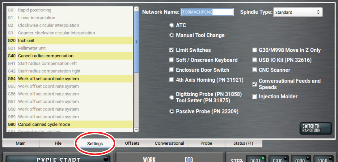

Settings Tab
The Settings tab displays active settings of the PathPilot controller, allowing you to configure PathPilot to suit your machine configuration (see Figure 16).
Figure 16
The window on the left side of the Settings tab displays a list of available G-code modalities. Active G-codes are highlighted in yellow (see Figure 16).
Specifying the Tool Change Method
Select the ATC (Automatic Tool Changer) or Manual Tool Change option to identify the tool changer type for your specific mill configuration. Mill behavior differs when it encounters an M6 command for an ATC or manual tool change.
If the ATC option is selected, PathPilot searches for an ATC attached to the mill. If the mill is equipped with an ATC, tools that have been assigned to the tray are changed automatically when a Tx M6 command is issued through the MDI line or within a G-code program file. The Tool DRO and M6 G43 button only change the current tool number – neither directly cause an automatic tool change. To request an ATC tool change, either program M6 Tx G43 in the MDI line or type a tool number in the Tool DRO and press Enter. For more information, refer to “ATC”.
If the Manual Tool Change option is selected, the mill pauses at the M6 command during a G-code program file execution, allowing you to manually change tools (see “Operation”, for information on the manual tool change procedure). After changing tools, press Cycle Start to resume program execution with the new tool. When the mill is paused and waiting for a manual tool change in the middle of a G-code program, the Cycle Start LED flashes on and off and a message is displayed with the requested tool number on the tool path display.
Selecting the Spindle Type
Use the Spindle Type drop-down to select spindle scaling if your mill is equipped with a Speeder Series 2 (PN 31350) or a High-speed Spindle (PN 35178).
Changing the Network Name
Use the Network Name field to change the network name of the controller; press Enter. The controller must be restarted for the name change to take effect.
If you are connected to a network using either the Ethernet jack or the optional Wireless Network Adapter (PN 38207), the controller appears on a network as network-attached storage. The controller exports a Windows network share named gcode to the Windows network with a domain name WORKGROUP. The default network name of the controller is TORMACHPCNC. The login name for the share is WORKGROUP\operator and the password is pcnc. The network name must be unique on your network. For more information, refer to the documentation that ships with the Wireless Network Adapter.
Disabling Limit Switches
The Limit Switches checkbox is selected by default. To provide a temporary workaround for a malfunctioning limit switch circuit, clear the checkbox. When cleared, Ref X, Ref Y, Ref Z, and Ref A sets the machine reference position to the mill position at the time it is clicked rather than completing the homing procedure.
NOTE: If desired, use this procedure in conjunction with one or more dial indicators mounted at the ends of mill travel to provide a more accurate method of manually referencing the mill.
Limiting a G30/M998 Move
Select G30/M998 Move in Z Only to move to the tool change position in the Z-axis only when using a G30 or M998 command. Otherwise, a coordinated X, Y, Z move occurs on G30 or M998.
The G30 or M998 G-code commands can be used to move the mill to a pre-set position. The position is settable using the Set G30 button on the Offsets screen. A G30 or M998 command is typically programmed right before a tool change line in G-code program files so that the spindle head clears the workpiece with sufficient distance to be able to change tools. For more information on using a G30 or M998 command, refer to “Programming”.
Enabling Feeds and Speeds Suggestions in Conversational Programming
Select “Conversational Feeds and Speeds” to enable feeds and speeds suggestions in PathPilot when using conversational programming. For more information on use, refer to “Using Feeds and Speeds Suggestions”.

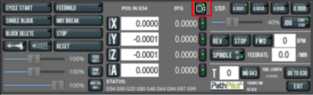

Use a USB Camera
Figure 56: USB Camera status.
About USB Cameras
Manual Recording
Figure 57: Manual recording controls.
Figure 58: Video Camera Recording button.
Figure 59: Camera settings.
    The Main tab displays.
Figure 60: Example of taking a photo.
To view E-stop videos:

Use the Settings tab to enable optional accessories that work with PathPilot.
4th Axis Homing
Select 4th Axis Homing if you are using an optional 4th Axis Homing Kit (PN 31921). For information on installation and use, refer to the documentation that ships with the product.
Enabling CNC Scanner
Select CNC Scanner if you are using an optional CNC Scanner. The Scanner tab displays. For information on installation and use, refer to the documentation that ships with the product.
Enabling Enclosure Door Switch
Select Enclosure Door Switch if you are using an optional Enclosure Door Switch Kit (PN 35550). The installed enclosure door switch is activated, and, when the front doors are opened:
  • All axis motion stops
  • Spindle speed reduces to 1000 RPM
For more information on installation and use, refer to the documentation that ships with the product.
Enabling Injection Molder
Select Injection Molder if you are using an optional Injection Molder. The Injection tab displays. For information on installation and use, refer to the documentation that ships with the product.
Enabling Soft Keyboard
Select Soft / Onscreen Keyboard to use a soft keyboard with the optional Touch Screen Kit (PN 35575). For information on setup and calibration, refer to the documentation that ships with the product.
When you select a DRO field, a numeric keypad opens on screen (see Figure 17). When you select either the MDI line, the Save field, the Save As field, or the conversational title DRO, a QWERTY keyboard opens on screen (see Figure 18). Press Enter to accept the value typed; press ESC to exit the soft keyboard and restore the previous value.
Figure 17
Figure 18
Enabling Probes
Identify the probe type if you are using one of the two optional probe options — a Passive Probe (PN 32309) and an industrial-grade Digitizing Probe (PN 31858).
IMPORTANT! Do not use probing features in PathPilot before selecting this setting. Refer to chapter 8, Accessories, to make sure the correct probe is selected.
Enabling USB I/O Board
Select Use USB IO Kit if you are using an optional USB M-code I/O Interface Kit (PN 32616). For information on installation and use, refer to the documentation that ships with the product.
Switching to RapidTurn
Click Switch to RapidTurn to close the PathPilot interface for the mill and open PathPilot interface for the RapidTurn (PN 32901). For information on operating the RapidTurn and related interface, refer to the RapidTurn operator manual.

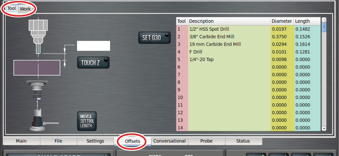

Offsets Tab
The Offsets tab reveals two sub tabs: Tool and Work (see Figure 19).
Figure 19
Work offsets are a concept that allow the operator to think in terms of X/Y/Z coordinates with respect to the part instead of thinking of them with respect to the mill position. Up to nine work offsets can be saved in the control. These are selected either by typing G54, G55, ... (up to G59, G59.1, G59.2, G59.3) into the MDI line, or by including them in a G-code program.
Tool offsets allow the operator to use tools of different lengths or – when using G41/G42 cutter radius compensation – different diameters, while still programming with respect to the workpiece. The most common tool offset is the tool length offset, which is applied by the G43 command.
Tool Tab
The Tool tab displays a tool table on the right with fields available to input tool information (see Figure 19).
NOTE: Fields are only editable if the mill is powered on and not in Reset mode.
For a given machining operation, the X and Y position of the workpiece are fixed. If you are using multiple tools of differing lengths, you will need to change the Z offset for each tool. PathPilot allows you to switch tools quickly, without the need to set up the mill every time a tool is mounted. Each tool and holder only needs to be measured once, either offline or in the mill.
Tool Measuring Techniques
Different tool measuring techniques may be used, but the three most common methods are:
  • Offline measurement with a height gauge
  • Automated measurement with an electronic tool setter
  • Touching off tool to a reference surface

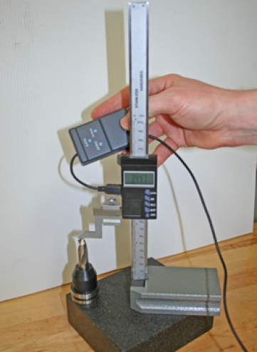

Measuring Offline with a Height Gauge
The Tormach Tool Assistant Set (PN 31988) includes an 8” digital height gauge and a USB interface cable with touch trigger (see Figure 20).
  1. Connect the USB interface cable to any available USB port on the controller.
  2. Move the digital height gauge to a block and press Zero on the touch trigger. The device is zeroed.
NOTE: Granite Surface Plate with Integrated Tool Hole (PN 31713), as shown in Figure 20, helps accurately measure tool length.
  1. To measure tool height, mount the tool in a TTS tool holder and place on a block (see Figure 20). The tool height measurement is the distance from the block surface to the end of the tool tip.
Figure 20
  1. From the PathPilot interface, click the appropriate line in the tool table (see Figure 19); the line is highlighted.
  2. Press Data on the USB interface cable to transfer measurement information to the Length field in the tool table (see Figure 19).
Measuring Automatically with an Electronic Tool Setter
Before using an electronic tool setter:
  • Set the work offset such that the surface upon which the electronic tool setter sits is Z zero. A quick way to do this is to use the Move And Set Work Offset button on the Offsets screen’s Work tab, with either a tool of known length in the spindle or with no tool in the spindle (and Tool Zero in the tool DRO).
    By doing this setup step, you are measuring true tool lengths, and can interchange tools measured in the height gauge with tools measured with the electronic tool setter.
To measure a tool with the electronic tool setter: Put the tool in the spindle, type the tool number in the tool DRO, and then, with the tool centered over the electronic tool setter, click the Move And Set Tool Length button on the Offsets screen’s Tool tab.
Measuring by Touching Off Tool
This method was covered in chapter 5, Intro to PathPilot, in your operator manual. It is not as accurate as the previously described methods, but works in many situations.

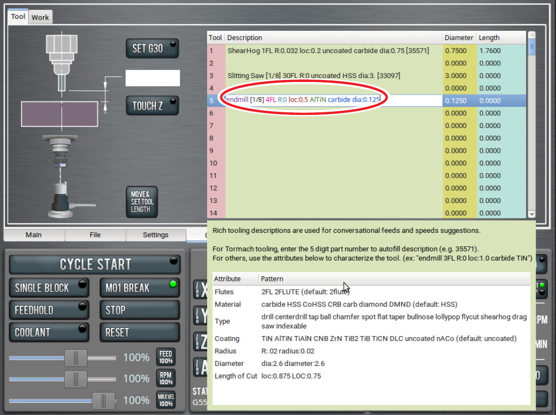

Creating Tool Descriptions
PathPilot uses keywords and patterns in the tool description to recognize tooling features. Refer to the section Using Tool Keywords later in this chapter for more information.
Example: "Dia:.3125 4FL R:03 AlTiN CRB variable loc:.75"
This description provides the following information for PathPilot to calculate machining information:
  • 0.3125 tool diameter
  • Four flutes
  • 0.03 radius, or "bullnose"
  • Carbide
  • Variable helix
  • 0.75 length of cut (loc)
To get accurate machining information, all tooling must be described with detail: the more detail, the better the results. Using a personal description likely won’t contain meaningful information for PathPilot.
Figure 21
Example: "Gold colored end mill from middle drawer"
This description provides virtually no information. PathPilot defaults to basic cutter features about this tool:
  • Two flutes
Manually Entering Tool Descriptions
You can manually enter tool descriptions in the Tool Table window. Descriptions are not case sensitive.
If a pattern or word in the description is recognized, PathPilot uses syntax highlighting to indicate a valid description (see Figure 21).
Refer to the section Using Tool Keywords later in this chapter for more information on tool description keywords.

Generating Automatic Tool Descriptions
If you are using a Tormach tool, you can enter the part number to automatically generate tool descriptions in the Tool Table window (see Figure 22).
Figure 22
NOTE: If you're unsure of the part number, you can search for the tool at tormach.com.
  2. Type the part number for the tool.
Example: 35571

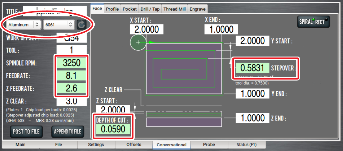

You can use PathPilot to automatically calculate feeds and speeds: from the Conversational tab, in the Conversational DROs group, select a material, a sub-type, and a tool (see Figure 23).
Figure 23

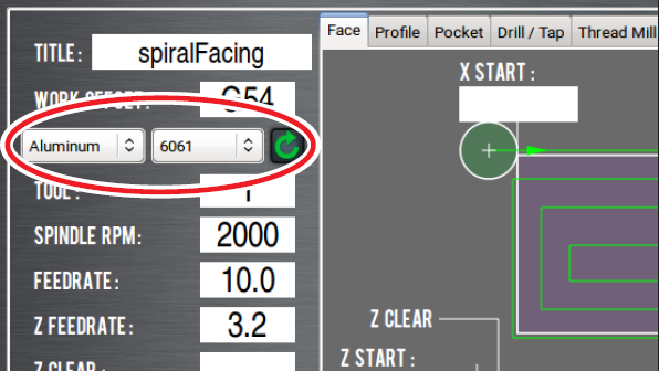

To calculate feeds and speeds, you must first make sure PathPilot has relevant details about the tooling. For more information, go to the section Creating Tool Descriptions earlier in this chapter.
  1. From the PathPilot interface, on the Conversational tab, locate the Material dropdowns in the Conversational DROs group.
  2. From the Material dropdown, select your material.
    Examples:
  • Aluminum
  • Plastic
  1. If required, from the Sub-type dropdown, select the material sub-type.
    Examples:
  • -any-
  • 6061
  1. In the Tool DRO, type the assigned tool number.
  2. Click Refresh (to the right of the Sub-type dropdown). The following machining-related DROs are calculated:
  • Spindle RPM
  • Feedrate
  • Z Feedrate
  • Depth of Cut (if milling)
  • Stepover (if milling)
  • Peck (if drilling)

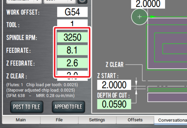

NOTE: After PathPilot calculates values for the machining-related DROs, the background turns green (see Figure 23).
Adjusting DRO Values
After selecting the material and tool, you can adjust the values in the calculated DROs, like Feedrate or Stepover. Adjusting the value in one of these DROs does not change the value in the other machining- related DROs.
Once you adjust the value in the DRO, the background switches from green back to white (see Figure 24). This helps you identify which DROs have suggested values (those with a green background), and which DROs have values you've supplied (white background).
Figure 24
Refreshing DRO Values
The suggested feeds and speeds are no longer valid if:
  • You select different material or sub-type values, or if you type a new value in to the Tool DRO.
    The suggested feeds and speeds are made by taking into account the current, specific conversational operation — like Face, or Pocket. Changing your conversational operation requires you to refresh.
When the feeds and speeds are no longer valid, the Refresh button turns green, and the machining-related DRO backgrounds switch from green to white (see Figure 25).
Figure 25

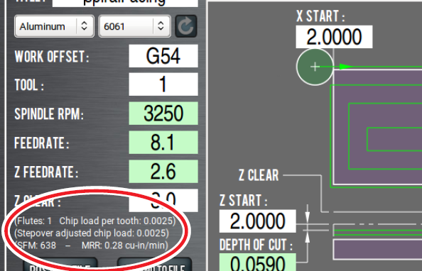

Using Additional Provided Information
On the Conversational tab, in the Conversational DROs group, there are tips that are displayed based on the calculations that PathPilot is performing (see Figure 26):
  • Chip load information
    Chip load — the amount of material removed per tooth — is based on the number of flutes, RPM, and feedrate.
    As the stepover value decreases, the actual chip load decreases. If the stepover is too small, the cutter may not have enough contact with the material to cut — effectively resulting in pre-mature tool wear.
Figure 26

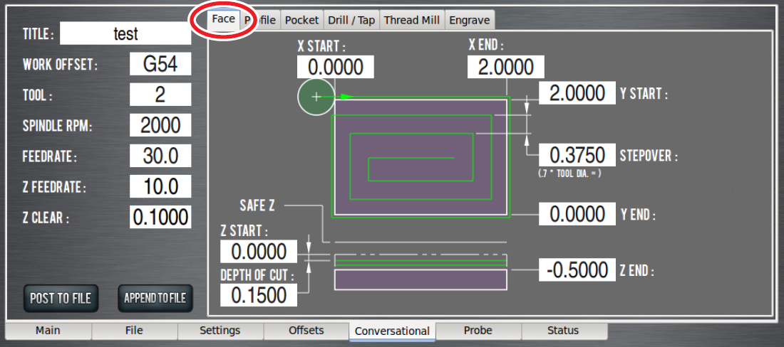

Face Tab
Face is generally used for cutting an accurate top surface from rough stock, cutting successive XY-planes over a Z range (see Figure 27).
Figure 27
It is assumed that the top of the stock is free of any clamps or other work holding devices, such as when the stock is held in a vise. The start of each Z pass is intended to be off to the side of the workpiece then move in XY to start cutting at the X Start, Y Start corner. This avoids the need for plunging the Z Depth of Cut move into the workpiece.
Therefore, the area around this corner must be clear of obstructions down to Z End. The tool diameter also extends beyond the workpiece X and Y edges by an amount dependent on the tool diameter and the stepover values, so Z End must be above the vise jaws.
The G-code routine starts with a move to G30, which typically is the park, or tool change position. Next comes a tool change if needed, a rapid move in XY to the workpiece start, and a rapid down in Z to Z Clear. An XY pass starts with an adjusted Z Depth of Cut, then a rectangular spiral from the workpiece perimeter, ending at the center. If a finish pass with different parameters is needed, save the current file, edit the current screen to the finish configuration and append to the saved file.
XY DROs
Start and End – These DROs should be set to the location of the workpiece edges. Tool paths, such as a lead-in, that are normally outside of the workpiece area are set in reference to these values, so no adjusting beyond the actual location of these edges should be needed.
Stepover – This is the space between spiral tool paths. To prevent uncut areas in the spiral corners, the stepover value should be limited to 80 percent of the tool diameter (see Figure 28). A stepover of 0 may be entered which invokes a center only cut. This is more formally called by X or Y values that create a workpiece width less than 70 percent of the tool diameter.
Figure 28
Z DROs
Z Start and End – The first Z pass will cut at Z Start – Depth of Cut adjusted. The last Z pass will cut at the Z End location. For a single Z pass at Z End, enter 0 or a full Z range value into the Depth of Cut DRO.

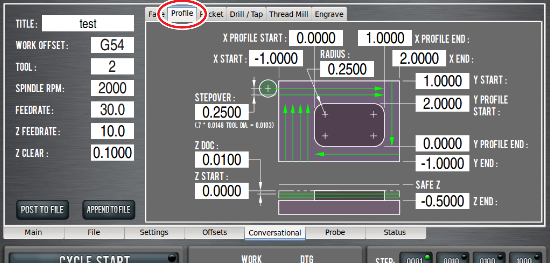

Profile Tab
Profile cuts an XY area with successive Z Depth of Cuts to form a rectangular island (see Figure 29).
Figure 29
The outer bound of the area is the stock material's outer edges. The inner bound is the island perimeter. For the cutting routine, the area is divided into four sections (north, east, south, and west). As with Face, the starting position for cutting each section is off the workpiece with an X or Y feed into the workpiece, thus avoiding a Z plunge cut. Cutting paths are restricted to climb cutting, so the tool is retracted to Z Clear at the end of each sweep of a section, with a rapid move to the beginning of the section for the next sweep. After each section is cut, the corner radii, if any, are cut with a tool path that travels around the perimeter of the island. This process is repeated for each Z Depth of Cut pass. If a finish pass is needed, leave enough material, then append your finishing G-code (usually a single pass around the perimeter) to this file later. Feed rate on the radius cuts are adjusted to compensate for the difference between the tool control point rate (at the tool center) and the actual rate at the radius surface.

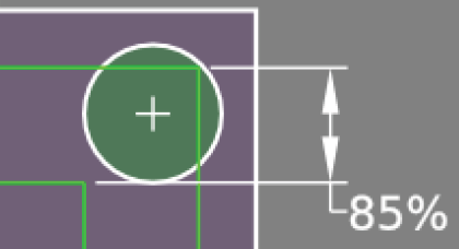

X and Y Start and End DROs
Start and End – These DROs should be set to the location of the workpiece edges. Tool paths outside of the workpiece area are set in reference to these values so no adjusting beyond the actual location of these edges should be needed.
Profile Start and End – The tool radius is used to create the tool path, so these DROs should be set to the location of the profile outer edges.
Radius – Enter 0 if no corner radius is desired. Valid radii values are from 0 to one half of the island’s narrow width (or limited to full radii on the long ends of the island).
Stepover – This is the tool path offset between section sweeps. A stepover of 0 creates a single pass (or rectangular slot) around the perimeter (outside) of the boss.
Z Start and End – The first Z pass cuts at Z Start – Depth of Cut adjusted. The last Z pass will cut at the Z End location. For a single Z pass at Z End, enter 0 or a full Z range value into the Depth of Cut DRO.
Depth of Cut – The Depth of Cut entered into the DRO is later adjusted to fit evenly within the Z range (Z End – Z Start), so each Z pass has the same depth instead of having a short depth on the last pass. For a single Z pass at Z End, enter 0 or a full Z range value into the Depth of Cut DRO.
Z Clear – Z location the tool moves or retracts to when starting or ending a Z pass, a section sweep, or a section change. This should be set to clear any obstructions between path changes.

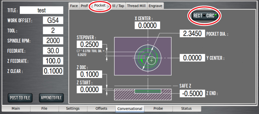

Circular
Pocket-Circular has a different entry for cutting a circular pocket dependent on the pocket diameter and the tool diameter (see Figure 31).
  • If the tool diameter is bigger than pocket diameter:
    • This produces an error with no G-code being produced.
  • If the tool just fits within the pocket diameter:
    • A straight Z plunge in the pocket center is used, therefore a center cutting end mill is needed. Next comes a single pass around the perimeter. This is repeated for each Z Depth of Cut pass.
Figure 31
  • If the pocket diameter is greater than 2x tool diameter:
– This allows a helical entry which cuts a hole of 2x tool diameter in center of pocket. Material clearing is done with a spiral cut out to the pocket diameter, plus a cut around the perimeter.
XY DROs
X and Y Center – These DROs should be set to the location of the pocket center.
Pocket Dia. – Enter the value of the pocket diameter. The tool radius is used to set the tool path diameter.
Stepover – This is the tool path offset between each rotation of the spiral cut. A stepover of 0 creates a single pass (or circular slot) around the perimeter (inside) of the pocket.
Z DROs
Z Start and End – The first Z pass cuts at Z Start Depth of Cut adjusted; last Z pass cuts at the Z End location. For a single Z pass at Z End, enter 0 or a full Z range value into the Depth of Cut DRO.
Z Clear – Z location the tool moves or retracts to when starting or ending the Pocket routine.

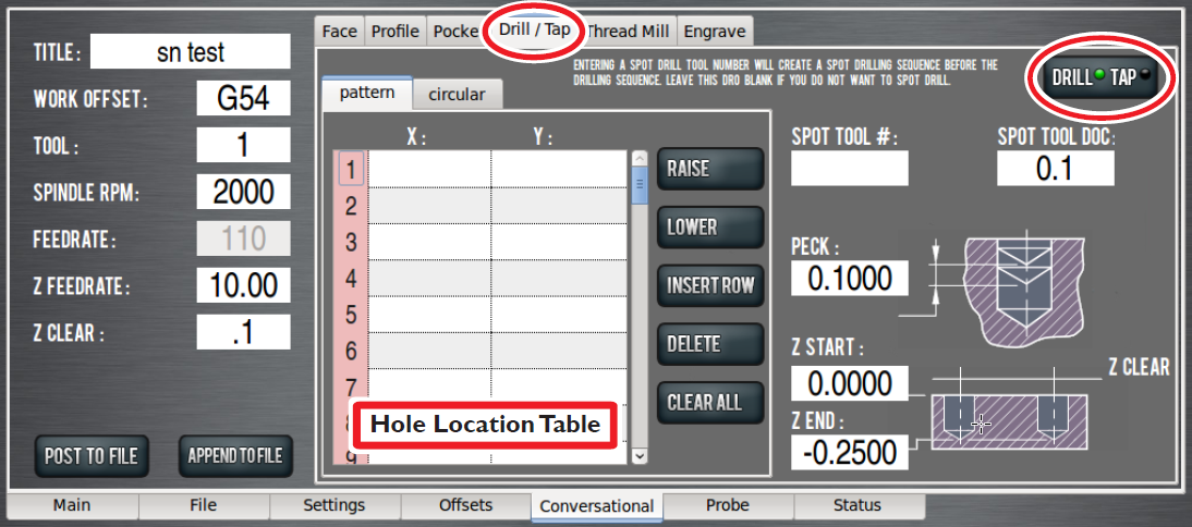

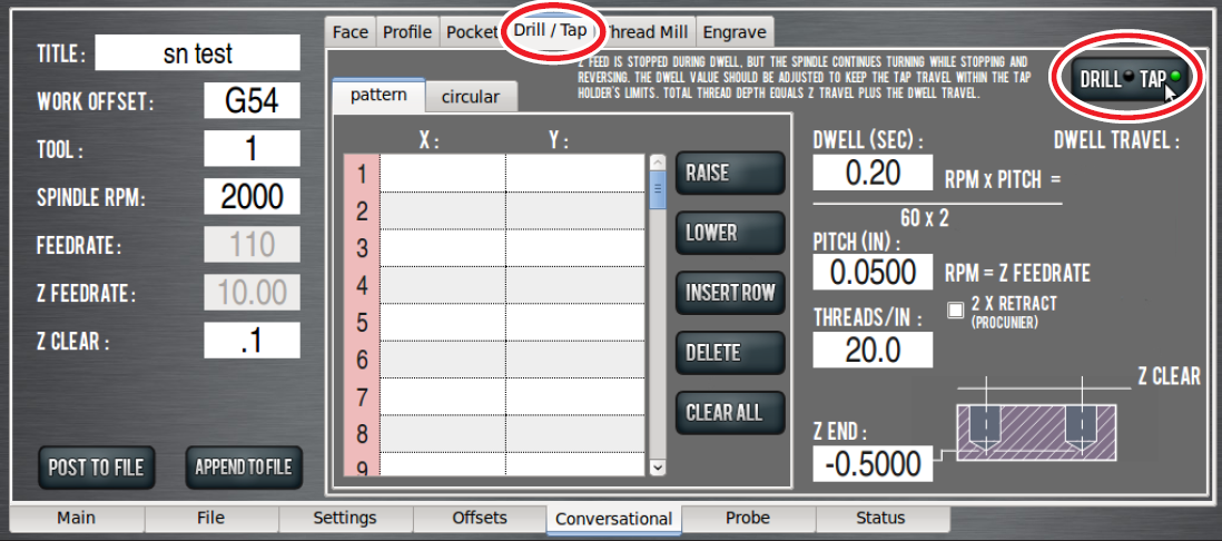

Drill/Tap Tab
Drill/Tap provides a means to create a hole location list, then, based on DRO entries, configures an appropriate canned cycle G-code to create holes – either Pattern or Circular (see Figure 32).
Figure 32
The Drill/Tap tab contains a separate, smaller notebook consisting of two tabs: Pattern and Circular.
Pattern DROs
Hole Location Table – This table should be used for making a list of X and Y locations for each hole using the same tool, Z, and common DRO entries (see Figure 32). To create holes using different tools or other parameters, post the first group, clear the table, enter the next group of locations and other parameters, then append the new list to the existing posted file.
Holes in a list are completed in order from top to bottom. You can rearrange the row order by using the Raise and Lower buttons. To move a row, first activate it by clicking anywhere on the desired row, which highlights it in blue, then select either Raise or Lower. To edit an X or Y cell, click on the desired row, then click the desired cell. An active cell shows up as a white box with a cursor marker (which looks like | ) on a blue row. If there is already a number in the selected cell, it is blocked in blue and is replaced with any number typed in.
To edit an existing number, click on the number until a cursor appears. The Clear All button clears all entries in the table. Leaving a cell checks the entry to see if it is a valid number. If not, the entry is erased and an error shows up in the Status tab. Rows are checked when Post to File is clicked. Any missing entries (an X without a Y, a Y without an X, or an empty row before the last row with an entry) stop the posting and insert the text “??” in the cells with missing entries. Fill in the missing entries, delete any “??” entries and Lower any empty rows past the last row with an entry, then try posting again.

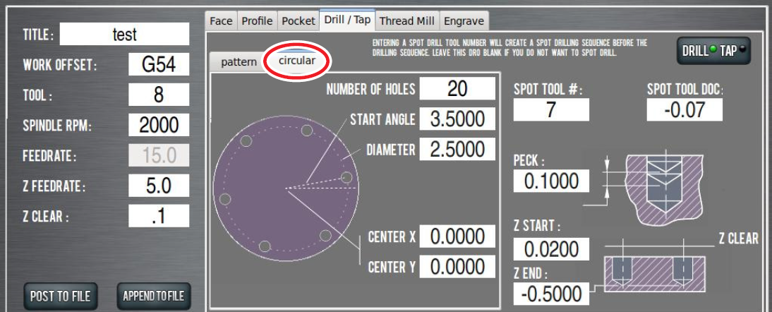

The Circular tab creates a specific hole pattern of evenly spaced holes around a circumference, also know as a bolt pattern (see Figure 33). As with the Pattern tab, all features and corresponding DROs, like Spot and Peck, are retained.
Figure 33
Circular DROs
Number of Holes – Specifies the number of holes in the pattern. This must be greater than zero.
Start Angle – Specifies the angle from angle 0. Angle 0 is a base (horizontal) line from the center point going right (east) to the circumference. The angle from the base line can be either positive or negative, up to 90 degrees (or -90 degrees) and rotates the pattern either clockwise or counterclockwise. A negative angle produces a clockwise rotation; a positive angle produces a counterclockwise rotation. For example, to create a hex pattern with flats on the top and bottom, enter 0 into the Start Angle DRO. To create a hex pattern with flats on the left and right sides, enter 30 (or -30) into the Start Angle DRO.
Diameter – The size of the circular pattern as defined by a line through the center point of each hole.
Center X, Center Y – Defines the center point of the circular pattern.
Spot Tool # – If this DRO contains a valid tool number when Post To File is clicked, a spot drilling sequence using this tool number will occur prior to the drilling sequence. The Feedrate, Spindle RPM, and Z Clear from the drilling sequence will be used for the spot drilling operation. The depth of cut for the spot drilling will be taken from the Spot Drill DOC DRO.
Spot Tool DOC – If the drilling operation includes spot drilling, this DRO will be used to determine the depth of cut for the spot drilling operation (for more information on defining a tool for a spot drilling operation, refer to Spot Tool # earlier in this section).
Drill
The Drill tab uses one of the canned G8x cycles to drill a hole at each location called out in the Hole Location Table (see Figure 32). The drill cycles available are: G81 – Drill, G82 – Drill with Dwell, and G83 – Drill with Peck (features can not be combined; peck cancels dwell).
Since it is usually more convenient to touch-off a drill on its point, that configuration is presented in the graphics. Hole depth is usually defined as the full diameter portion of the hole, so the Z length from the drill point to the corner may need to be considered.
Dwell – An entry greater than 0 replaces G81 with G82 in the G-code, unless there is an entry greater than 0 in Peck. The G82 routine feeds at the Z Feedrate (a DRO in the left panel) until reaching the bottom of the hole, then the position is maintained during the period set by Dwell.
This is usually used to let the tool complete the cutting of the hole bottom before retracting. A revolution calculation is presented in the graphics to aid in setting an appropriate dwell value (such as half revolution for a two flute drill).
Peck – An entry greater than 0 replaces G81 with G83 in the G-code. The G83 routine feeds at the Z Feedrate starting from Z Clear down a Peck distance, then rapid retracts to Z Clear, and rapid returns to start the next peck. The peck distance is not adjusted so the first and last peck will likely be shorter than the Peck setting.

Tap
Tap uses the G84 canned cycle which is similar to the G81 drill cycle, except a spindle reversal is commanded at the bottom of the hole (see Figure 34). It is important that the Z Feedrate matches the spindle RPM and tap pitch, so the rate is calculated from the pitch and RPM DRO entries. The result is displayed in the Z Feedrate DRO (in the left panel) after the Enter key is pressed in one of the RPM, Pitch, or TPU DROs. Note that an auto-reversing tapping head typically uses a drilling cycle.
Figure 34
Dwell – Allows for tapping with a tension/compression tapping head. A calculation is presented as a guide to how much the tapping head may need to extend while the Z-axis is stopped during spindle reversal at the bottom of the hole. Dwell travel is half the distance the tap would travel at the selected RPM. This assumes half the dwell time is on the down stroke and half up. It is also assumed the RPM is constant during the down stroke, but since the spindle is actually decelerating to a stop, the actual travel should be considerably less.
Pitch and Threads/Unit – These DROs are linked; enter whichever value is handy. When the Enter key is pressed, the corresponding DRO is calculated and updated.
Z DROs
Z Start and End – G84 starts at the Z Clear location, reverses the spindle at the Z End location, and ends back at the Z Clear location. Note that the tap continues a little bit beyond Z End during the dwell period.
Z Clear – This is the Z location the tool moves or retracts to at the start and end of a hole, as well as moving between holes, so it must clear any obstructions along the path between holes.

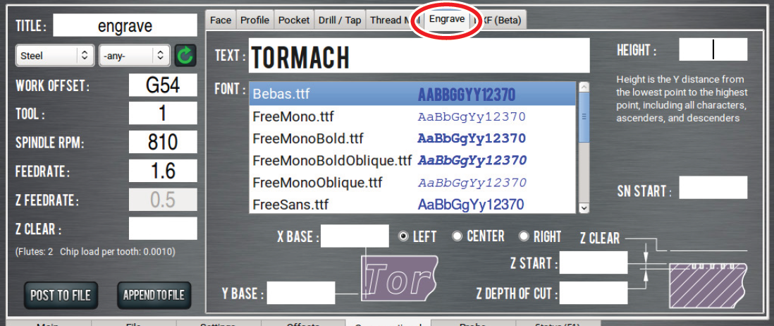

Engrave Tab
The Engrave tab (see Figure 37) contains functions to engrave a single line of text cut in a single horizontal pass (along the X-axis). This is a basic text engraving routine best suited for engraving True Type stick or outline fonts into things like simple plaques, control panels, or data plates.
Figure 37
Fonts describe paths of the tool control point; therefore, the tool’s effective cutting diameter may need to be considered for overall character size.
Serial numbers – a number that sequentially increases with each Cycle Start – can be engraved alone or added to the end of any desired text. Serial numbers use their own non-proportional font and are scaled to match the defined font extents. For more information on adding serial numbers to an engraving routine, refer to SN Start later in this section.
X and Y Start – Sets the location of the left side of the first character’s baseline. If any characters in the text have descenders, such as y or g, they extend down below the baseline. The tool’s effective cutting diameter may cut an area before or beyond the start location (see Figure 38).
Figure 38
Height – Sets the Y distance from bottom to top of text. This includes ascenders and descenders, but not the tool cutting diameter (subtract this diameter from the overall desired height to get a more accurate value to enter). Height is used with the font data to calculate a scale value that is applied to the character paths in the G-code. The actual height may vary and need adjustment.
Text DRO – Is the text to be engraved. A sample of the text in the selected font is updated when the Enter key is pressed.
SN Start – Sets a starting serial number. Add zeros in front of the first digit as a hint to the number of decimals to be engraved in the series (including leading zeros). For example, if '0012' is entered, '0012,' '0013,' '0014,' '…' will be engraved. If '99' is entered, '99,' '100,' '101,' '…' will be engraved. The current serial number is stored internally; to view, hover over the SN Start DRO.
NOTE: Leave the Text DRO blank to only engrave a set of sequential serial numbers; likewise, leave SN Start blank to only engrave a line of text. It is an error if both the Text DRO and SN Start are blank.
Font – Lists the True Type font files found in the font directory. Scroll through and click on the desired font; clicking presents a sample in the Text DRO. Some font files do not render in this box, but may be viewed by posting the file and checking the font in the Main tab’s preview window (see Figure 38). True Type font files may be added to the Font list by transferring font files to the gcode/engraving_ fonts sub-directory in the controller's home directory (for more information, refer to File Tab section earlier in this chapter). Power the controller off and back on to refresh new files in the Font list.
Z DROs
Z Start – Sets the location of the surface to engrave.
Depth of Cut – Is the depth the cutter is fed into the workpiece.
Z Clear – This is the Z location the tool moves or retracts to at the start and end of the engraving routine, and when moving between characters.
DXF Tab

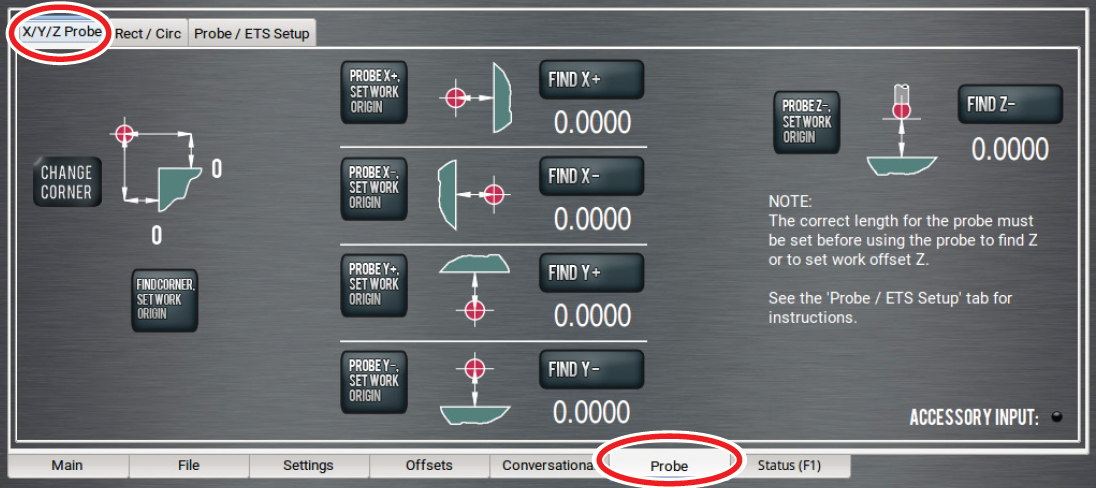

XYZ Probe Tab
The X/Y/Z Probe tab of the Probe notebook allows the user to quickly touch off a workpiece or vise jaw to find that feature’s location in current work offset coordinates, or to touch off that feature and set the work offset zero to the feature’s surface (see Figure 39).
The Find Corner, Set Work Origin button is used to probe the corner of a vise jaw or rectangular workpiece, and set that corner to X/Y zero.
NOTE: To change the corner on which to probe a part, click Change Corner.
To use this button, first position the probe below the surface of the vise jaw and roughly 1” away from the vice jaw corner in X and Y (see Figure 39). Upon completion of the probing moves, the current active work offset system (e.g. G54) is set such that the vise jaw corner is 0, 0 (the X/Y origin).
The Probe (Axis), Set Work Offset buttons will probe in one axis only and set the current work offset origin to the probed surface for that axis. The direction of probing is specified by the + or – sign on the button and is described by the accompanying graphic.
The Probe (AXIS) buttons cause a probing move similar to the Probe (AXIS), Set Work Offset buttons, but will not change the work offset value. Instead, the location of the probed surface is displayed in the label below the button.

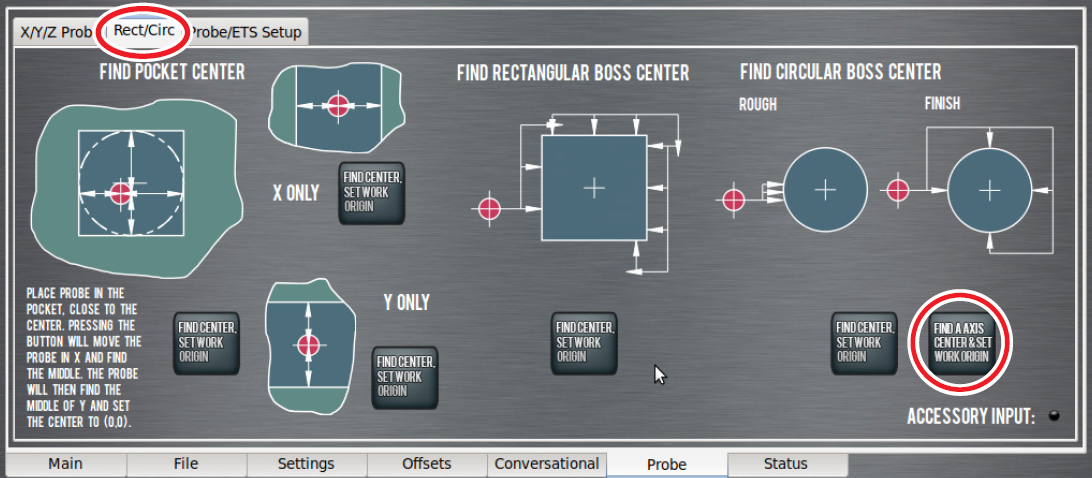

Rect/Circ Tab
The Rect/Circ tab of the Probe notebook contains buttons that automate tasks like finding the center of a pocket, slot, or bore, as well as finding the center of a circular or rectangular boss (see Figure 40). As the on-screen instructions suggest, first jog the probe below the top surface of the feature to be probed.
Figure 40
The Find Pocket Center, Set Work Origin button works in either a round or rectangular pocket. The probe moves in both X and Y to find the pocket center. The Find Center, Set Work Origin buttons perform a similar probing operation, but in X or Y only, and are intended to be used to find the center of a slot.
The rectangular boss center finding routine hunts around the edge of a square or rectangular workpiece to find the center. To use this routine, start with the probe below the top surface of the boss and on the left-hand side. Similarly, the circular boss center finding routine probes three times to find an approximate center of curvature, then confirms the circular boss center with four additional moves. To use this feature, start with the probe below the top surface of the boss and on the left-hand side.
The Find A Axis Center & Set Work Origin button (see Figure 40) is available for use with a 4th axis mounted in the A-axis orientation. The function probes a round workpiece mounted in the A-axis to find the center rotation of the A-axis. Move the probe to a point approximately directly above the A-axis center of rotation, and click the Find A Axis Center & Set Work Origin button (see Figure 40).

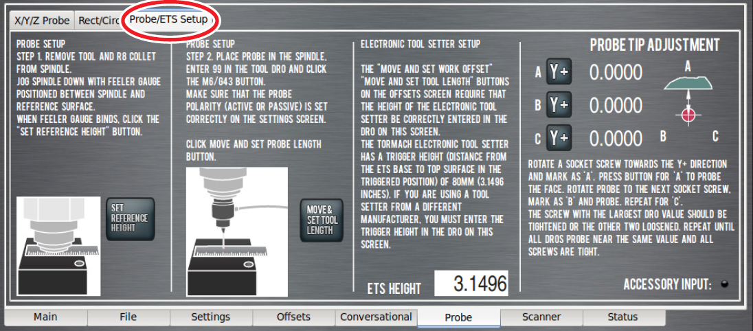

Probe/ETS Setup Tab
The Probe/ETS Setup tab is used to align and set the probe and ETS heights (see Figure 41). For information on probe and ETS setup, refer to chapter 8, Accessories, in your operator manual.
Figure 41
