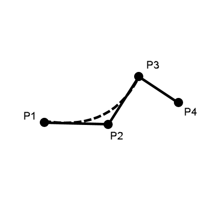

P - specifies a tolerance from the program end/start point that the machine is allowed to deviate by. In the image below P controls the allowable distance of the dashed line from the P2 point, illustrated by the dashed line. A typical value for the P parameter would be .005”.

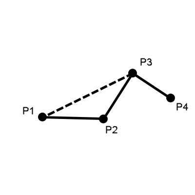

Q - specifies a tolerance for multiple line segment end points to be collapsed into a single line segment. In the image below, the original program path consisted of line segments from P1 to P2, P2 to P3, and P3 to P4. If the distance of P2 to the line segment between P1 and P3 is smaller than Q, the line segments of P1 to P2 and P2 to P3 will be deleted and the line segment between P1 and P3 will be used instead, illustrated by the dashed line. A typical value for the Q parameter would be .0005”. Greatly diminishing returns are seen from values over .001”.

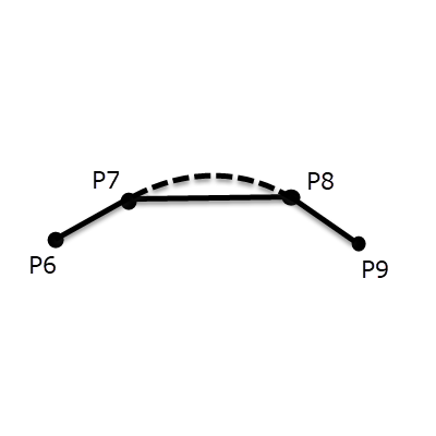

R - specifies a tolerance from the programmed path, other than the program end points. In the image below, R controls the allowable distance of the dashed line from the P7-P8 line segment with the allowed deviation illustrated by the dashed line. A typical value for the R parameter would be .0005”.

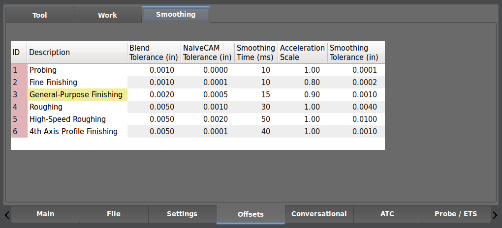

Smoothing Profiles and Application
Pathpilot includes several preset profiles for use in different applications, applied by the use of an L argument with M59 (eg, “M59 L3”). The profiles set parameters for both G64 and M59. It is possible for the profile to be temporarily modified by additionally specifying one or more of the G64/M59 parameters, for example specifying “M59 L3 D25 E1” will apply the L3 profile but will set the D parameter to 25 and set the E parameter to 1 instead of the current profile defaults of 15/0.9.
The smoothing profiles can be seen as a new tab of the Offsets page as of 2.11.0.
The 4th Axis Profile Finishing smoothing profile should be used for all simultaneous 4th axis toolpaths
